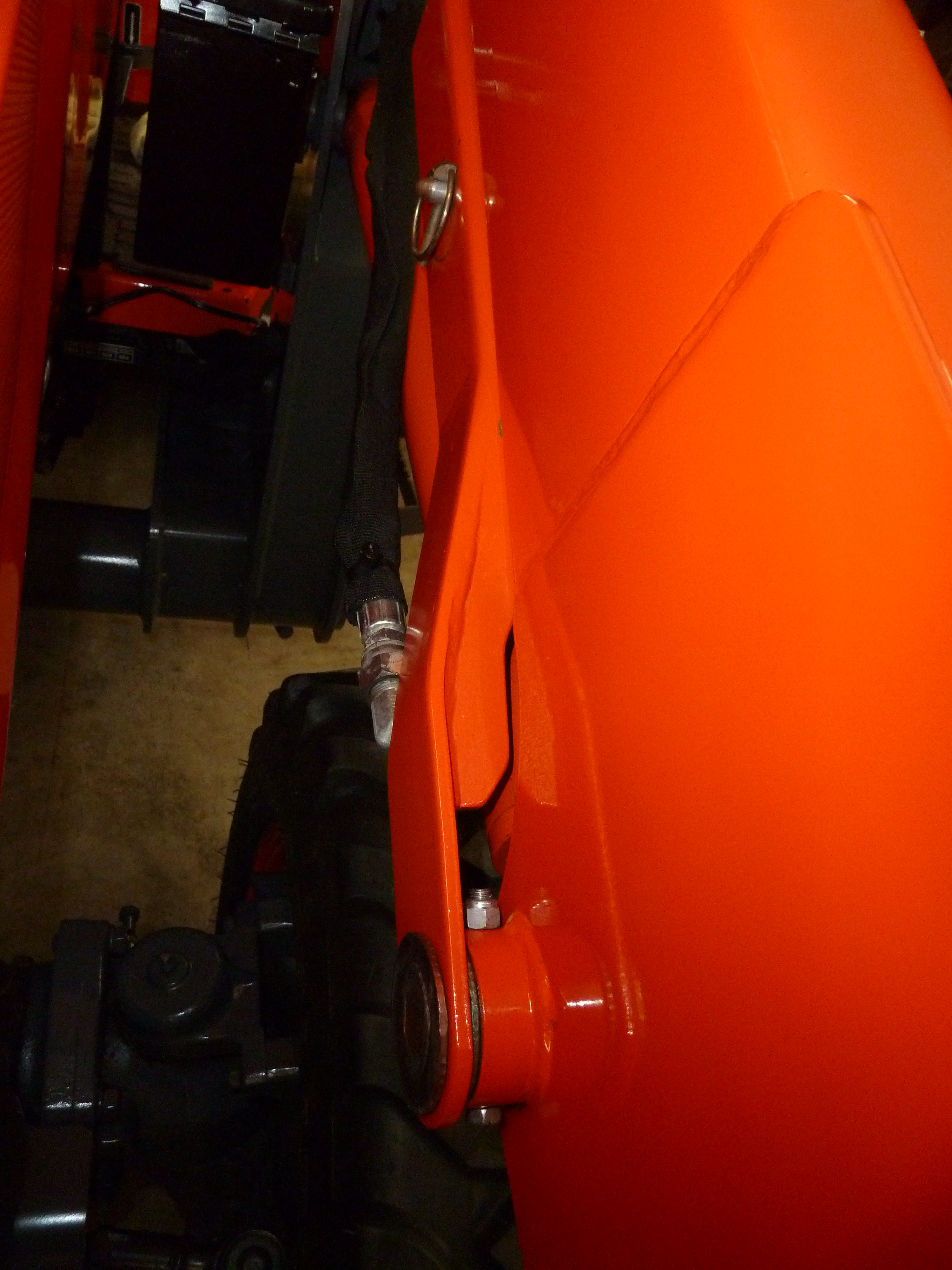

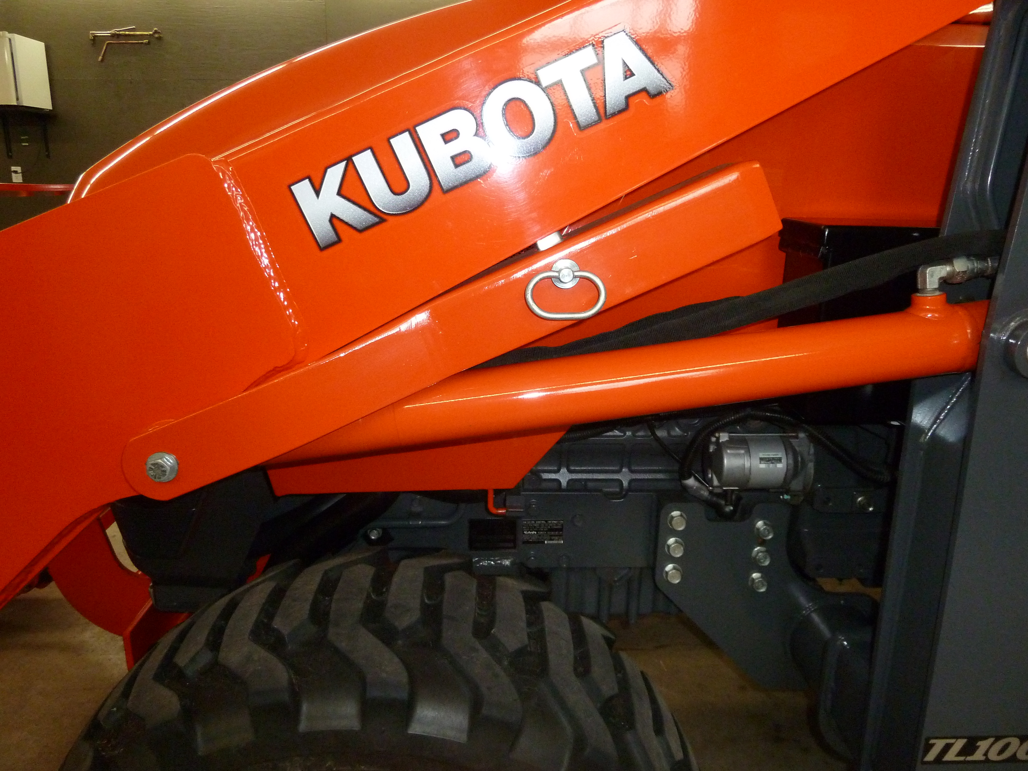

   / Upsized Hydraulic Clyinders for Loaders #23

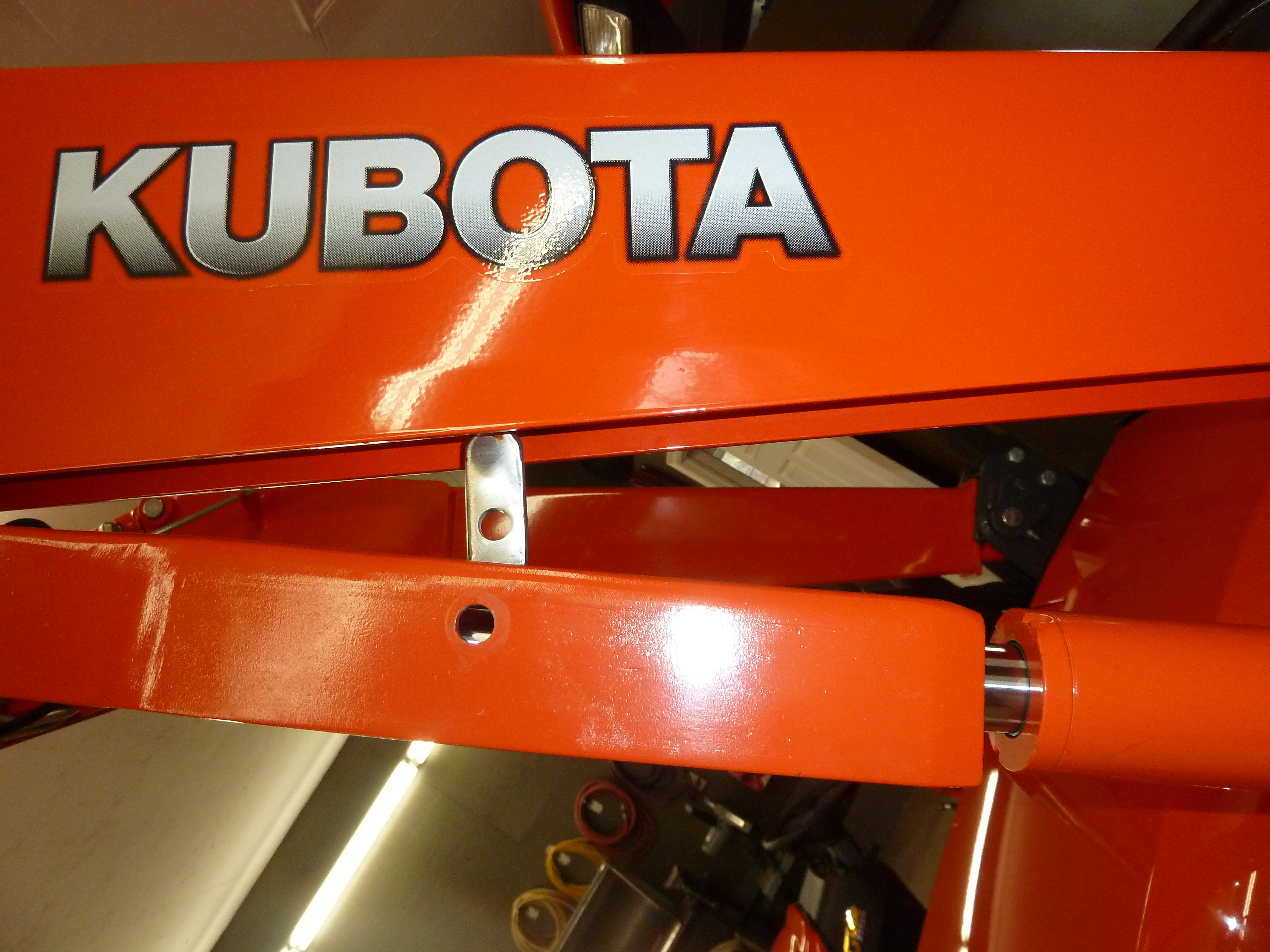

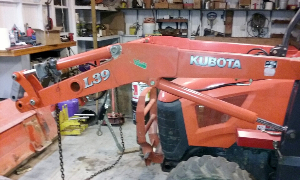

Here are some photos of the boom lock.The main part is made of 2 1/2 by 1/4 flat bar.The tolerances for this are quite tight and it took more time to make it than I anticipated.There is not a lot of room for error so that it doesn't bind throughout the full range of motion.If you want more info just let me know.

   / Upsized Hydraulic Clyinders for Loaders #25
Yes I agree however, I'm not using the Accumulator like you would in a large excavator., The one on the L39 has a 16 oz. working capacity just to reduce shock.
It's tucked away under the frame.
When the tractor was new I was robbing some gravel down the road, and while traveling back hit some potholes that caused such a pressure spike, ruined the quad seal rings on the main pump. It was covered under warrantee, as they may have not been installed correctly originally. I now drive slower and the tiny accumulator really helps.
I agree. The loader arms & pins, the hydraulics, and the tractor itself can probably stand a reasonable increase in cylinder size or pressure a lot easier than they can withstand the shock that comes from hitting a bump in the road at speed with a load in the bucket. An accumulator can help there, but slowing down works too.
Our construction JD 310 has the optional "easy ride" swith on the dashboard for transport with a full bucket. I haven't looked, but that option may be no more than a solenoid valve and an accumulator. Simply putting the solenoid valve in the fitting to the accumulator gives options for nearly no additonal cost or complexity. With the flip of a switch you can either have a time delay to spread out the shock - or not. Your choice.
Most large ag dealers can direct you to a local small shop that makes decent custom cylinders. They are pretty common in Ag country. Inexpensive and made to your specs. There's one within walking distance of the JD dealer right down the road.
luck, rScotty

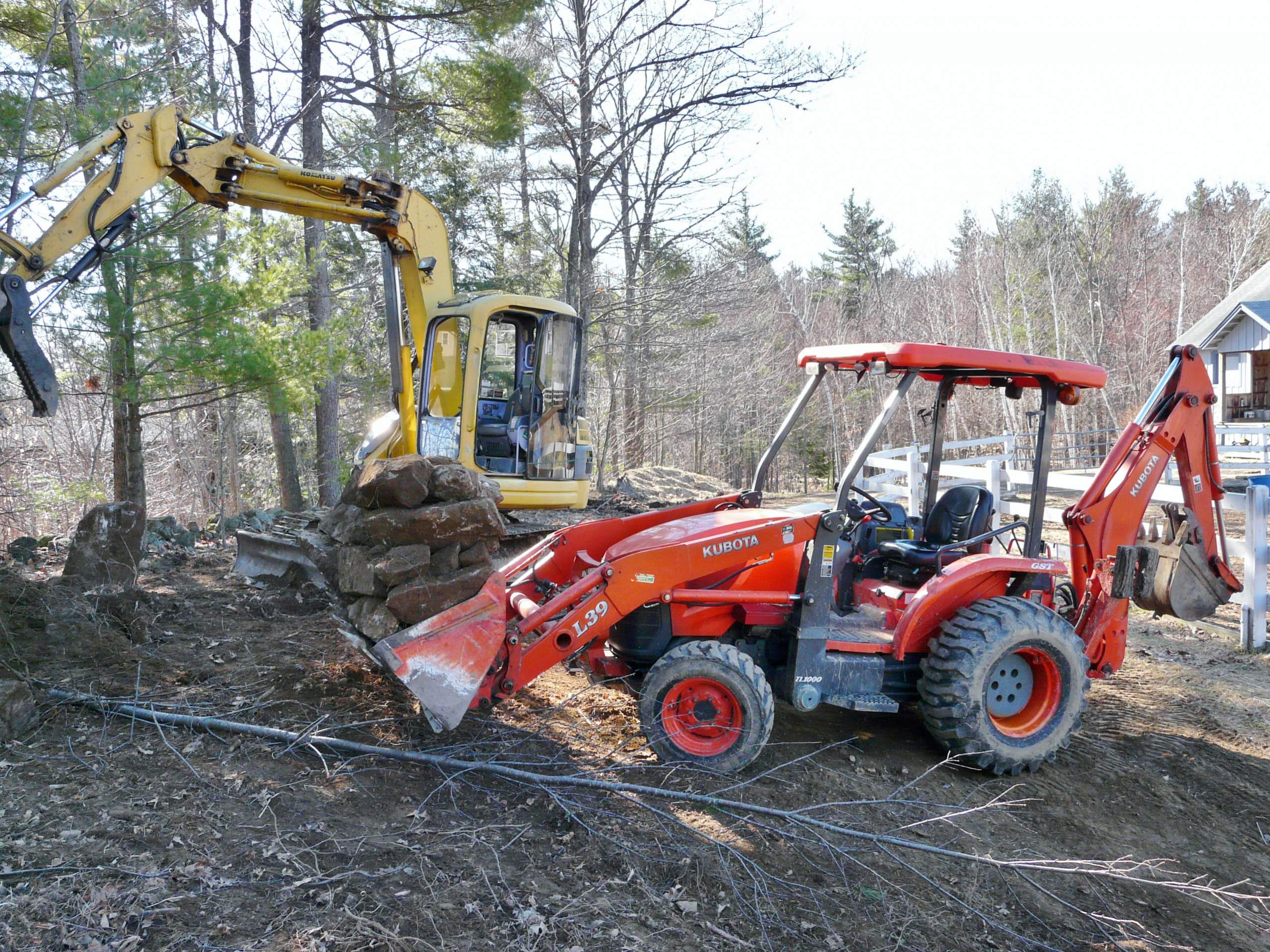

I have a price on 10 setes of loader lift and bucket cylinders custom made to fit the TL1000 Loader.
L39 Curl $400/Set of 2.
L39 Lift $440/Set of 2
Does not include shipping
I would suspect Kubota increased cylinder size even though increasing capacity would load up that fragile grand L front Axle, where the L45/L47 have up-rated axles. Unless the later L39 had their axles upgraded also?
Considering that Kubota prices for OEM Price for L39 Cylinders are:
Per Messicks
CYLINDER BOOM LIFT PN 7J800-63013 $661.89 ea.
Old style Curl CYLINDER BUCKET PN 7J800-64010 $575.56 ea.
New style Curl CYLINDER BUCKET PN 7J803-64010 $877.71 ea.
Per MB Tractor
The L45 TL-1000A2 & A@V & Cylinders are
CYLINDER,BOOM RH LIFT PN 7J803-63022 $944.95 ea.
CYLINDER,BOOM LH LIFT PN 7J803-63012 $944.95 ea.
Curl CYLINDER BUCKET PN 7J803-64010 7J803-64010 $873.35 ea.

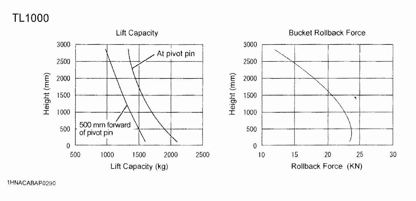

So it appears that Kubota is selling the larger L45 Cylinder as a replacement for the L39 original cylinder. This is same size as I was quoted.
The Price I recieved is a good price. My problem is I do not need 10 sets
I have to assume that the new curl cylinder bore is 65mm vs the 60 MM OEM original.

   / Upsized Hydraulic Clyinders for Loaders #28
Nice work, although I can't see from the photos how it pins into the "locked" position... Or is it held by compressive force?
rScotty
   / Upsized Hydraulic Clyinders for Loaders #29
It is held by compressive force.Although it will work with the bucket on I take it off first.It weighs about 600 pounds so it would add a lot of force to the lock.I thought about drilling it and using the retaining pin to act as a safety,when in the up position, but didn't feel it was necessary.
   / Upsized Hydraulic Clyinders for Loaders #30
If you ever want a more positive lock, there might just barely be enough room to drill both sides of the latch as shown. It makes a handy place for storing the pin when in the safety-locked mode.
rScotty

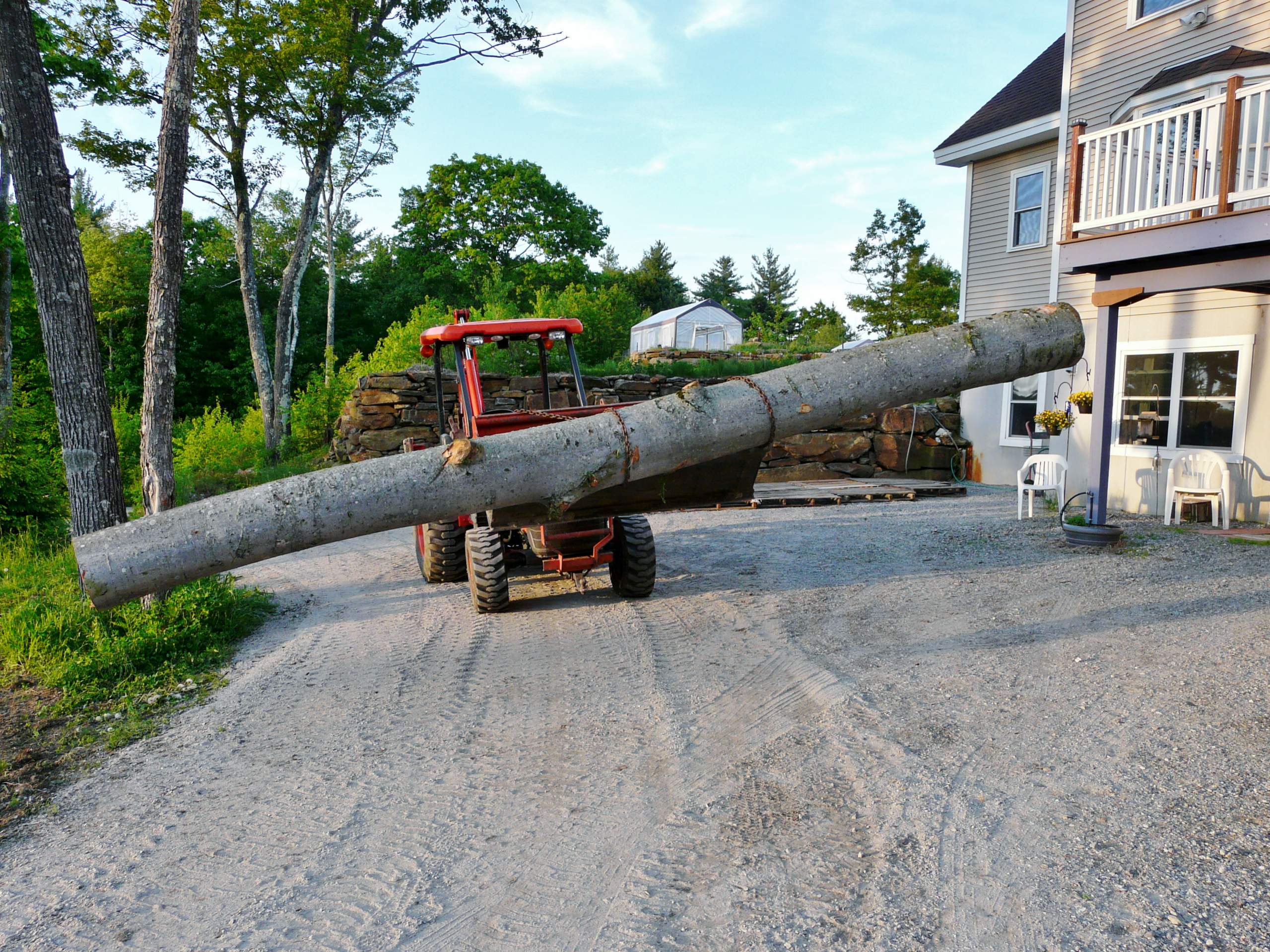

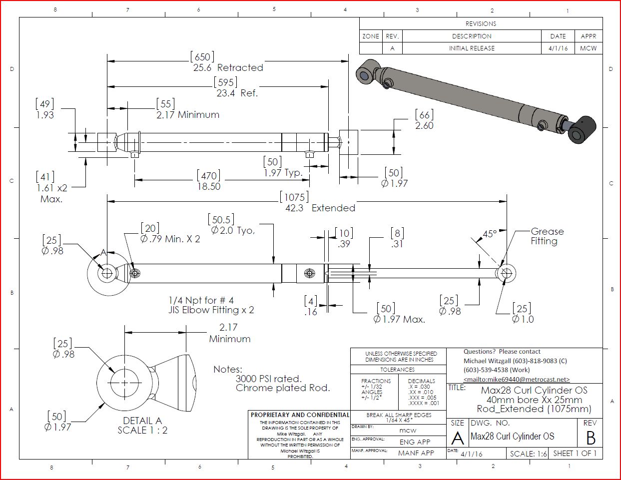

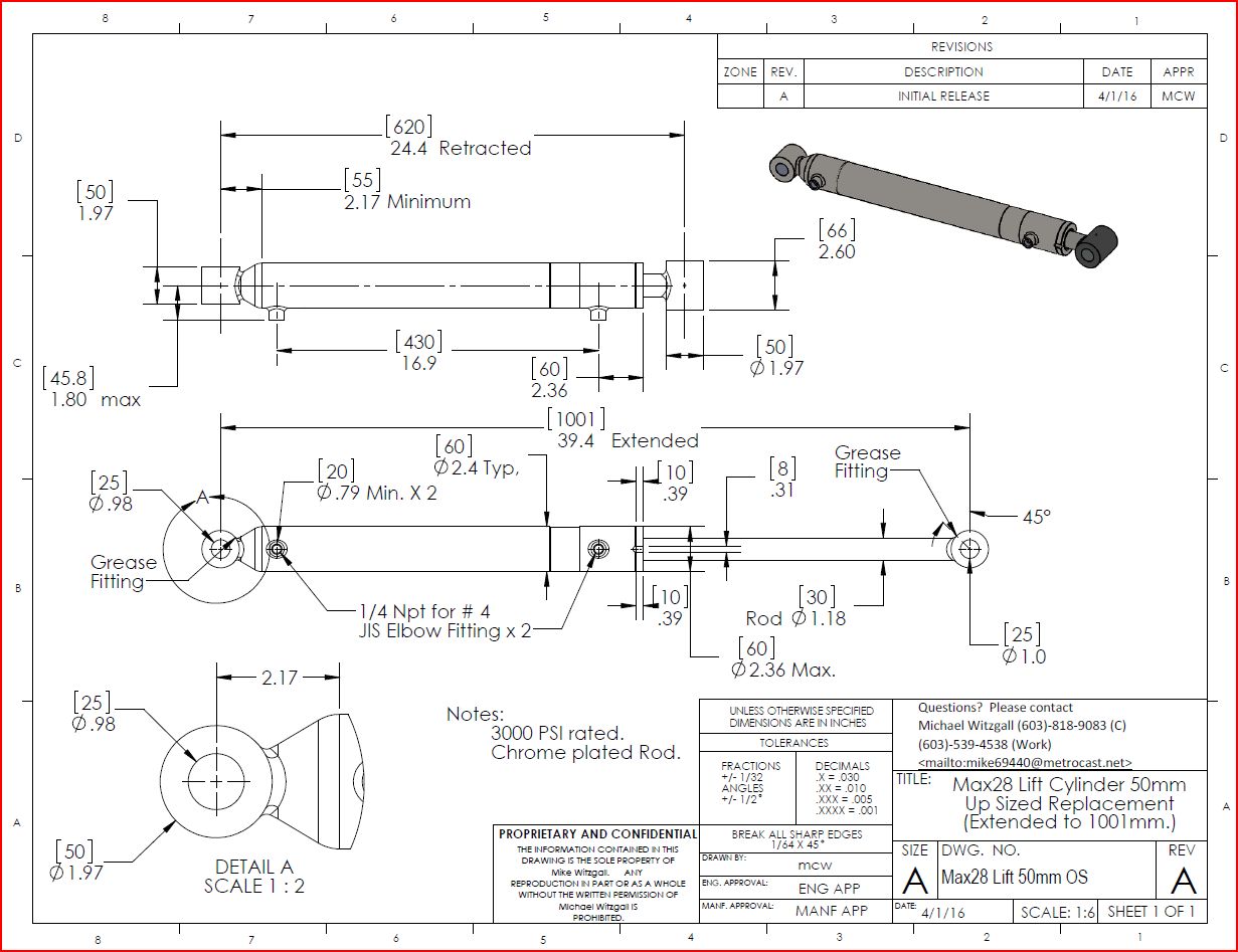

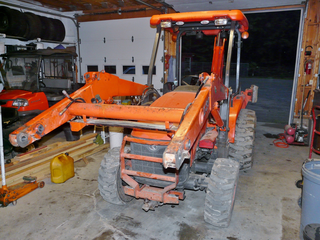

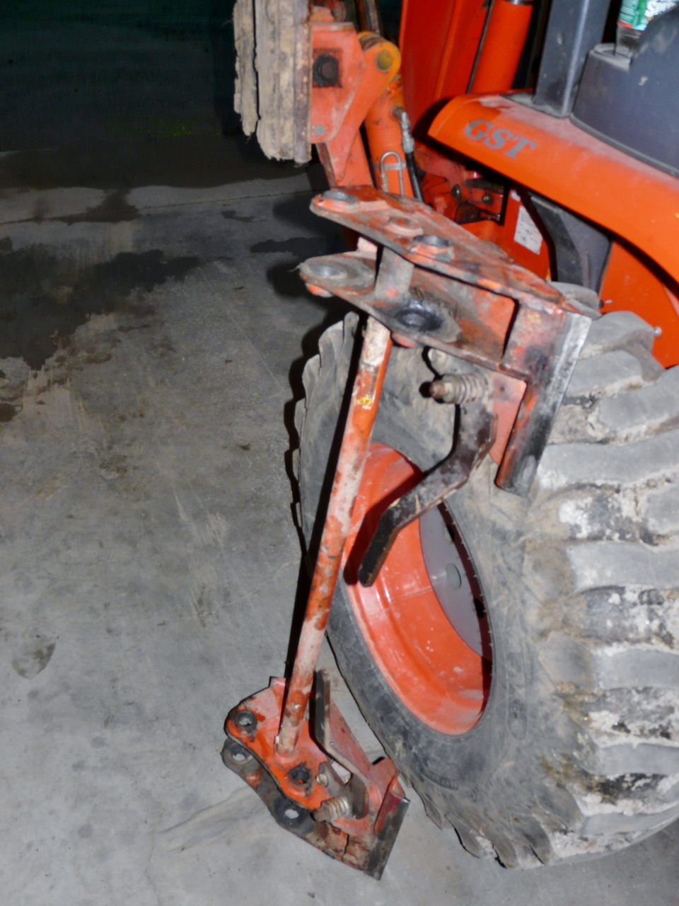

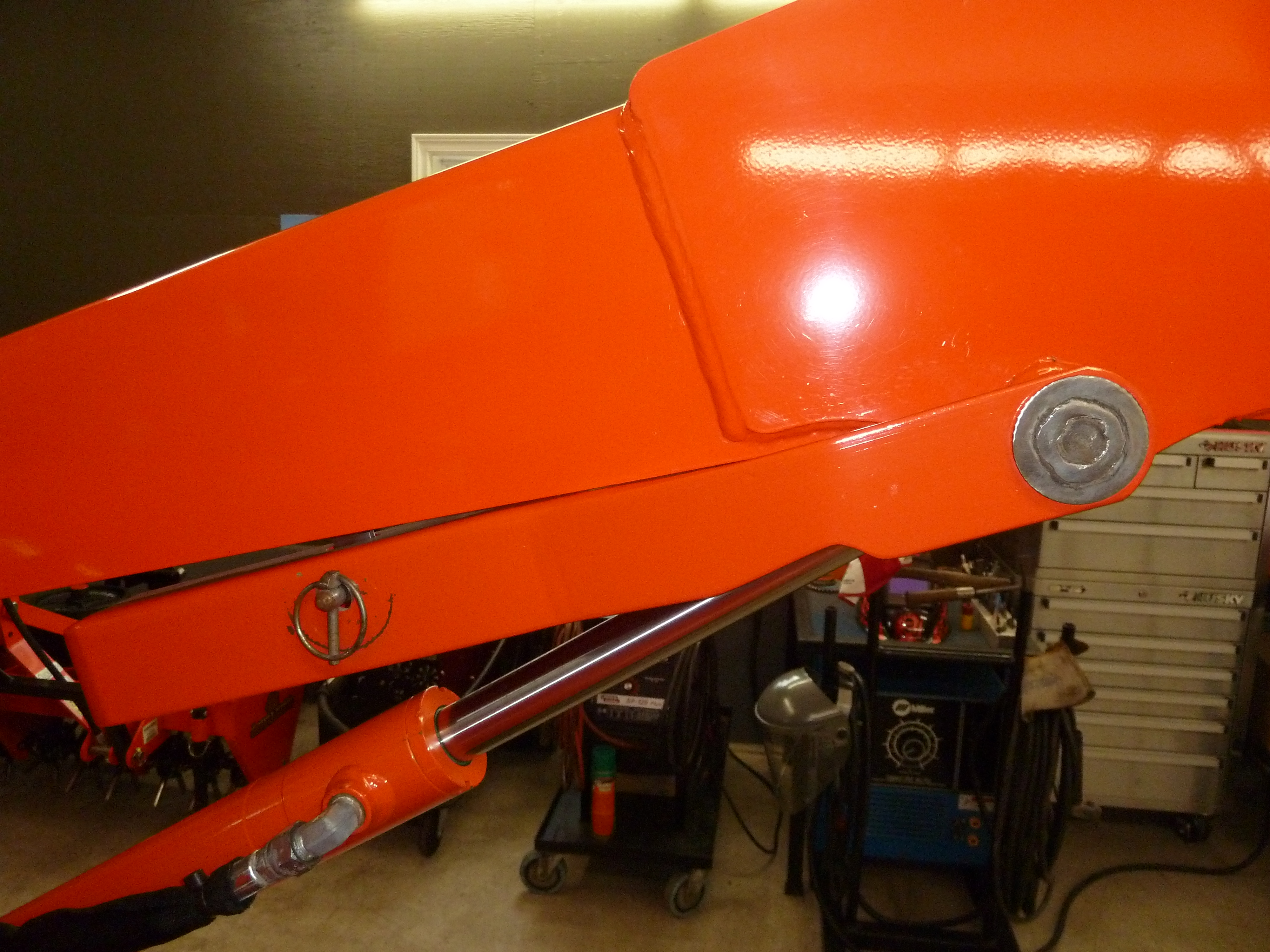

Update: Upsized Hydraulic Clyinders for Loaders, Started my L39 2000 Hr Hyd. Overhaul
I am having thw BT1000 Trunion Swing Cylinders rebuild, after sustaining piston damage in one swing cylinder.
I am using the guts from the loader curl cylinder and original rod from the lift cylinder to build a 60mm bore lift cylinder, upsized from the OEM 55 Mm bore. This alone will provide 19% more lift.
Factoring in I have the relieve set at a bit over 3000 Psig should give the lift capacity at ground level near 4,000 Lbs.

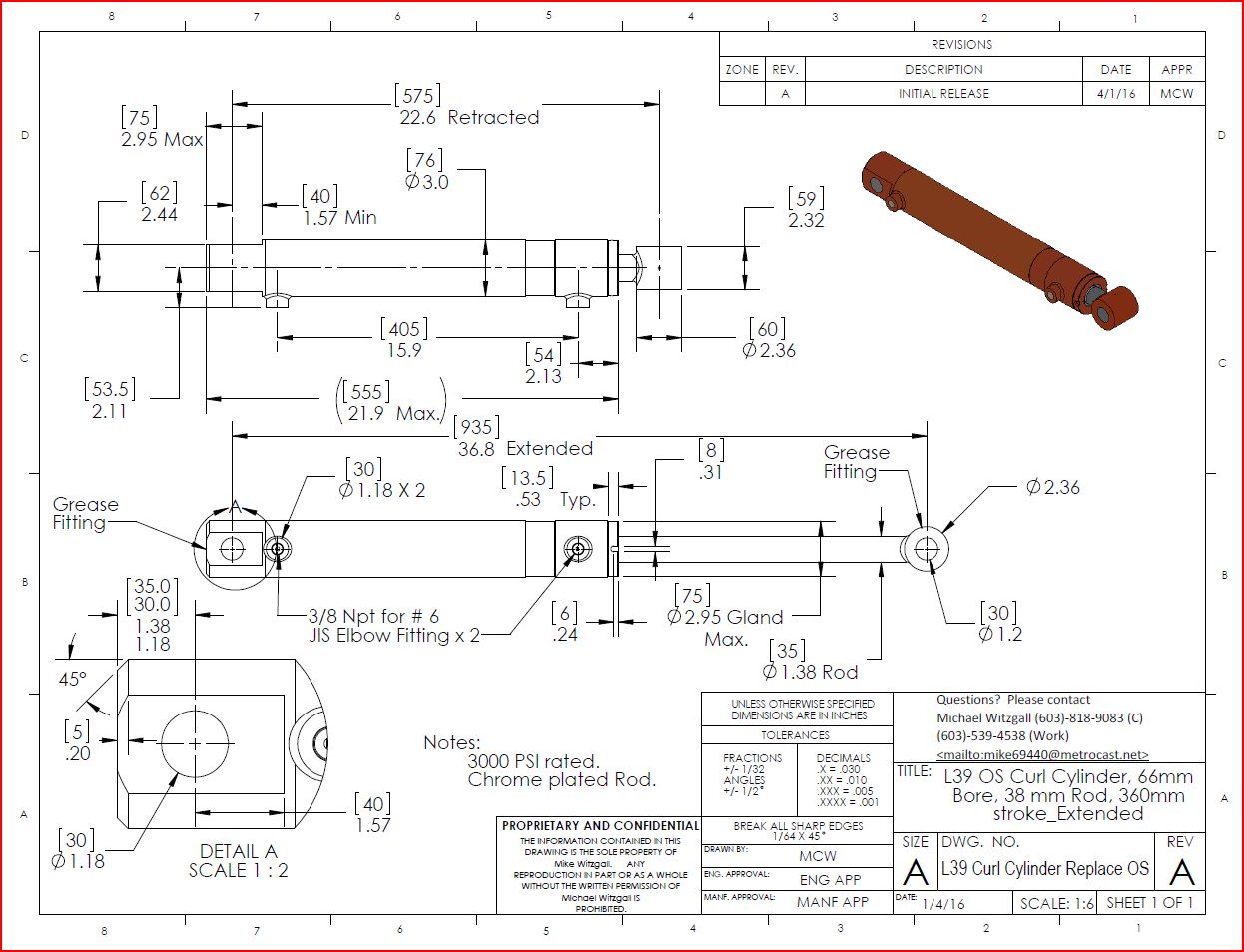

For the bucket curl cylinder I am importing from the UK a 66mm custom sized cylinder that will provide near 32% additional curl force.
If you think that is too much, note that I upgraded my Max 28 Mahindra curl cylinders with Mahindra curl cylinders form their 1526 tractor and gained 62% force. The bucket moves noticeably slower, but is not terribly slow. The Larger pump of the L39 will compensate a lot for the increased cylinder volume, as the loader on these commercial machines are relatively fast and strong compared to the general use farm tractors.
The L39 upgrade will also include new bushings and some new pins as well as some weld repair/reinforcement.
This is not going to be cheap, as the rebuild/upgrade turning out to be at least twice as costly as I anticipated, but I plan on keeping the machine for another 2000 hours.
Like i now operate the Mahindra, I'll do most of my L39 loader work in 2WD except in real slippery stuff to save the front axles drive components.
At +8,000 lbs operating weight, you will have trouble finding a tractor in it's size range anywhere as strong or capable.

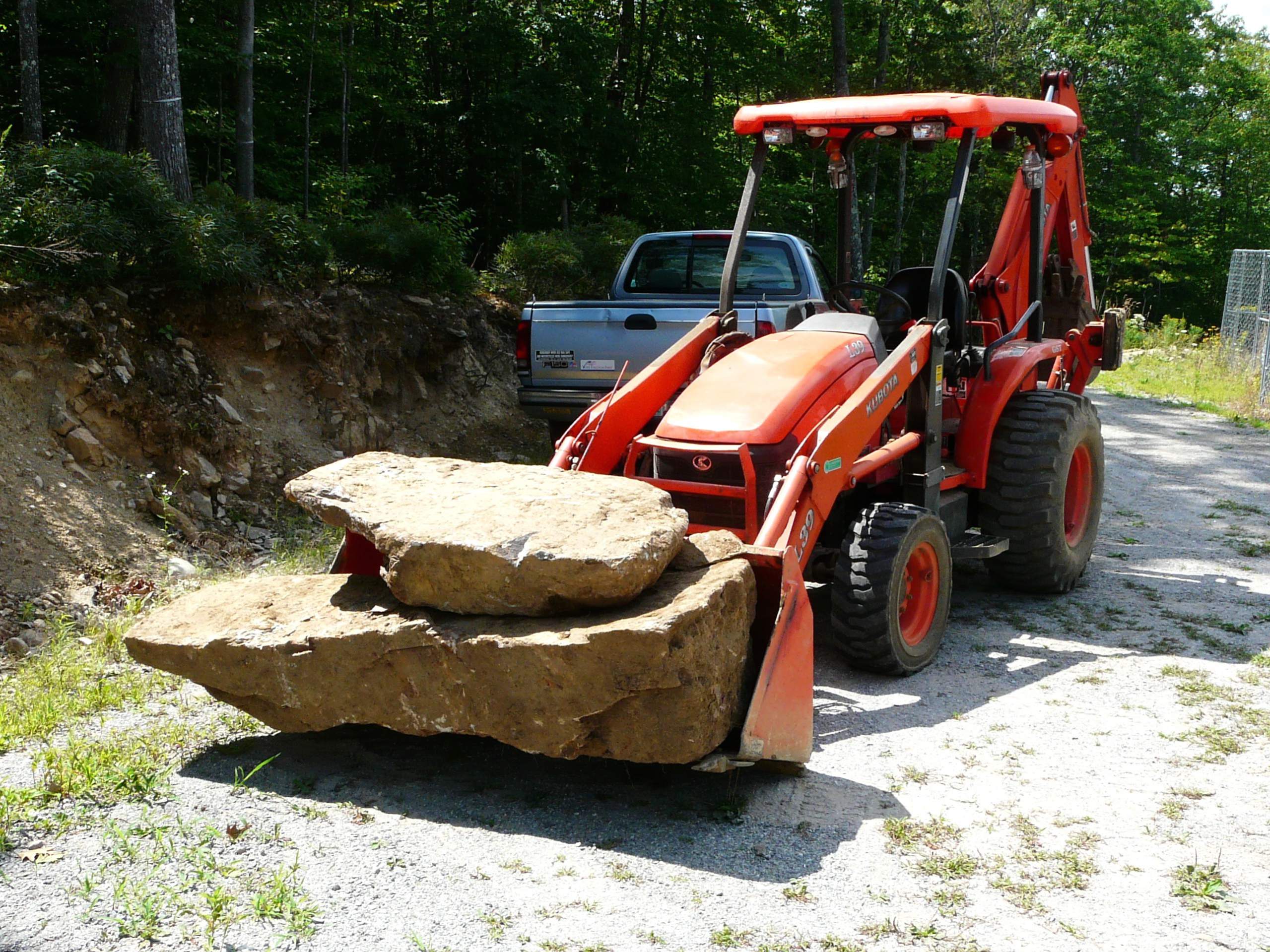

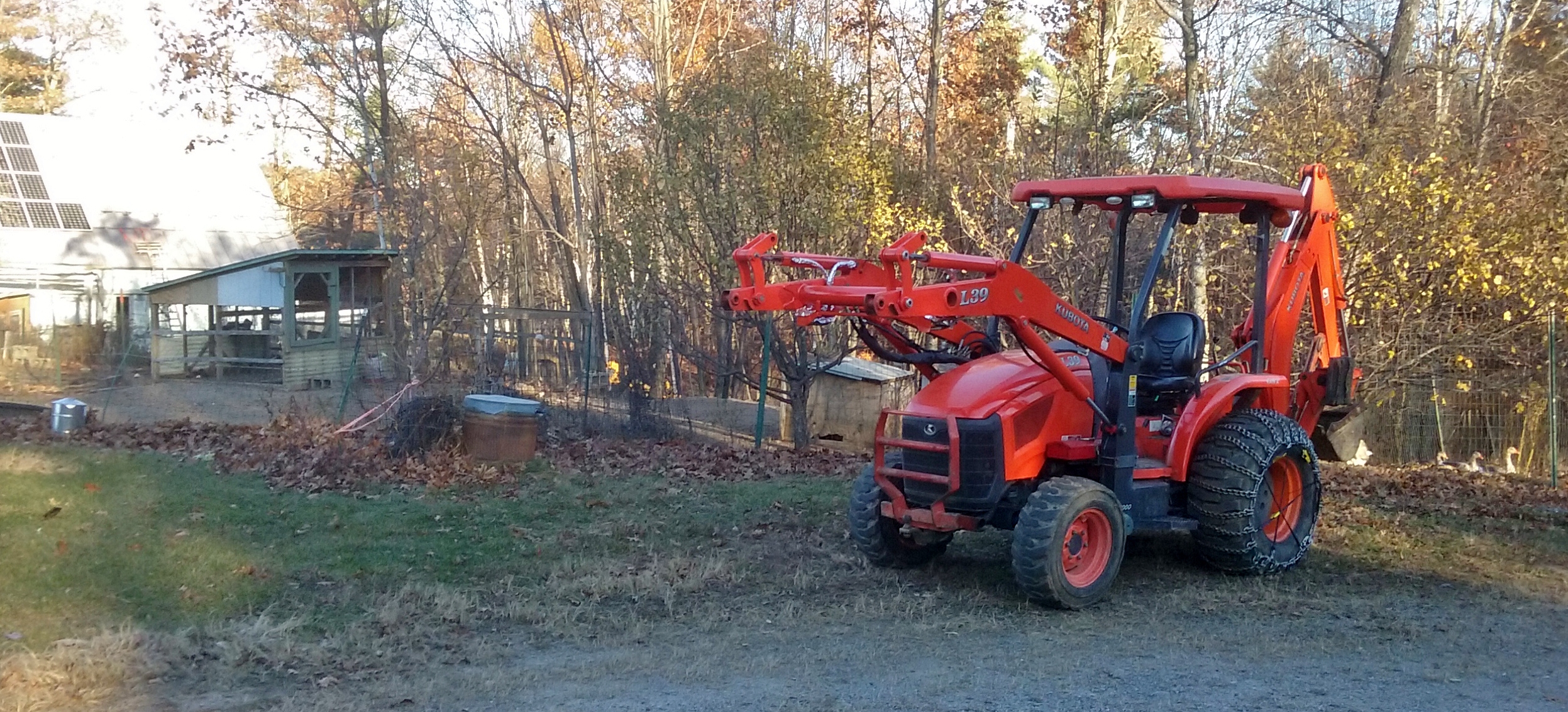

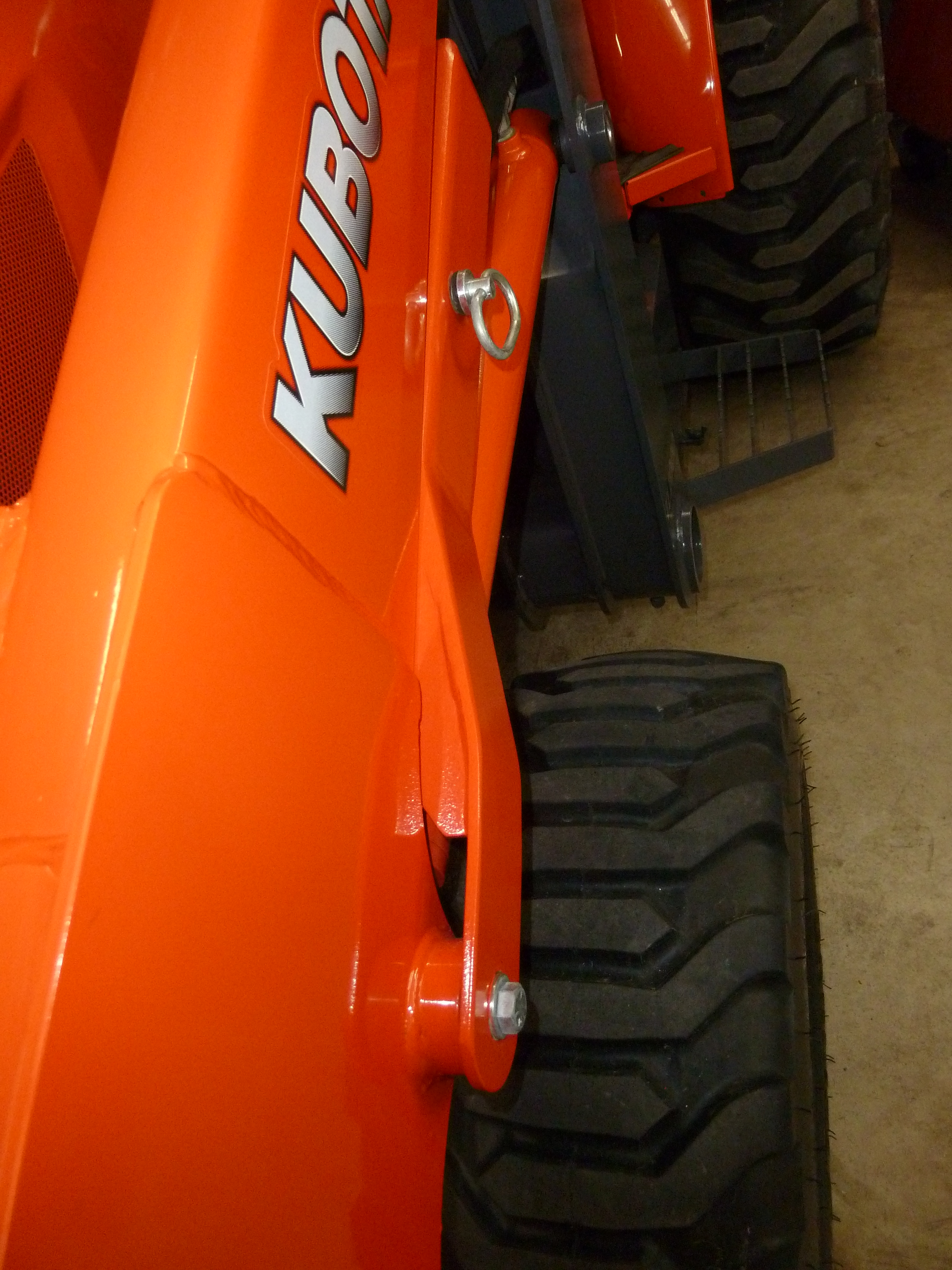

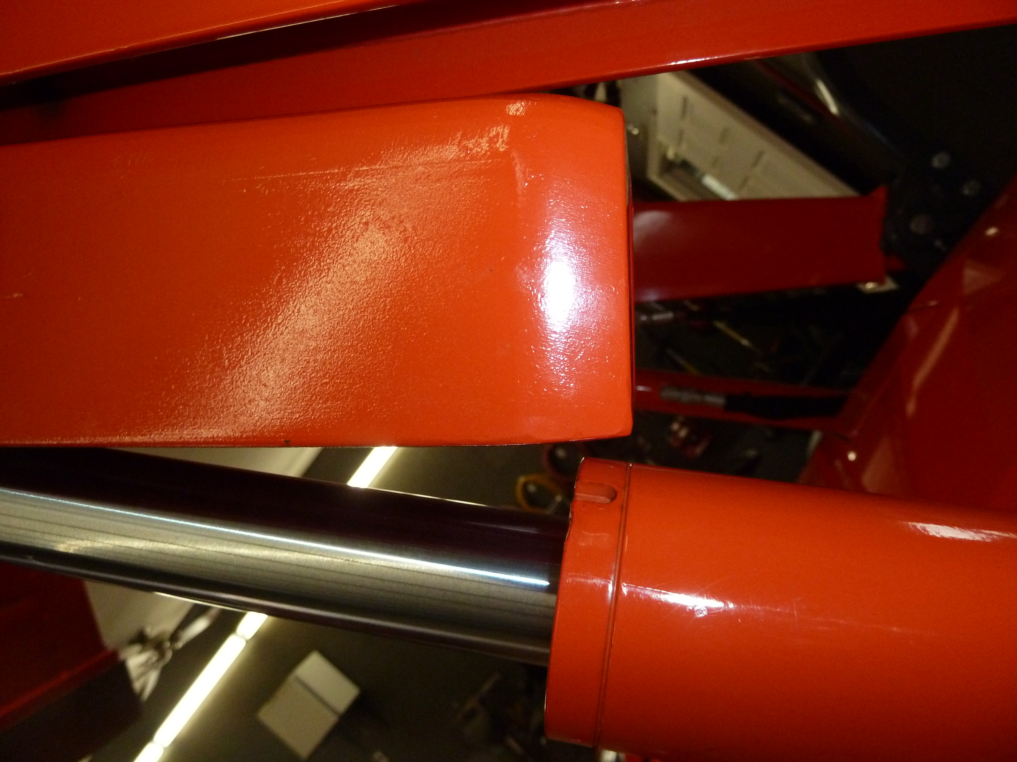

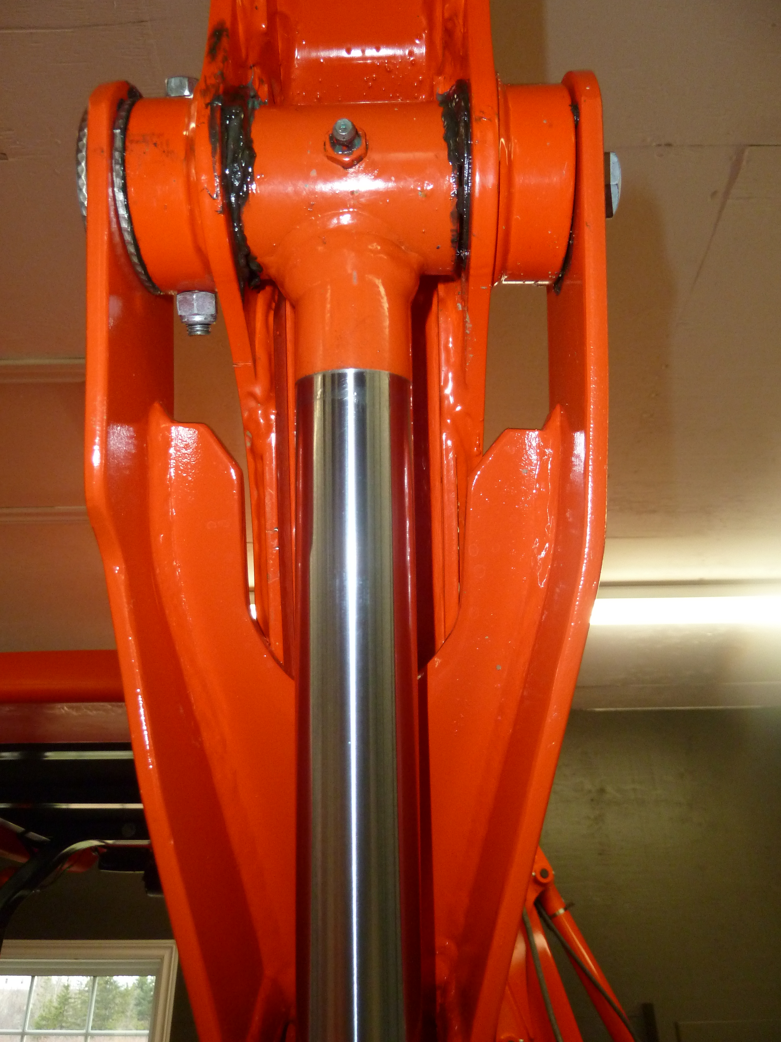

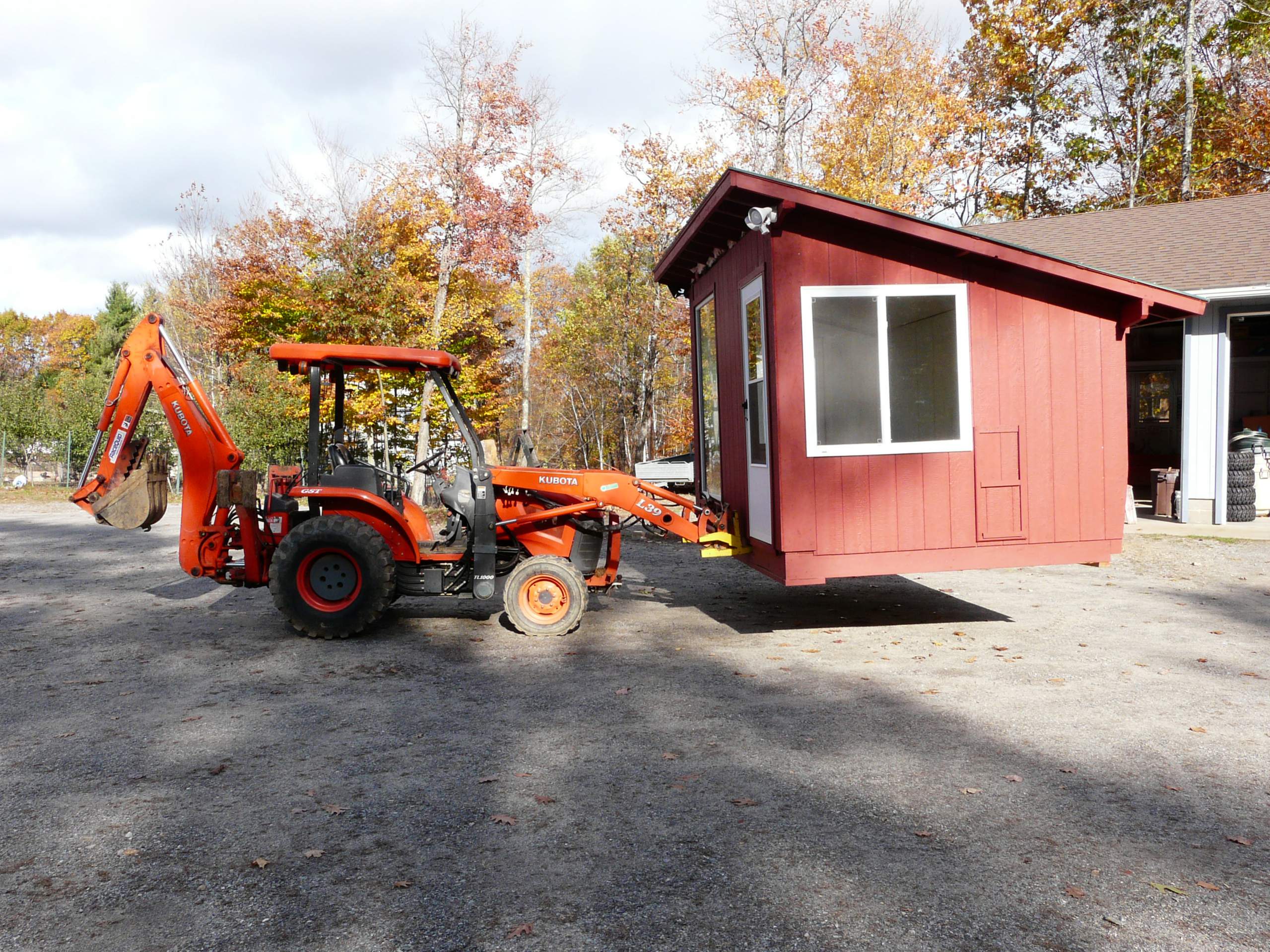

My up-sized Hydraulic cylinders for the Loader curl function are finally back from the shop.
The loader will be put together just in time to mount the Fisher plow. I might as well just put on the snow chains also.
I have the rebuilt BH swing cylinder and the up-sized 60mm Loader curl cylinders installed. Loader Lift OEM cylinders were 55 mm. Changing to 60mm increases hydraulic lift 19%
The 65mm up-sized from 60mm bucket curl cylinders will provide additional 26% curl force, handy for breaking out of a dirt pile. I have also set the hydraulic pressure a bit over 3000 psi. I'll keep it in 2wd, so not to over-stress the front axle while digging.
I've also up sized the bucket curl cylinders in my Mahindra Max28 and found it now digs better in 2WD than it did in 4WD with the OEM bucket cylinders. The Max28 has the loader capacity of a small l series Kubota.
The L39 should have the lift capacity of the old L48, maybe not an M59 , but close enough.

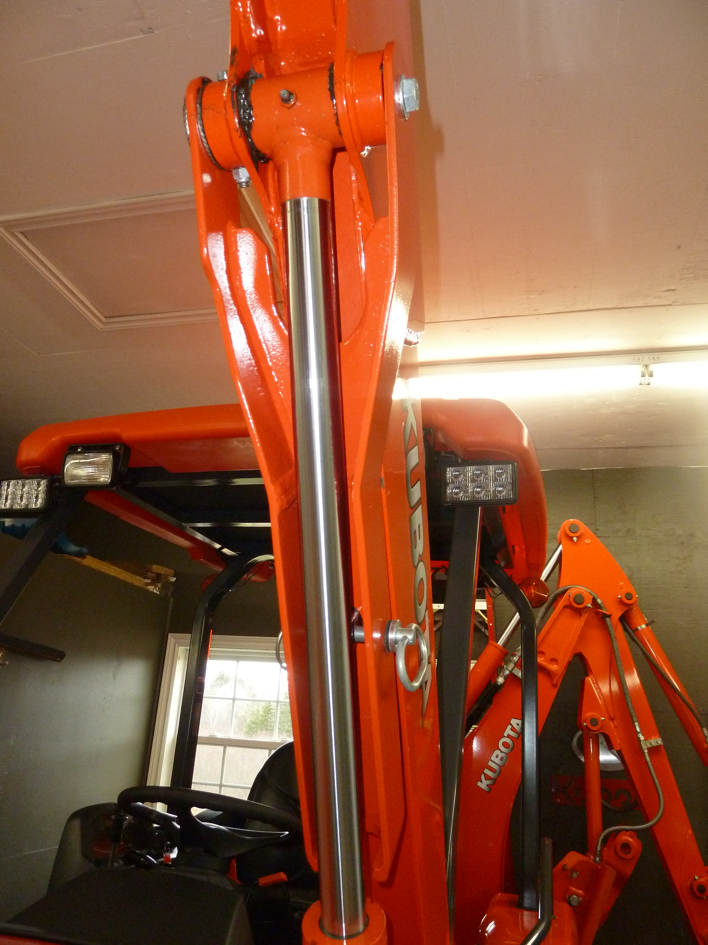

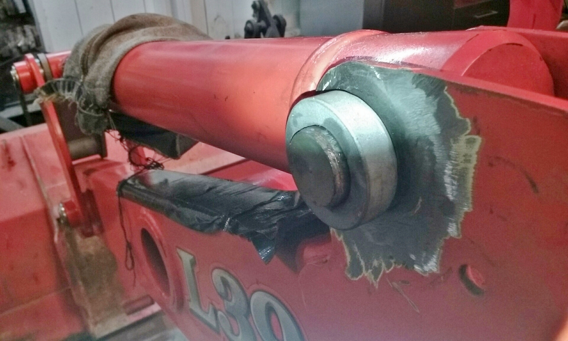

I noticed into a bit of a problem when I fitted the loader curl cylinders to the compensating links that go from the Rod end eyes to the QA.
Right side fit fine, but the let side cylinder angled to the left. I was going to give the cylinder shop an ear full, thinking that the pin ends were not bored square, but trying swapping the good fitting cylinder on the right to the left, same results?
Flipping the cylinder over same results.
Since new, the Kubota's boom loader pin holes were not aligned. The slop in the pin holes was allowing the loader to work all those years. So that explains the rub marks where the comp link and the QA touched. With the rebuild and tight fitting pins, I have a situation where the comp pink binds and puts side load on the cylinders piston rod. As this creates a situation that promotes rod buckling and premature seal failure i needed to fix it.
What a pain. I cut off the pin bushing on the loader boom, egged out the hole a bit wit a die grinder and used a come along to bend the other boom pin bracket. The shadow in the photo makes it look what I had to elongate more than it actually is. I removed less than 1/32" of metal.
Once I reweld the bushing, paint and assemble, I be ready to put the L39 back to work.

#37
Re: Up sized Hydraulic Cylinders for Loaders, Back together
Well, The L39 is finally back together. Loader bucket and QA is all bolted up and painted nice orange.
Maybe I should change the decal on the Loader to TL1300 now, as it actually will lift 1300 Kg. In my case the 1300 Kg rating is close to a true lift capacity 500mm forward of the pins, not at the pins., Naw, why brag.
I have a weeping hydraulic hose to replace, and out to change the engine oil before the snow hits. What a relief to get this over with!
Maybe I have time to do a little dirt work before I hang on the Snow plow.
During the loader rebuild I replaced some go the beat out loader bushings with 30 mm shaft collars from:
MISUMI USA Customer Service
MISUMI USA: Industrial Configurable Components Supply
e-mail: inquire@misumiusa.com
Phone: (800) 681-7475
FYI
One thing I found out the at the bucket dump circuit is always in regeneration mode. This is why the dump cycle is so fast.
The good thing about this is that regen discourages back dragging with the front edge of the bucket. Back dragging with the front edge of a bucket beats the crap out of your loaded. Don't ask how I know.
The bad part is if your stuck in mud, etc. the bucket does not have a lot of force to roll back and move you forward.
