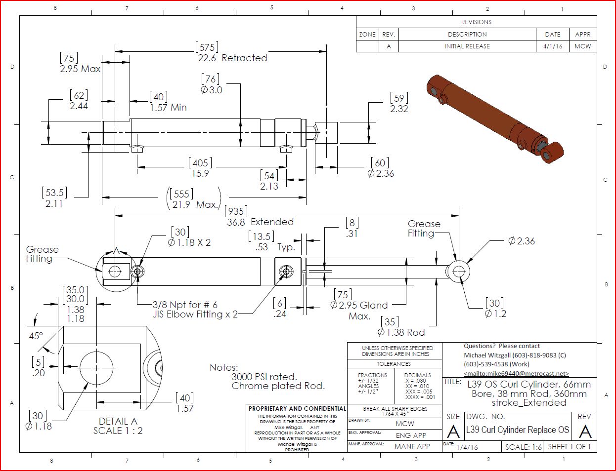

I'm looking a my options to obtain exact fit interchangeable up sized hydraulic cylinders for my tractor's loaders.
These will have to be custom built due to port location, that they are metric sized, and have non standard weird piston stroke and retracted lengths, as well as having metric pin bores.
The replacement DA Hydraulic Cylinders need to be 3000 # welded cylinders.
I have my two tractors that primarily want to increase the curl force on the attachment (Bucket attachment) cylinders. I would not mind also boosting the Lift a bit also.
Attached ismy spreadsheet on the info for the OEM cylinders and the up-rated version, just as an example.
I'm making CAD models and details dimension prints also.
I have a few leads as to where I can source these, but want to first get an idea of the potetial quantity.
PM me if interested in doing a group buy or you just want a copy of the worksheet in Excel format.

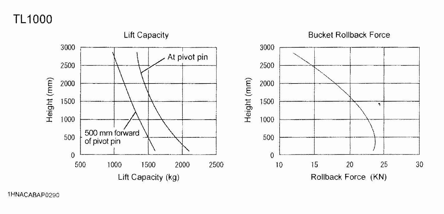

Lauren may have his pressures set low, as mine were from the factory. If he has increased his lift capacity 50%, that is over 4000Lbs!. See the attached loader curve Lift graphs from my manual.
The OEM stock lift capacity IS quite a bit more at mid lift than full height. Plus 2 ton lift ability is too much for the L39/L45. Even Lauren's foamed tires and cab will not keep weight on rears.
I'd be completely happy with another 15-20% extra lift. Even with that I'll be grabbing a boulder with the BH thumb for safety.
The Curl is the L39 weak point, designed that way to protect the front Axle. As long as I'm careful, I think I'll get away with boosting the Curl 35-35%.

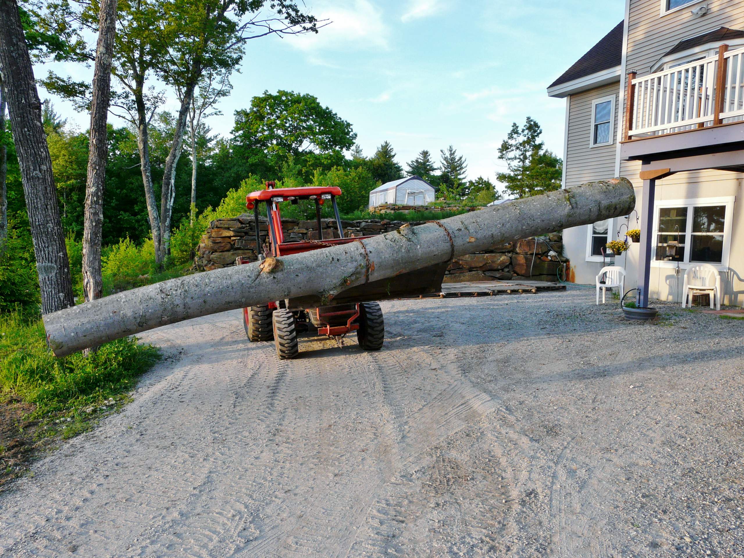

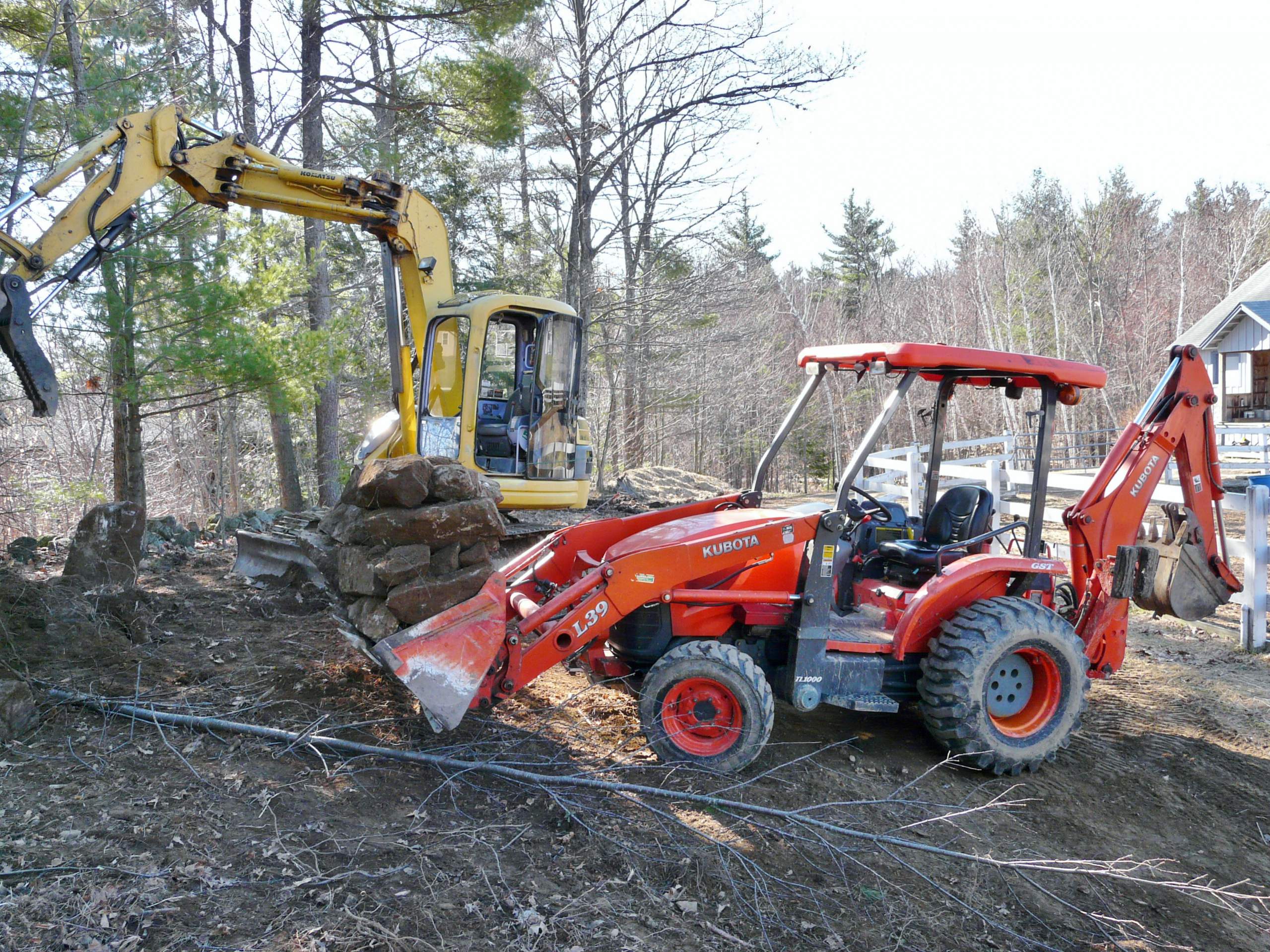

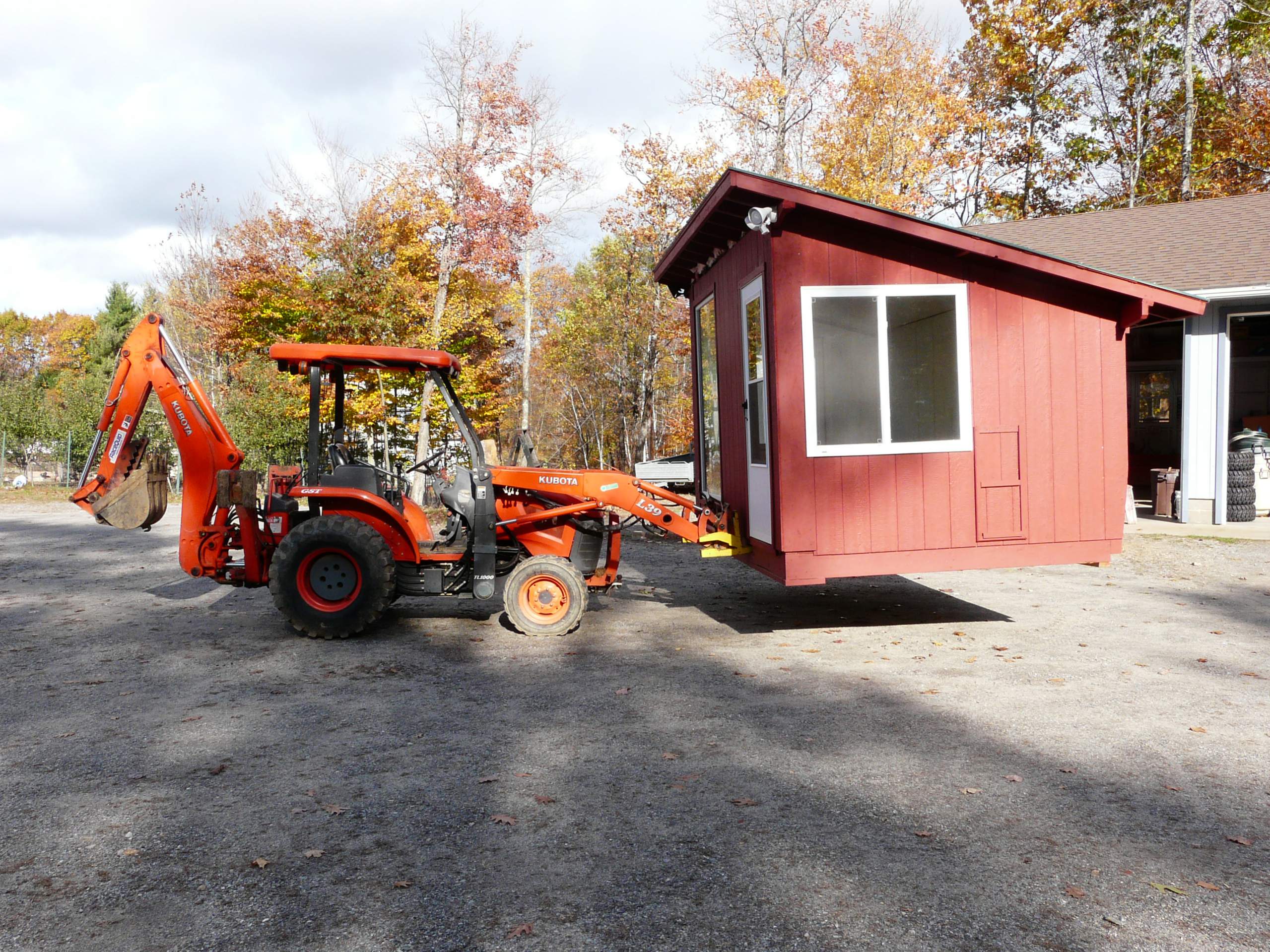

Carefully moving heavy pallets and rocks with my pallet forks is where I want the extra curl and lift as from the photo's below, execpt in hard digging, the L39 is adequate. I try to be as gentle a front axle abuser as possible.
Attacthed are my resized cylinder drawings.
