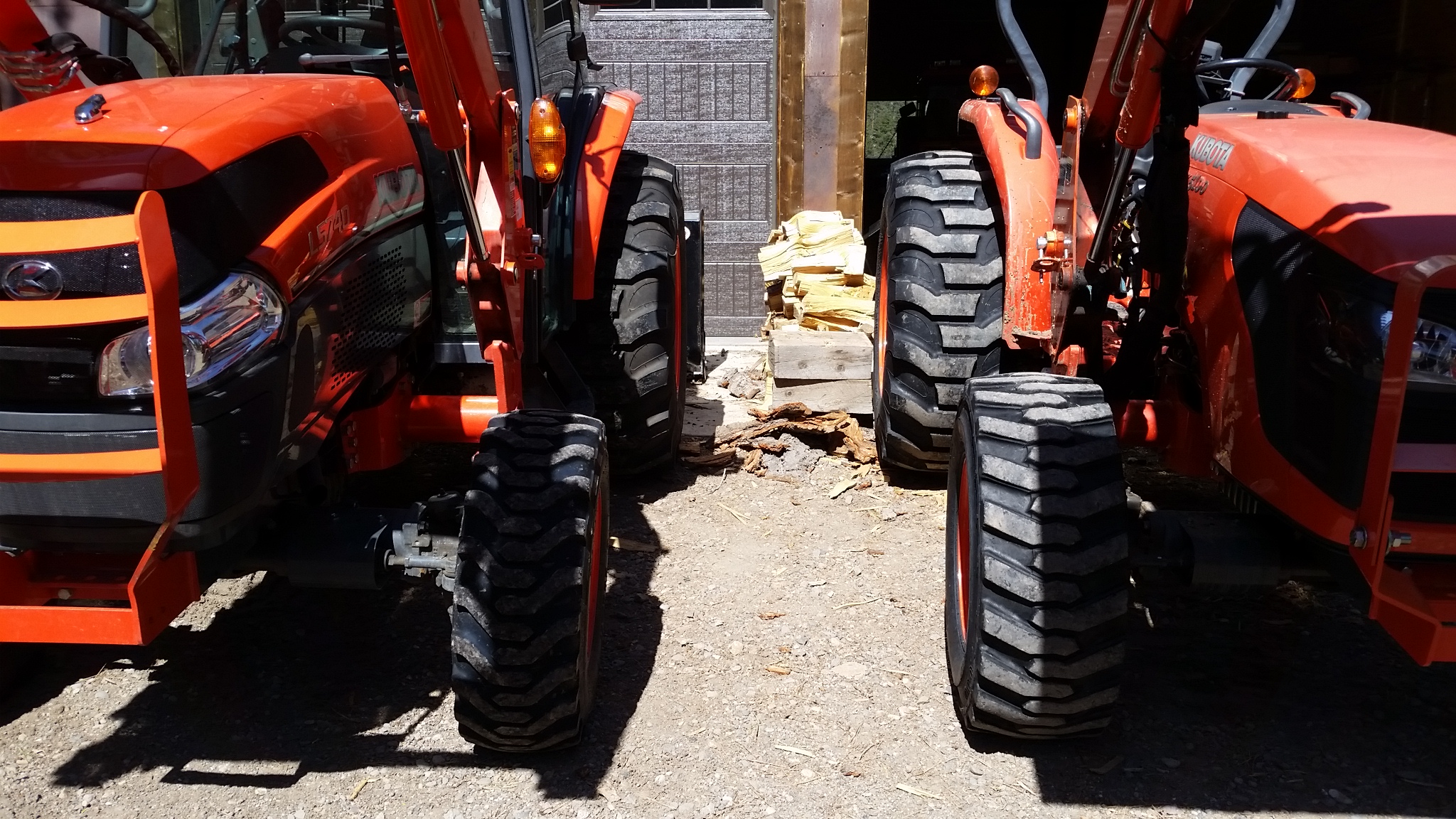

The MX5100 actually have a different ratio in the front diff and the side gears. The rear end on them is based on the older L4610 design without the external lift cylinders that have a different rear ratio and lead/lag mechanical ratio.
Never understood why L series used the smaller R-4 size. My MX 5100 is comparable in size and 12 x 16.5 is the standard R-4 front tire. The footprint of the 10" width would seem to exert excessive ground pressure on improved landscape surfaces, especially in using the FEL, loaded to capacity. Shortsighted thinking on Kubota's part ?. Other manufactures of this
size tractor seem to employee the 12" R-4. (Mahindra, an example) The L series rear tire sizes on L and MX are the same for Industrial Tires.

L5740 and MX5100 front tires.

not trying to be negative on the MX, I like them. The front axles are 90% the same as the L30 except a few gears. This means they have the good steering and top bolster on the knuckle.
The rear end design is the older type series without the external lift cylinders. The Grand L10 series had a split where the L4610 got the new style front end that later Grand L and MX inherited. The L4610 also retained planetary gears of the older L while the L30 went to cheaper spur gear design that fit the lift cylinders better.
So the MX has better front axle, and retains strong planetary rear, just doesn稚 have the 3 point lift numbers the external cylinders provide.

The original rims work fine.
The R4’s I swapped to are 16.5-12 not 12.5’s.

Last update, take a look at the R1 tire options on the MX5100 vs the L5030 or 40 series. They run the same 9.5x16 and 14.9x26 or 13.6x28 rears. The R4 option bumps the fronts to 12x16.5 on the MX5100 where it didn’t on the L5030.

EPIC FAIL! I upsized from the 10-16.5 to 12-16.5. Common sense should have prevailed but stupidity got the best of me but I guess :confused3: I was too busy wasting $$$ and time. Installed the 12’s put it in 4wd on loose dirt and absolutely not good! Just ordered the 10-16.5’s. Let me know if anyone needs a new set of 12’s :thumbdown:
