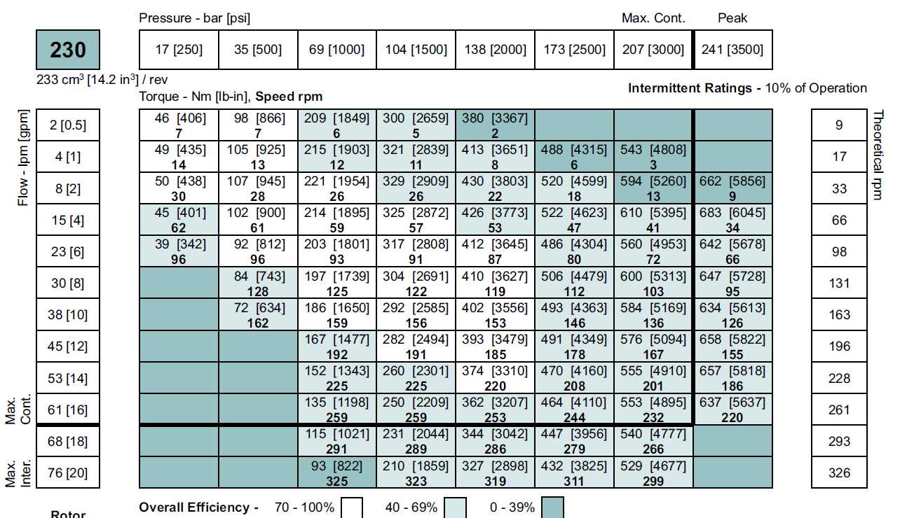

I'm about to upgrade my White 14.2ci wheel motors with White 21.2ci (or bigger) motors. Any way to easily figure out the speed changes? The current motors are very fast. I'd guess 10 MPH. The tractor is faster than my 1845 and I have larger than normal tires on that tractor. I'd rather have more torque due to some hills on my property. Beside, with no suspension, I don't like going over 6 MPH anyway.
Having been there, done that, the short answer is "NO" to the "easy" part. With a variable displacement pump, the inherent loss of efficiency in hydraulic systems, etc. -- all you can end up with it theoretical numbers.
However, the White catalogs list the specs for each size motor in a series separately, with a table for different flow rates (volume) and PSI. So, you can compare the specs, side by side, at different pressure and flow ratings. I built a spreadsheet that compared the numbers for the specific size motors I was looking at, using the data from those tables. Disregard any numbers above 2500 PSI (max limit for these PT designs, AFAIK), and about 12 GPM (though I'm not sure what the theoretical max for this tram pump is). Then you could use tire circumference to calculate the theoretical MPH. Since we're dealing with theoretical numbers, it is essentially a direct relationship. Twice the displacement yields twice the torque, and 1/2 the RPM (speed).
From practical experience in having done this twice now, and seat-of-the-pants observations, the CE-series 22.8ci would be a good choice to meet your stated requirements, if you plan on staying with the stock 23x10.50x12 tires. I ran CharLynn S-series motors about that size for a while -- though I don't recommend them for this conversion because the taper on their tapered shafts does NOT match the taper on the PT hubs. I couldn't keep the hubs tight, and wallowed them out -- they're very soft metal.
I'm now running White RE-series 28.3ci BUT I also went to 26x12x12 tires. Even with the taller tires it is SLOW (slower than your stated goal) but has more torque that the 425's design limits -- I've bent QA hitches, lift arms, etc. I have to be careful not to break things, and still find the weak points in the PT's design. So far, I love the torque on my steep hillsides, though, and have found the speed "fast enough" even if I am mowing at full treadle on the few flat spots I have.
As I said, I'd recommend the 22.8 size -- then you could go to taller tires if you wanted more speed...
BTW, my only complaint with the RE series wheel motors is that I have now blown the seals on each of the rear wheel motors. The first one went at about 250-300 hours of abuse, and simply ordered another wheel motor from Surplus Center to have a spare. The second one went yesterday, and I just ordered two seal kits. I'll have one put in the wheel motor I replace initially, then have to second one installed in the motor that just blew, so I'll have a ready spare next time...Surplus Center no longer has the REs in this size in stock (sold out, I guess) but at $179 each (with hubs) or $169 each (without hubs) they were a bargain while they lasted....

Let's go through a few numbers. The Bondioli and Pavesi NT 10 pump comes in two flavors, 14 cu cm and 19 cu cm. So, at 3600 RPM, that's ether 13.31 GPM or 18.07 GPM. The rated pressure of the pump is 175 bar, or about 2500 PSI. Using rule of thumb calculators, 13.31 GPM at 2500 PSI would require 23.29 HP. The same calculation for 18.07 GPM would require 31.62 HP. Therefore, if I were guess, I'd bet the PT-425 uses the 14 cu cm pump and the PT-1430 uses the 19 cu cm pump (assuming it uses the B&P NT 10).
Now that we have some numbers, let's look at the White brochure. The "230" motor can take up to 3000 PSI continuous. However, just driving around with no load wouldn't require much pressure. Since White rates the RPM by pressure and GPM, we have to pick something. For conversation purposes, I selected an RPM of 60, assuming 15 GPM. Doing a little math, this results in a 4.1 MPH speed. Far slower than the 8 MPH advertised or my seat of the pants estimate. Doing the same math for your tractor, I get 2.3 MPH using a 26" tire. My guess is these number are off by 50%. Maybe something to do with the way they are plumbed in series. If so, my tractor speed would indeed be about 8 MPH and your current speed would be about 4.6 MPH, or a "speed walking" pace.

I think you're correct with the 14cc size assumption on the tram pump. I agree that theoretically, it could pump 13.31 GPM, requiring 23.29HP. However, that 25HP engine (at 3600 RPM) is also spinning the pump for the lift arms/tilt/steering circuit at all times, in addition to the PTO pump. Even if there is no added load on either of those hydraulic circuits (not steering, lift arms at rest, and the PTO not engaged -- those pumps are still pumping oil, even if that oil is simply returning to the tank. So, I don't think you EVER have 23.29HP going to the tram pump. How much less depends on how the other two circuits are being used....
Now, let's look at how pressure/flow relates to the tram circuits themselves. There are TWO circuits, with TWO motors in each one. So, that volume is split in half, with half available to each circuit. Pressure is the same across both circuits, but the front wheelmotor will "consume" half that pressure while the rear wheelmotor will "consume" the other half. In a "no added load" situation, with the PT up on jackstands and only turning the wheels, you could likely get somewhere around 12GPM, perhaps a bit more, flowing through the tram circuits (why I suggested disregarding anything above 12 GPM in my first post) with the remainder of the engine power going to the other two pumps.
At 12GPM, according to the specs, a 230 wheel motor would turns 192 RPM, at 1000 PSI. But, that doesn't happen -- half the flow (6 GPM) is going to one wheel motor circuit, half (6 GPM) to the other. According to the chart, at 6 GPM the wheelmotors would turn 96 RPM at either 250 or 500 PSI pressure. It likely would take somewhere close to 500 PSI to get the PT moving if not on jackstands (automatic hydraulic brakes often require about 400 PSI to release, as an a example, and allow the motors to start turning). So, at 12GPM from the pump (6 GPM to each wheel motor) you'd be turning 96 RPM -- or about 6.3 MPH with 23" tall tires, according to my conversions.
You may actually be able to get more than 12GPM flowing the tram pump, closer to 14 (the next table value) in no-load/no-added-load conditions, before you run out of engine HP, but since the table does not show 7 GPM (half of 14), it is hard to make any higher conversion or calculations...
Bottom line -- I think your interpretations are pretty solid -- but you haven't considered that the GPM must be evenly split across the two tram circuits... and there's no need to add any "fudge factor adjustments"... I think the numbers are pretty accurate, just a bit difficult to interpret.

In my analysis above, I made two errors. I misread the chart and originally used liters per minute instead of GPM (oops). And I didn't consider the flow split between the two circuits. After those corrections, I get about 7.7 MPH for the standard 230 motor and 4.5 MPH for the 375 motor. So, the 375 looks like a decent compromise, as you suggest.
Now, on to the motor mounts. I can fabricate some type of spacer, or have a welder lengthen the boxes. The 375 motor is only .57" longer than the 230. But I'm a little worried about using a spacer. I'm afraid it could get lose and "wobble" over time, causing problems.
