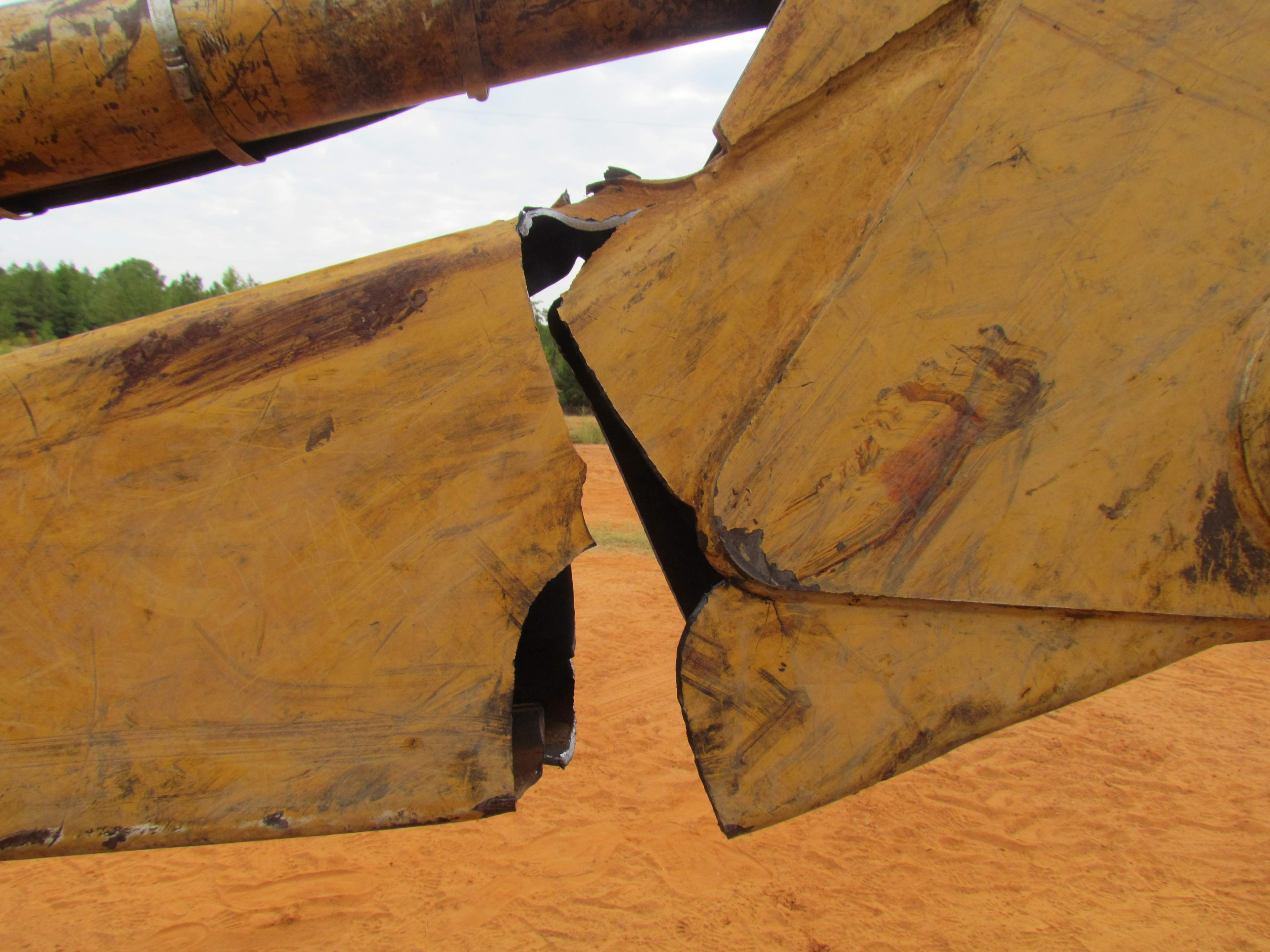

I don't believe anybody can engineer anything that my dad can't break!!!
Eddie

/ Under Engineering #26
Eddie
:laughing::laughing: I remember that.
But with the repair you had done to that hoe, he is going to have a MUCH harder time breaking it now:thumbsup:

#27
Eddie
Good picture. I cant say it was underdesigned. It is done with exercise of the Physics, but apparently, by demonstration of the failure, not with an adroit grasp. That potential failure point would have been made much more durable by extending the side bracing [assume its on both sides of the arm?] further down the arm with a more gradual taper. The side braces there were too ridgid and hence the stress riser at their ends was too abrupt. Another advantage would have accrued by peening the weld areas, esp at the ends of the side braces.
llllarry
