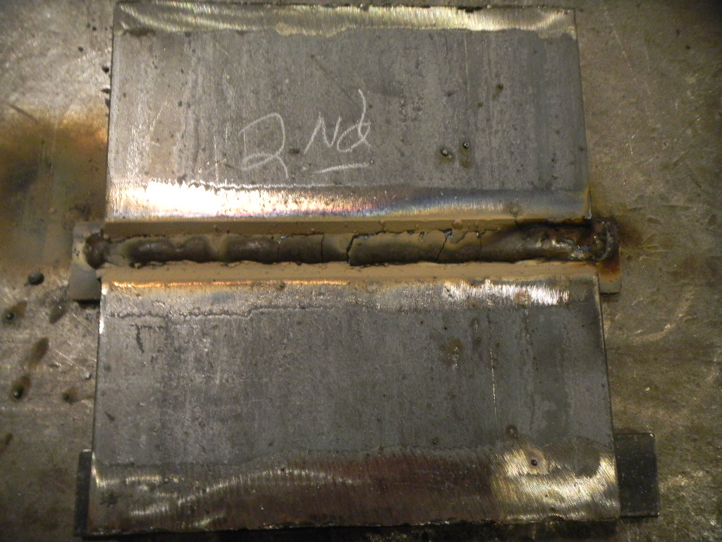

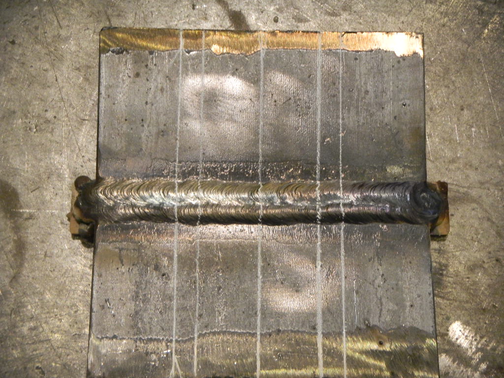

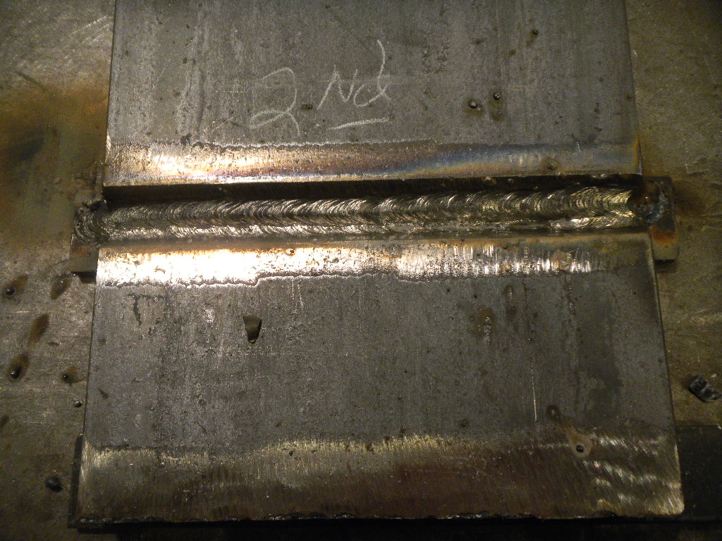

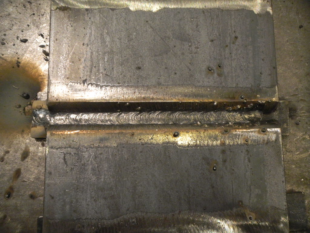

A member on another site shipped me some AC/DC 7018, asked if I would run a bend test to see the results. Far as I know this rod has never seen the inside of an oven. At the very end of the root pass the rod acted really funny, I could see the flux flaking off 3/4 to 1-inch above the puddle:confused:. I don't think I had the wrong rod angle, because this isn't my first rodeo;)! Even with this rod being cold, it ran very nice, maybe the best 7018 I have ever run!:cool:
I'll cut and bend the coupons tomorrow morning, and post the results.

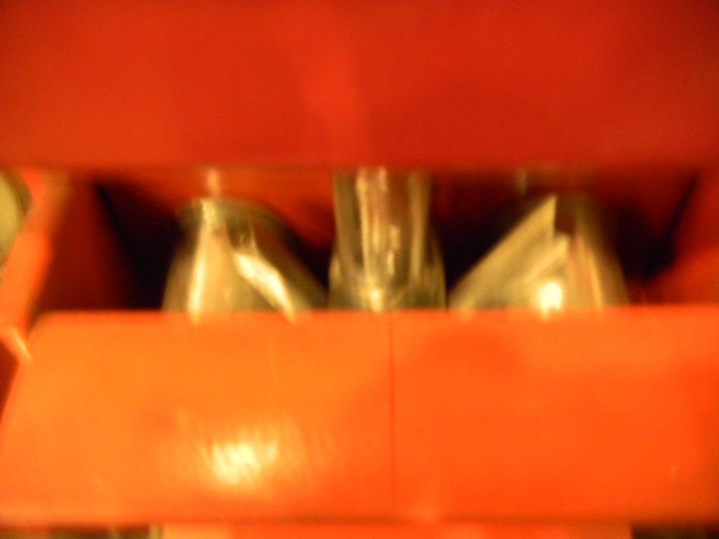

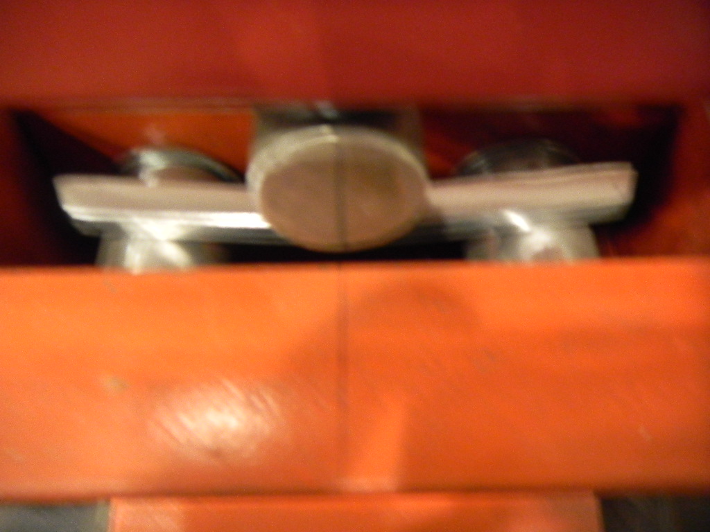

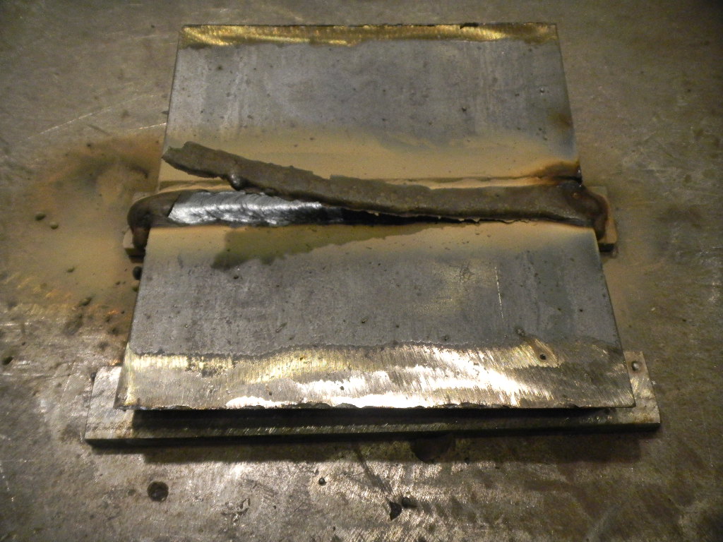

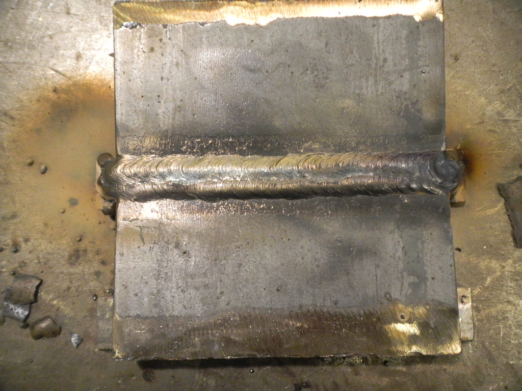

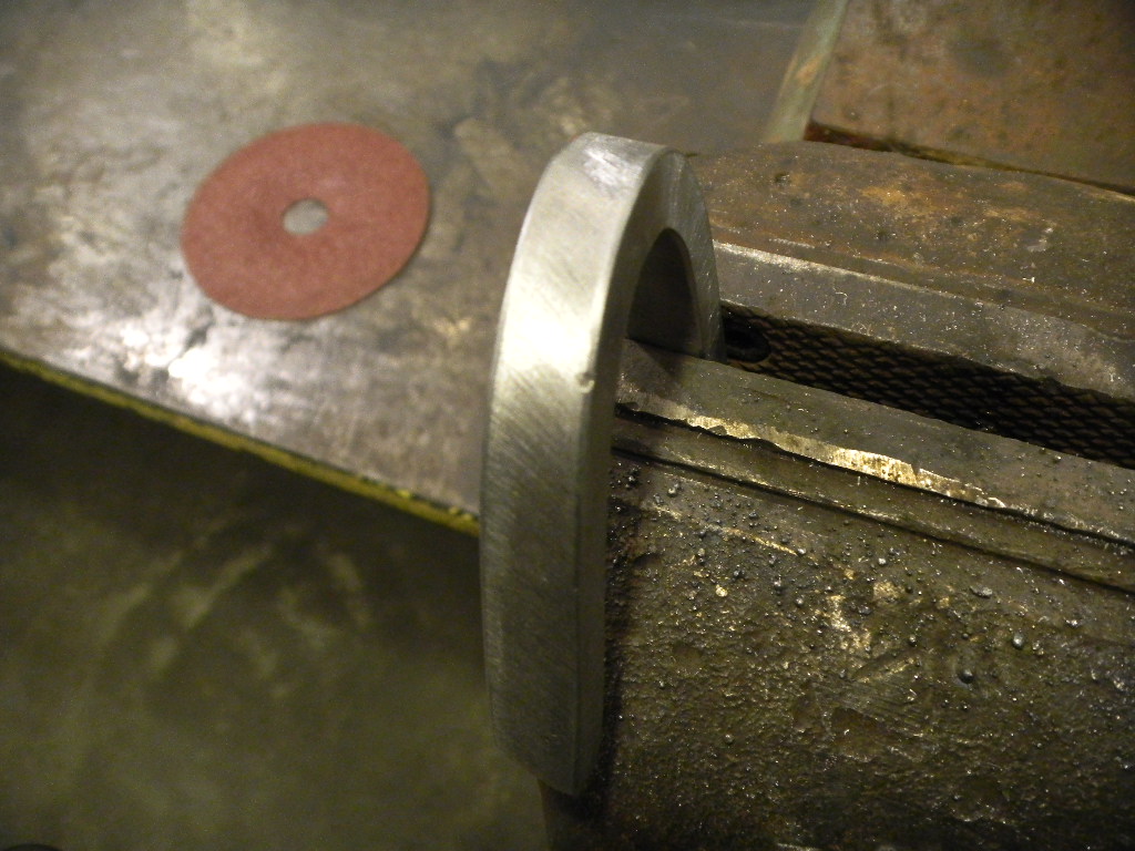

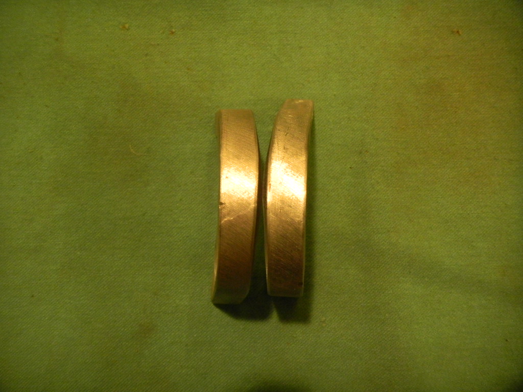

Here are the test results. It's obvious I need a better camera for close up shots:mad:. There is a blemish in the cap pass on the left coupon. Looks more like a ding than a rip. There is the same thing on the other coupon, way out of the weld zone. Maybe the coupons hit something when springing through the bender.:confused:
