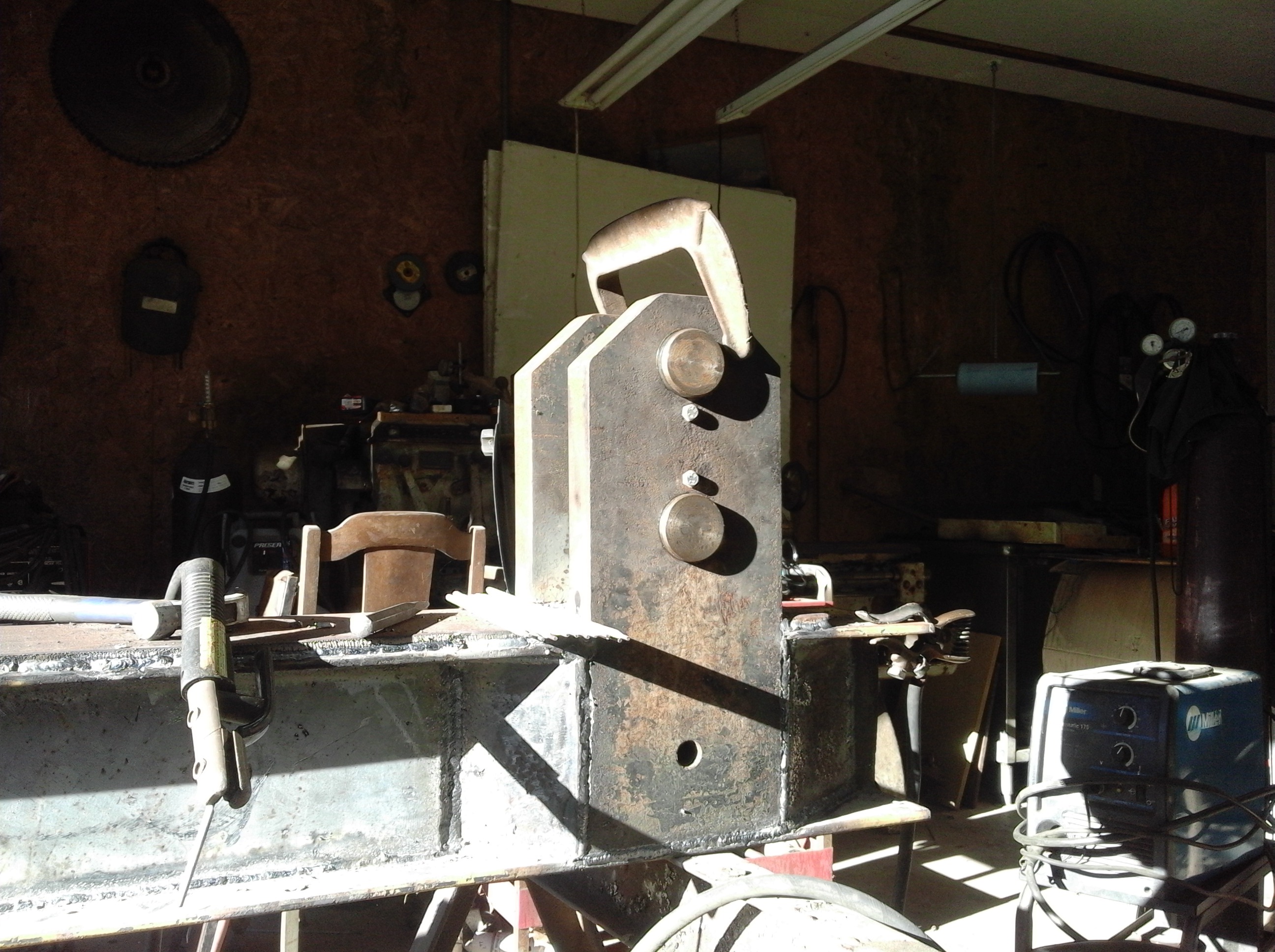

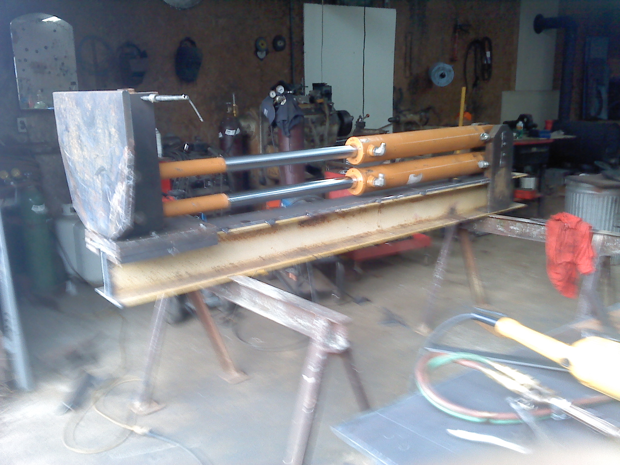

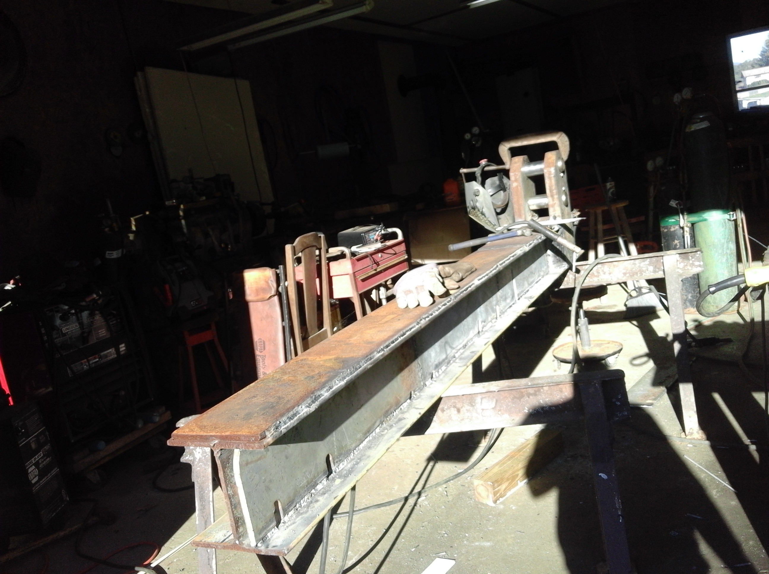

Not much to show yet. A few picks of the beam I am boxing and the splitter wedge. Its been sitting for a year and a half, waiting for me to get back to it.
