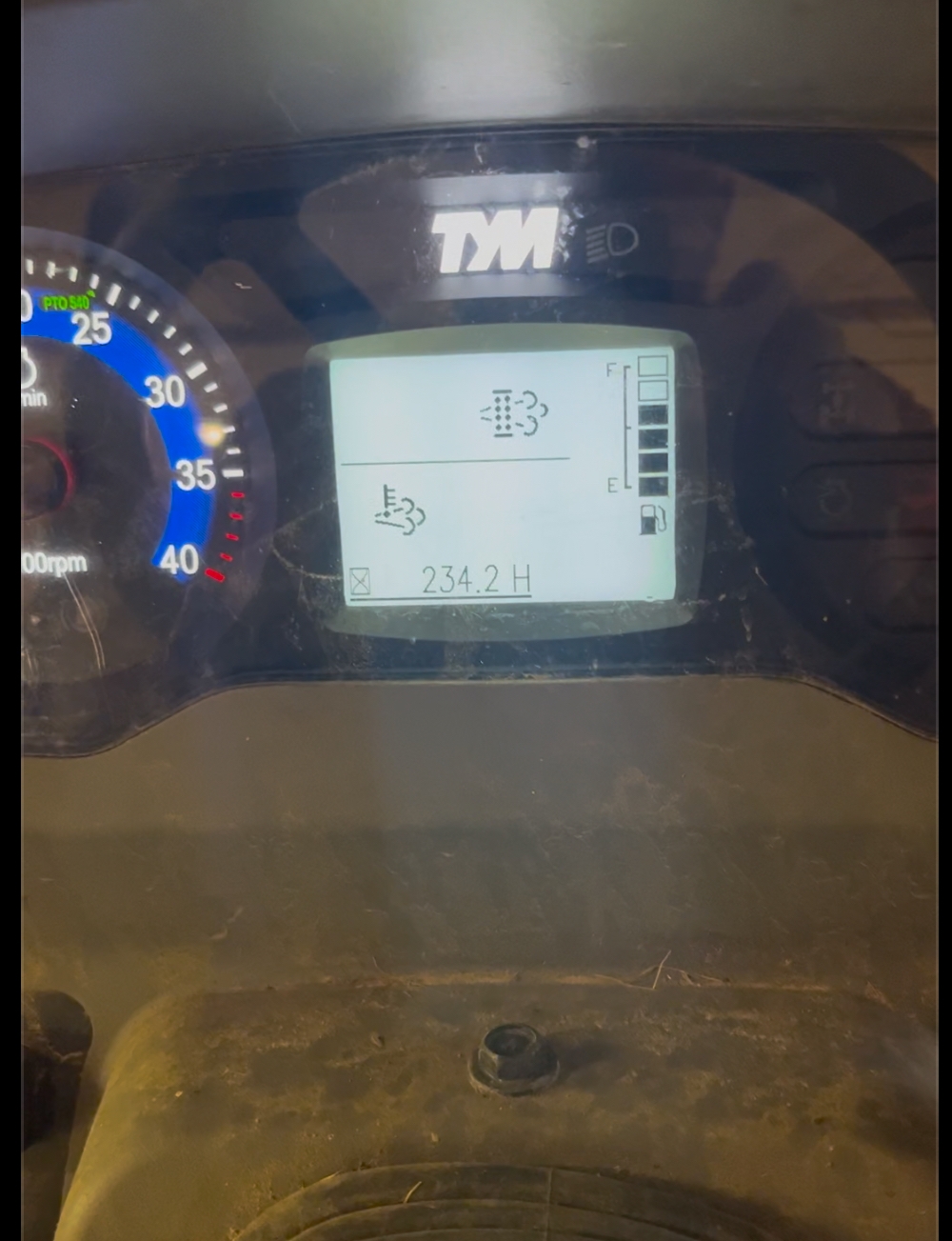

I have a tax 47 all sudden started losing power and trying to die I tried to do a regen but it won’t work so I performed a reset controller and learning process still won’t regen but flashes this any help be appreciated
   / Tym Tx 47 #2
TX 47 is the loader. Most likely a T474 tractor.
Here is the meaning of the symbols.
   / Tym Tx 47
I press the regen button ripped up the RPMs to 2500. The lights are still flashing on the dash but the idle has went down from 2500 to between 1500 and 2000 and it smells like something awful. Does that mean it’s regening
