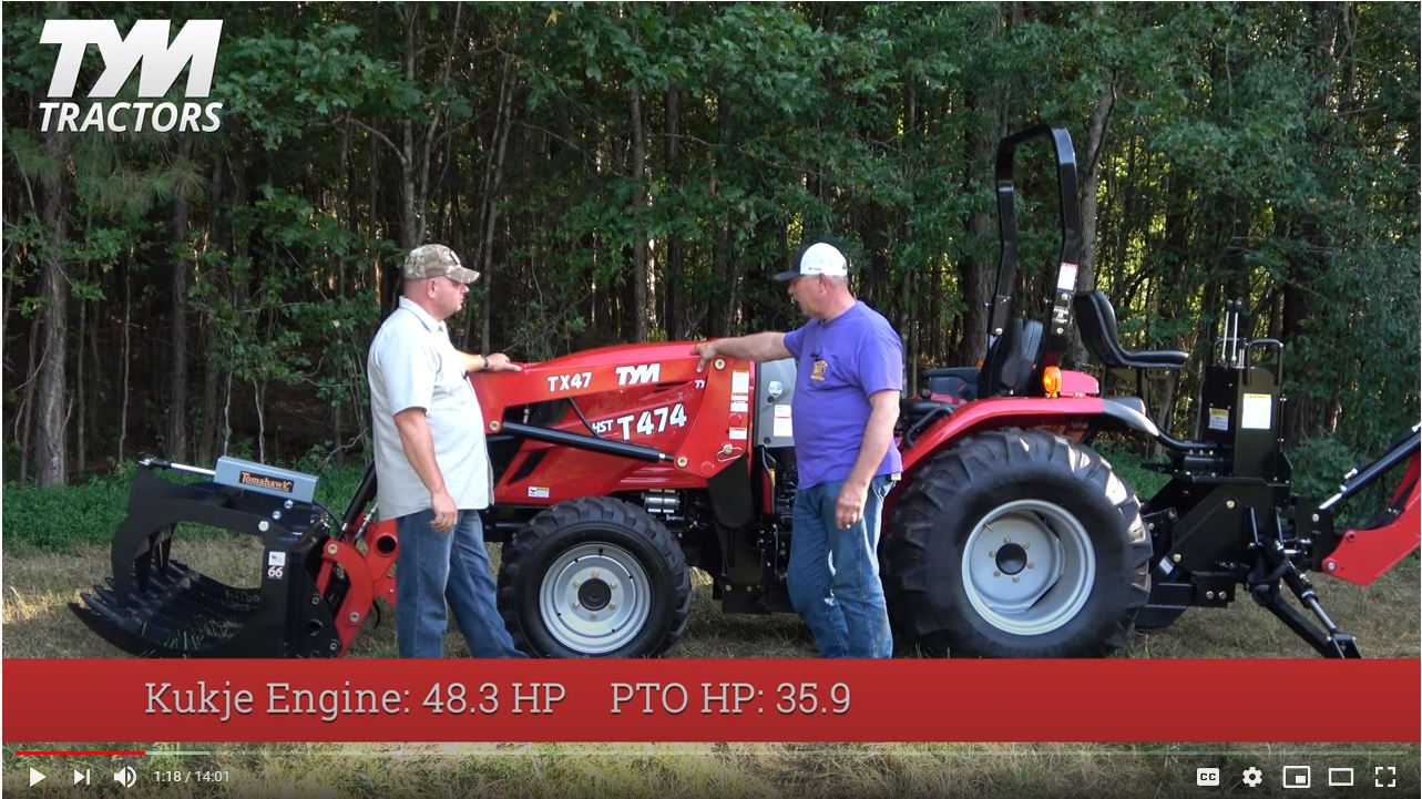

Screenshot taken from Tony's Tractor Adventure and TYM going over the T474 on Youtube.
Hi Tym Norsky,
Congratulations for your youtube video about oil changing on TYM T474 !
Thanks for this last info.
So let's do a little calculation : (48,3-35,9)/48,3=25,7 %
If these specifications are the right ones there is a HUGE loss of power belween the engine and the PTO.
Like I said, the same situation as in Antonio Carraro tractors.
I cannot understand how, from a technical POV such a loss can be possible.
Phil

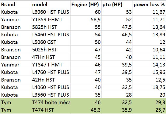

Guys, please have a look on the following Excel sheet and tell us what you think about it :
I would be very pleased if a TYM official could confirm or not the veracity of these datas for their tractors.
Phil

Thanks EuroYanmar, just trying to help build the technical how-to's for the T474. You're right at 25% loss is immense, but for an HST it seems to be pretty darn the standard these days whether you look at LS, Kioti?
/ Tym T474 : the secret data
#13

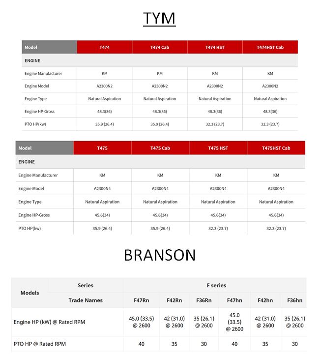

I dig up this topic because I found other datas on Kukje and Tym global websites :
For Kukje (Branson) :
Branson
And for Tong Yang Moolsan (Tym) :
Tym
There are much more technical informations on those websites than on national ones.
Regarding to the PTO power loss here is what I found :
So :
For Tym T474 HST : (48,3-32,3)/48,3 =33,12 %
For Tym T475 HST : (45,6-32,3)/45,6 = 29,16%
For Branson F47 Hn (HST) : (45-40)/45= 11 %
With three times less power loss at the PTO, Branson is clearly the winner...
