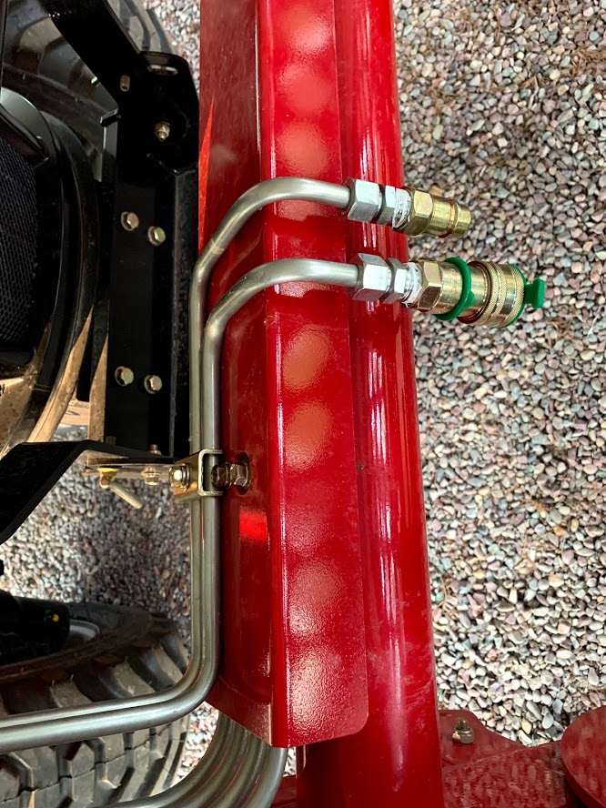

My tractor has buttons on the loader joystick. In see they are to control a third hydraulic function. So, if I want to use those buttons to run a grapple, what do I need to activate those buttons?
I also figure I need another hydraulic source. Where and how do I plumb that in? (I using the extra outputs in the back to run a center top link)

Those buttons are plumbed in for the factory 3rd function kit from TYM
/ TYM T474 loader joystick buttons #4
Contact your dealer to see what the kit cost? You might be able to still install it yourself? I do not have a part #.

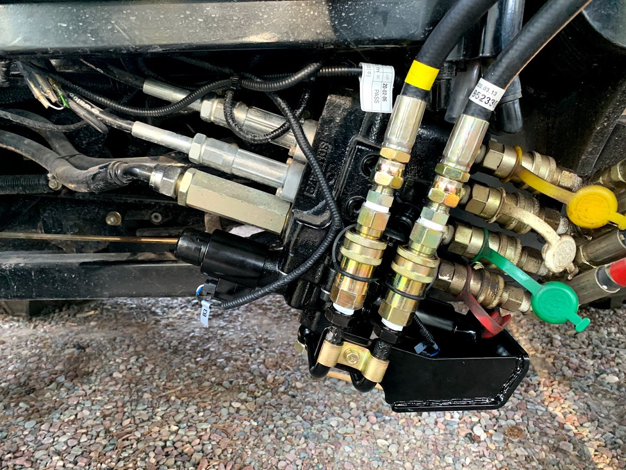

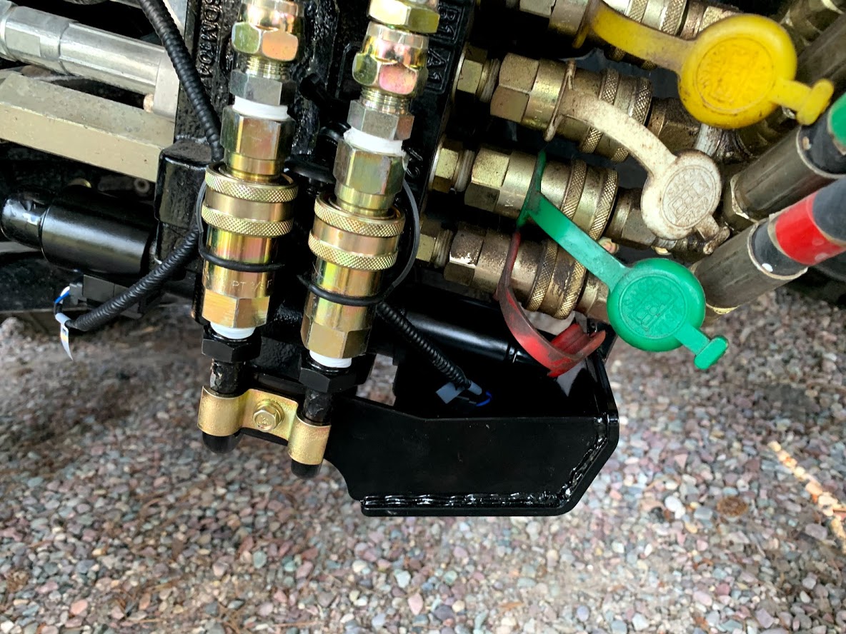

The guard came with the 3rd function kit from TYM, dealer installed.
So TYM changed its valve protection design probably because of some multiple issues reported by dealers....
This is one more proof that this company is serious.

You should be able to use the buttons on any 3rd function valve, just trial and error
/ TYM T474 loader joystick buttons #12
You should be able to use the buttons on any 3rd function valve, just trial and error .
Is it possible for you to get a couple more close up pictures of that guard TYMNorsky

I realize this thread is over three years old. However if someone SEARCHES the archives for the TYM T474 third function here is the info I got yesterday when I took possession of my new T474 HST:
Dealership: Ocala Tractor (Ocala, FL)
3rd Function Kit (plug n play, owner install): $850 plus sales tax and shipping
3rd Function Kit (dealer install): $1150 plus sales tax
Sorry I don't have the Kit Part No. I'm buying the kit and will install it myself. Mechanic at dealership said it was a 30-minute (max) installation. Kit includes all the H/W, and stainless steel hydraulic tubing pre-bent for a clean install. He said "...if you can change the oil in your truck or tractor.... you can easily install this kit."
