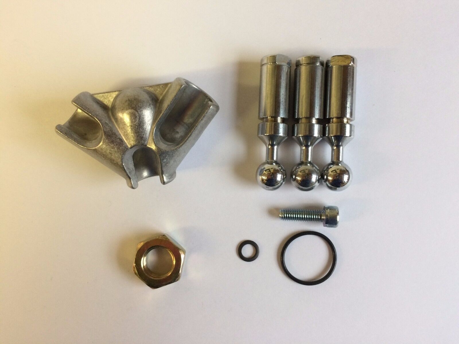

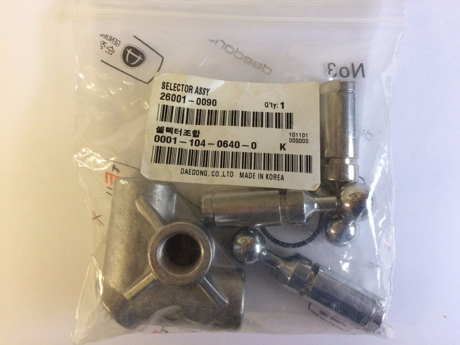

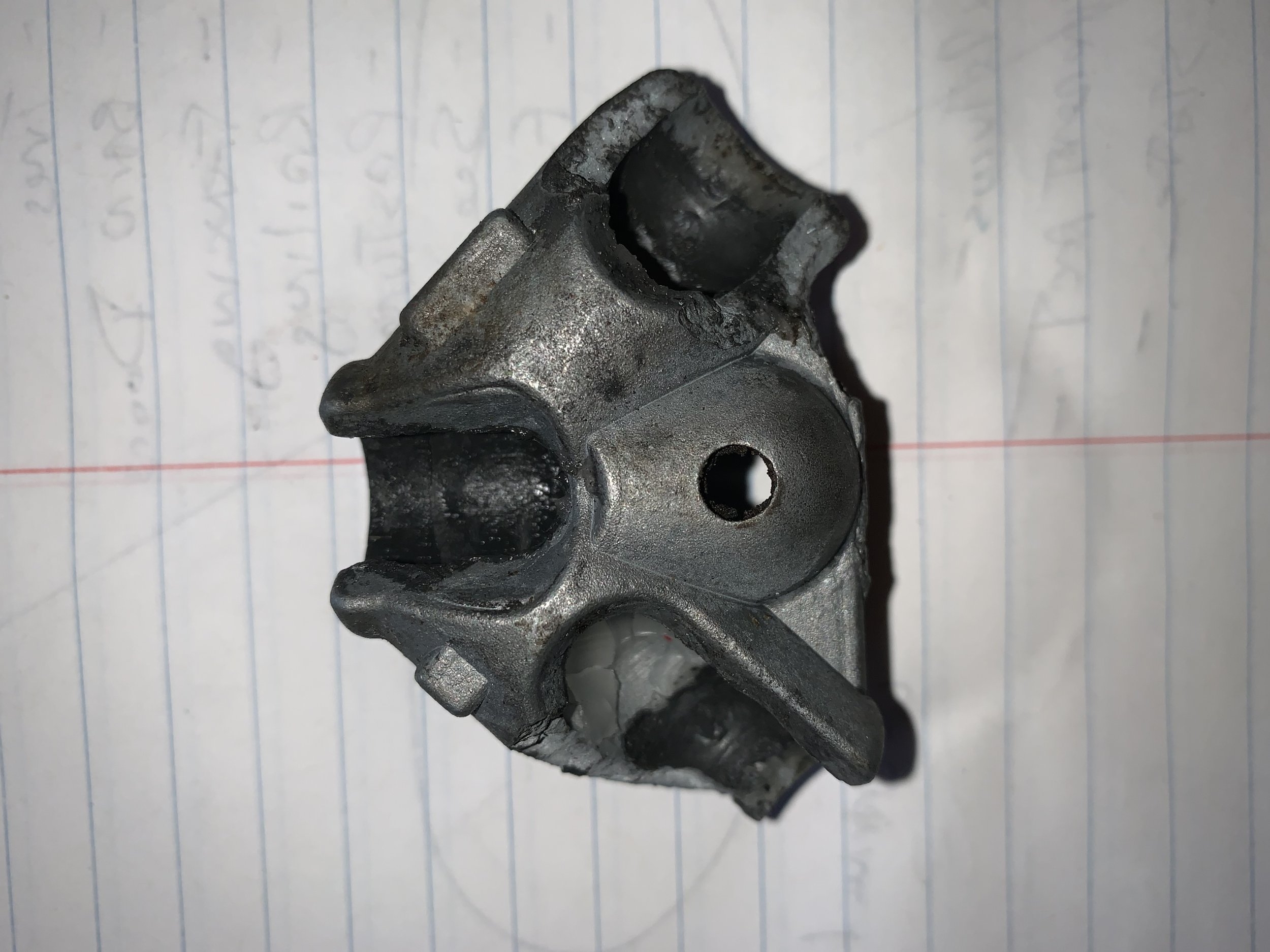

Last week the joystick on my T353 went loose and floppy, it wouldn't operate the FEL. When I inspected it I found the triangular joint, aka the "selector" had broken apart in several pieces. After speaking with the TYM dealer they said TYM doesn't break down the joystick to it's smaller parts and a new one would cost me $1200. After a few choice words the parts guy said he could then get me just the joystick for $500. While still not happy I said ok and had him hold it for me (he's > 1 hour away from me).
I started digging and found that the Kioti uses about the same joystick and they do break it out to the smaller parts. After sending the Kioti dealer the measurements he thought it would fit. Sure enough it was an exact fit, I did not need to make any mods to make it work. Do note that I decided to only replace the selector and not replace the ball/pins since mine were in good shape and that was just one less thing to mess with.
There are several videos on youtube that discuss how to replace it so a quick search will help you there. I've attached a few pics of the broken selector, the Kioti parts, and the part number.
I hope this helps some of you all save some bucks...

The original joint on my T353 had lube on it. Seemed to be graphite based. I lubed the replacement with neverseize. The joint and the area where it broke was clean since the boot seals it pretty well.
/ TYM Joystick Repair
#13
How does your joystick look like? I have a T474 which sits on the exact same chassis. And I have been thinking of this has to be a maintenance item at one point? At least lube it?
I don't think it is called out as a maintenance item in the owners manual, but then again the TYM owners manual leaves a lot to be desired. The broken joint had a lube on it and from what I could see there was no wear, the joint simply had a catastrophic failure.

What was the price for the Kioti part? It might be worth getting one for backup, I had to replace one of the cables already.
The Kioti part was $79 from the dealer.

Eddiekro I have the exact same issue. I also bought the same part as you did. My question is, I see your old one had a screw through it to a plate like mine does. What was your work around as the new one from Kioti does not? Did you drill a hole? My plate I believe is my issue as its getting worn out and curved.
#16
Hey Sawwas,
Sorry I dont recall the broken part being attached to a plate, however I'm old and it's been a bit and I've slept since then :-(
I definatly did not drill anything out. The replacement part fit easily into the assembly.
