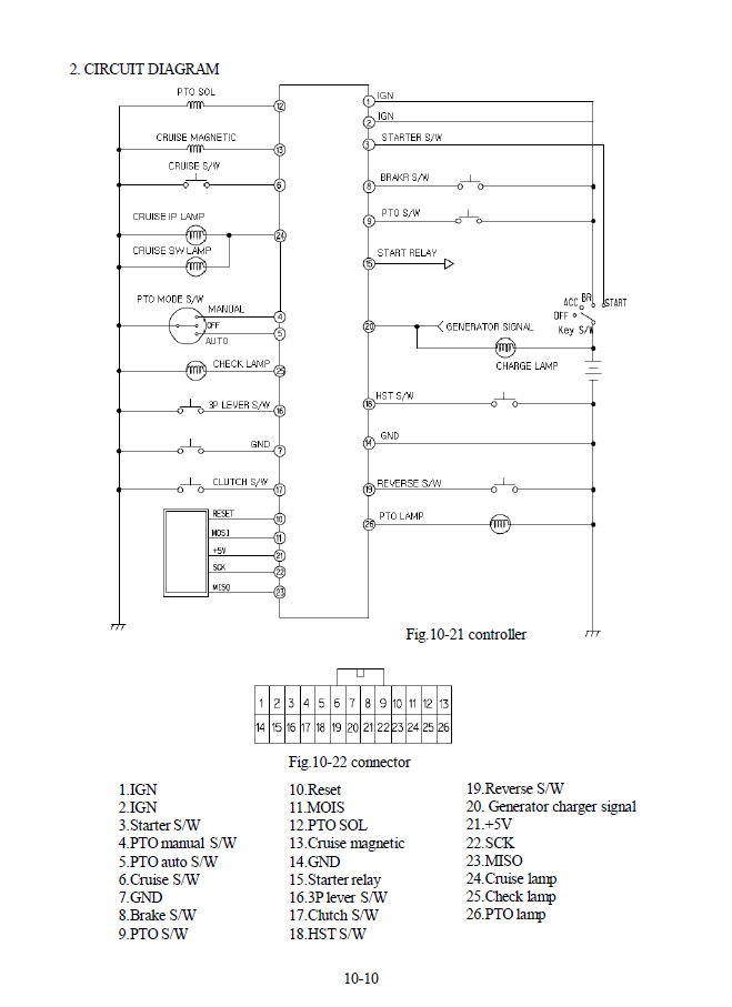

I have a T474 but assuming the dash display is the same on all cab models. The dash has a parking brake light but mine is not hooked up to the parking brake switch. I see several wires missing from the plug. Does anyone have the pin out of the plug? Or know of a source for replacement pins? Unfortunately, they are not weatherpack plugs.

I took this from a T474 workshop manual. Not sure it helps. Can you tell if this matches yours? This service manual is kinda bad to be honest.
I did the same on my Branson as you want to do. In my case, it was to make the 4x4 and Neutral light to work. I add to instal the proximity switches for both Shuttle and 4x4 levers.
The plug, I'm pretty sure it's just a Molex plug. I didn't bother with finding the pins. Just exposed a good amount of cooper on the wire, shove it in the plug with a little bit of hot glue and tied the wires to main dash harness with electrical tape and zip ties. It's been holding very well since.

It looks like the dash works on 5v(21). You had no issues feeding it 12v?

Looks like I do have a wire in pin #8. So I e-mailed my dealer to see what my options are.
Thanks.
Wouldn't surprised me if they had all the wires ready to go and just didn't hooked up to the switch or maybe is just the switch missing.
Maybe check the parking brake linkage for some wires nearby or something.
