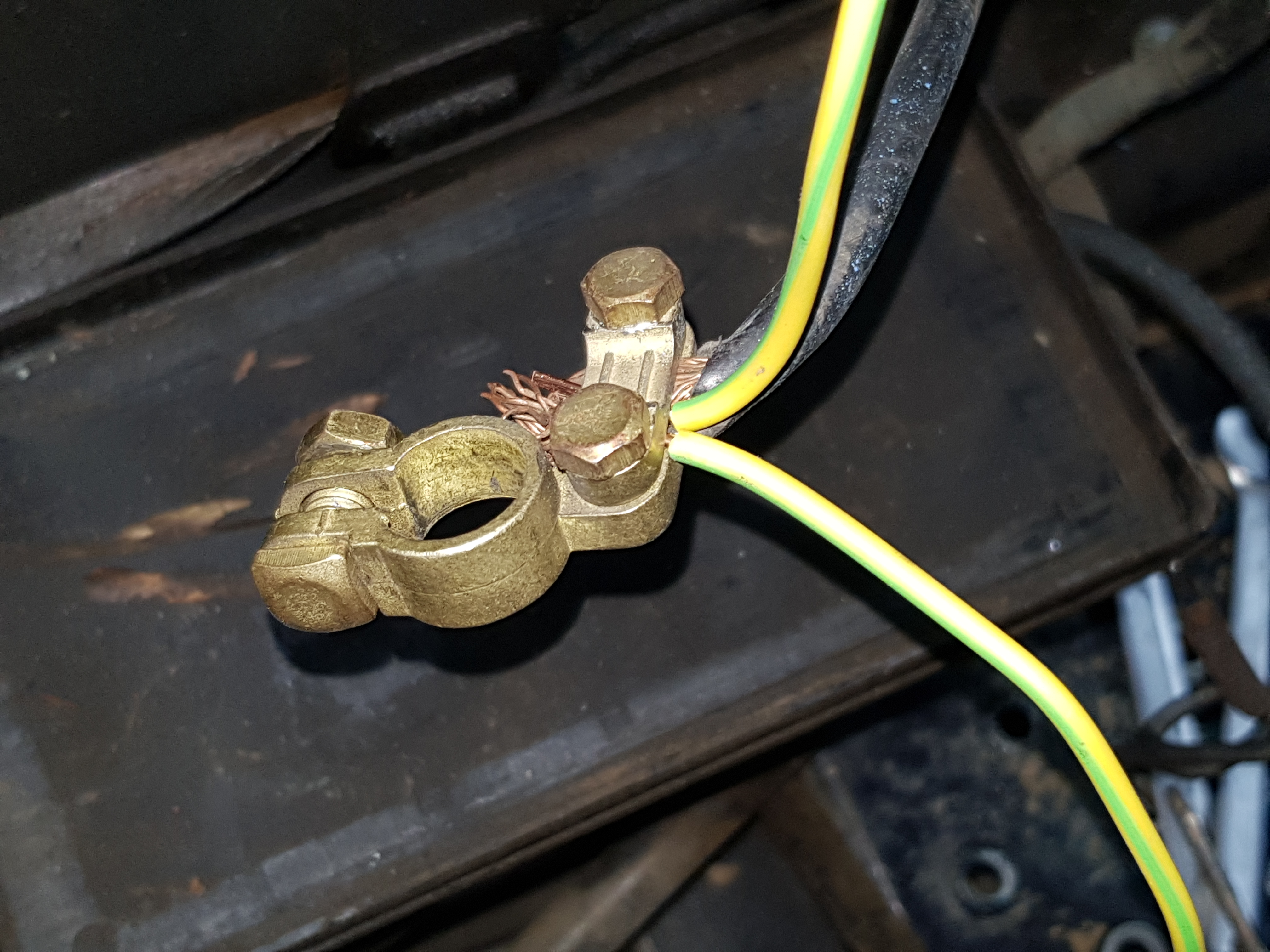

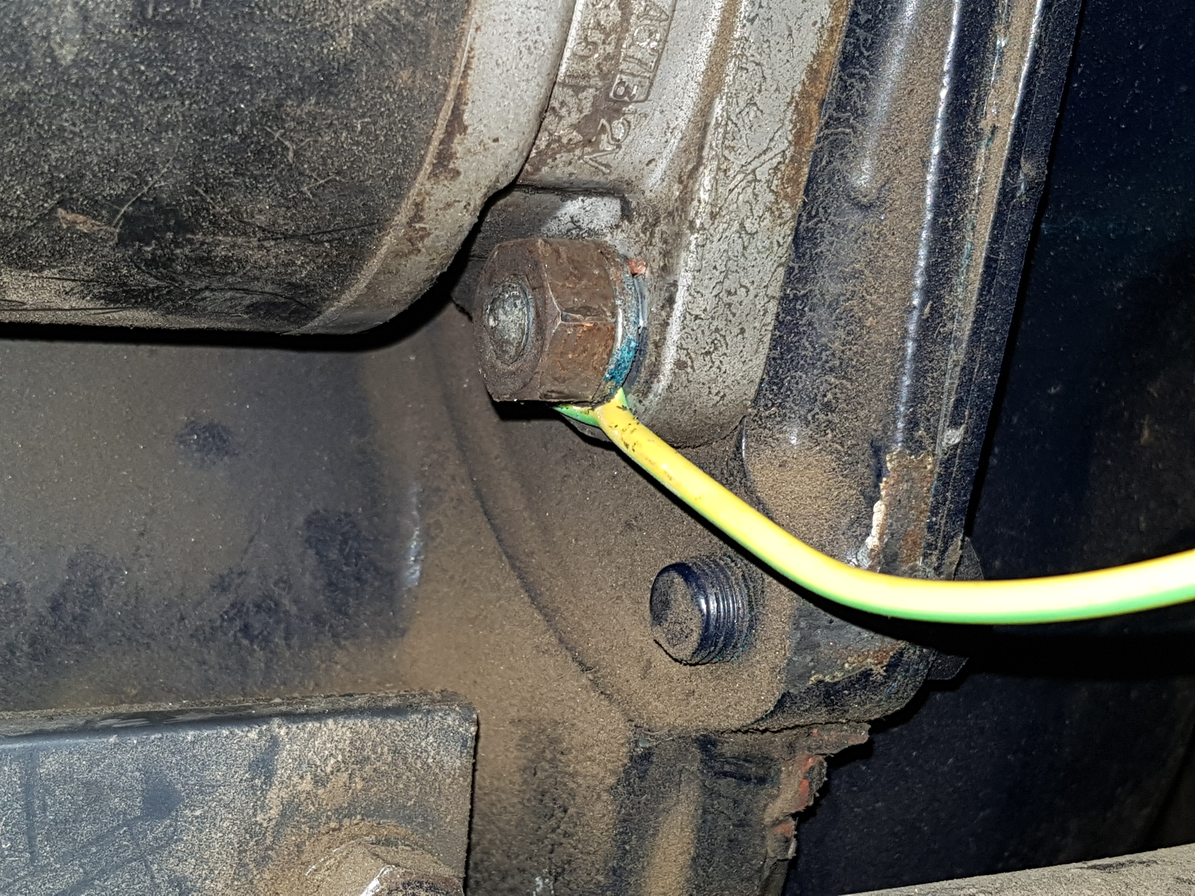

Looks like you're having bad ground issues.
If you put a jumper cable directly from the Negative post of the battery to the Body do the starter, like a bold or something, it might start right up.
Although, I'm thinking that the ground to the dash is also bad.

Wouldn't be a bad idea to get a cable straight from the Negative post of the battery to a bolt holding the dash. I had to do that on my Kubota B7000. That was very similar to your Iseki. I wouldn't be surprised if parts would interchange.

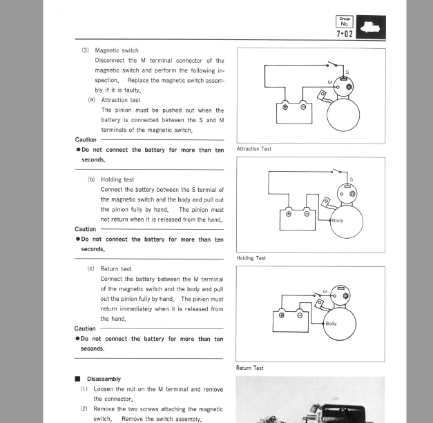

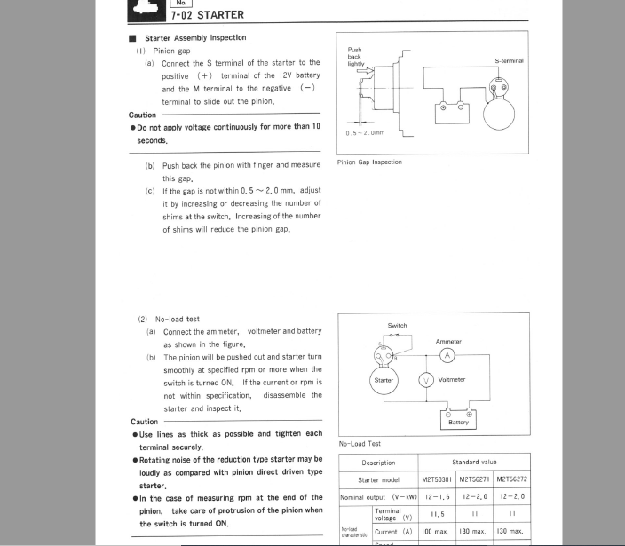

Marcel ,here is a few pages out the manual if its of help for testing the starter, if you do carry out this test, in the first just bridge the 2 positive connections and the starter should operate like you did with your friend,

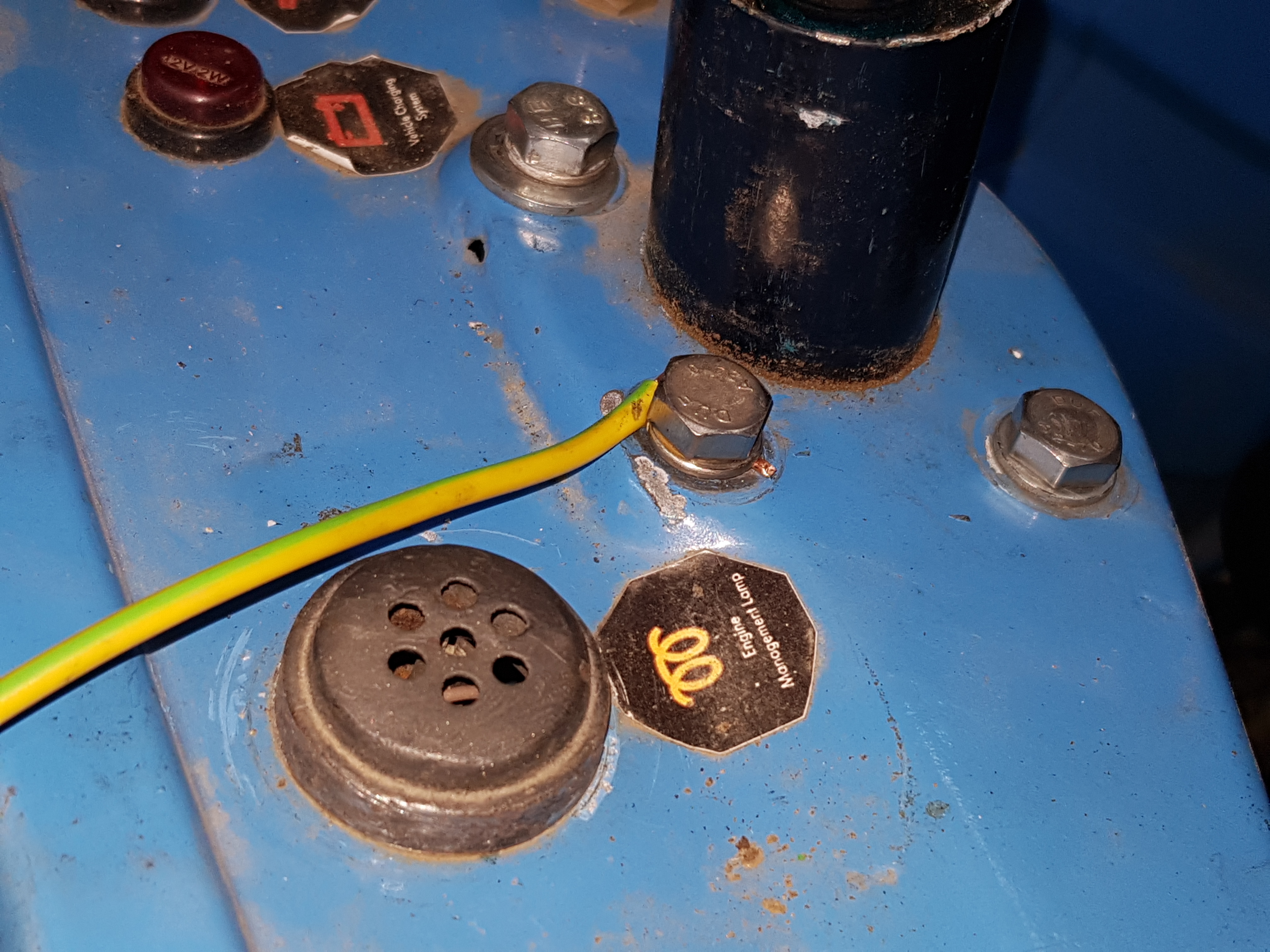

It sounds like you have two things going on. First is your ground.
on my 1300 the dash IS the ground to the steering column which is
bolted to the chassis which completes the ground circuit.
The 4 bolts that hold my dash on have lock washers that bite into
the dash making a good ground. I think the reason the hood hold downs
were hot is because they were acting as a ground circuit although not
a good one because they were hot. Make sure the 4 bolts that hold
the steering column onto chassis are tight also.

Pedro, you're the man!!! I followed you lead, connected two cables (as thick as i could find), and it started. The lights on the dash look different (more weak, and only one works), but i really don't care. As long as the tractor is working.
