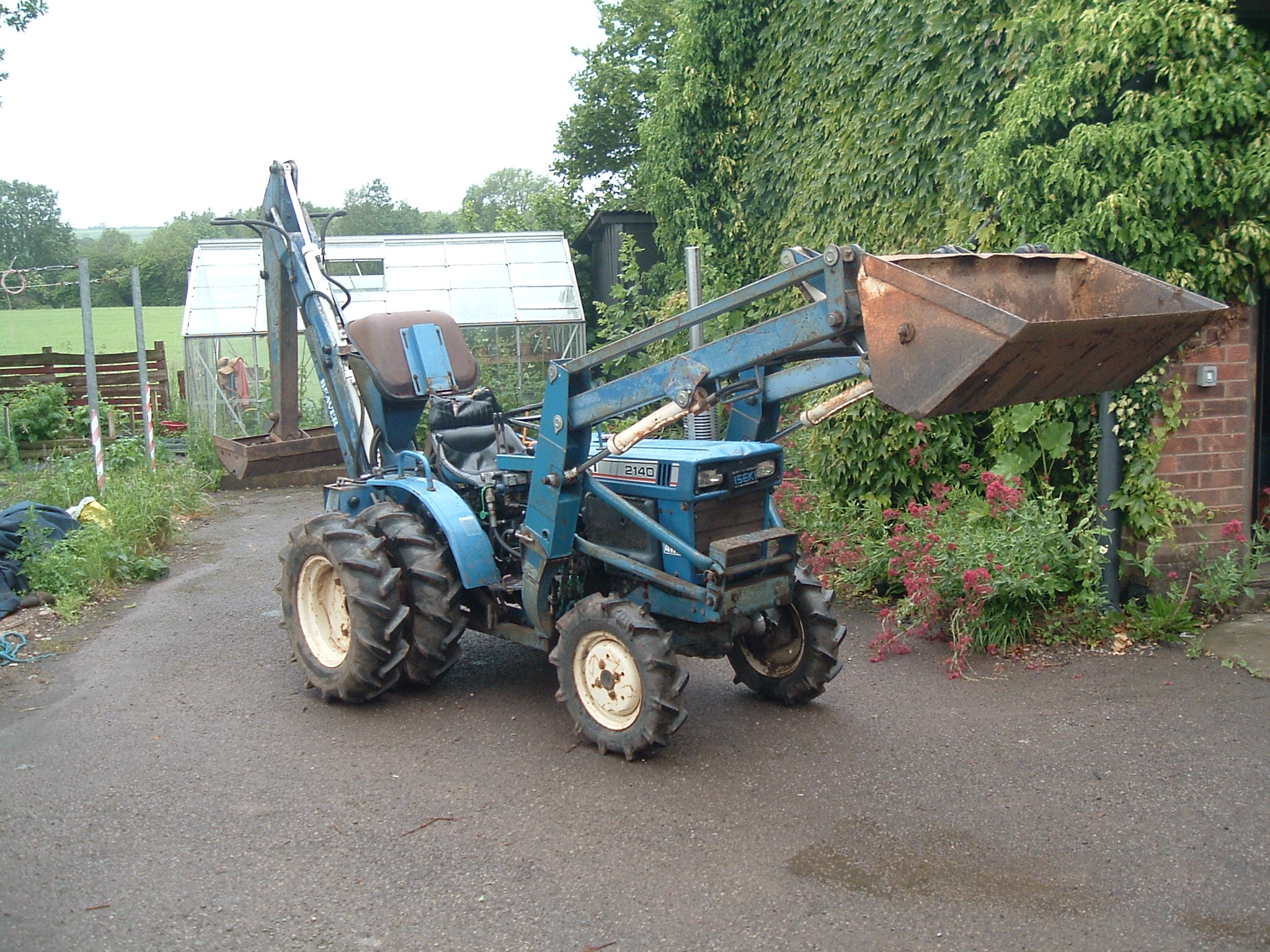

TX 2160F, with front loader and backhoe, long term project

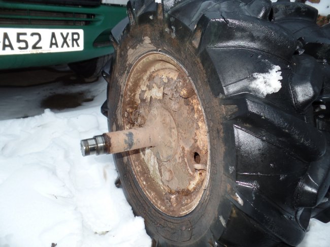

I have the same set up as you, though the smaller 2140 with same front loader and back hoe.
I also see you too have twin rear wheels. In my case they were fitted by the previous owner. I've never liked wheel spacers and thought about removing my twinsies, but thought the halfshafts looked stout enough, however after some snow clearing in recently, I had the one wheel 'fall' off!
The issue may just be the extra strain with the leverage on the bearing, however I suspect the full ballasting of the tyres don't help, so will be removing the outer wheels for now.

Well its been a while and the progress has been slow but I have reassembled one engine with all the good parts, injectors away getting tested with the best 3 getting fitted, new injector pipes aquired, new dash aquired and some of the wiring changed over in readyness for starting once the engine rebuild is complete, I intent to start this on a frame before it goes back in the tractor, or before I start building the tractor around the engine.

After biting the bullet and deciding time to seriously move forward with this project after many other more important tasks have got in the way over the last many months, a couple of nights were dedicated to see where we are with the engine. To my astonishment when I cranked it over after bleeding the fuel lines the thing fired into life after about the 2nd turn of the engine,
Iseki TX2160 after engine strip and rebuild - YouTube
All that I have done to this engine was pick the best parts from the 2 engines, the condition of the alternator is terrible but I am delighted it still generates power, this is the stage I hoped to get to so I know now I have a project which has serious potential,
I am one very pleased person tonight.
Chris
