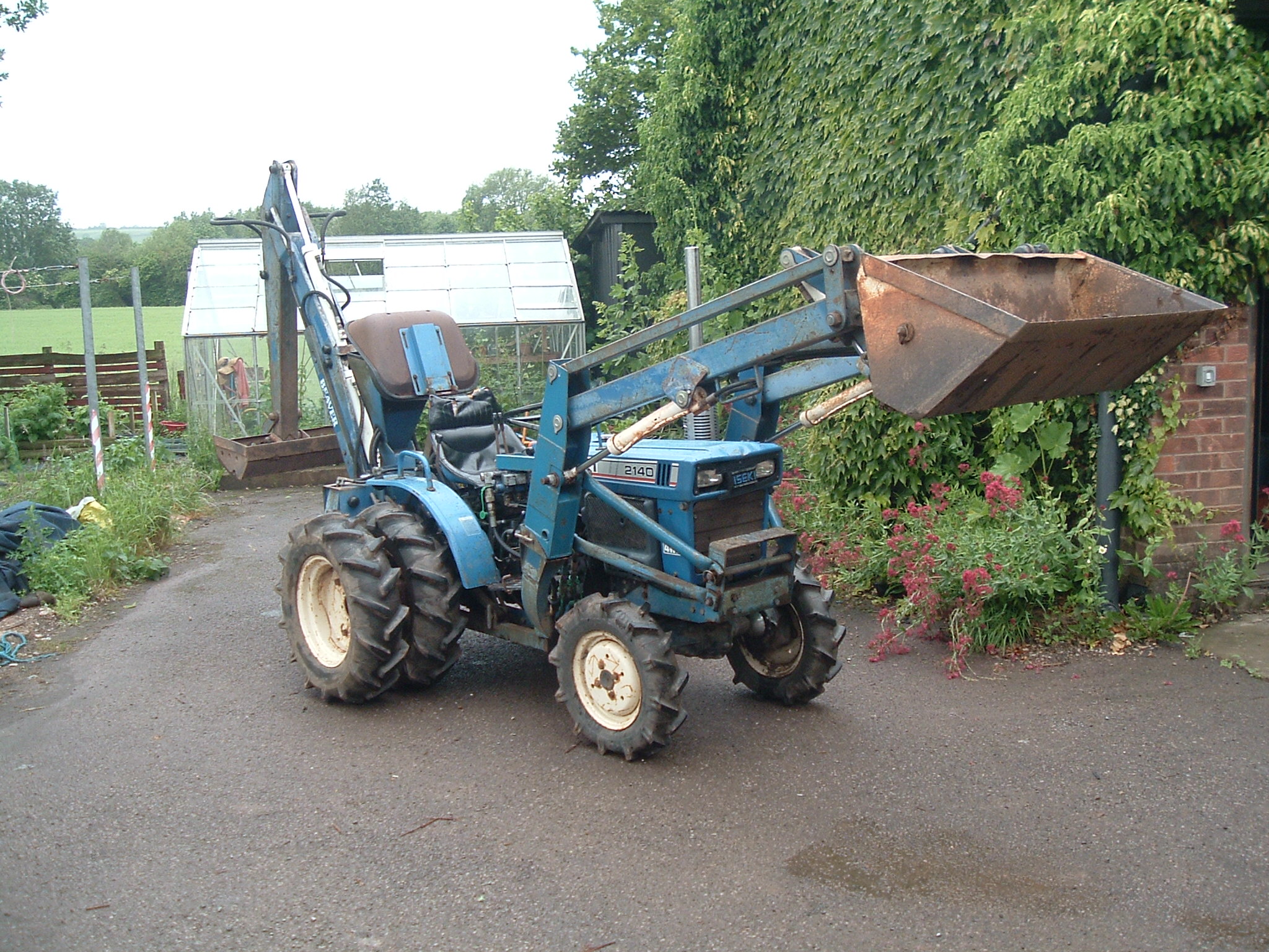

So first image is the tractor, its been sitting for many years out side abandoned, this was it half way home.

Tractor with loader and backhoe is stored on a friends farm for the moment,

Removing the tractor from the backhoe, I managed to get some of the loader steelwork removed bit not all.

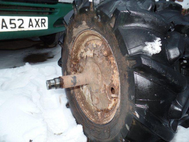

Still just working through some bits and peices, there is some issues with the diff on the engine 2 tractor(the loader one) but the diff on engine 1 tractor feels good, its looking like its is going to be a hybrid of the 2,

Quite a difference in the clutches, can someone let me know why this would be, can I use either?
DSC02711 by chrismac2012, on Flickr
DSC02688 by chrismac2012, on Flickr
and stripping the backhoe so its easier to store and getting ready to knock the leg ram pins out,
DSC02690 by chrismac2012, on Flickr
Untitled by chrismac2012, on Flickr
DSC02692 by chrismac2012, on Flickr
/ TX 2160F, with front loader and backhoe, long term project
#14
Any one know why the clutches are different?
