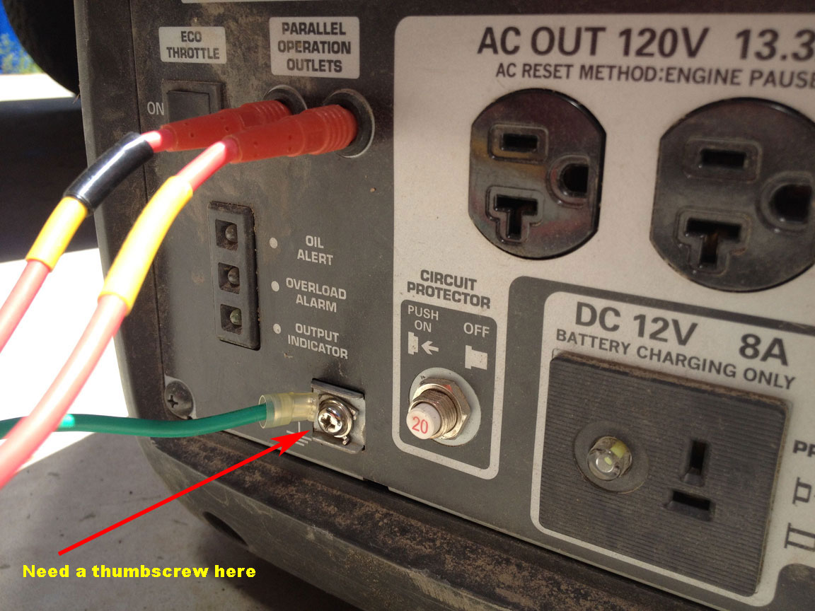

I've been welding with 2 Honda inverter generators paired together to get 20A of 120v. To pair these generators there is a ground wire that requires a screwdriver to attach.

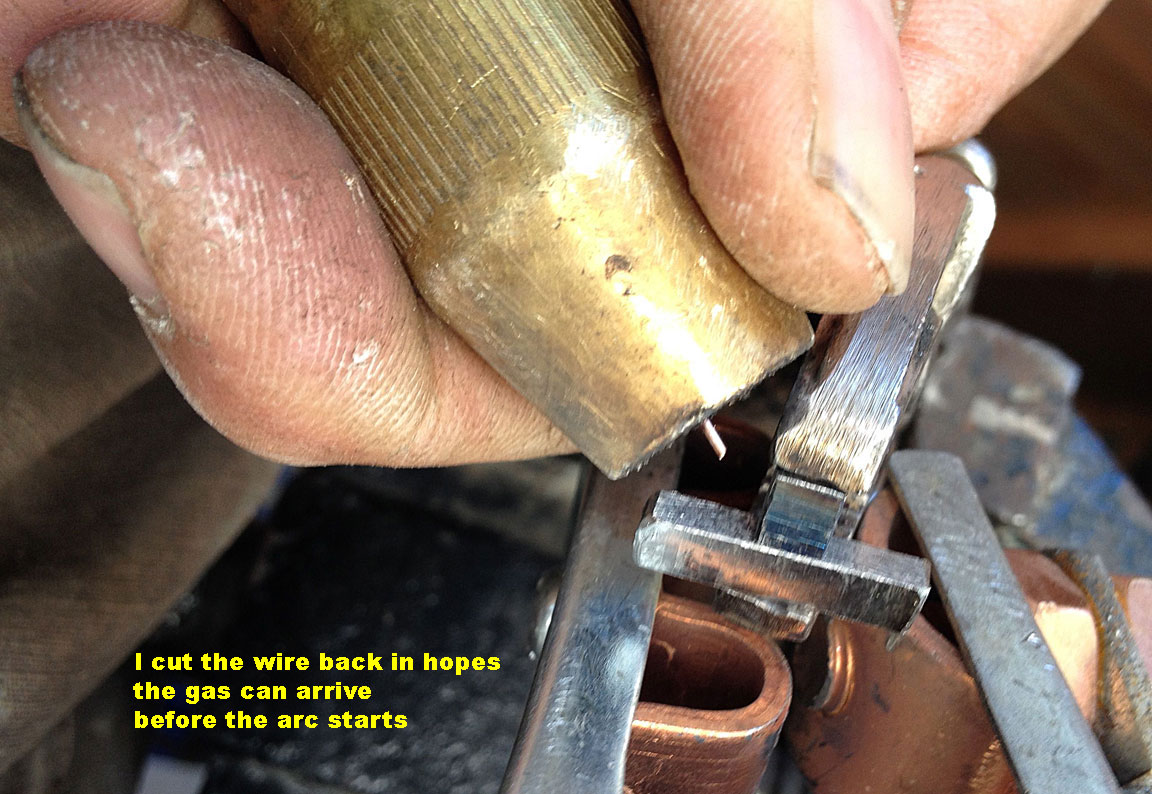

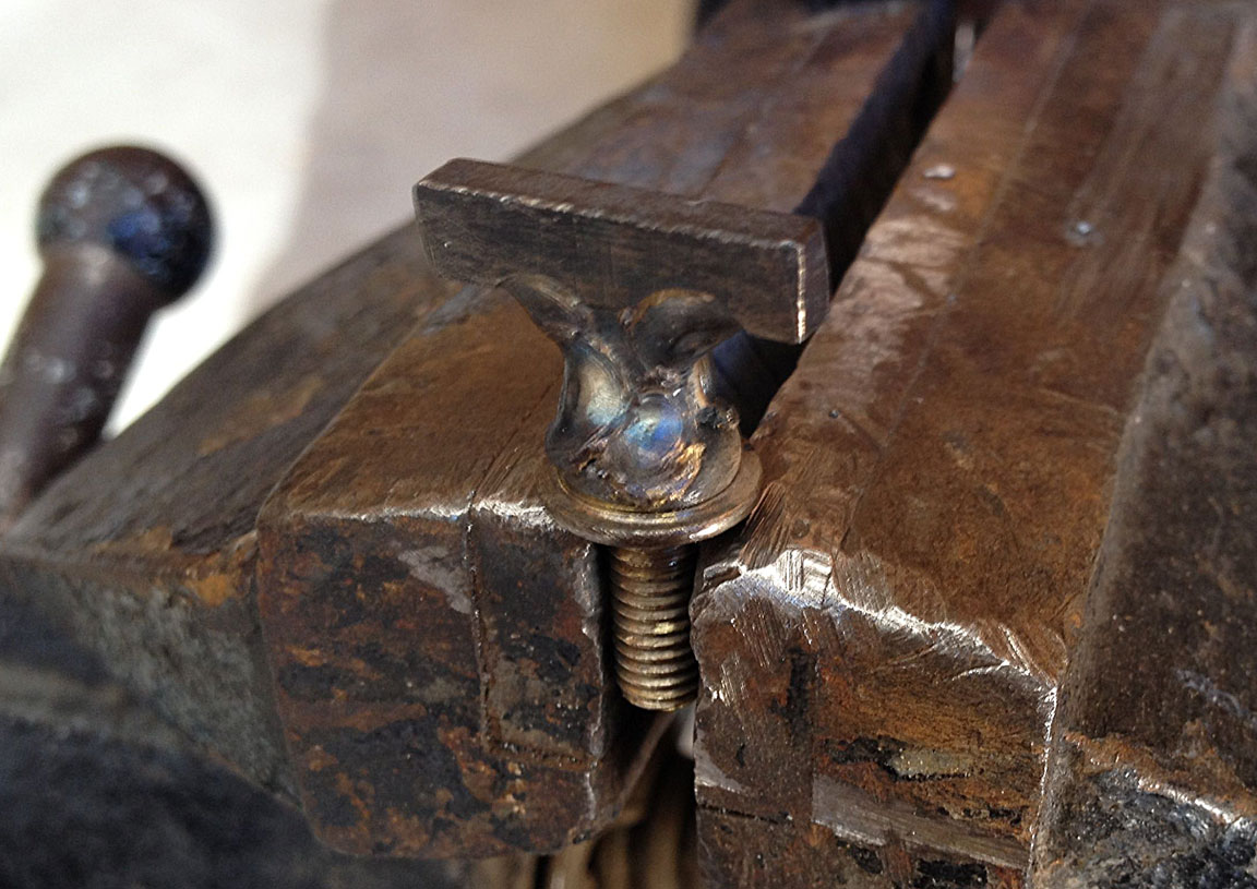

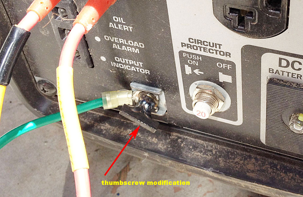

I got fed up with this today and decided to weld on some ears so I can tighten it by hand, don't have to get a screwdriver to hook up.
I cut the wire back so it would have a little time for the gas to arrive. Then just aimed, and "ZAP ! " (with my eyes closed). It's a very short weld, really just about long enough to say "ZZZZZZAP".
That somebody else might ever do this (specific hack) is highly unlikely. But now you've seen how small a weld is possible with a MIG.
I suppose I can order a nicer thumbscrew on Amazon if I ever get a round tuit. I'm out in the woods for the week, and Amazon doesn't deliver out here anyway. But anyway, this shows that a tiny weld is possible with a MIG.

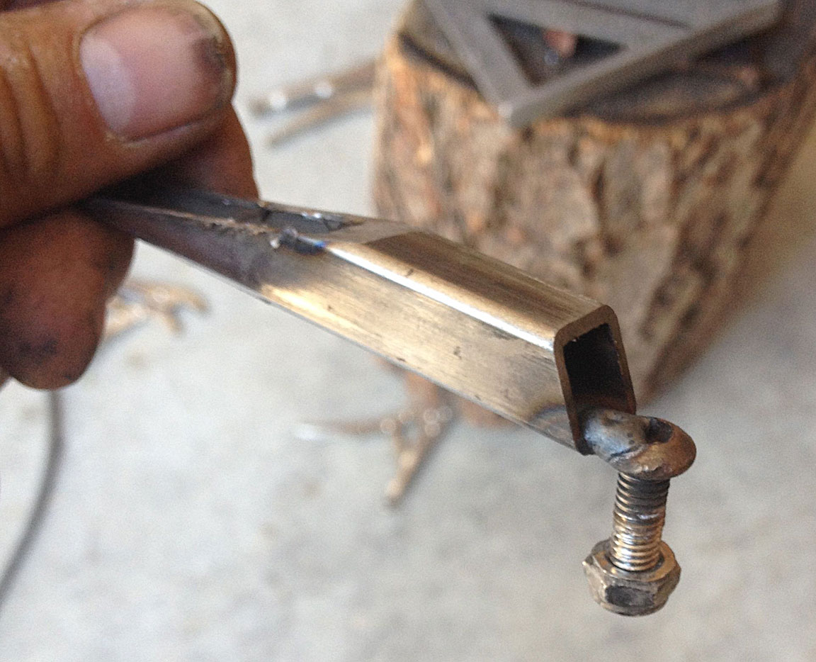

Here is another small weld. A friend stopped by on a motorcycle. He had an engine protection crashbar structure that had cracked due to vibration. To remove the crash bars, the bolts had to be removed but one allen-head was stripped, and was impossible to remove the nut. I welded a scrap onto the head to hold the screw and then removed the nut.

Sorry Sodo I don't buy it. The picture of the thumbscrew shows way more weld than the ZZZap you describe. Also great example for the newbie you seem determined to educate, no glove on the hand on the nozzle and no helmet just shut your eyes.

Your MIG did a nice job on the little projects, but if there ever was a project crying out for TIG, that was it. But you made it work with what you had, and I applaud you for that. I have done such things with 1/16 inch 6013 sticks, but it is hit or miss. Mostly miss.:) And a real PITA. but a simple 17V TIG torch on your DC stick welder can get you set up for a small amount of money to do small and thin projects with much better control than even the MIG.

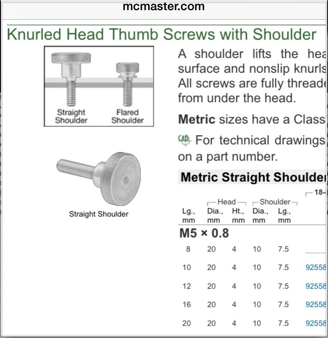

If I revisit this thumbscrew will probably go this route rather than welding. Unless I get the TIG torch first. :D
Nah, no point buying a thumbscrew if you can make one..:D Ain't nothing wrong with making it yourself even though you could have saved time by buying it. Here look at these two TIG projects
