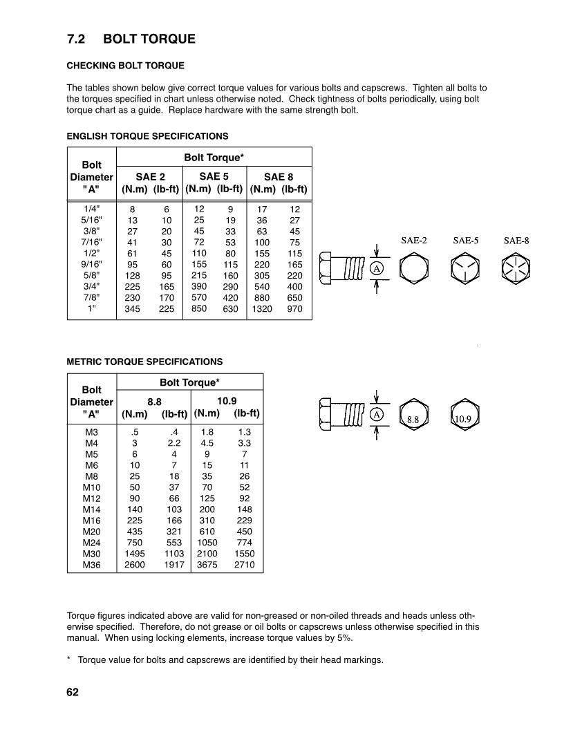

One of these days I'm going to bite the bullet and get a decent air compressor. Then what rating should I look for in an impact gun?
Sure would be nice if you could dial in the tightening torque with some accuracy...and I wouldn't want something too heavy either.
One last question...is there an alternative system to grade 5/8 used overseas? Sometimes I see numbers on the bolt, and that makes me leery, instead of hash marks, and sometimes the hash marks
don't look very "official" either. What can be relied upon?

remember.. metric bolts have a different rating.
Drew
Metric bolts marked 8.8 are the equivilant to SAE/USS Grade 5
Metric bolts marked 10.8 are the equivilant to SAE/USS Grade 8
Just guessing on this one, but an unmarked metric bolt would be equal to a SAE/USS Grade 1/2
Ken
good to know, and easy to remember, thank you Ken.

One really interesting thing I learned in this thread is that spraying some WD40 on a bolt about to be tightened changes its torque values. I do that lightly for lawn mower bolts to help with the inevitable moisture/rust problem under the deck, but never knew it had consequences. Never had a problem either, so I'm probably sticking within the range, unknowingly. Or I'd be twisting off bolts too.
