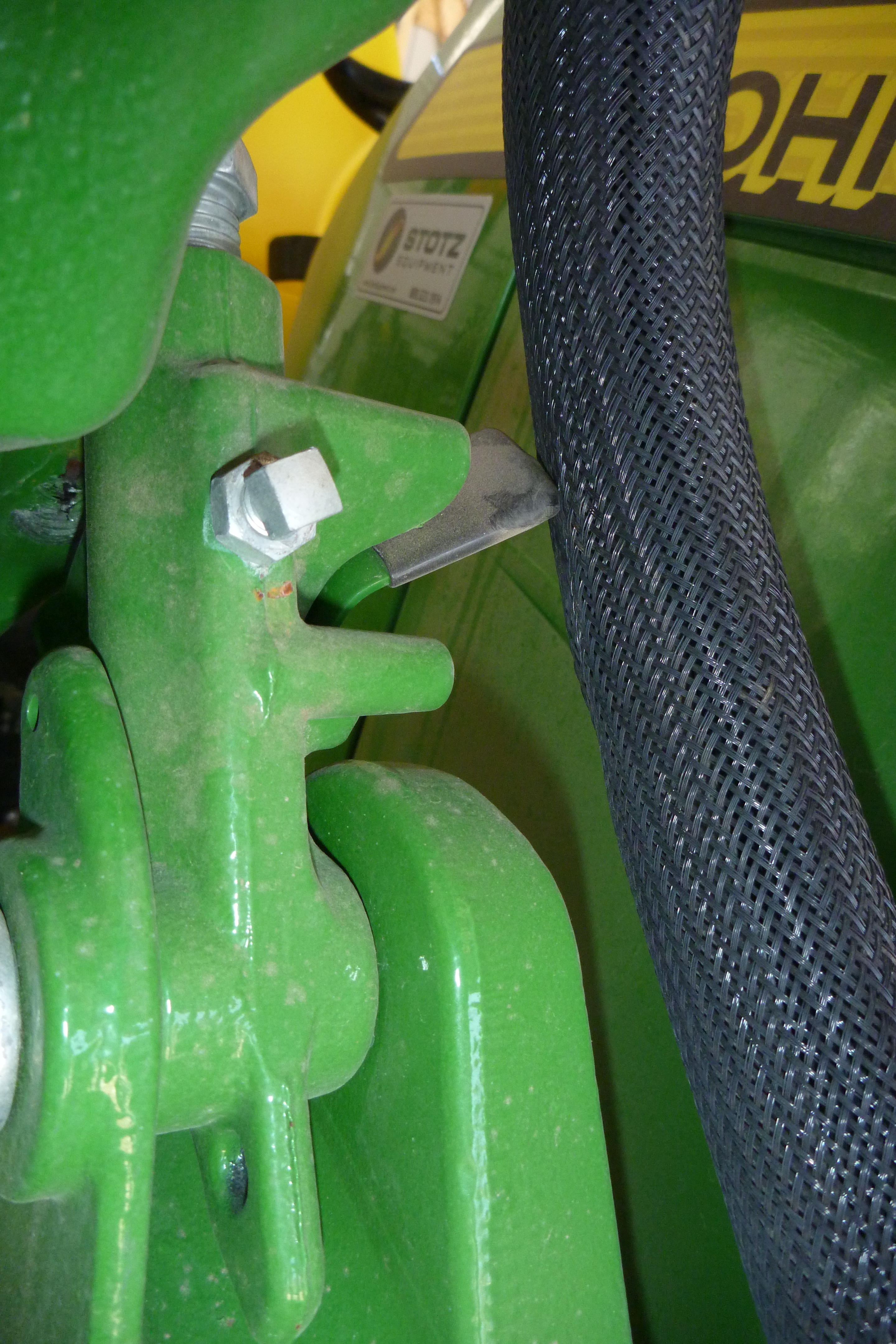

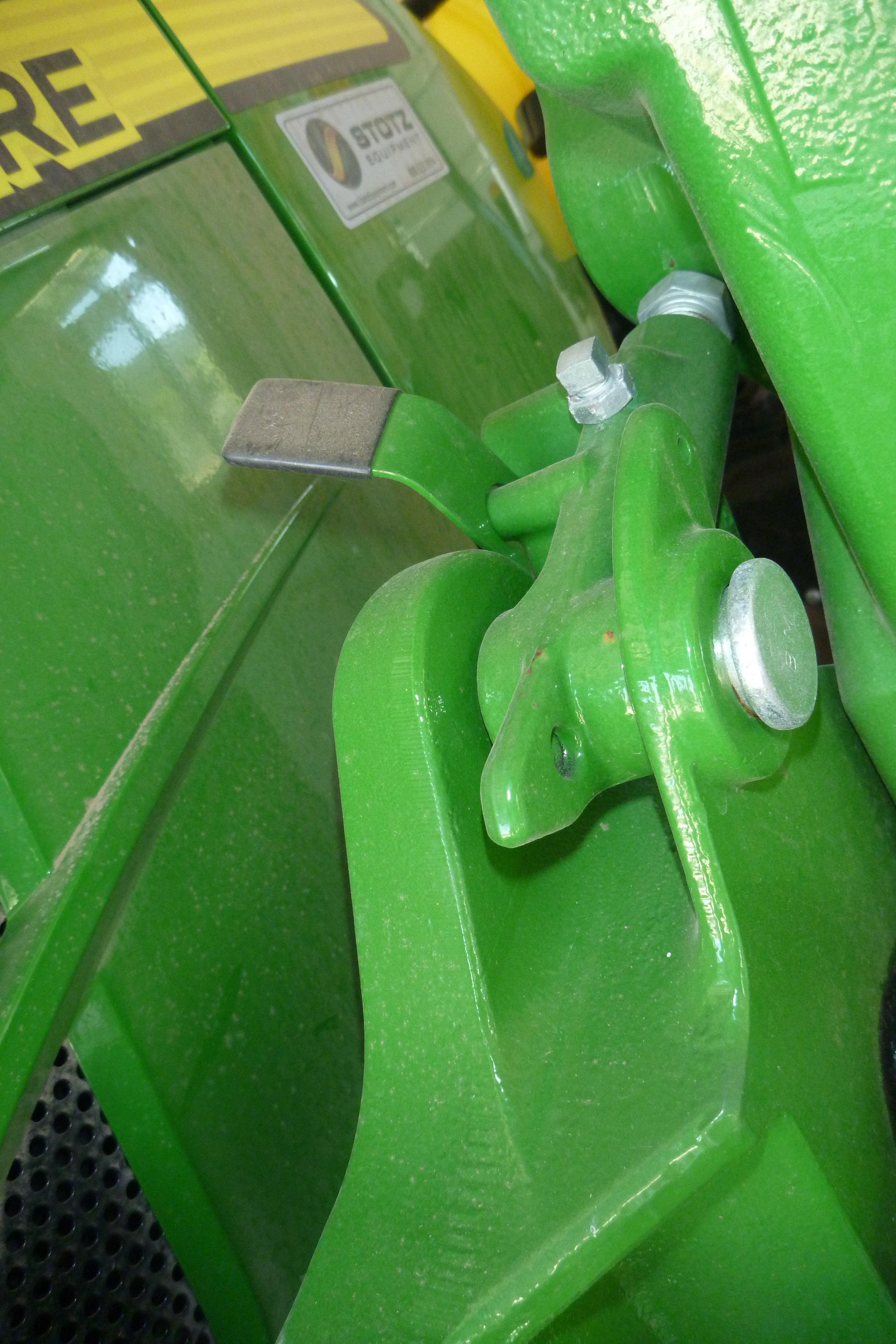

Here are pics of the disengaged right side and the normal left side. I would never think to take pics of something for future use like this; I have pics, but not close-up details. It's going to the dealer tomorrow.View attachment 562810View attachment 562811I guess I shouldn't have touched the lever as it removed the dust.
Just something that popped into my head when I saw your picture of the lock undone; is it possible that the movement of the hydraulic hoses as the loader goes up and down could have hooked that little latch and unlocked it?
/ Tweaked FEL #89
Sadly, it's obvious by the last two pics that the lock was engaged at one time. You can clearly see the skinned paint.
Why it unlocked is going to be the issue to be resolved. The dealer is going to have to be very creative with JD to get this covered under warranty. If he pulls it off I would be a faithful customer from this time forward. Including all fluids and filters.
If a JD warranty rep gets called in this isn't going to end well.
Side note and my opinion only. That lock system sucks!!! An "over center" latching device should never be used here. I'd have zero faith in it from now on...... :(

Looking closely at the OP's pic you can see how the latch moved up slightly which took away the "over center" protection. Then it continued to climb upward until it unlatched. Those signs would be my argument with JD. This was not operator failure to relatch. The forces involved unlatched it. That's why I have no faith in it. :(
