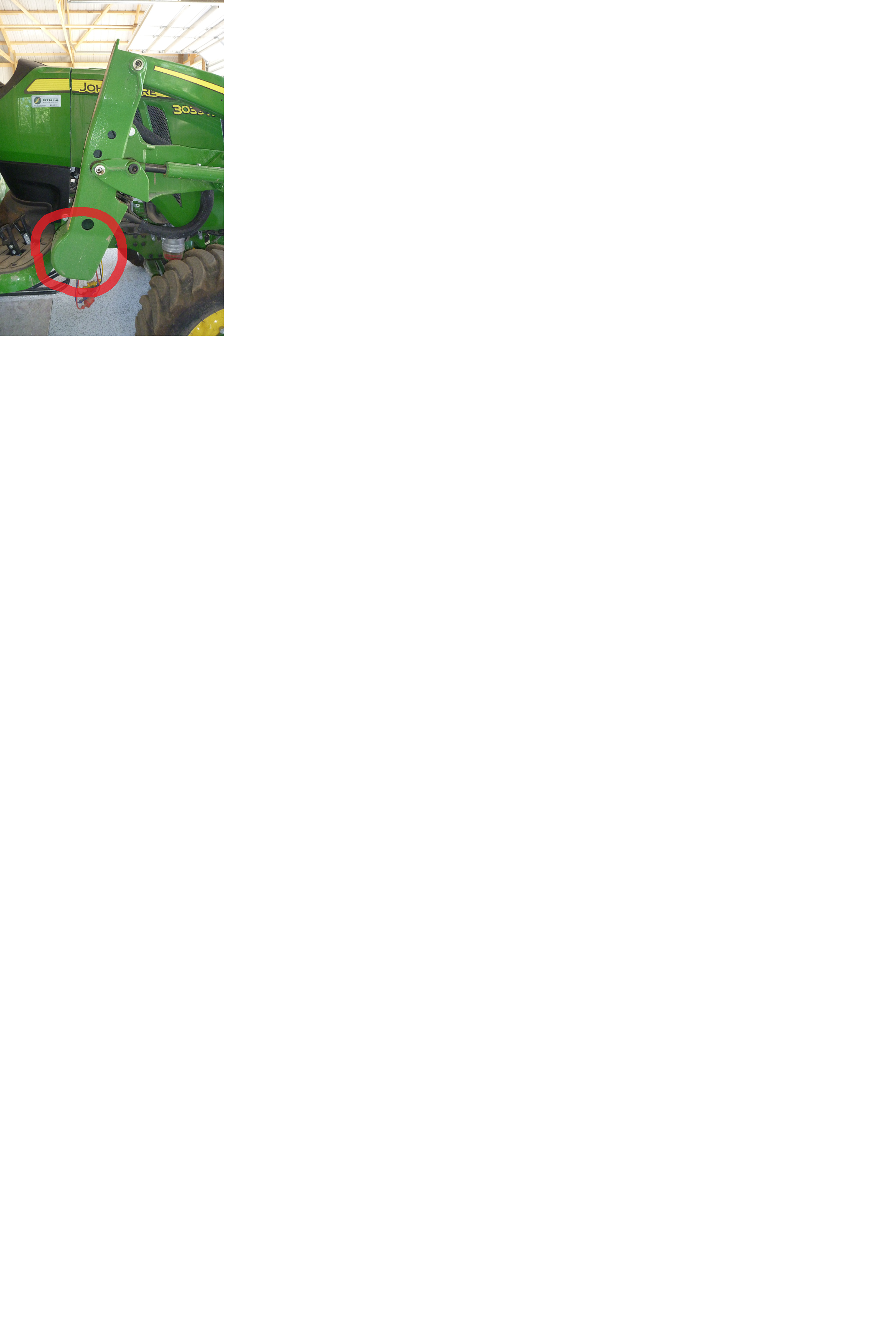

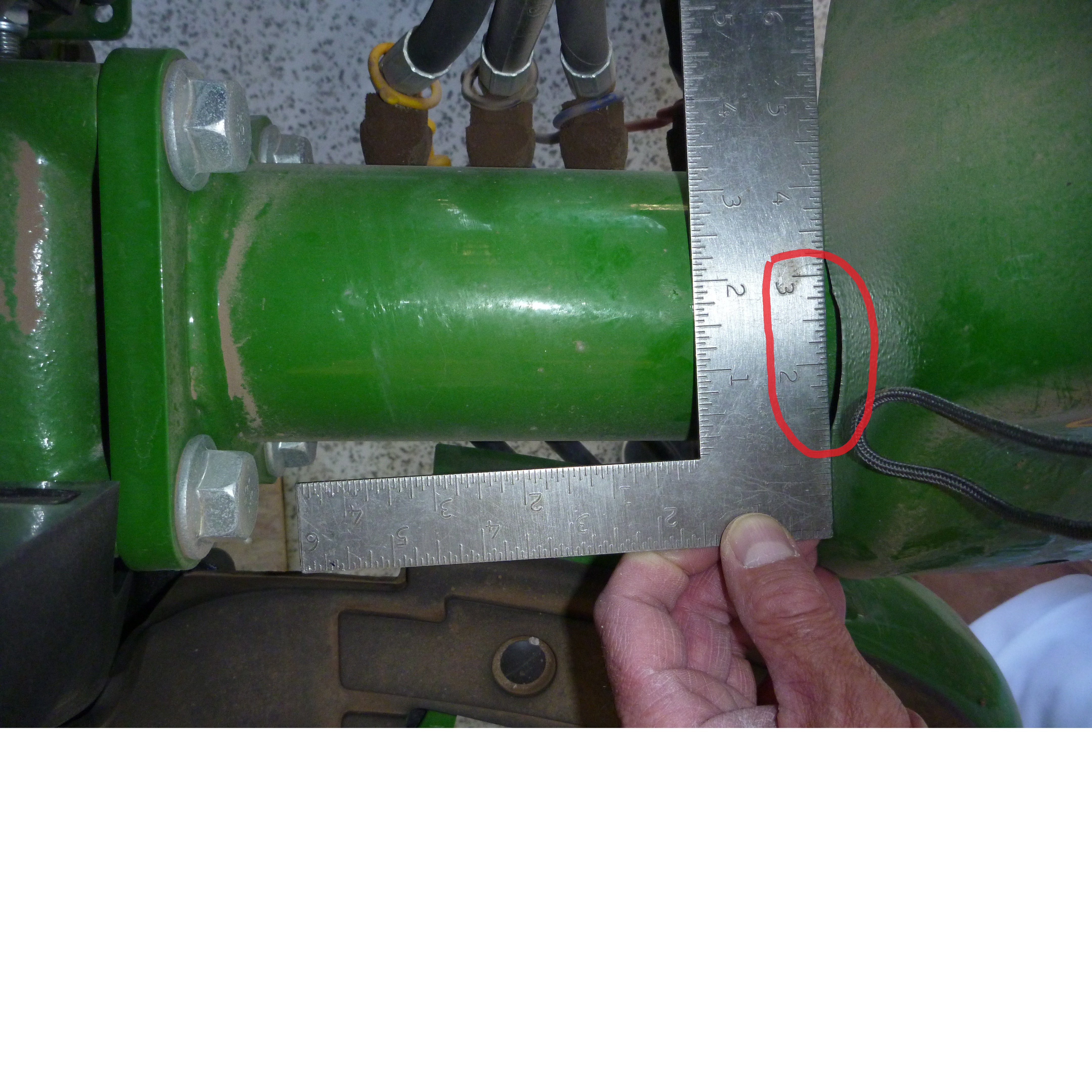

I'm having trouble understanding if one side was out, why was it not clear that it came out?
Probably less visual clues, the newer style covers the tractor frame mount making it less obvious the loader frame mast is not seated properly. If there was a picture of the inner side, the gap would have been more apparent.

Hello, everyone. I took the tractor to the dealer yesterday morning. The service guys looked at it and said, oh, that's an easy fix. It was fixed and I was on my way in ten minutes. Good job Stotz service department in Bluffdale, Utah. The problem, as mentioned by some smart people above, was the quick-attach system on the right side had become loose, and once some weight was put on it, it become completely disengaged. The right side was too loose, the left side was too tight. The guys corrected this, showed me what to do, and how to check it. It's embarrassing, and I realize that tractors are tough and meant to be at least partially fixable by the end user. Thanks again to all who contributed to this thread.
