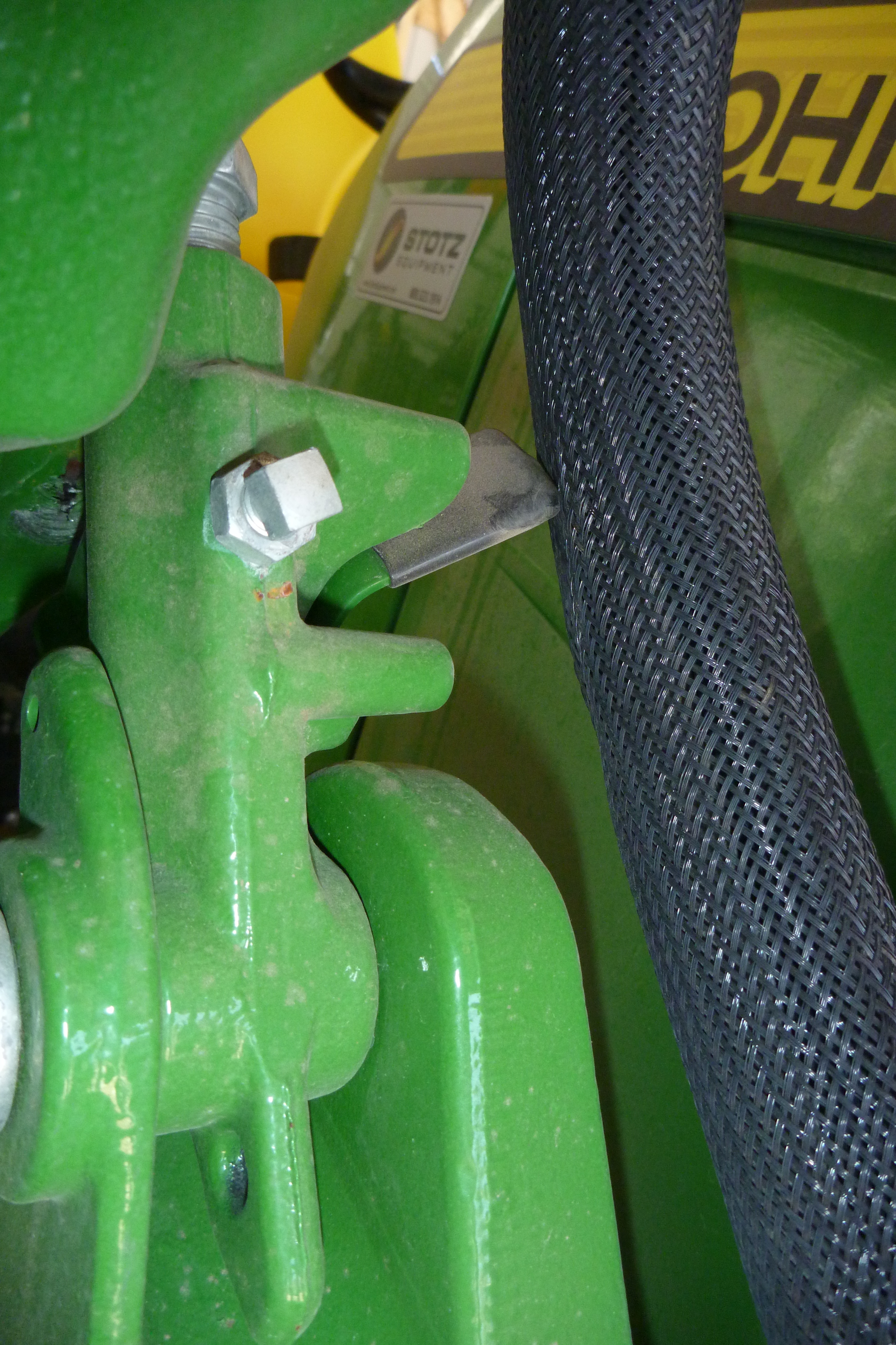

Except that the right side is not locked in (as the OP said in their last post). Unless there is something broken that let it unlock the dealer will probably say that it was "user error" due to not keeping the loader arms locked to the tractor side of the frame.
Well if one lock was not engaged properly, even a really heavy duty loader would probably get all twisted beyond repair. The OP refers it on the post on the previous page.
Yes, IMO this is due to the one side of the lift arms not being locked to the tractor frame.
The dealer may warranty it as a mechanical failure (especially if they can find a mechanical reason why the lock disengaged, or if the OP is on the service writer's good side and the service writer is creative in how they write it up). They might also cover it under "goodwill" (where Deere eats the cost of something that might or might not be covered under warranty.
If the OP has insurance that covers "user error" that should cover this as well.
OP, I would try not to be inflammatory when you take/send the tractor to the dealer. Make sure they understand that you have never removed the loader, so you didn't have any reason to check the loader mounting latches.

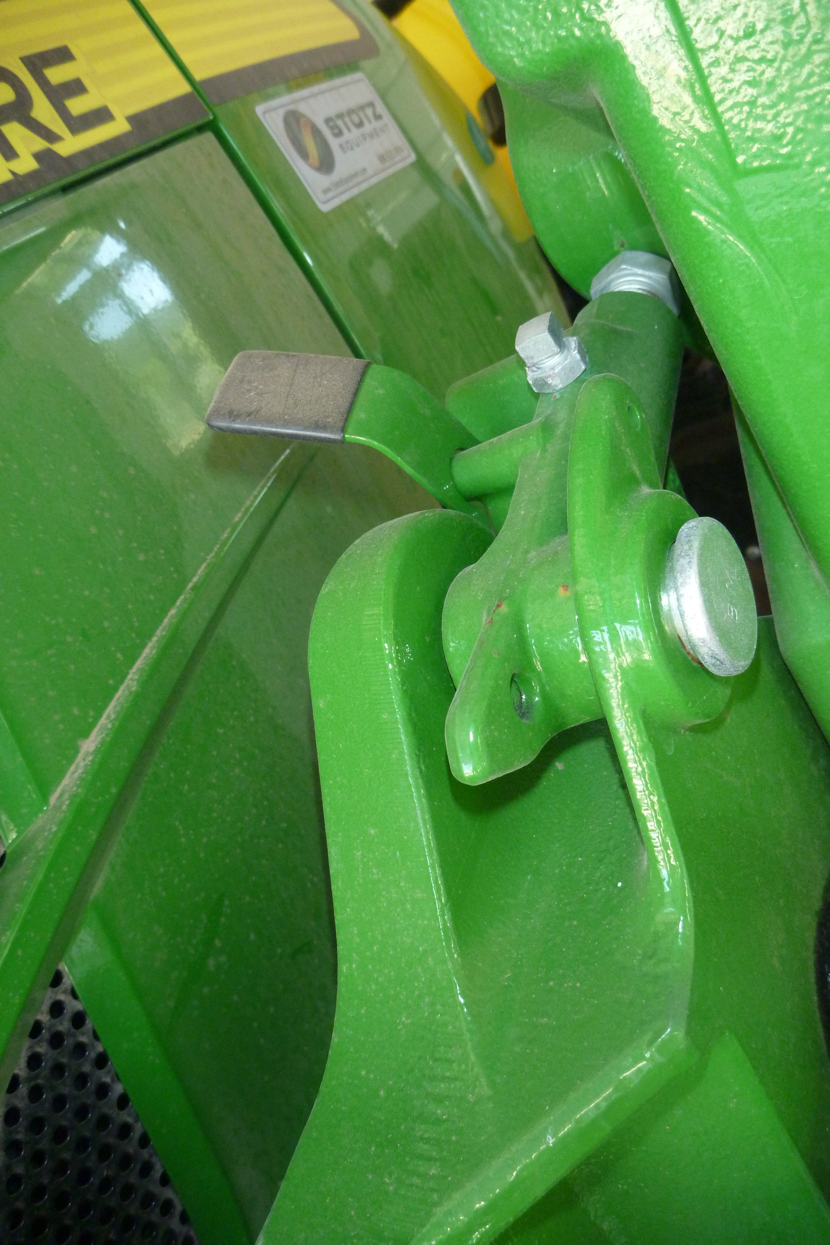

Here are pics of the disengaged right side and the normal left side. I would never think to take pics of something for future use like this; I have pics, but not close-up details. It's going to the dealer tomorrow. P1100218.JPGP1100221.JPGI guess I shouldn't have touched the lever as it removed the dust.

My opinion (which doesn't count for much): I'd say the OP has given us the correct version of things.
He was exceeding the weight limit, but that wasn't exactly the problem. The problem was, that the load was not centered on the lift arms/forks. With this imbalance and maybe a slight incline, the right mast, which had more weight, gave way. This can be seen in the one picture. It either broke the welds on the mast mount to the tractor or the tube from the tractor to the mast twisted.

One thing I don't understand, is why so many people keep ignoring the fact that the OP already mentioned and showed pictures of the lock that was not fully seated causing the twisted arms.
If that lock had failed with the loader arms lifted all the way up, it could get seriously dangerous.

Exactly, this damage appears to have been caused by the lock that holds the lift arms to the loader frame becoming unlocked on the right hand side.
No abuse or impact would be needed to cause this, just trying to lift something that is heavier than the side-to-side resistance to torsion of the loader arms itself (which will be much lower than the lifting capacity of the loader).
