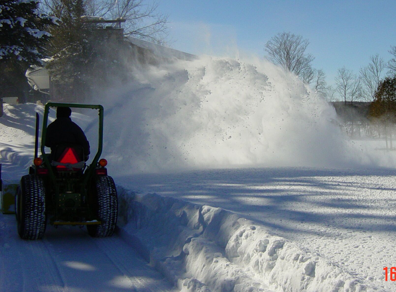

Going to be mowing and snow blowing with my tractor. Looking for recommendations

This was years ago. JD 770, front blower.
Never had any bad issues with the Turfs, except the Odd time, I kind of drove into a Dip, and couldn't back out. Rear 3PH weight would probably have solved that.
In certain slushy conditions it's also nice not to have more aggressive tire tread marks making for a washboard when it freezes.
