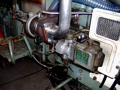

With our recent snow fall, I decided to do some snow blowing over the weekend. Unfortunately, the tractor was blowing some oil out of the exhaust. I could see the moisture, but I thought it was just melt water from the snow that was blowing back. The oil is everywhere. It covered the building at least 8' up, you could see it on the ground (it looked like black sand flecks). The tractor is just as covered as I was. Because the oil mixed with the blowing snow and the cold temps it immediately congealed into this thick tar like goo. I'll have to wait for warmer temps so I can clean the tractor and the building. Hopefully, it won't stain the paint, but there's a good chance it will. My jacket is already stained. We washed it several times and the color won't come out. Thankfully the oil was new, so it didn't stain my face. Old diesel oil will stain the skin for a couple of days. The turbo worked really well. I only throttled up to 3/4 throttle, but this thing has way more power than I was expecting. Talking to a turbo shop, it sounds like my oil return line was too small allowing pressure to build on the bearings a leak past the seal. With a larger drain line it's probable the oil leak will go away. The snow blower worked exceptionally well. The snow was dry and rock hard so I got some good distance out of it. The larger pieces were probably flying close to 60'. The drifts around the building were a good 20" deep and the tractor just chewed right through it. Only occasionally would I shift to neutral to allow the engine to recover. I wasn't comfortable fully loading the engine just yet. The power shift is great, but I'm not thrilled about having to use the clutch for the ranges.

When I was running the tractor, that's what I was telling my self. No, it was definetly oil. I checked the dipstick afterwards and it didn't even register. I added a quart and that got me about half way up - still a half quart low. Now that's with a 2 quart capacity!

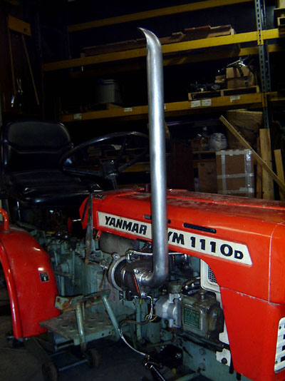

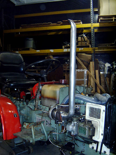

Hope the bigger drain line fixes it. I haven't taken any more pics yet, but have been using my tractor quite extensively (actually, my father-in-law has). It pulls a 90 year old IH drag disk around with no problems except for the turning aspect due to light weight. Pulls it in 6th gear with no bogging whatsoever. There has been about 20 hours put on the motor since the turbo add-on and so far it has met expectations. I snagged an air cleaner box off an old Dodge turbo 4 cyl motor, but haven't had time to hook it up yet. I do need to, however, because my air cleaner is quite restrictive (I knew it would be).
My in-laws are visiting from Mexico. My father-in-law was a banker down there, so this farming thing is new to him as well as driving a tractor. Didn't take him too long to get used to it and now I can't get him off the dang thing to drive it myself. I'll take pictures of it working and post them maybe this weekend.
All in all, to me, the turbo was a worth while investment for me. It made the tractor more powerful, smoother, and just as fuel efficient as naturally aspirated. I haven't noticed a negative side to the conversion yet.

I swapped out the -4 drain for a -6 and the problem was solved. She pulls like a champ with no oil control problems.

I have a couple of pics posted above. Look for the "attachment" link in the message line.
Anybody know how to post a .wav?
