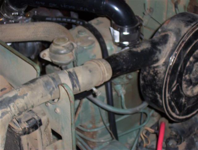

Drop the stock air filter (you can keep it for later if you ever nerd it back up) and put on a larger canister or build a box above the battery that contains a K&N. Put a snorkel on the box to limit dust intake. The stock filter is too small for the increased airflow. On a dusty day you will have to clean it every hour and if your turbo dies it will be the air filters fault.

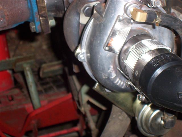

This is the one on my little 1110d. I havn't done much testing with it yet as I don't have the pyro hooked up.

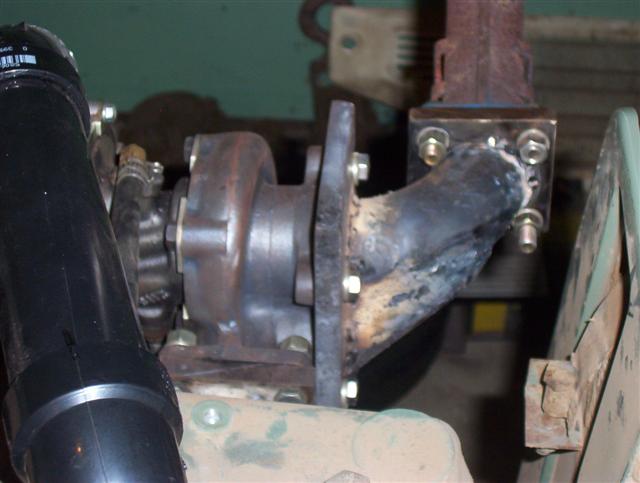

The turbo is off a Yamaha Seca 600. It's small enought to fit in the palm of your hand. The exhaust pipe is 1-1/4" schedule 40 pipe that I welded up.

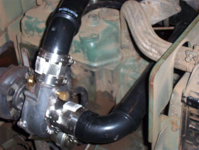

The biggest problem that I fear is that the turbo may be too large. The bike was a 600 and my diesel is a 630 +/-, but the difference is in the rpm range. The bike reved up to 10k, my diesel tops out at 2.6k. I would have used a smaller one, but I havn't found it.

My 1110 is pretty close to the 135. I just got the pyro gauge the other day, and havn't purchased a boost gauge yet. I also want to hook up a oil pressure gauge. On a larger tractor I wouldn't be concerned about the oiling system, but I only have a two quart capacity! The oiling hole on the turbo is only 3/32" so it won't steal too much oil.

That looks great. Your welding is a lot better than mine. I'm not sure where you could get a smaller turbo. Perhaps you can get by with changing the vanes?

The smallest automotive wastegated turbochargers utilized here in North America are the turbos off the Volkswagen and Audi 2.0 liter gasoline engines, the Garrett GT15 and the KKK03 (their two liter turbodiesel turbocharger models (VNT15) all have variable vane and nozzle technology which requires electronic CPU modulation to control the boost pressure.)
Both of these tiny turbo models put out about 1bar boost and the turbo maps have good choke and surge characteristics. You can get them at foreign junk yards or on ebay for about $300-350 used.
