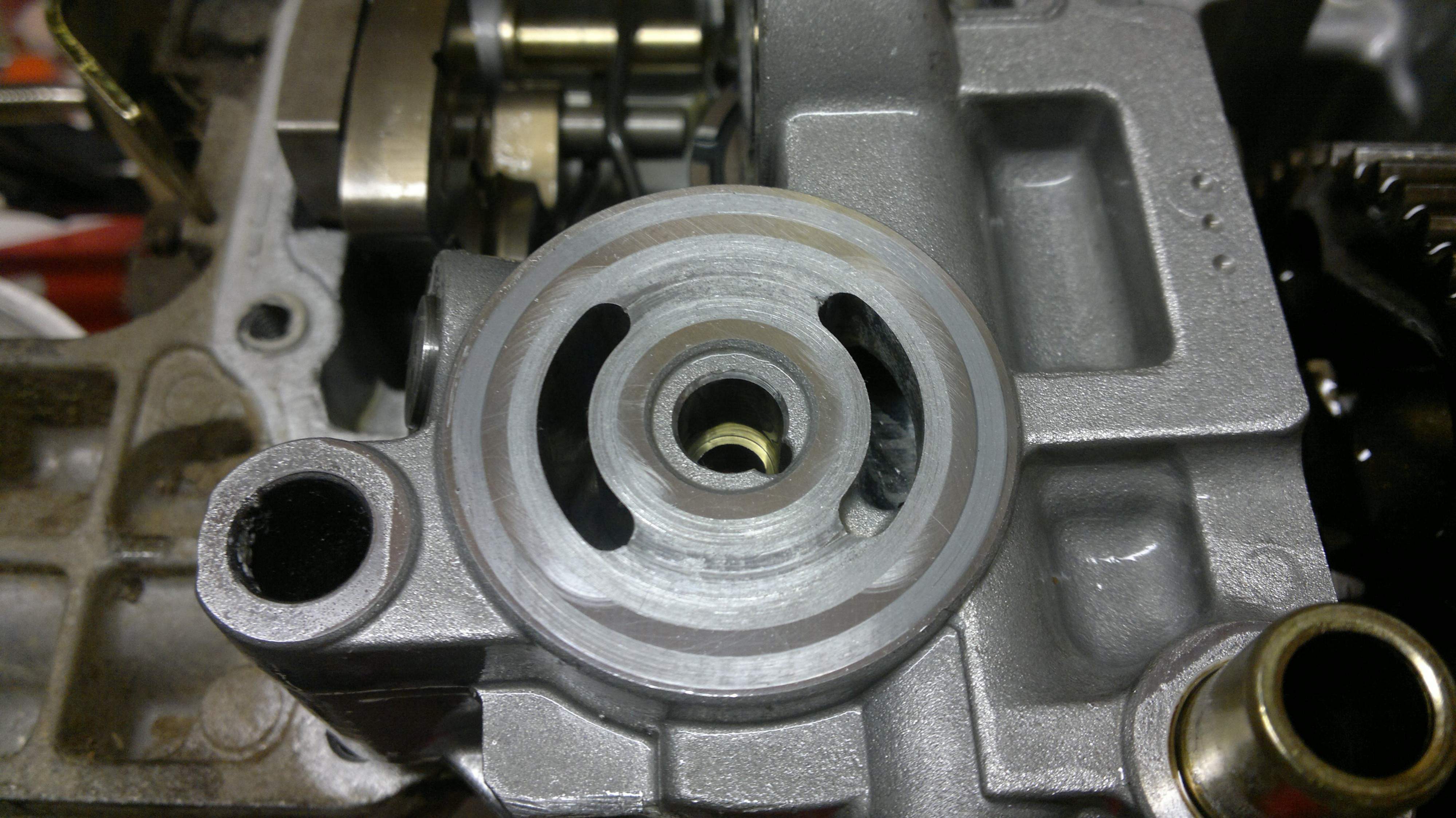

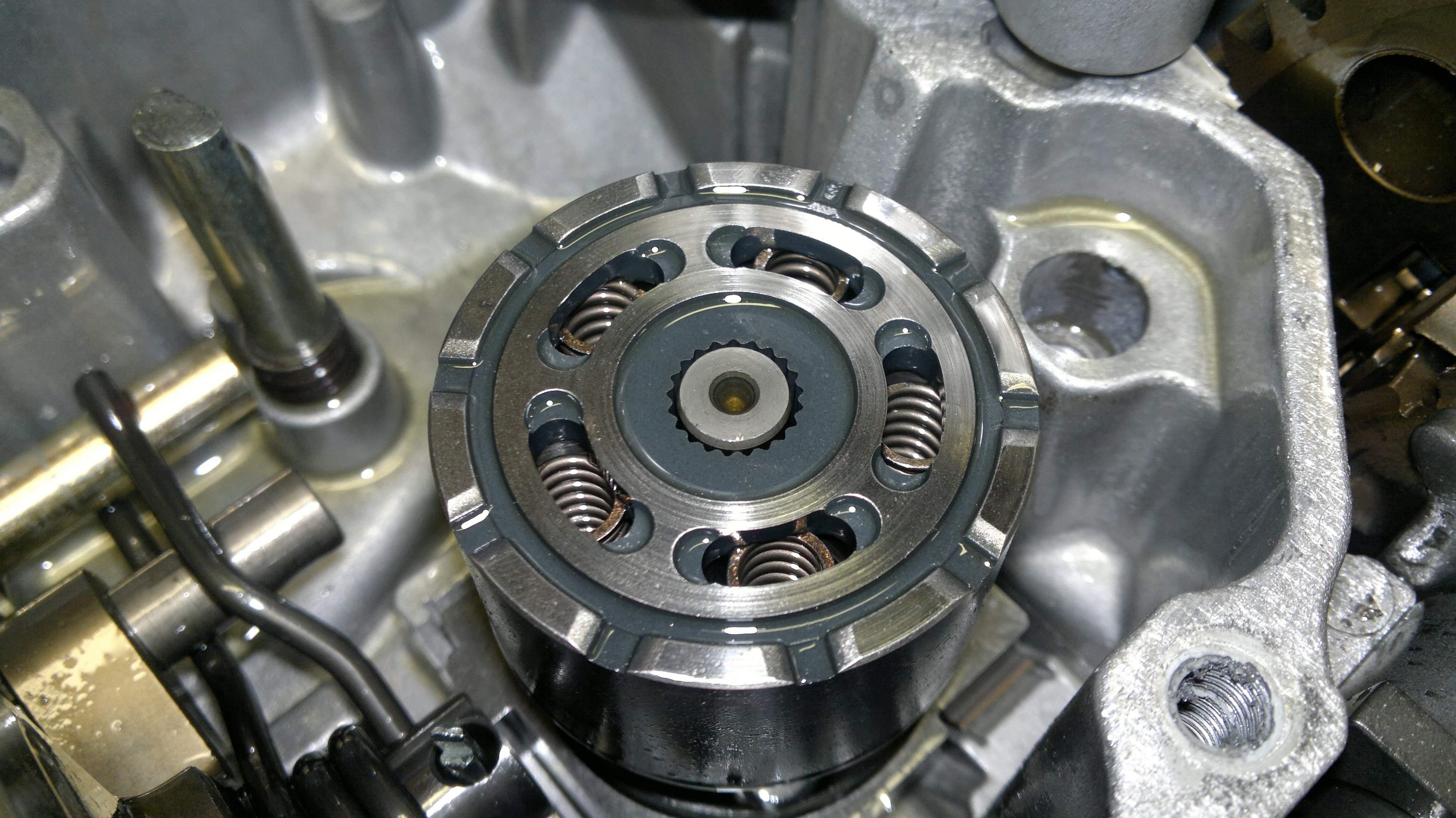

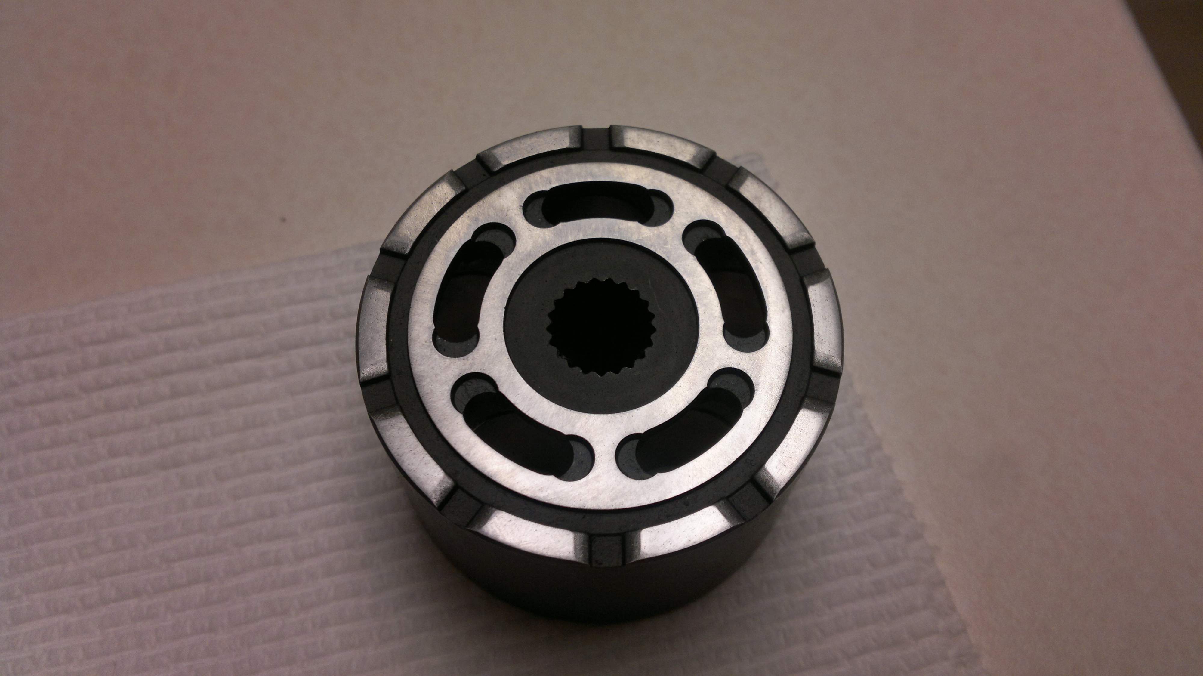

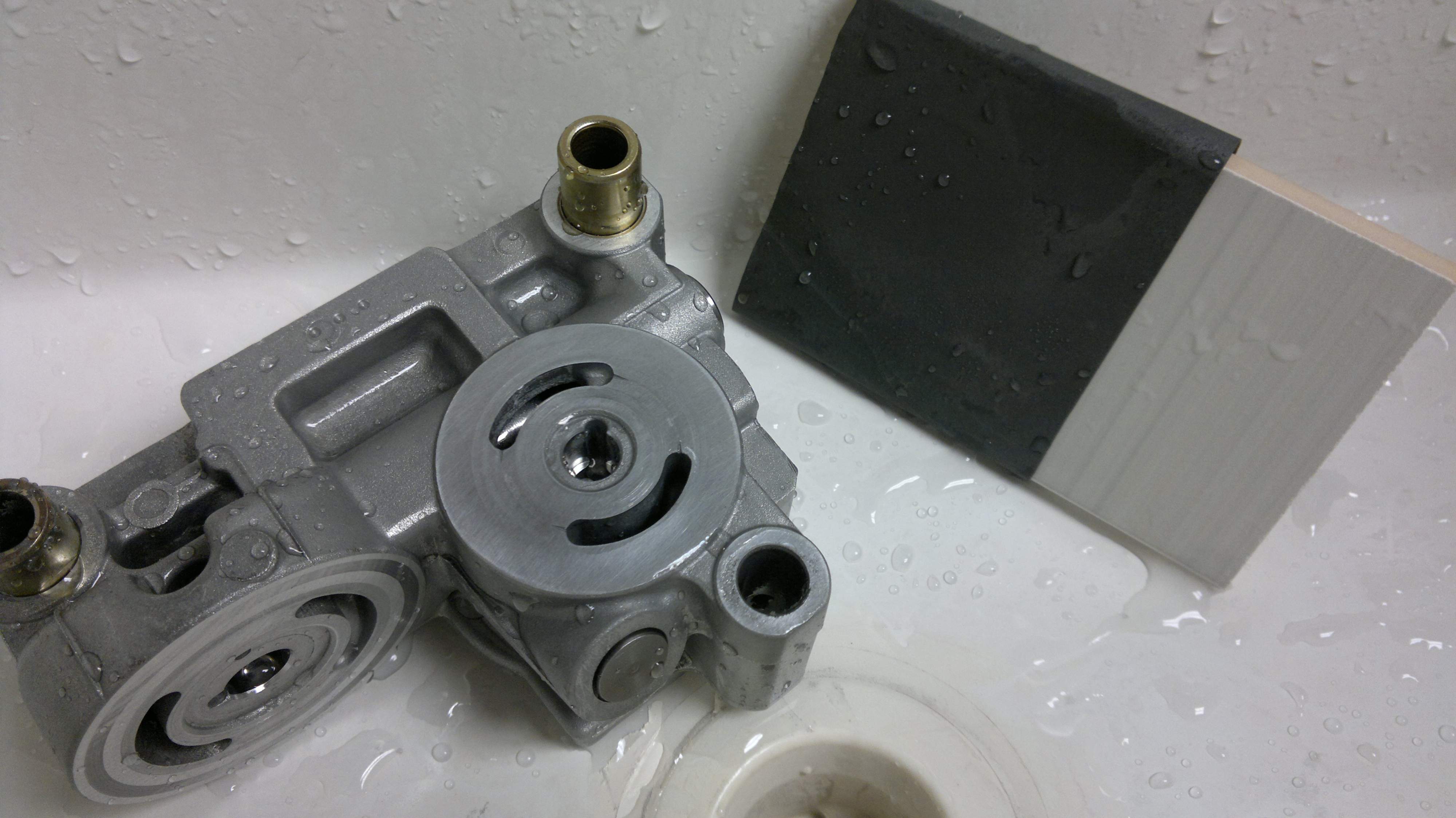

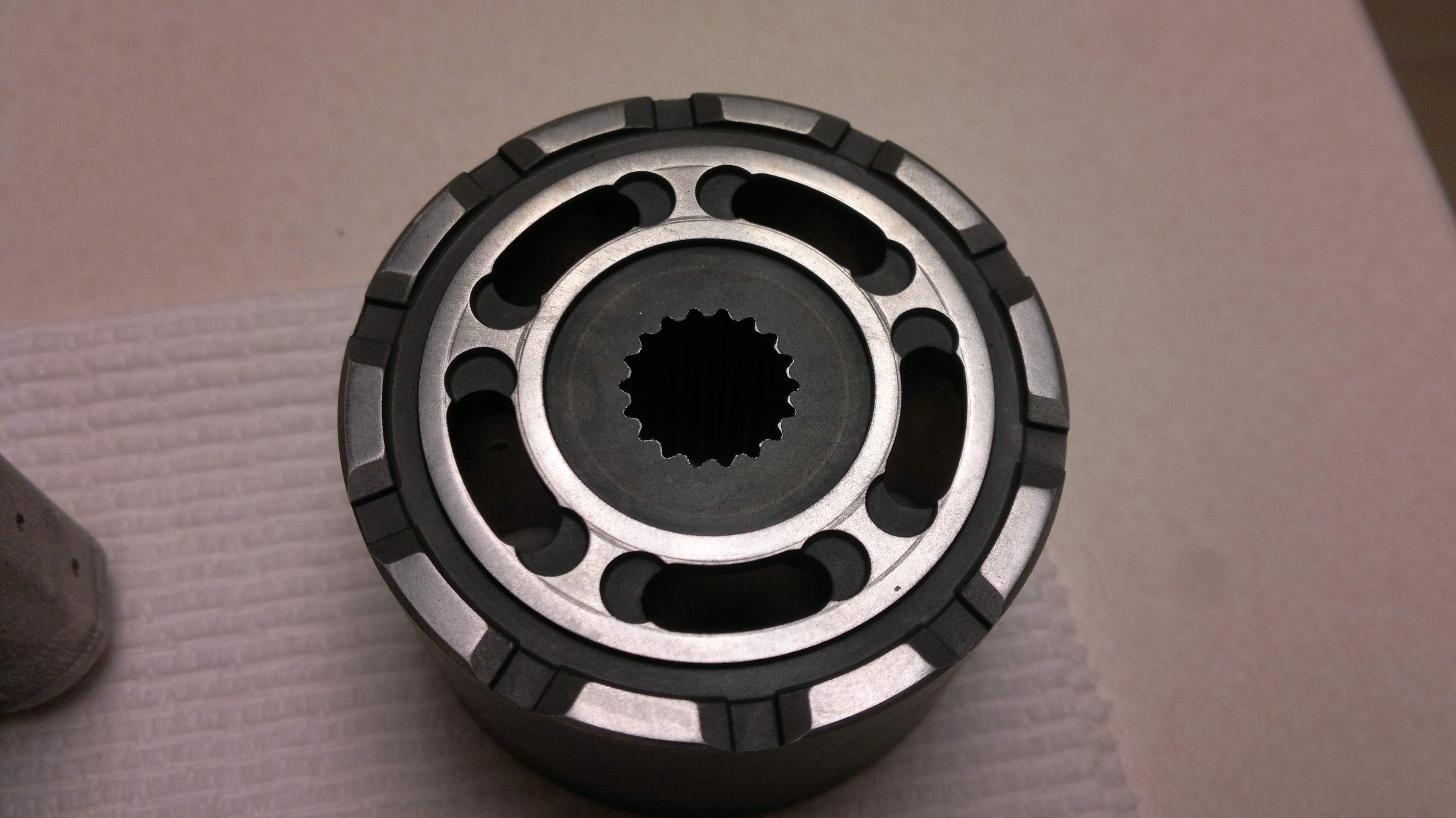

just to keep this thread going. I have ordered a rebuild kit. I guess i could have sanded it down, but after 375 hours this mower really doesn't owe me anything. I've only ever changed belts on it. Mow 2 acres, once or twice a week for 11 years. Started getting bad after i dragged a harrow around for a while landscaping the front yard. Right after that the power was never the same and over the 3 years after that landscaping it was a struggle up any incline and it was hit and miss for power. If it was hot out forget it, the thing was like a turtle. Fall and spring were okay. I changed out to a heavier gear oil last week to see if i could salvage it, but it just made more noise than it ever did. Hoping this $450US dollar fix kit works. Here's some photos of what i pulled apart.

Cleaned.

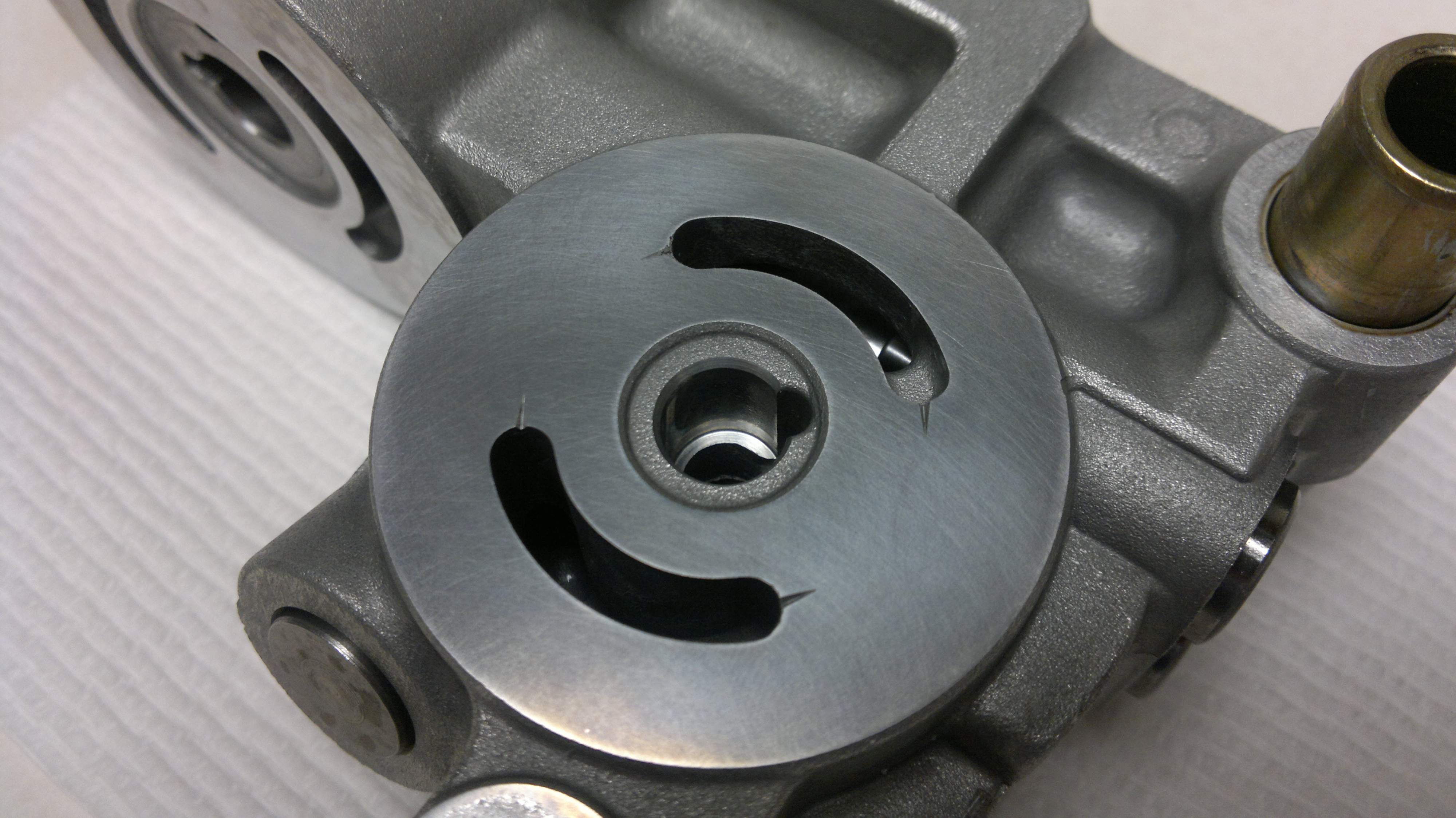

Cleaned
