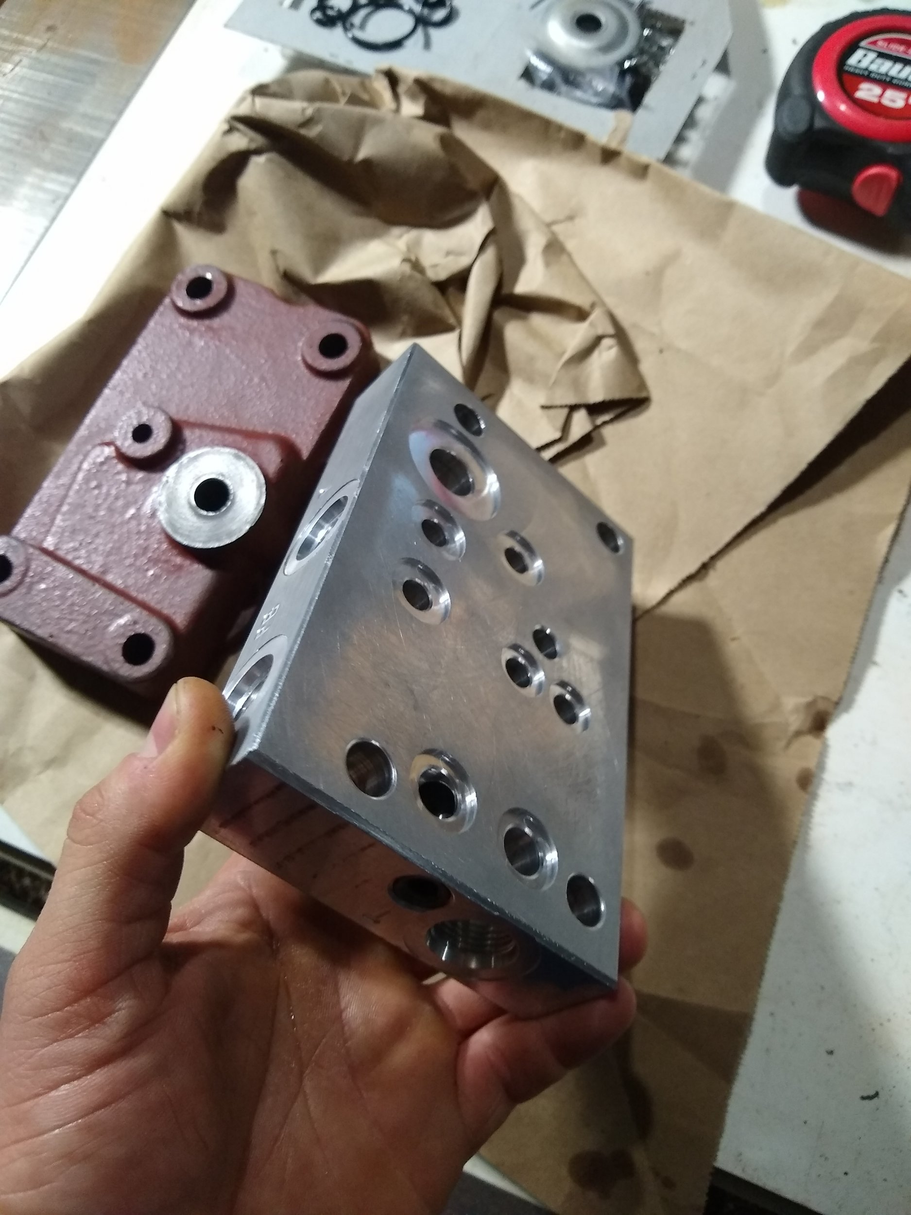

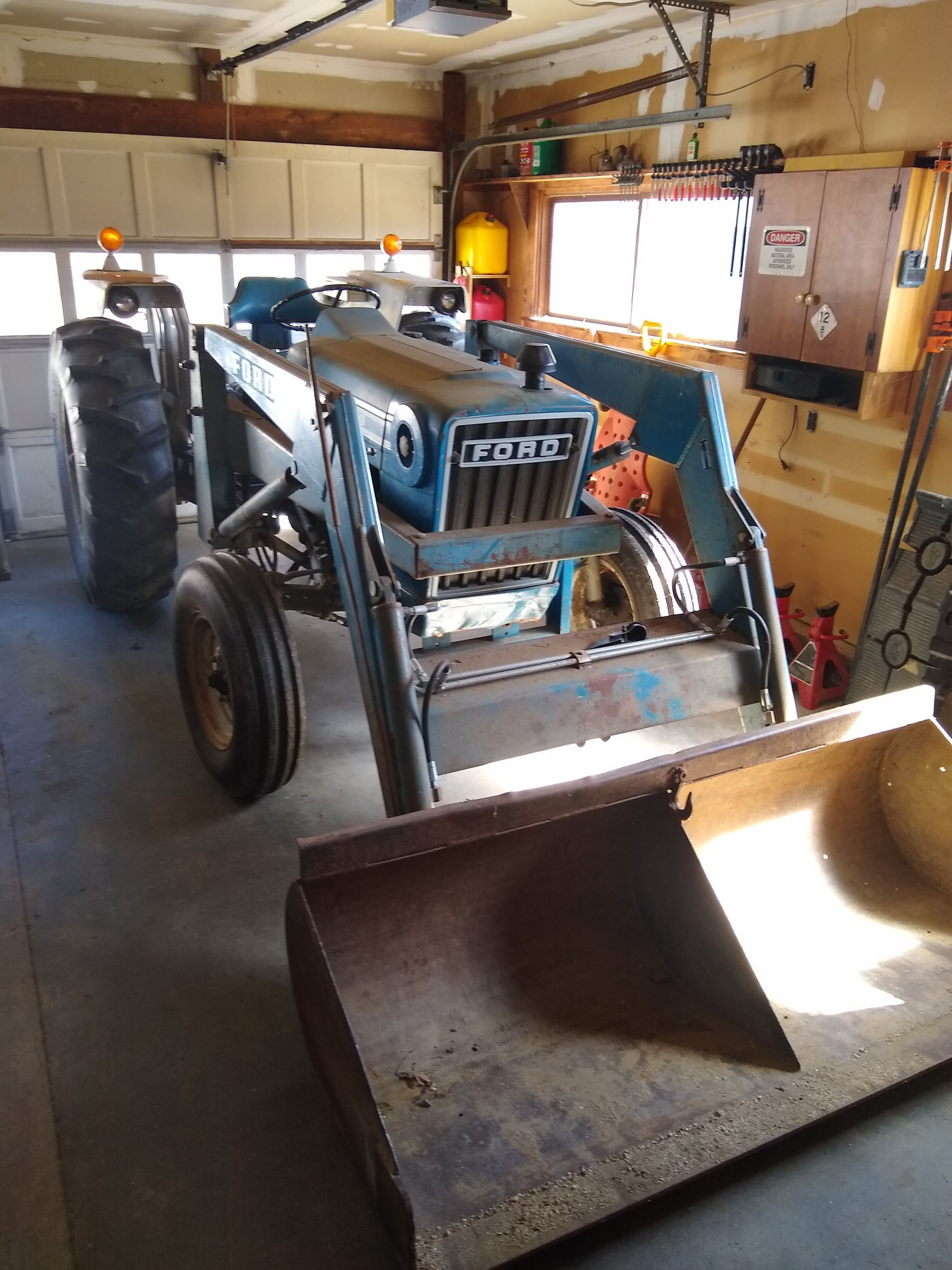

I'm redoing all the plumbing on my tractor and loader. The hoses are old and cracked, and I also want to change up the loader valve and rear remotes.
This is my tractor, late 70's Ford 4100. It has the internal hydraulic pump. Some tractors have an engine mounted pump or earlier Ford's had a pump mounted off the rear of the engine somewhere - in those instances you may have some other options. Not what I have though.
Anyways, I am using the HV5902 adapter plate with power beyond (NOT the HV4902 without power beyond). The reasoning is because the power beyond line will relieve the pressure on the new loader valve. The power beyond port on the adapter plate returns directly into the sump of the tractor. It's not necessary for this to work, but why not. It will be easier on the valve - cheap insurance in my opinion.
For whatever it's worth, I called Bailey Hydraulics (where I got my valve from), and talked with their tech department. They assured me if I wanted to use the HV4902 adapter plate and only use two hoses, that their valves could take the constant pressure that setup would create. Ultimately I talked with a member on here who guided me in the direction of using the HV5902, and I think it's the best way to go.

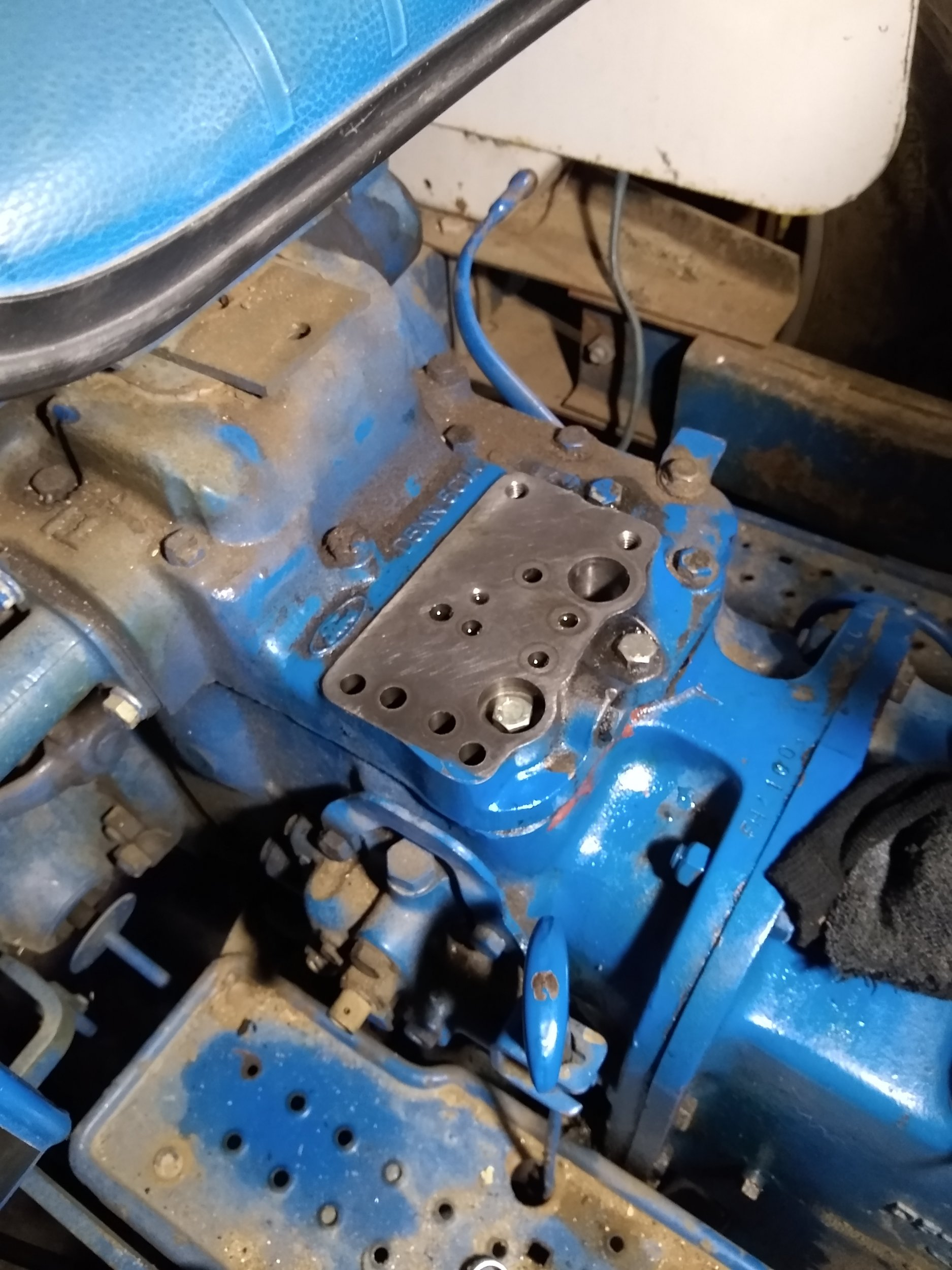

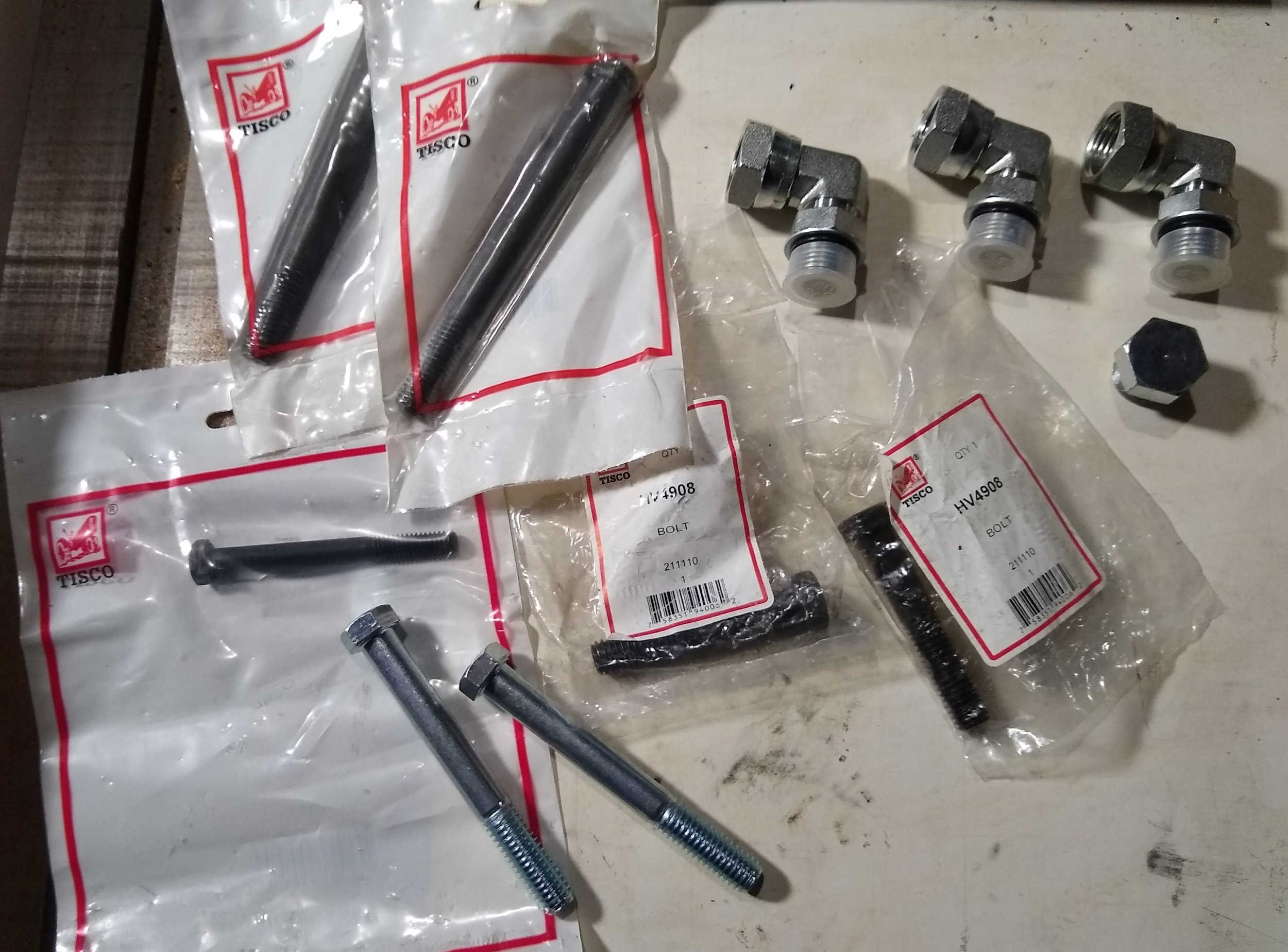

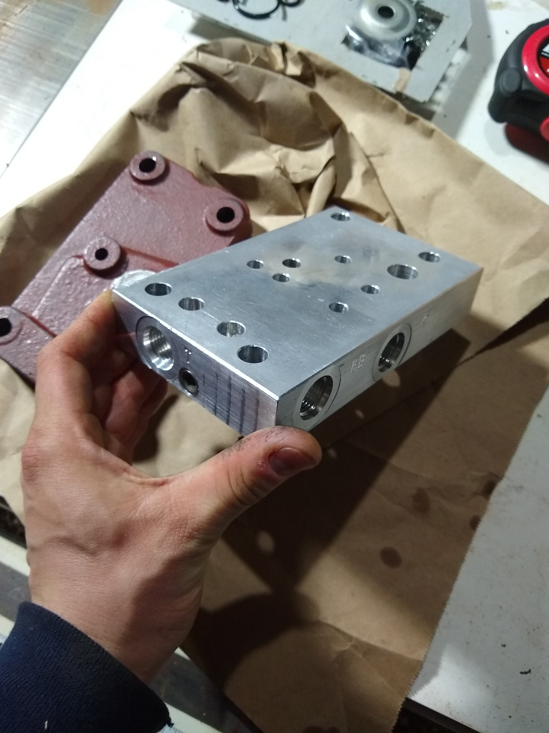

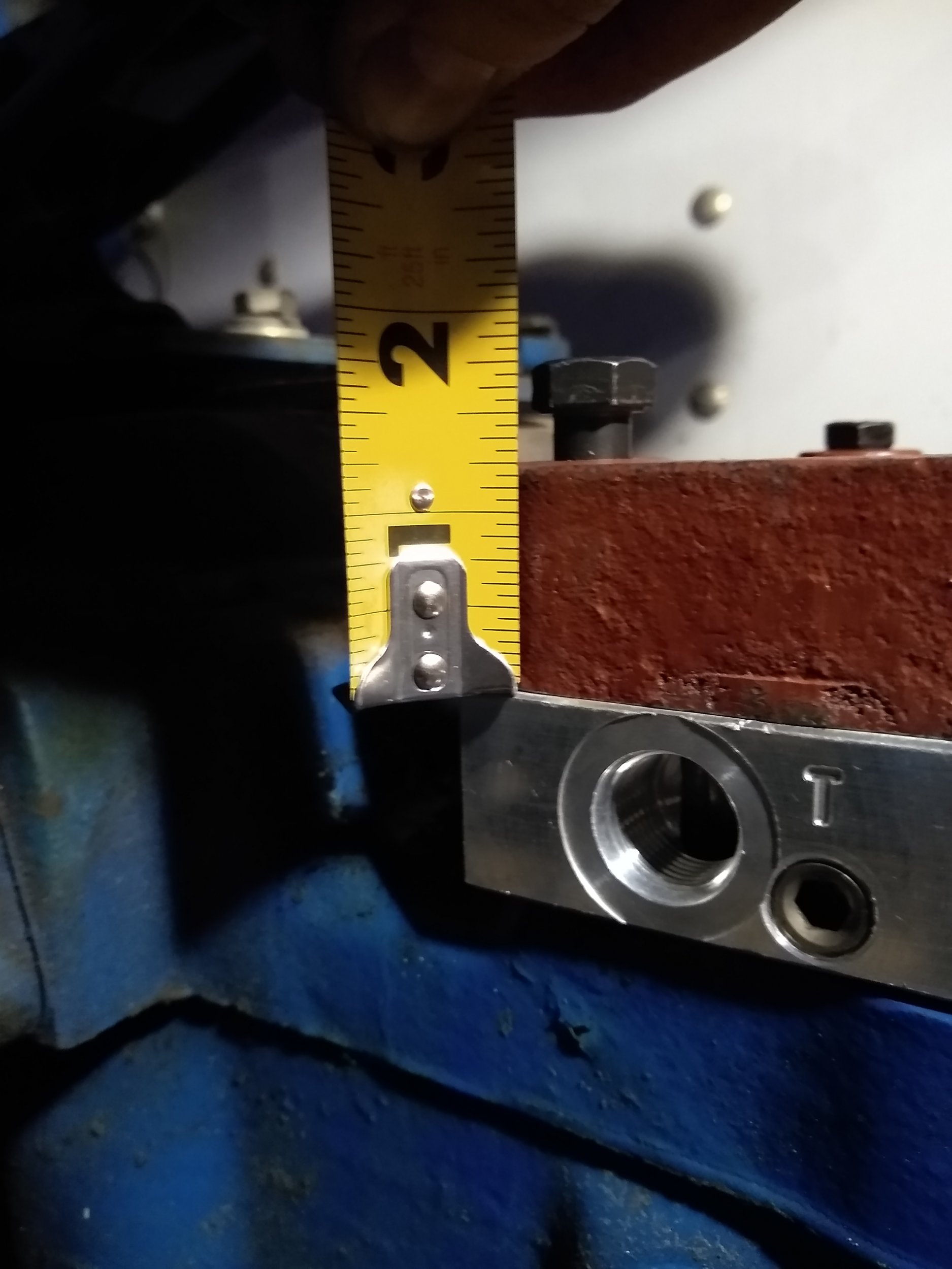

The adapter plate is aluminum. I stoned both sides to get it relatively flat and take the burs off. It comes with O-rings, a bunch of bolts, some fittings, and instructions. The O-rings stay in the plate good, but if they don't (because that side goes face down on the tractor) just use some vasoline to hold them in place.

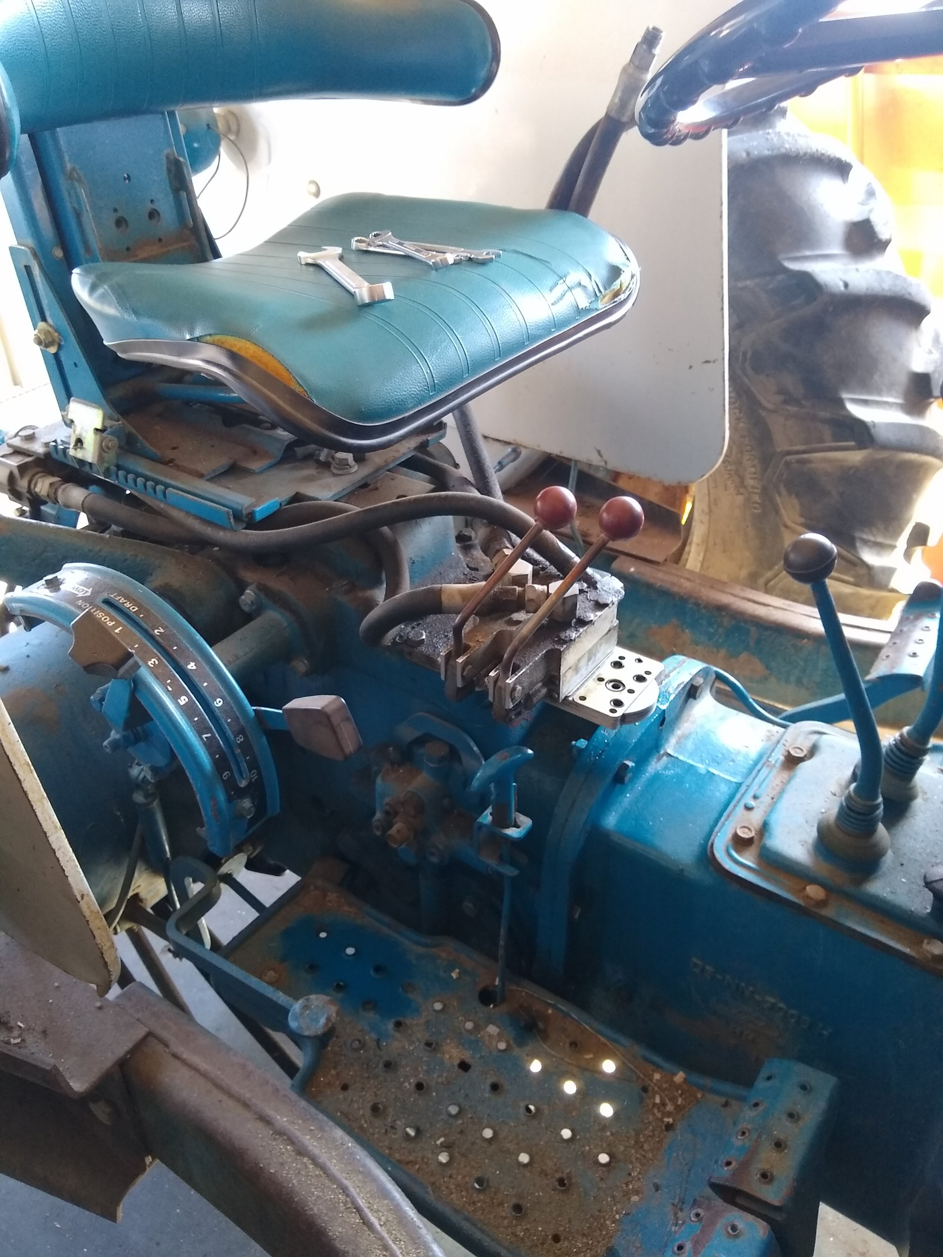

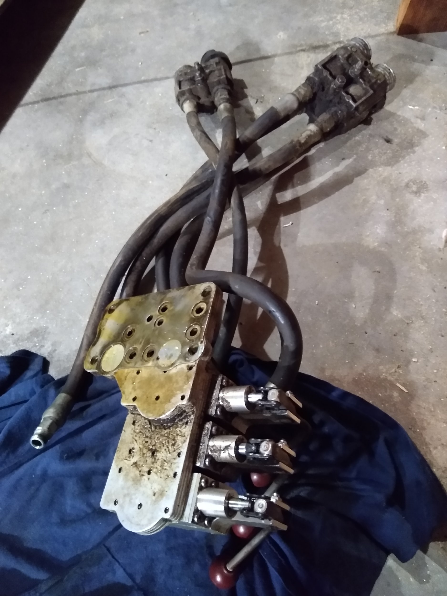

My tractor came with this oddball triple spool valve. Which was fine, but the loader didn't have float - and I want that. One of the many reasons I'm doing all this work. It only had 4 bolts holding it in. So no big deal pulling it off. I talked to a few old Ford dealerships near me, and none of them were able to identify this spool valve. Seems to be an aftermarket thing. I've never seen pictures of it online anywhere.
The problem was that now I didn't have a blocking plate for the top of the adapter plate. If your tractor doesn't have any hydraulics - it will simply be bolted in place where my old spool valve was. Other tractors might have some remotes, and there will be a selector valve on top - which will let you divert flow to either your remotes or the three point.

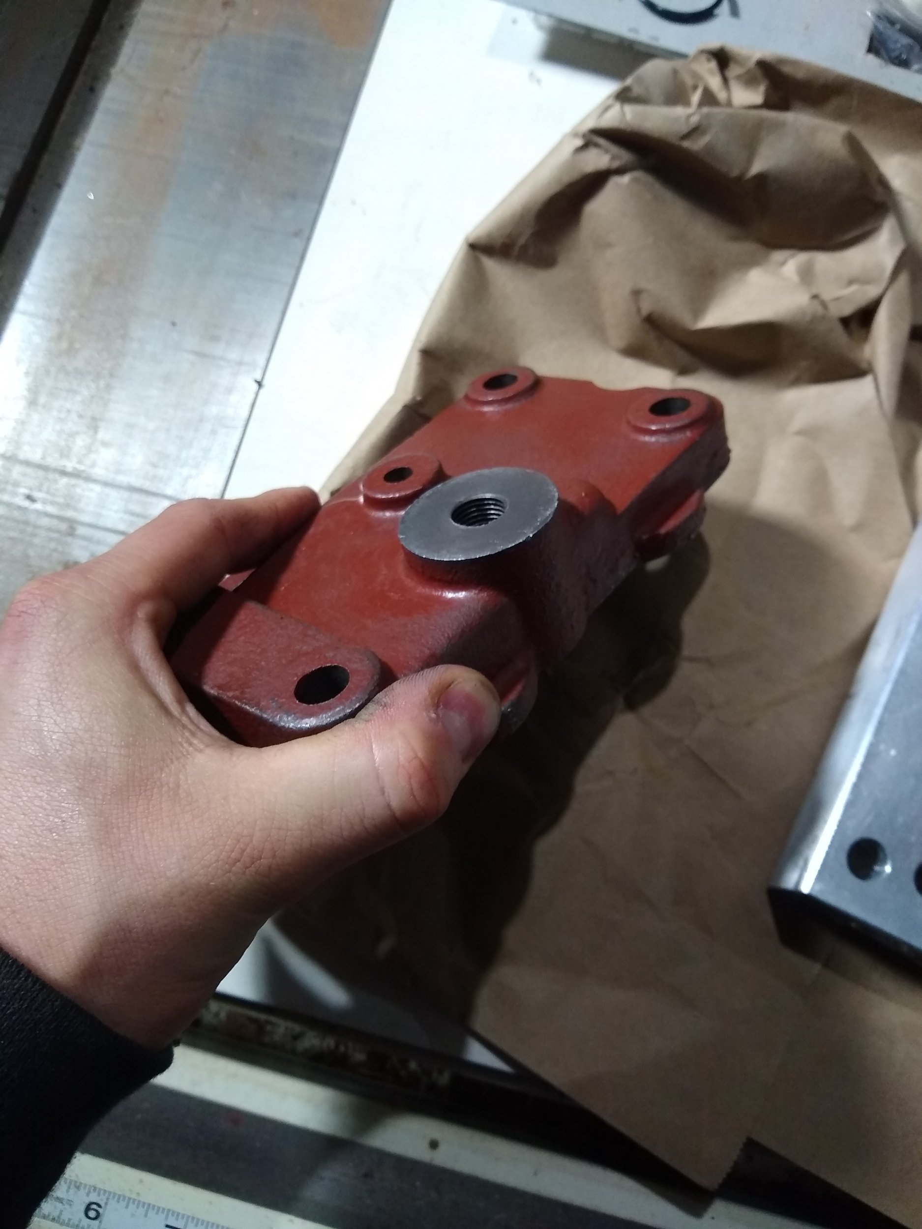

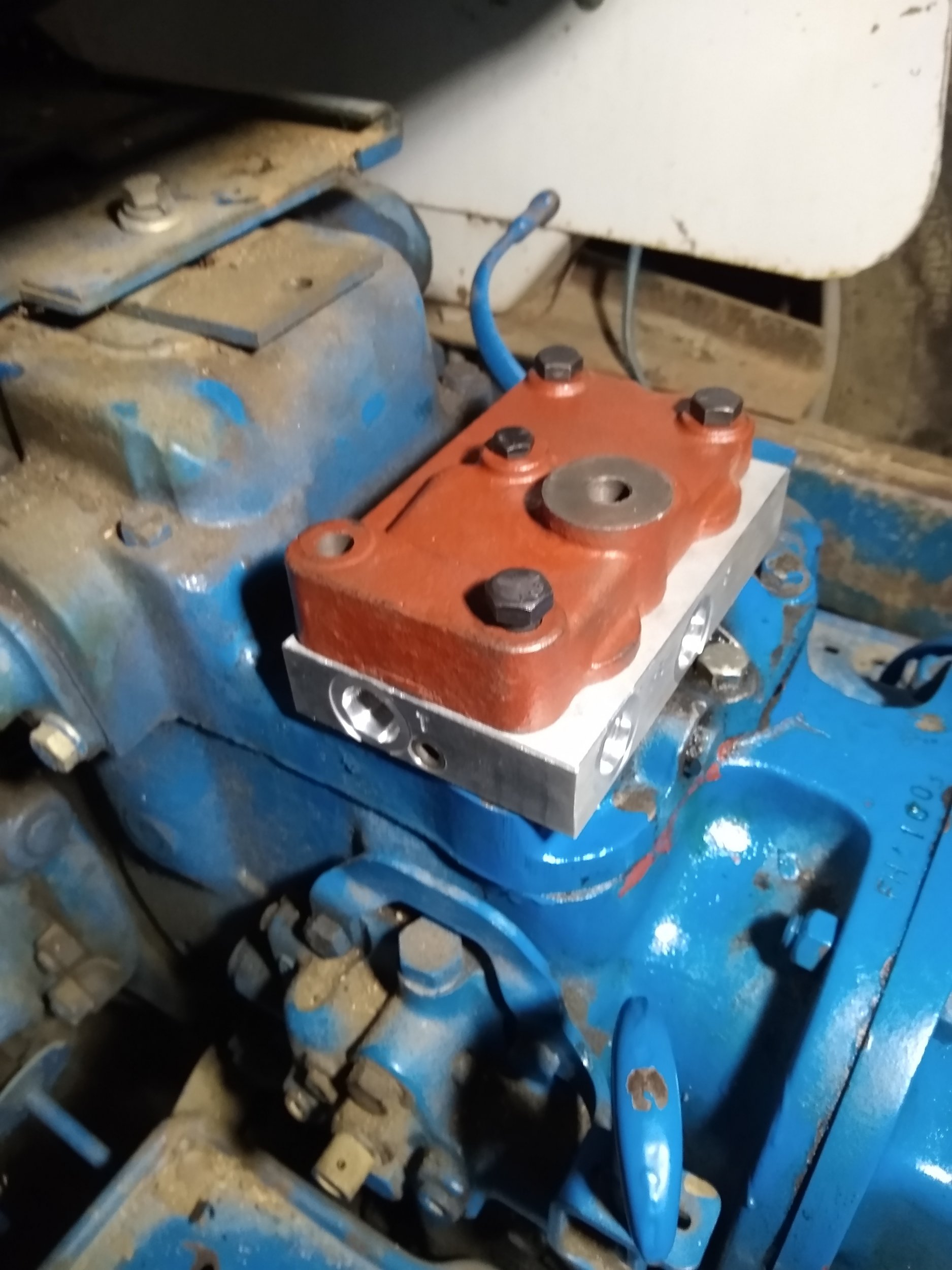

The beauty of this adapter plate is that you can just put the blocking plate (Ford Part# C5NN475B) on top of it. You don't need the selector valve thing and your three point will still work normally as well as whatever you plumb off the adapter plate. But if you want to you, you can use the selector valve on top. Not sure why you would want to though.

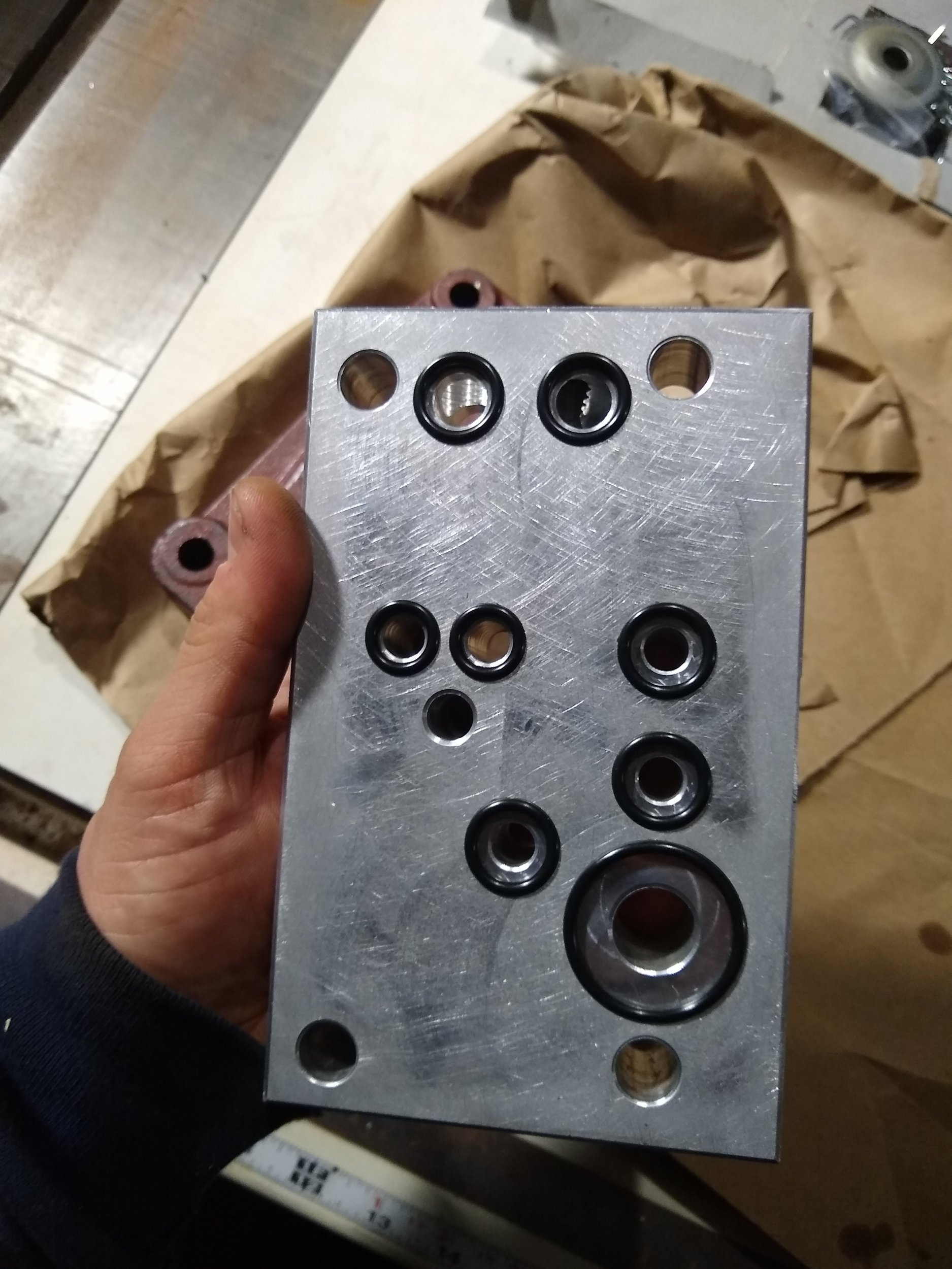

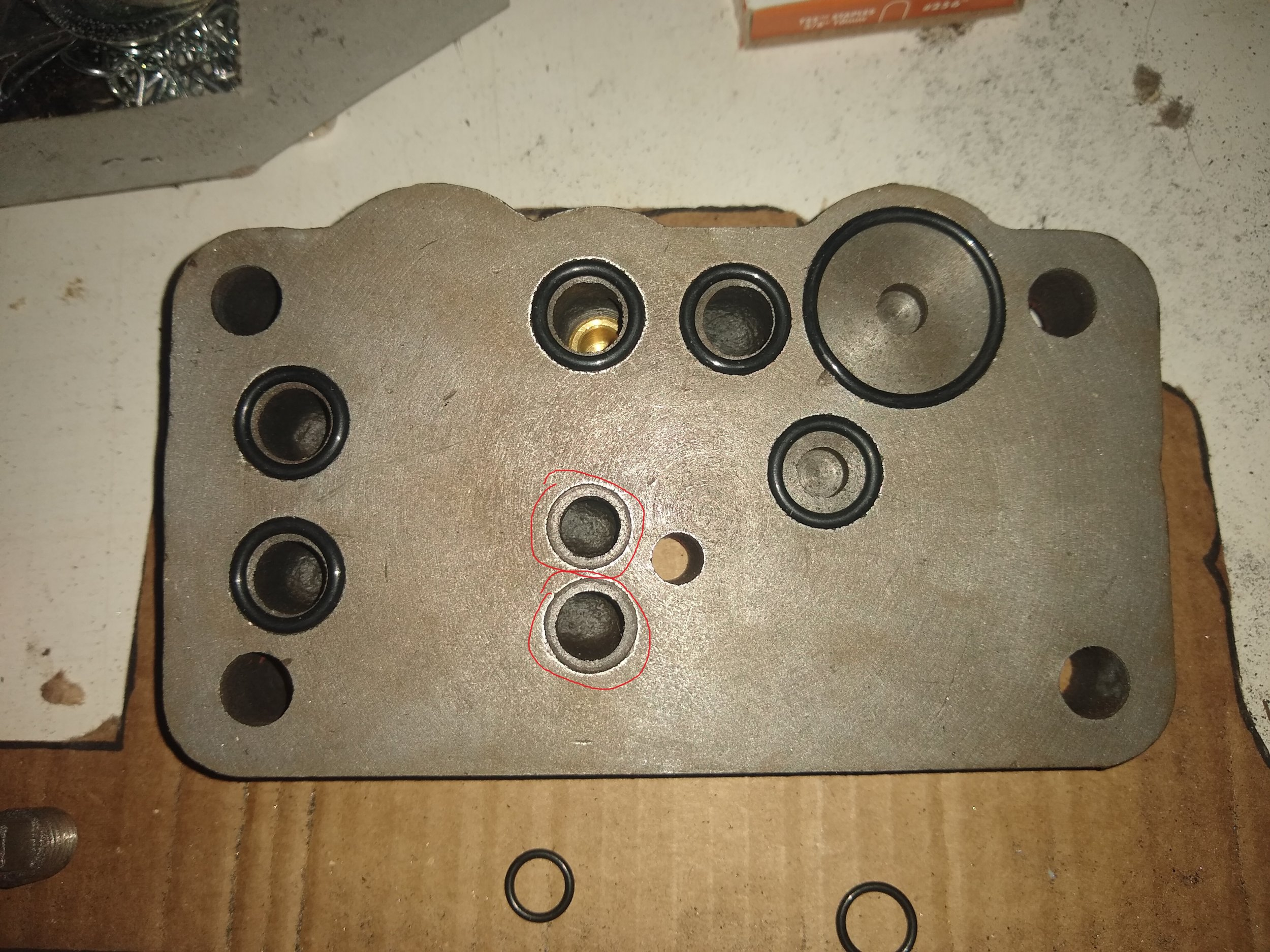

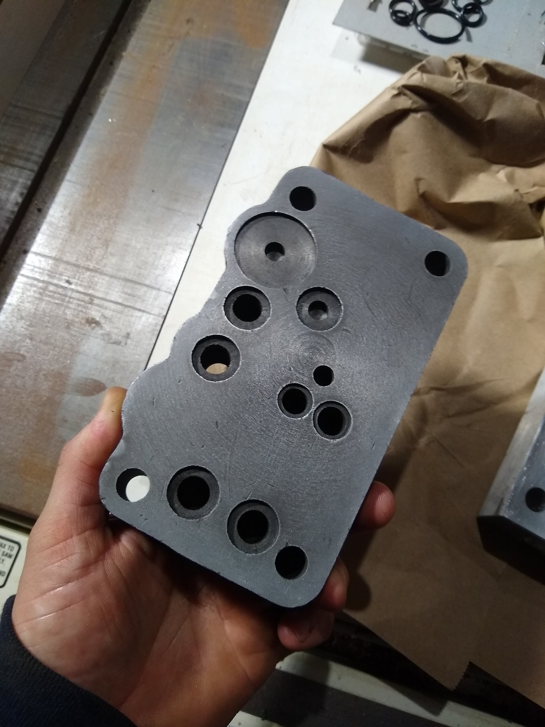

So I grabbed the hydraulic blocking plate cover (Ford Part# C5NN475B). It was pretty rough, so same thing. I stoned it to get it as flat as I could and get all the burs off. This part does not come with O-rings, so I'll need to head down to the hardware store and grab some.
I started mocking everything up at this point. I also lightly stoned the top of the tranny, I'm not terribly concerned about getting junk in the tank because I'm going to do fluids and filters after this is all said and done. Here's what the top looks like.

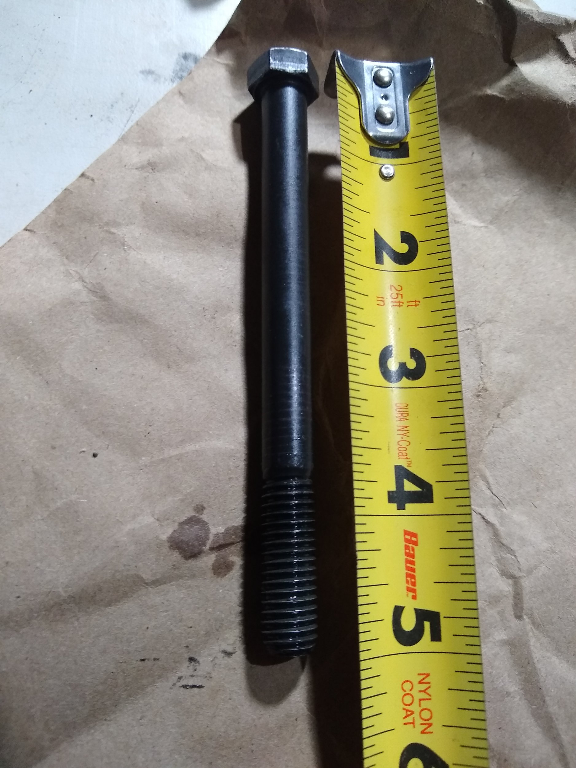

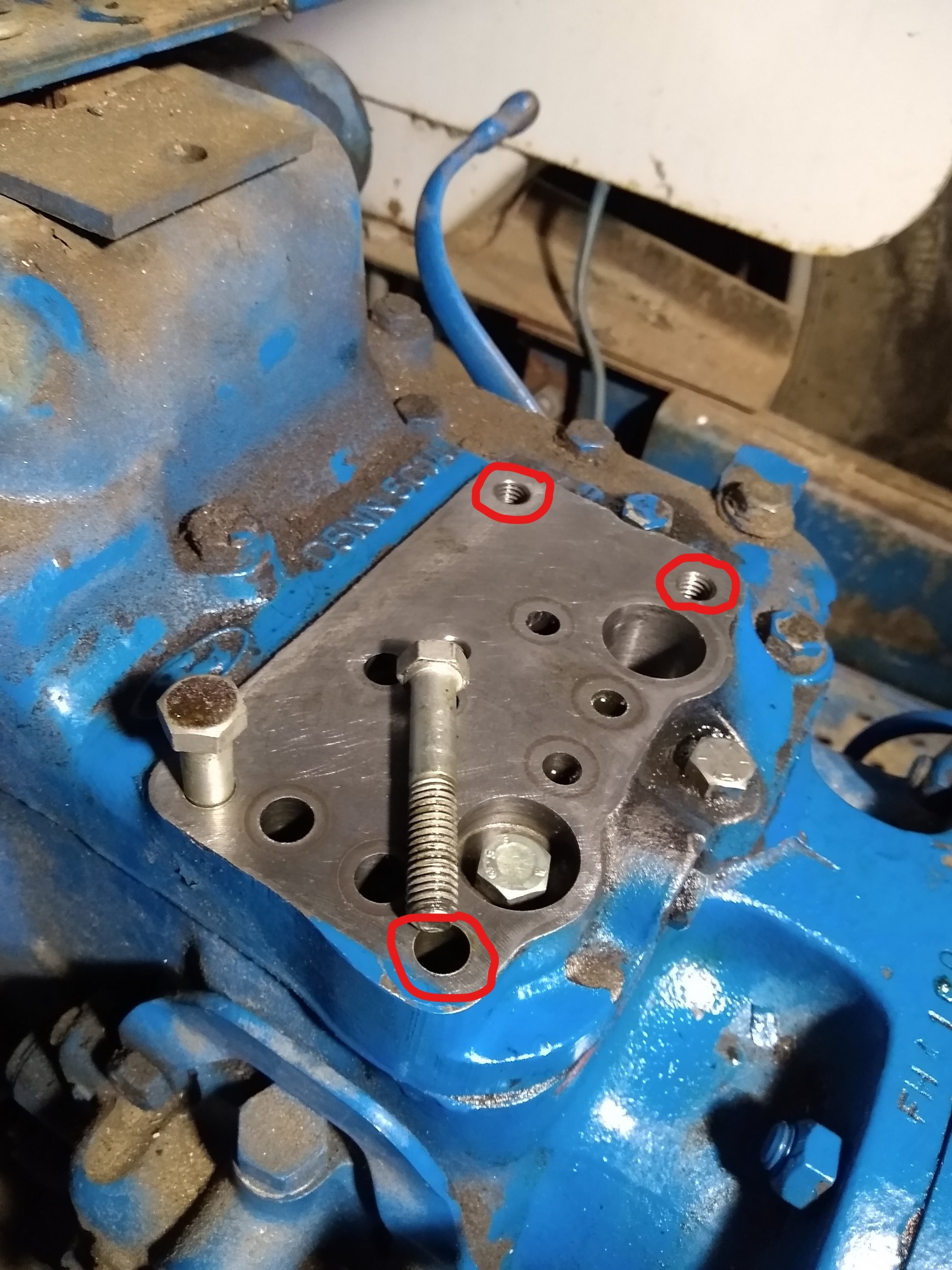

One thing you'll read online is that the bolts that come with the adapter plate are not the correct length. Can verify - they're not. Notes about this: the two farthest away bolt holes have threads immediately starting in the hole. The two bolts closest start threads way down in the hole past the hydraulic lid. All the bolts in the kit work - except those two that are deep down. They're just 1/4" too long...
Here is everything mocked up in place. And you can see how the provided bolts are too long. I think I'm going to just grind these down. There is at least 3/4" of thread engagement, so taking out a 1/4" isn't going to hurt anything.

I did grind the bolts down, and they fit fine. That wasn't a big deal.

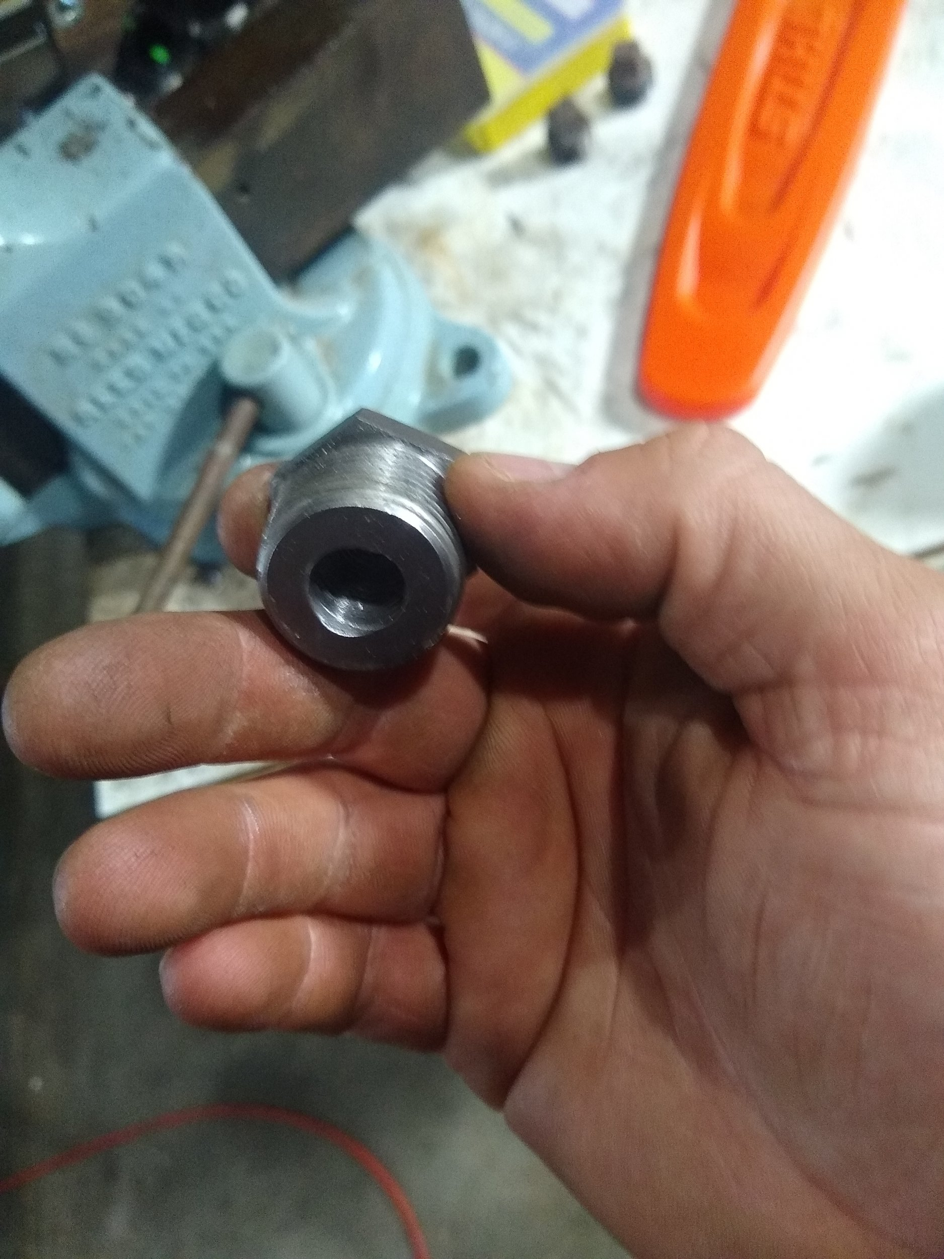

The open port in top of the blocking plate is 1/4" NPT. I had a brass plug that I put in for now, but I do have a black plug I might use instead.
The issue I'm having is finding the correct size O-rings for the blocking plate. All but two of them are just basic off the shelf stuff. I think they're metric, no clue why. Everything I tried is either too big or too small. Going to an industrial supply house tomorrow, and hoping they have what I need.

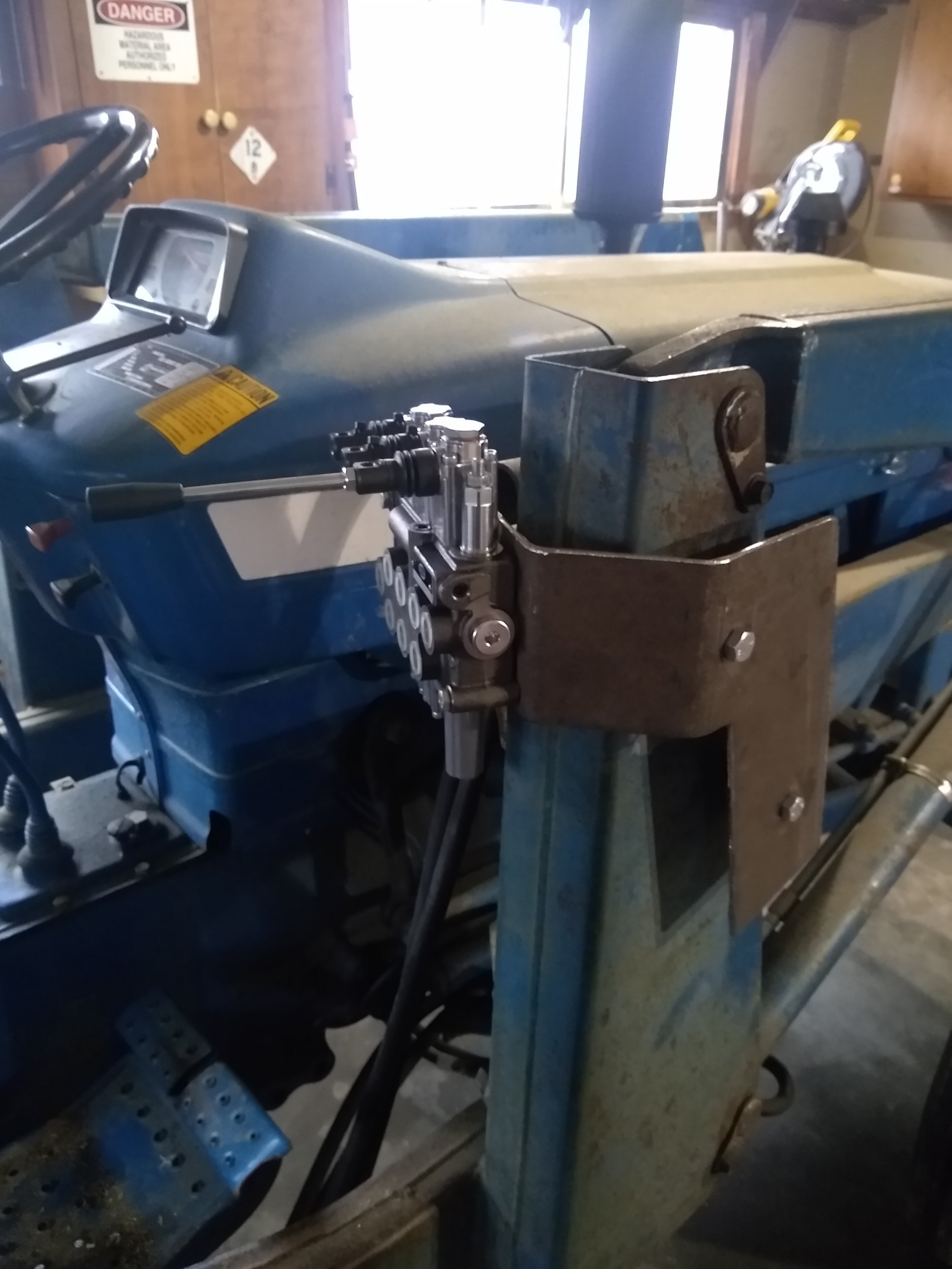

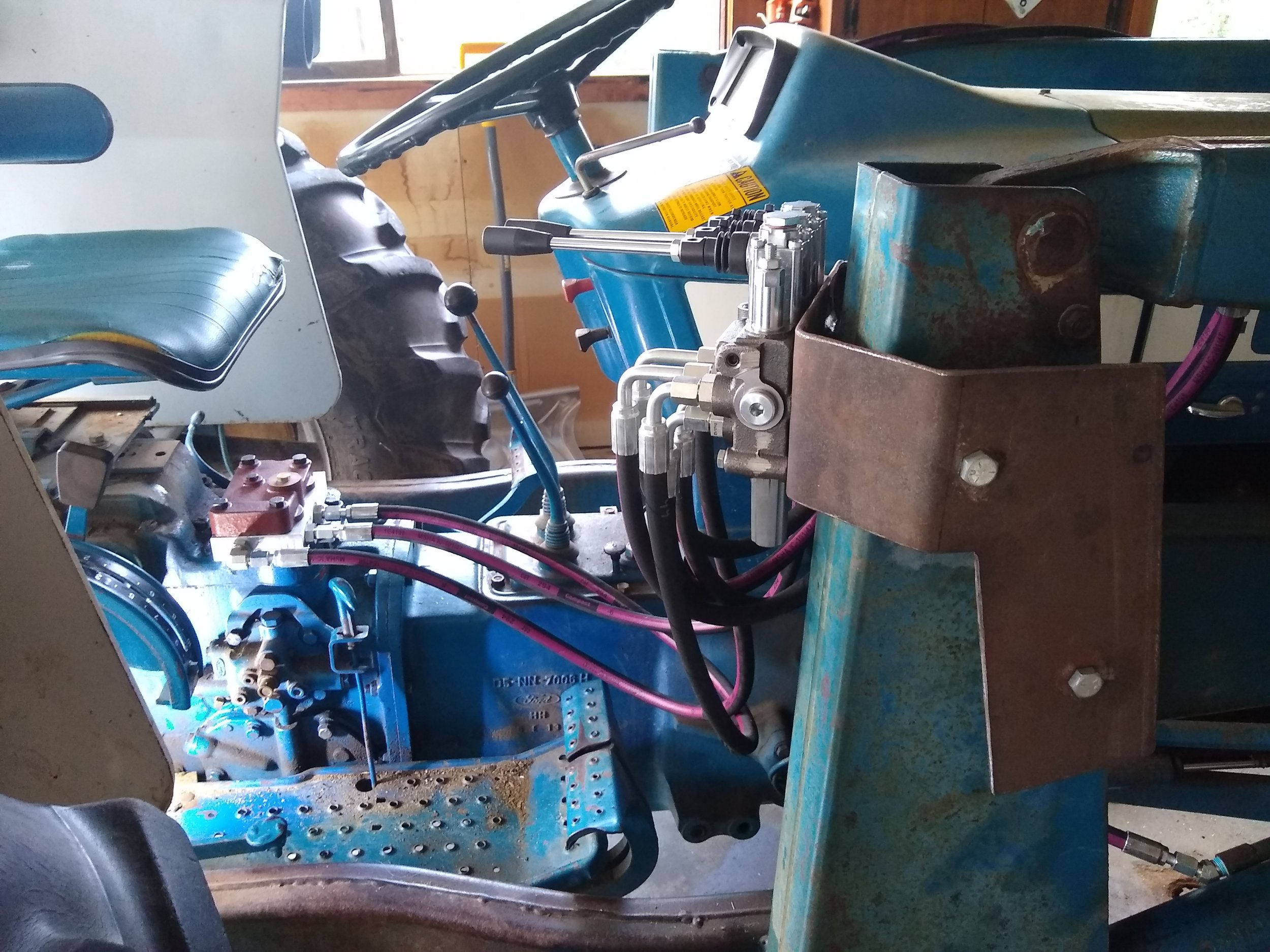

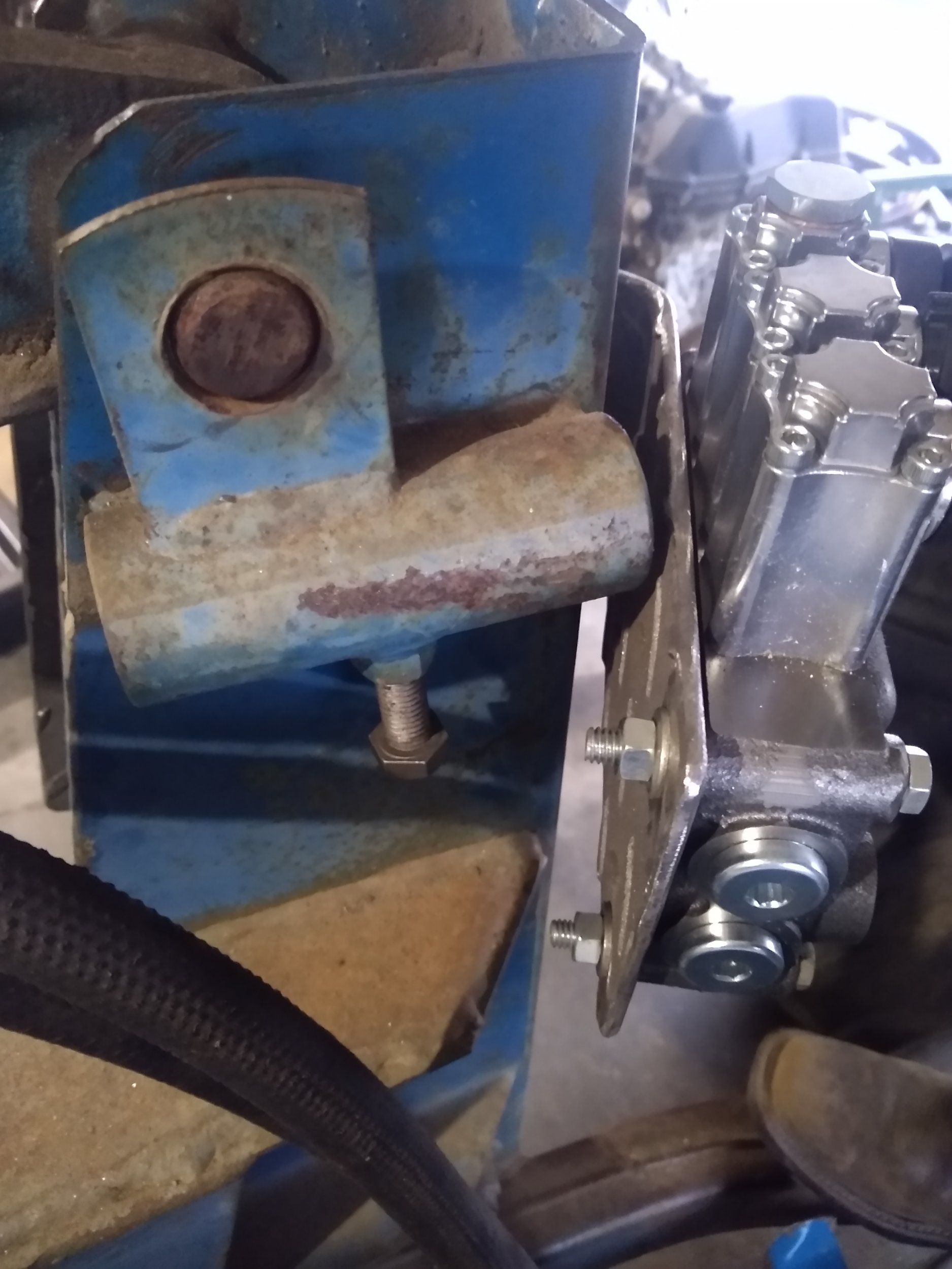

Next thing I started working on was a mount for the new loader valve. The loader on my tractor has some 3/4 NPT bungs on it. I grabbed some bushings for it, drilled them out, tapped them 1/2x13 and it worked out really great.
I made up a mount with some 1/4" diamond plate, and I think it turned out really good. Bolted up really strong. Very easy to just grab, I don't have to bend or stretch at all to reach the valves.
There's a tiny bit of flex in the plate, and I'm thinking I may go ahead and add a tab on the back. There was a random nut welded on there, perfect location to brace the back.

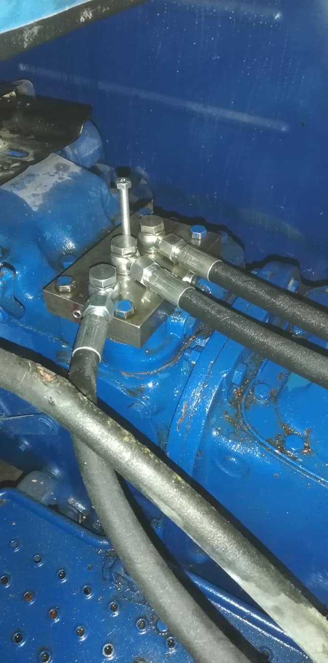

Well I got everything back together. But uh, my three point hitch won't lift. Went down like normal. I think my pump lost prime? I'm not really sure. Anybody have any ideas?
/ HV5902 installation guide on my Ford 4100 #5
So if I understood your post correctly you used a adapter plate with Power Beyond. What I think you did was plumbed power beyond from the plate to the IN on the loader valve. Then you went from the C port back to power beyond on the adapter plate. Is this correct?
What I think should be done is go from the pressure port of the adapter plate to the power in on the loader valve. Then the loader valve needs a power beyond sleeve installed on the C port. Then you would have a hose from the C port of the loader valve back to the power beyond on the adapter plate.
Then you would have a 3rd hose go from the T port on the loader valve back to return port on the adapter plate.
The Power Beyond is what will go back to operate the 3pt. Hopefully I explained that well enough for you to understand.

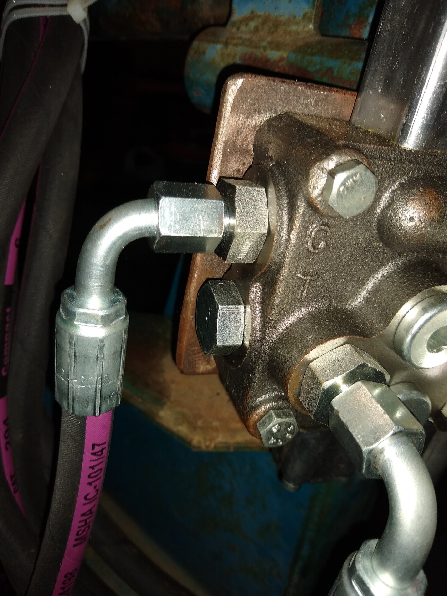

That is how I have it:
Pressure port on plate (P) to inlet on valve (P).
Return to sump on plate (T) to outlet on valve (T).
Power beyond on plate (PB) to power beyond on valve (C).

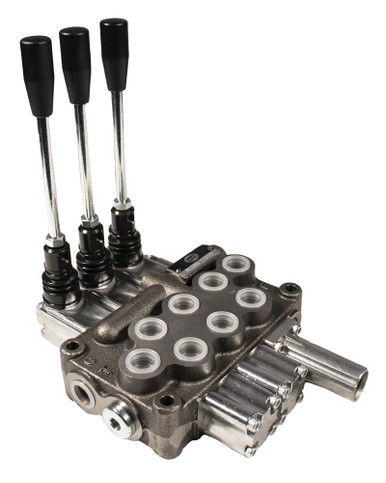

The valve I'm using is this:

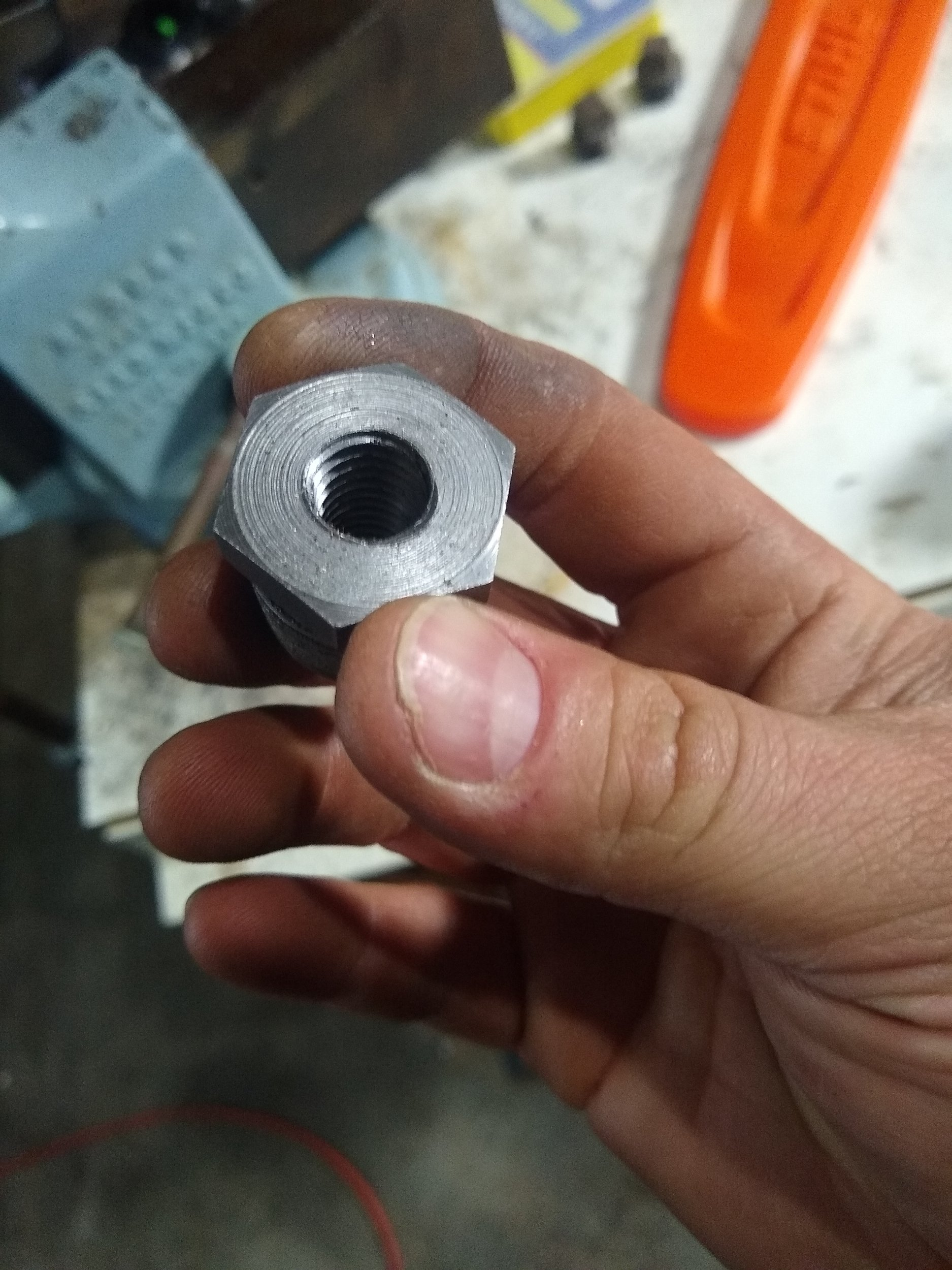

When I put the power beyond line on the valve, I just used a regular 3/4-16 ORB x 3/8 JIC male adapter... I'm guessing the special power beyond plug does something special with oil flow to direct it back to the plate.
/ HV5902 installation guide on my Ford 4100 #8
Correct. so what is missing is the power beyond sleeve. The sleeve is what redirects the flow internally in the valve. Without the sleeve then C is just another tank port.
You need to reach out to Bailey’s and ask them for the power beyond sleeve and plug if needed. They will be able to help. But that will fix the issue.

I think you're confused on a couple of different fronts. First of all, the 5902 valve plate doesn't have power beyond simply by virtue of three ports. The 4902 is also for power beyond, it merely forces you to find a third (sump) port somewhere else. Should one choose to ignore that, connect another valve in the series without that (and only two lines), you take your chances. Yes, many systems are set up that way and there are those who claim theirs works great like that. Fine. I don't do it that way.
Secondly, yes you do need the power beyond sleeve (which obviously your valve source rep didn't mention) in order for the three point to work properly. Third, the pressure "in" port on your loader valve is on the other side. The side where the relief valve is located. Right now you're plumbed into and out of the same port. You don't know that yet because you haven't actually put any oil through it. One more thing, you have a relief valve in the pump, and don't need the one in the valve. Loosen the nut, and screw the stem in a few turns to make sure it's set higher than the tractor system, or it might relieve at a lower pressure and affect performance.
Also, the parts list gives a pretty good description of the O rings you're looking for.
/ HV5902 installation guide on my Ford 4100 #12
Harry,
If you look at his last picture in post #4 you will see he does have it plumbed properly. I was confused at first as well. Looking at the instructions that came with his adapter plate it clearly mentions Power Beyond and has the ports marked.
So is there something else we are missing?
/ HV5902 installation guide on my Ford 4100 #13
Yes. I missed the pressure line, thinking the port with the plug was the only one on that side.
What's missing is the power beyond sleeve. All that's there is a fitting now. Both ports are joined internally and connected to sump. Hence no pressure to lift system. At least that's my take on it.

Sleeve is coming on Saturday. In the meantime I have to tidy up the hoses and massage a few things.

It did. In this valve though, there isn't a sleeve per se. Just a small plug that redirects the flow. Been working excellent since then.

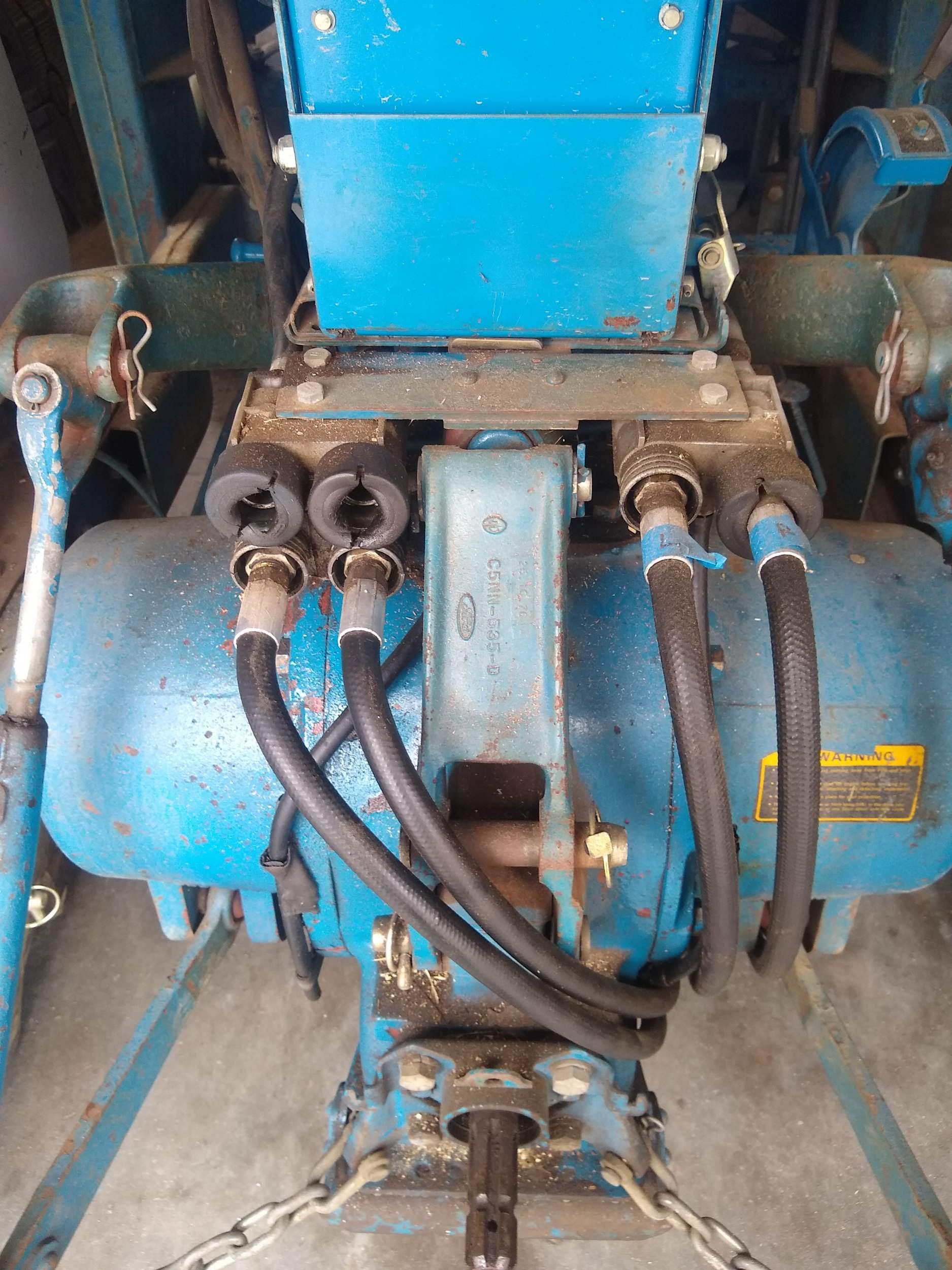

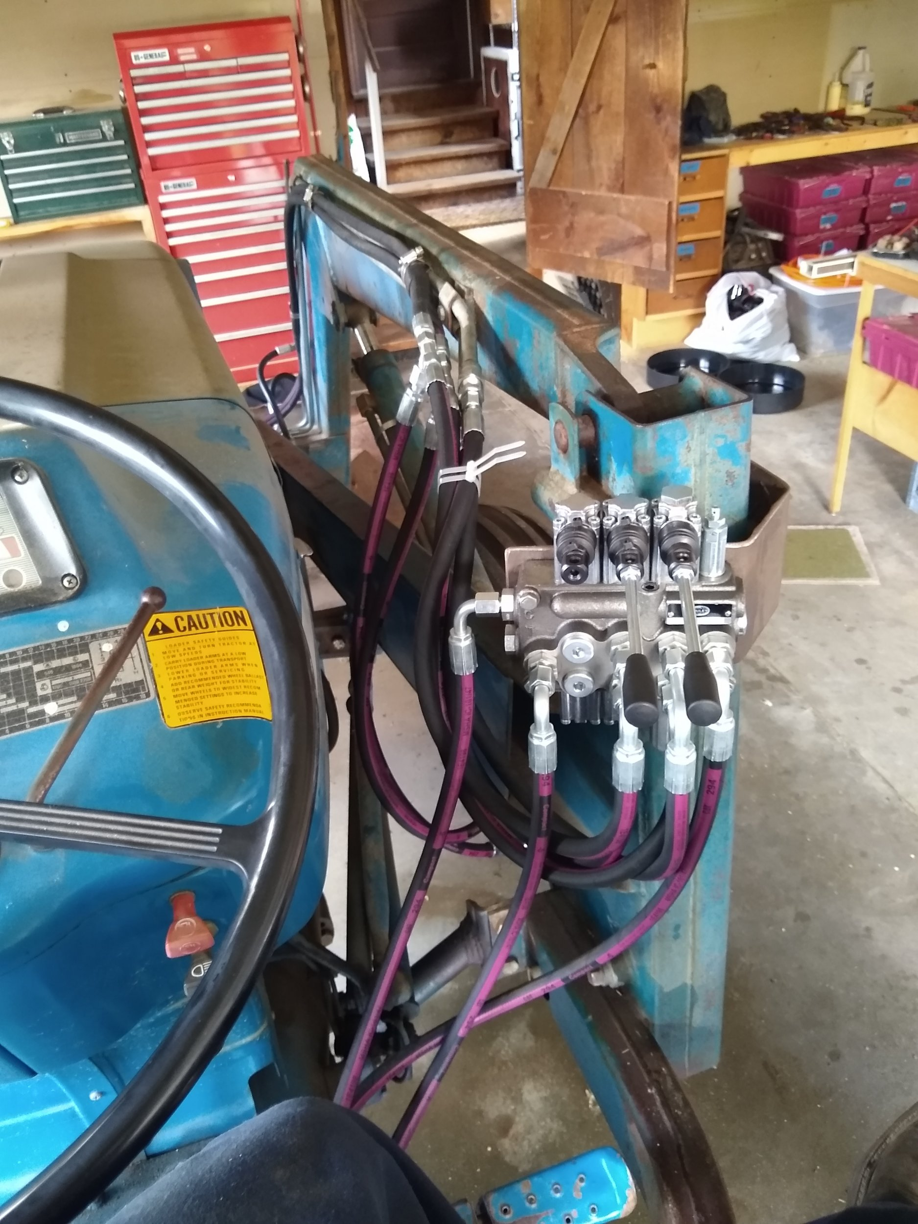

So this is about where I'll end things. It really worked out great in the end. I made up some mounting tabs and that keeps the hoses in place and free from binding anywhere. I also did add an additional tab behind the valve and tied it in there. Super sturdy now.
Thanks to everyone here who helped me get this together, and I hope this helps out others doing the same thing.
brokuly, what do you mean by "small plug"? I'm going thru the same PB Sleeve issues and could use a few pictures of the plug you used and your hose routing. TIA, Chris​

I am a little confused by the pictures and setup. Did you remove the rear remotes? What is the 3rd spool used for on the loader?
