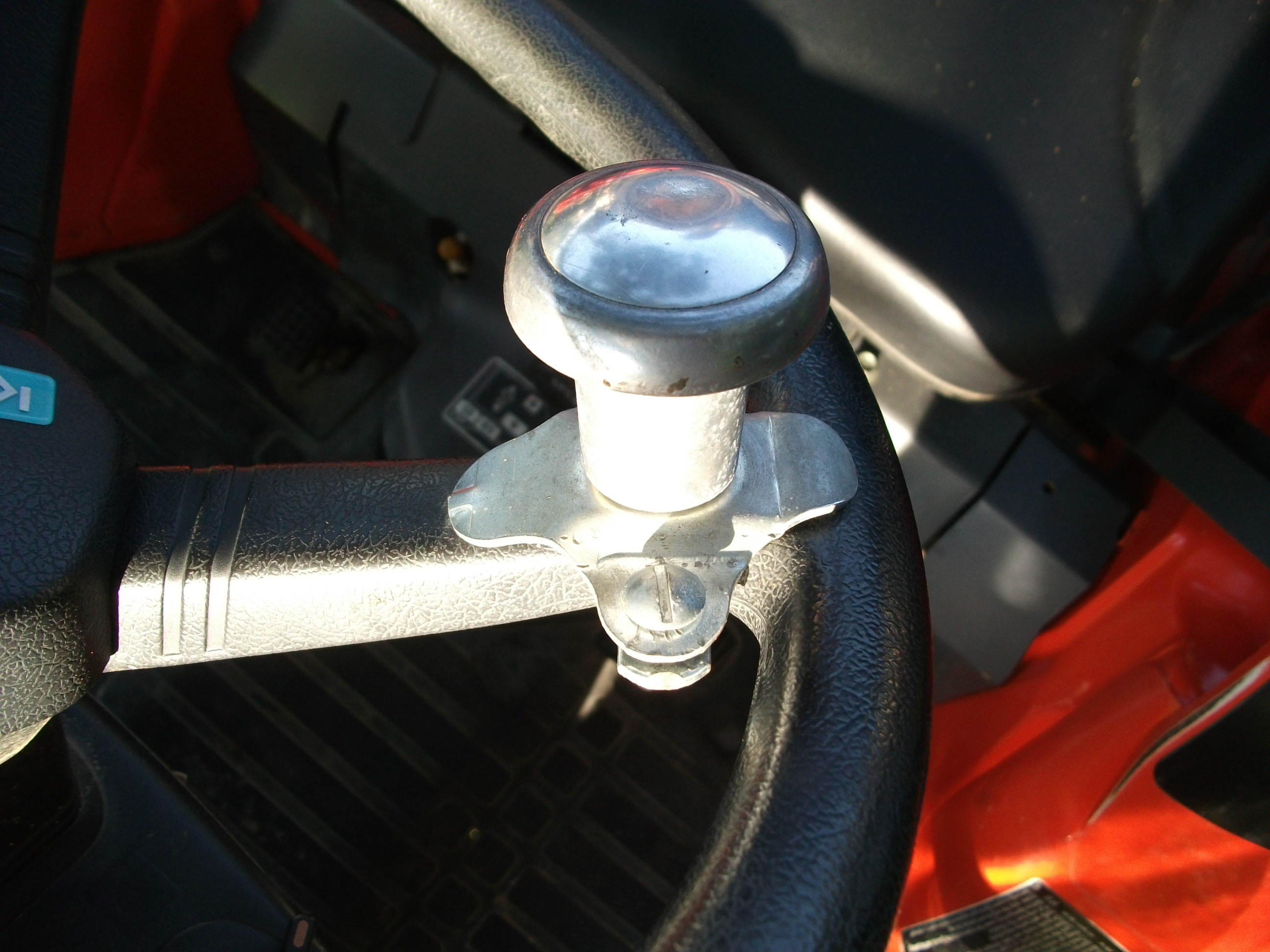

See if this will help. Cursor over the steering wheel and click to see closeup. By using this knob and the R or L brake "she'll turn on a dime and give you 9 cents change!" :D:thumbsup:

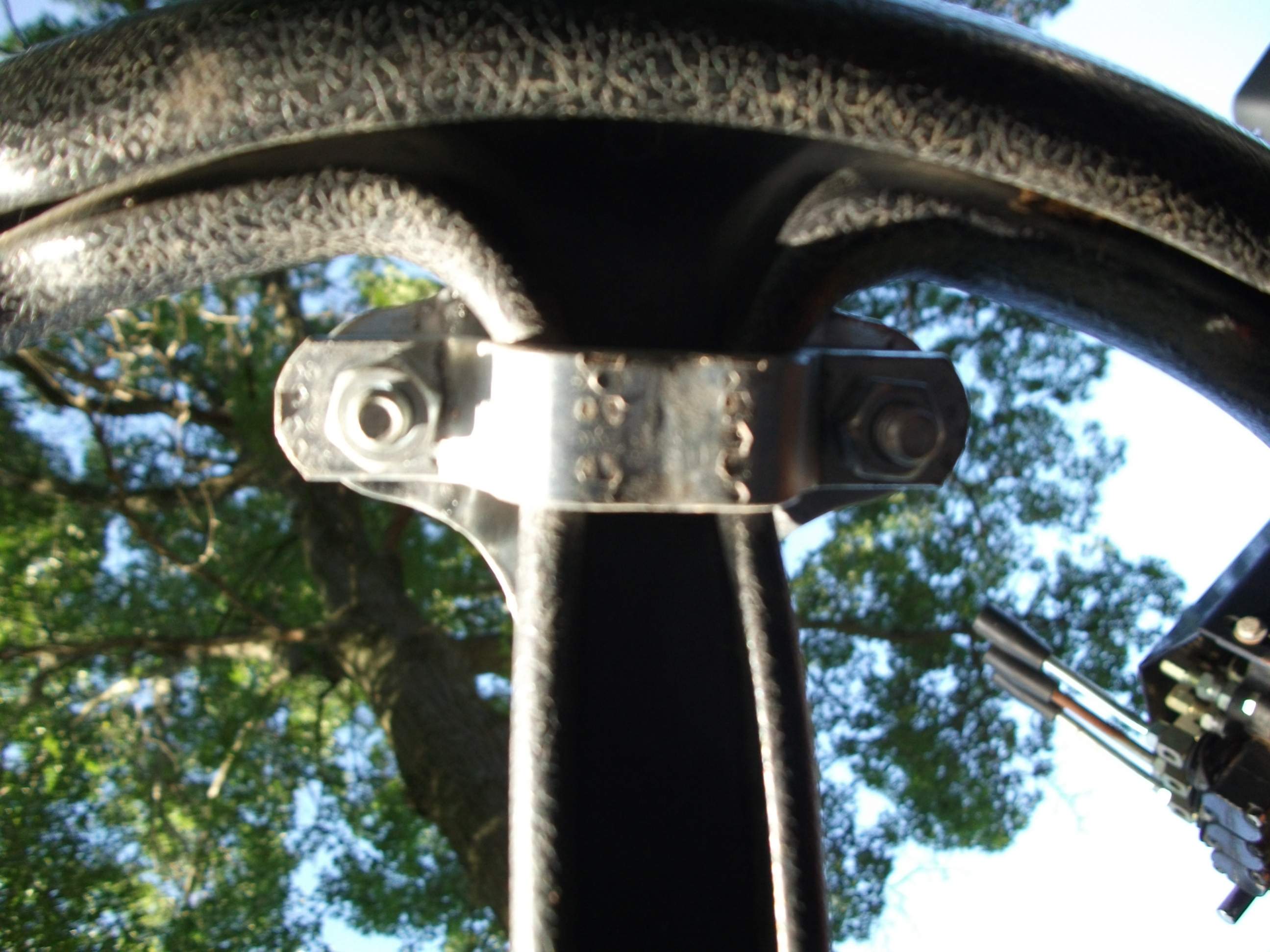

On both my L4350 and B7800 I put my steering wheel spinner on the left side when the wheels were straight and to this day that is where they are.;) Perhaps John Deeres are different? :confused: I did have to modify the bracket so it would fit the spoke of the steering wheel. You can see the vise marks in the pic. I picked mine up at a local tractor dealership for about $8 each. Always the first thing I do for my tractor. Would not be without it!

Glen, On my B7800 it is at about 10 O'clock as that is where the spoke is and I want my left hand on it. On my L4350 it is at 6 O'clock but does seem to vary from 4-8 O'clock, much more than the B7800.

General Lee, I mounted mine just like MagiCheater did and it seats properly. Yes, most of it is on the spoke with only the "lip" of it on the wheel.
