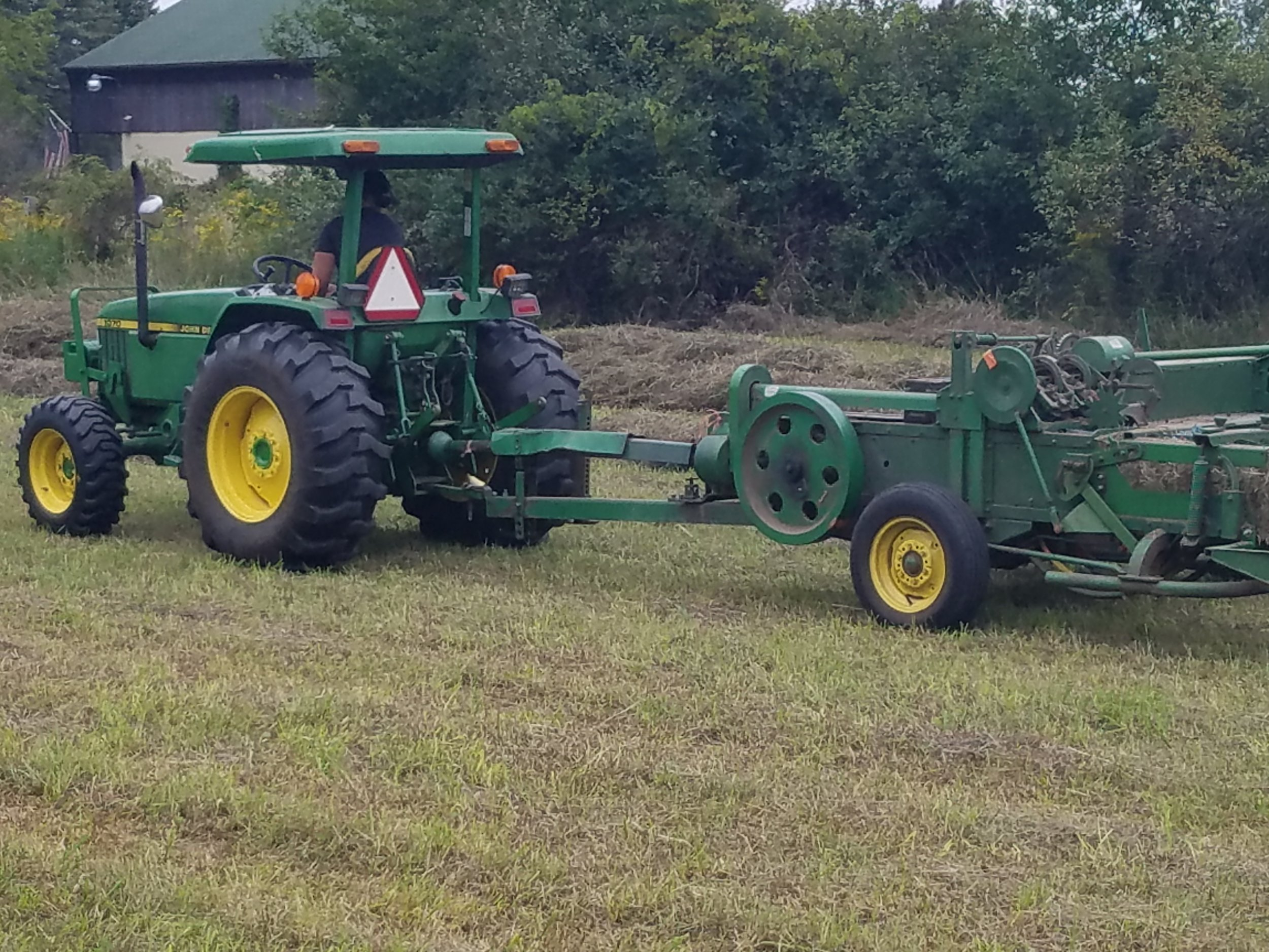

My 4 cylinder 35 HP 1070 is now almost 40 years old. BTW: I can draw more than enough juice from a PTO generator to power an electric car equipped with a trailer hitch as long as I don't have to stop.
