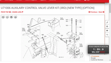

From the pictures inside the cab, it looks like there really isn't another way to add a second remote. I have no idea if that's even possible, so I'm wondering if this tractor can pull a batwing mower?
You mentioned the pics from the cab. Looks like this is the "new type" cab layout. They put the first two remote handles in that one large slot by using bends to separate the actual handle end. Looks like a 3rd remote would go in the far right opening. FYI.

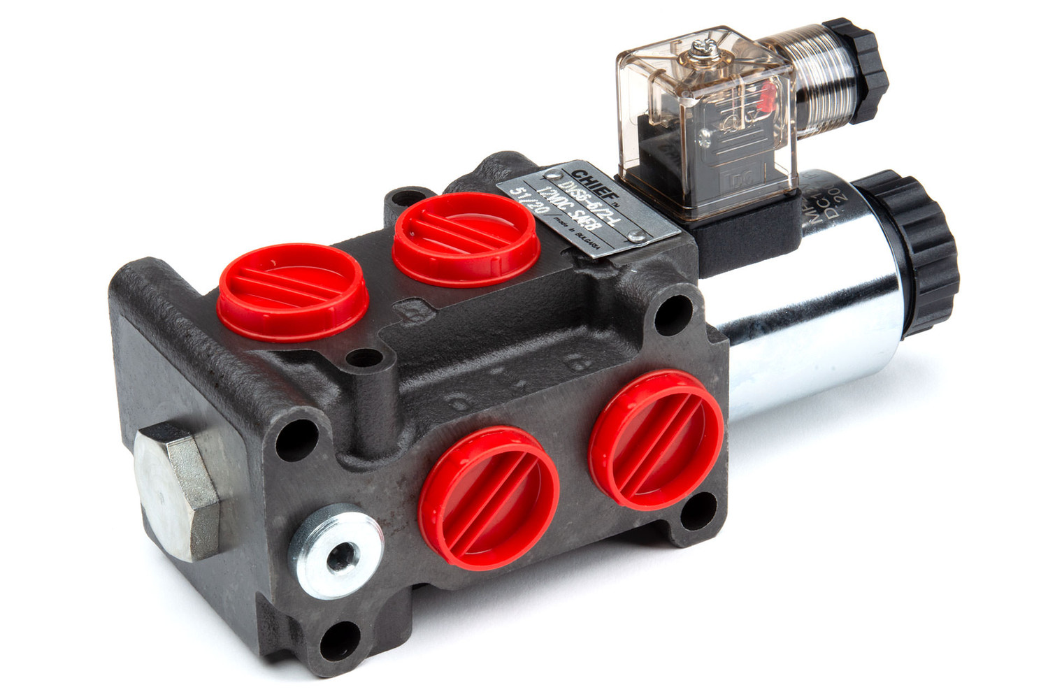

One input two outputs and they can be stacked I believe up to 3 for 4 separated outputs, commonly called VALVE SELECTOR SOLENOID OPERATED,
or a selector valve or a hydraulic multiplier. I have them on my back blade and will be installing one on my snow blower, they are also often installed as diverter valves for grapples and blades. One set of remotes and a switch and you have two remote hydraulic outlets.

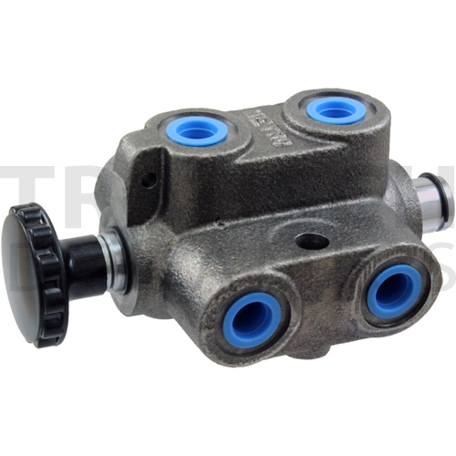

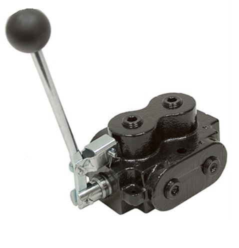

Manual selector valves are also an option:

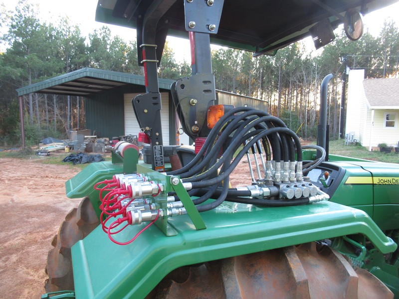

Just an example.
One factory rear remote, four sets of couplers. Grey control grip on the factory valve lever with 3 control switches.

I think you have some good answers above. I've had a batwing for over 20 years. My advice, like others is that you want to be able to independently control the wings from the tractor seat. Unless it is a big money issue, I'd really suggest a 3rd control for height.
I see 2 options with the cab tractor. A 'power beyond' multi-valve inside the cab is impractical for your situation. (1) add Kubota built-in remotes. A tractor dealer or repair shop should be able to do this for you. (2) electric solenoids. I bought two Fassi valves years ago - one valve I have allows control of two circuits, the other valve I have (that I have yet to implement) allows one valve to select between three circuits. With one of these, your one remote feeds into the solenoid block and with a switch inside the cab, you decide which circuit your single remote is operating. Pricey, but much less than adding permanent remotes to the tractor. As a bonus, if instead of mounting the solenoid valve on the mower, you mount the solenoid valve on your tractor "permanently", you have multiples for other implements.
