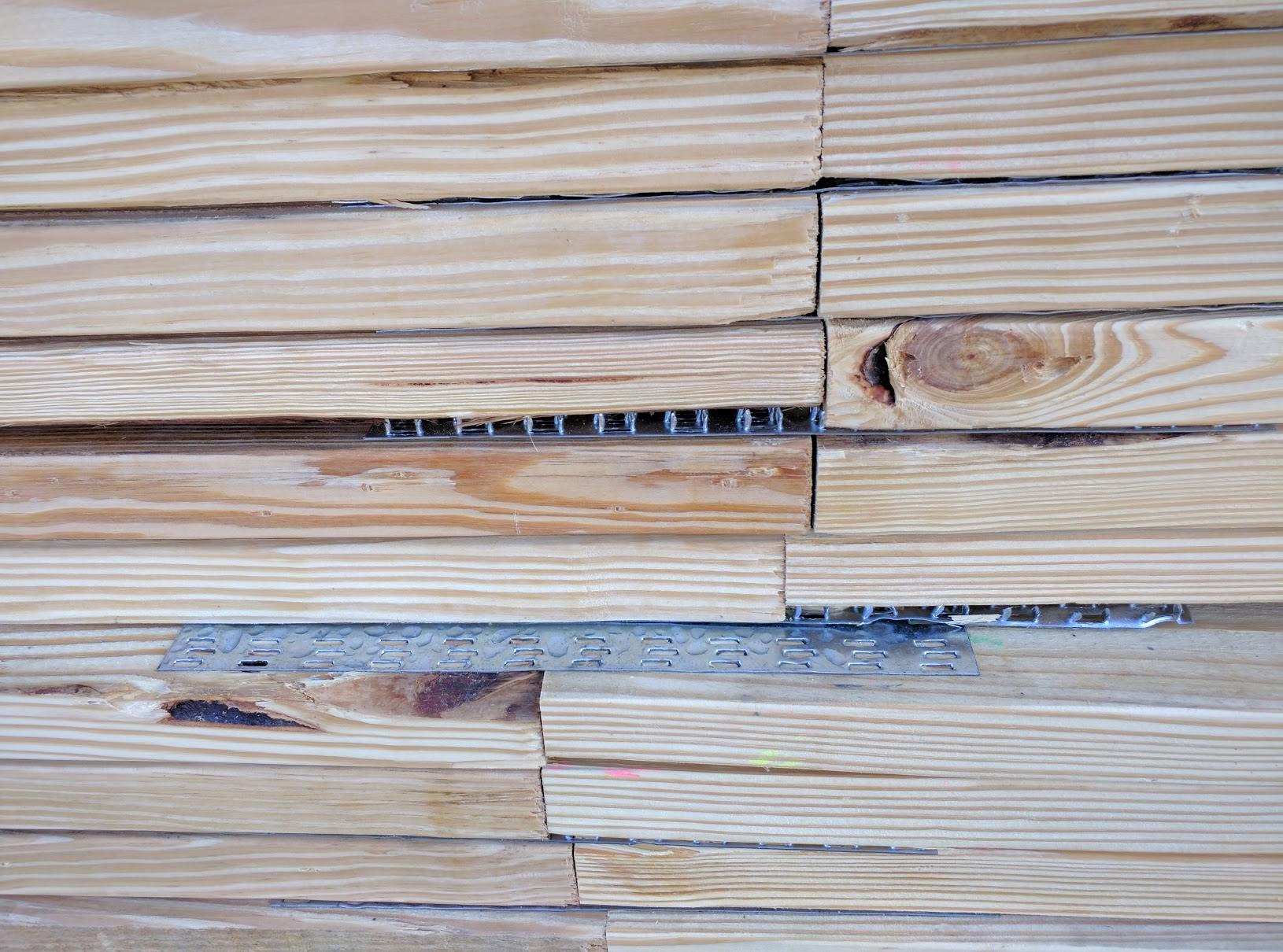

View attachment 486075View attachment 486076Ok so I cannot figure out how to upload pictures. (Edit I think I added them now)

Pictures show, at least on the parts of the various trusses that I can see, several large gaps where the boards have pulled away from each other. Also show several of the metal plates they use to joint two boards together are pulling away from the truss.

It looks to me like a couple thinner 2x4s were used on one picture and the pressed in metal connector couldn't overcome the gap differential in the two boards. I think they should still be able to be pressed together somehow and should be alright. The truss company should have portable presses to correct those problems in the field.
The last picture, it looks like the wood was cut a little shorter than it should have been, and not like it pulled away.
They don't look as bad as I thought they would have been from the pulling sideways act.

He looked at them as best he could with them still stacked and banded. He was not so concerned about the things in the pictures. But has concerns because of the pulling off by the truck.

Looking at the pics of the trusses, I would be upset about the quality. Anyway, hindsite being 20/20, two things; I personally would not have "dumped" them or should I say, attempted to "dumped" them where that driver did. I mean, that is what cell phones are for, right? Also, why did the well meaning neighbor not drag the trusses off the end of the trailer at least somewhat then hook to the front of the truck and pull? Yeah well, I was not there so I don't know for sure.

I would be concerned about the quality of build on those trusses. Looks to me from the couple of pictures posted that they have poor quality control. Wood of different thickness at the joints, large knots located right at the joints where the truss plates go and truss plates not centered on the joints. Around here, those would be considered shody construction.

So truss company looked everything over. Certified the trusses as fine. Recommended some repairs for peace of mind. GC said no problem they will make those repairs.
