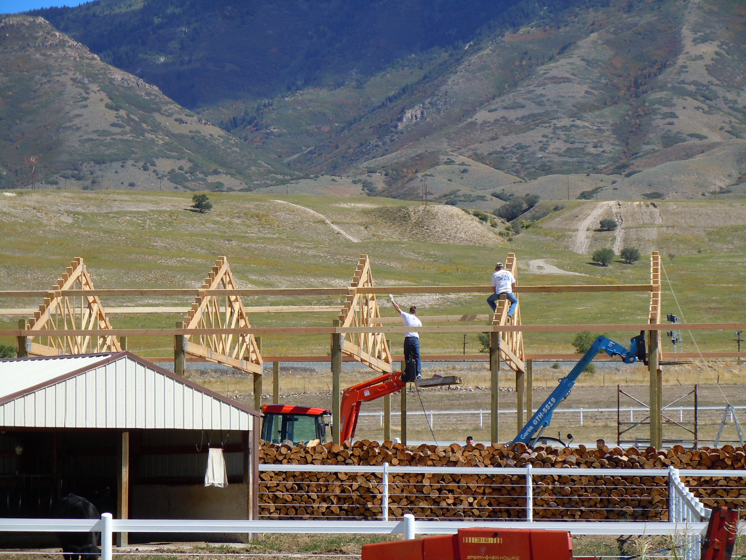

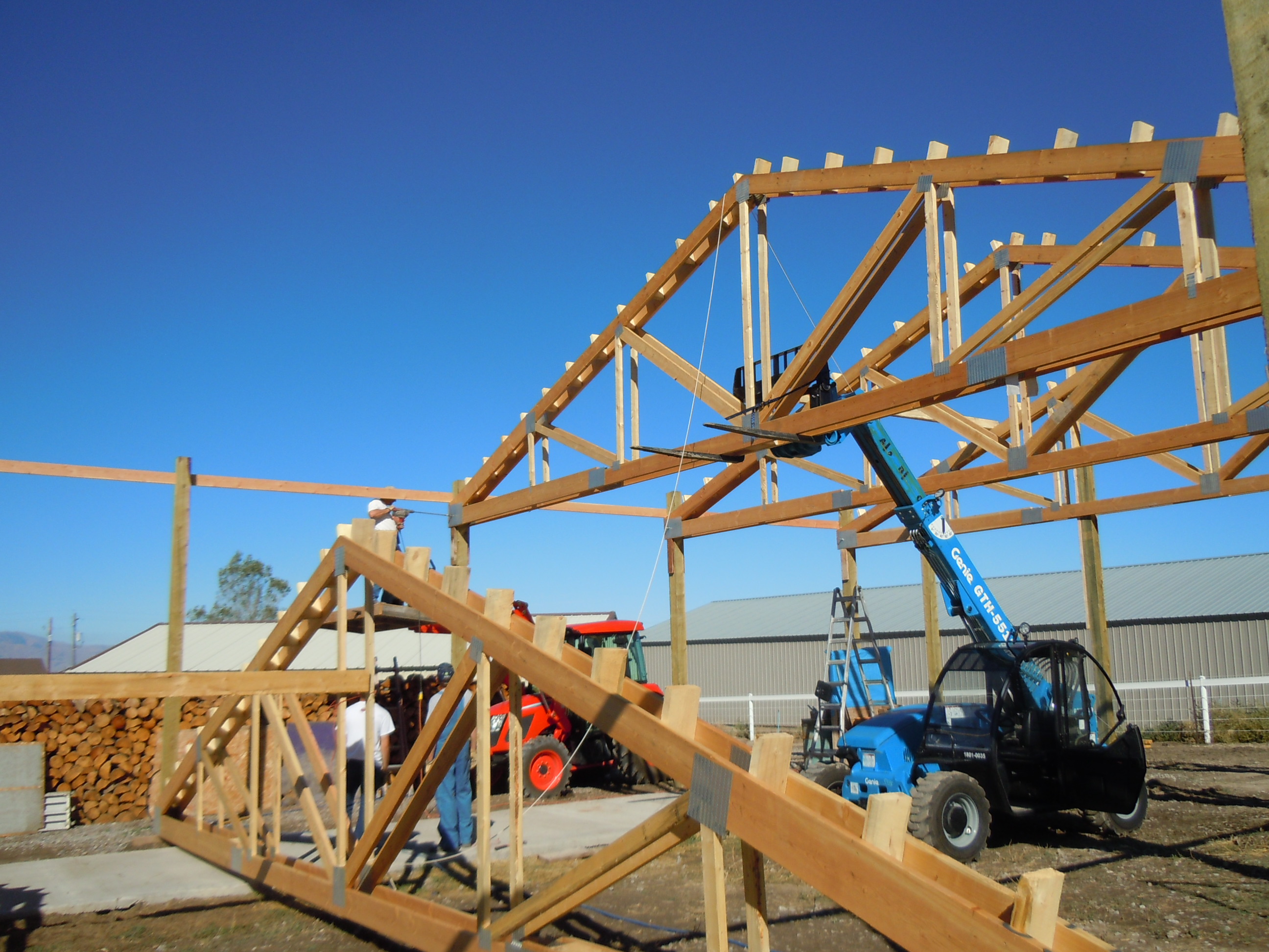

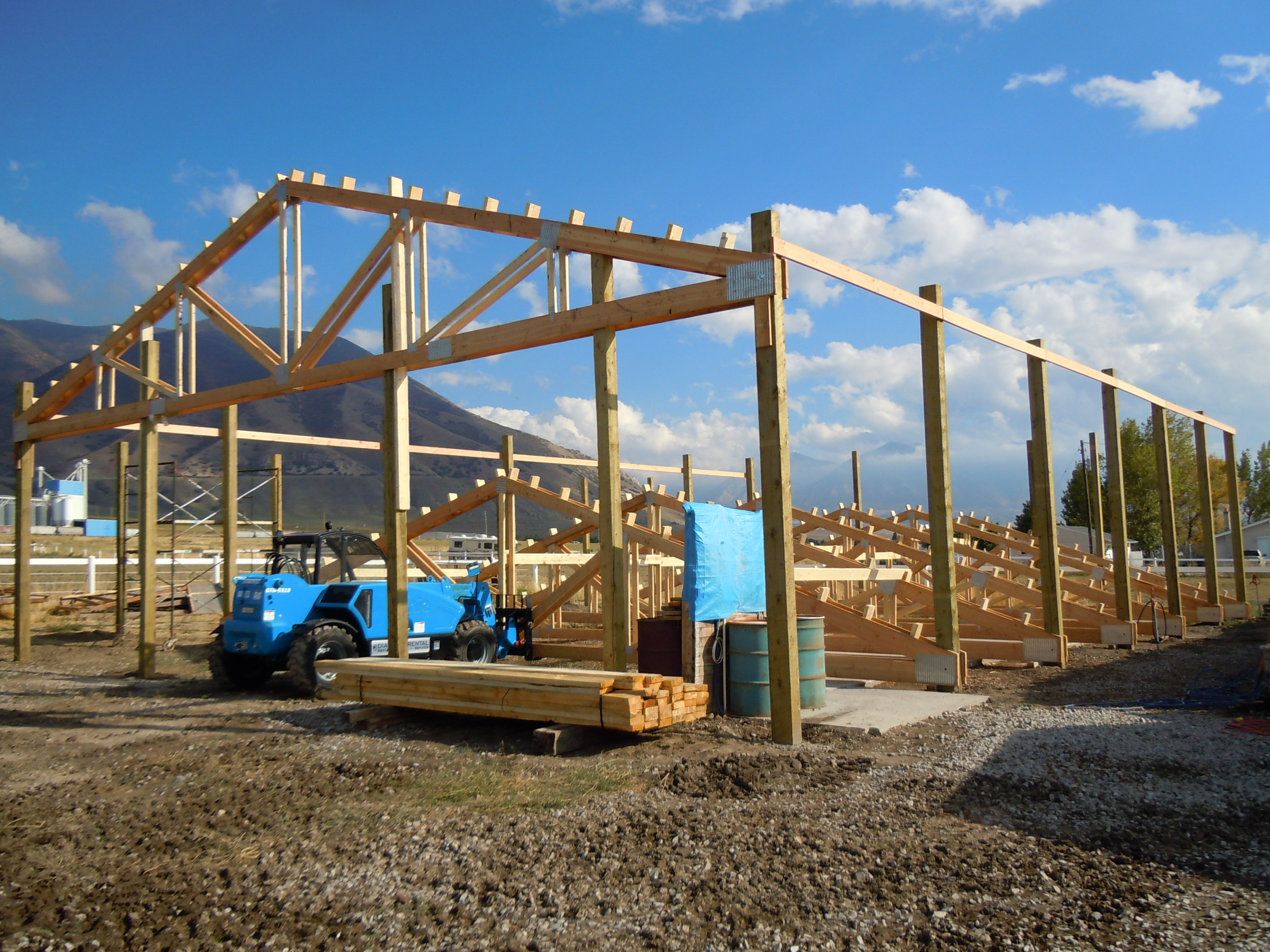

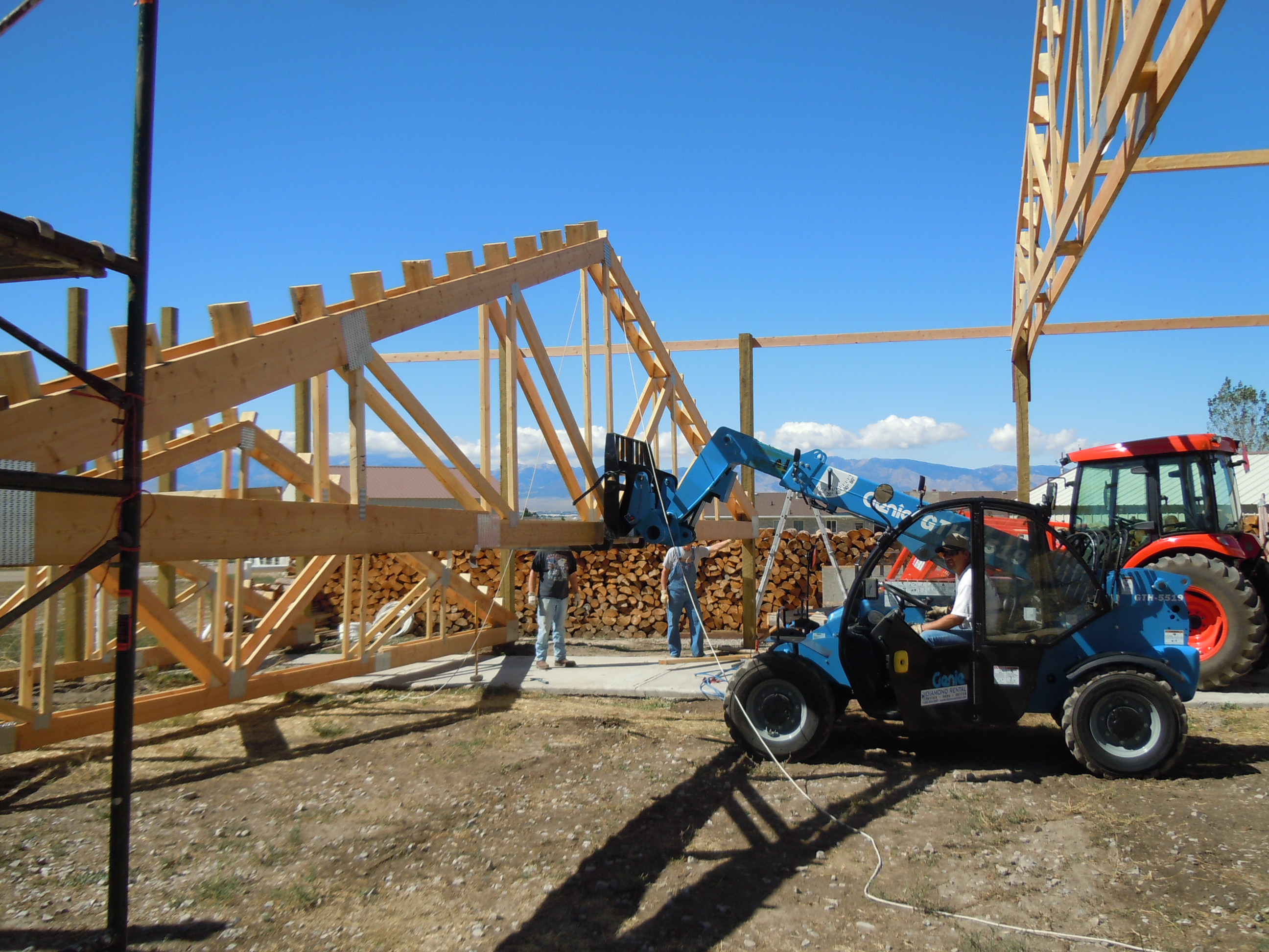

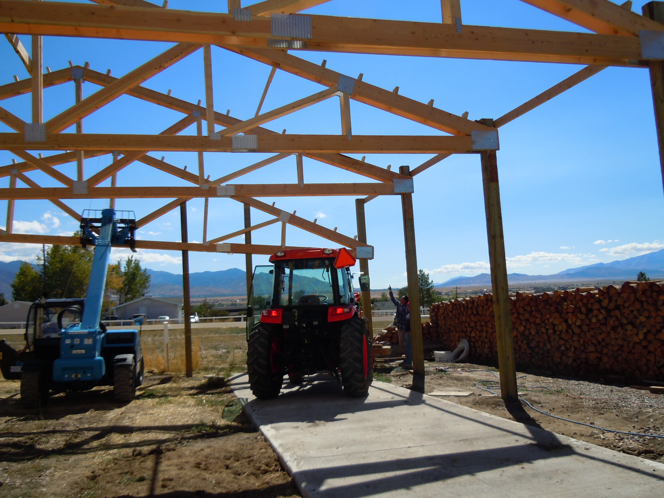

While mine were only 45' long, here is how I set them.
As to the thread I think the trusses are going to be just fine, other than some mud. I do agree with Eddie, they should look new when put up.

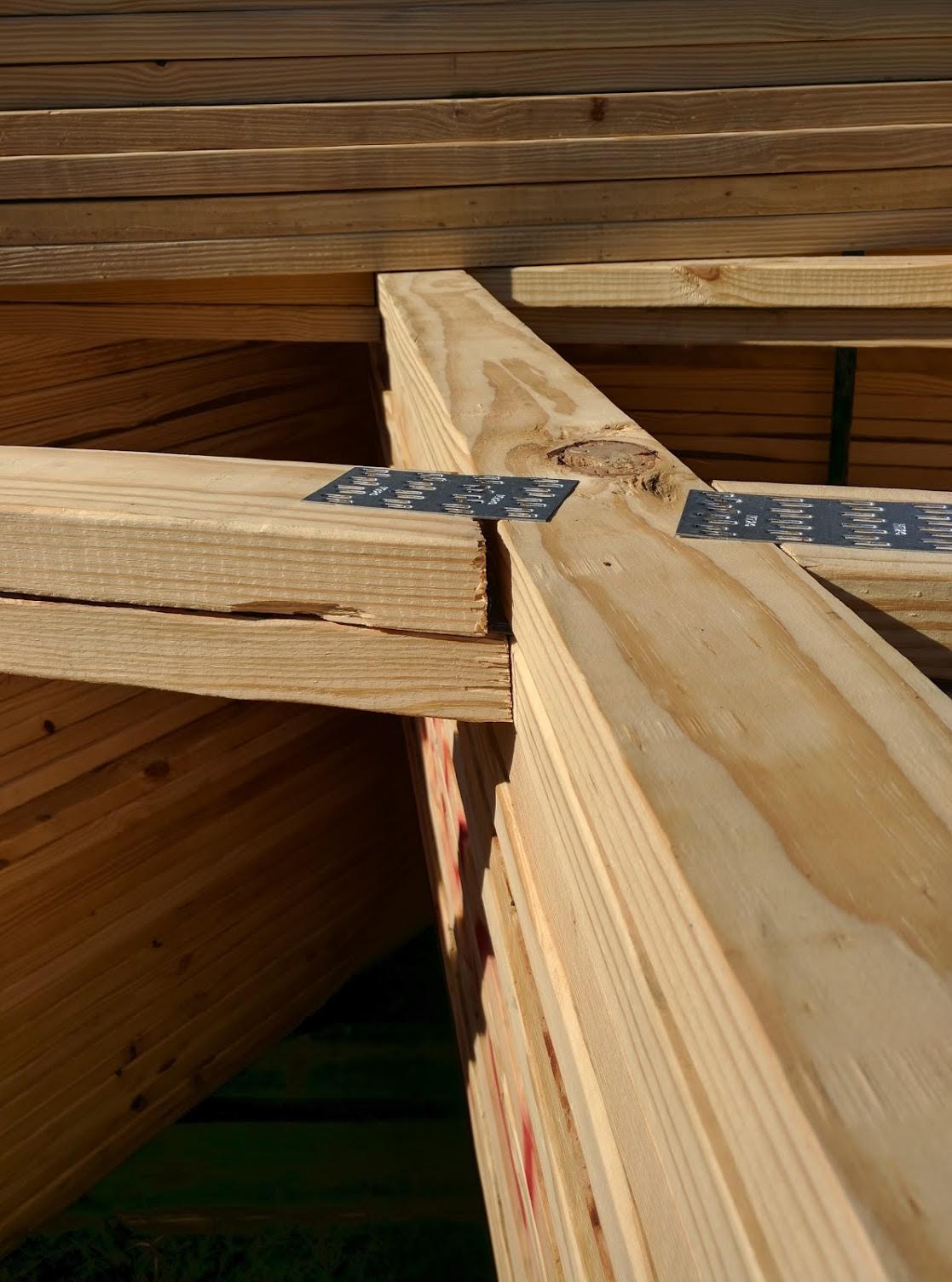

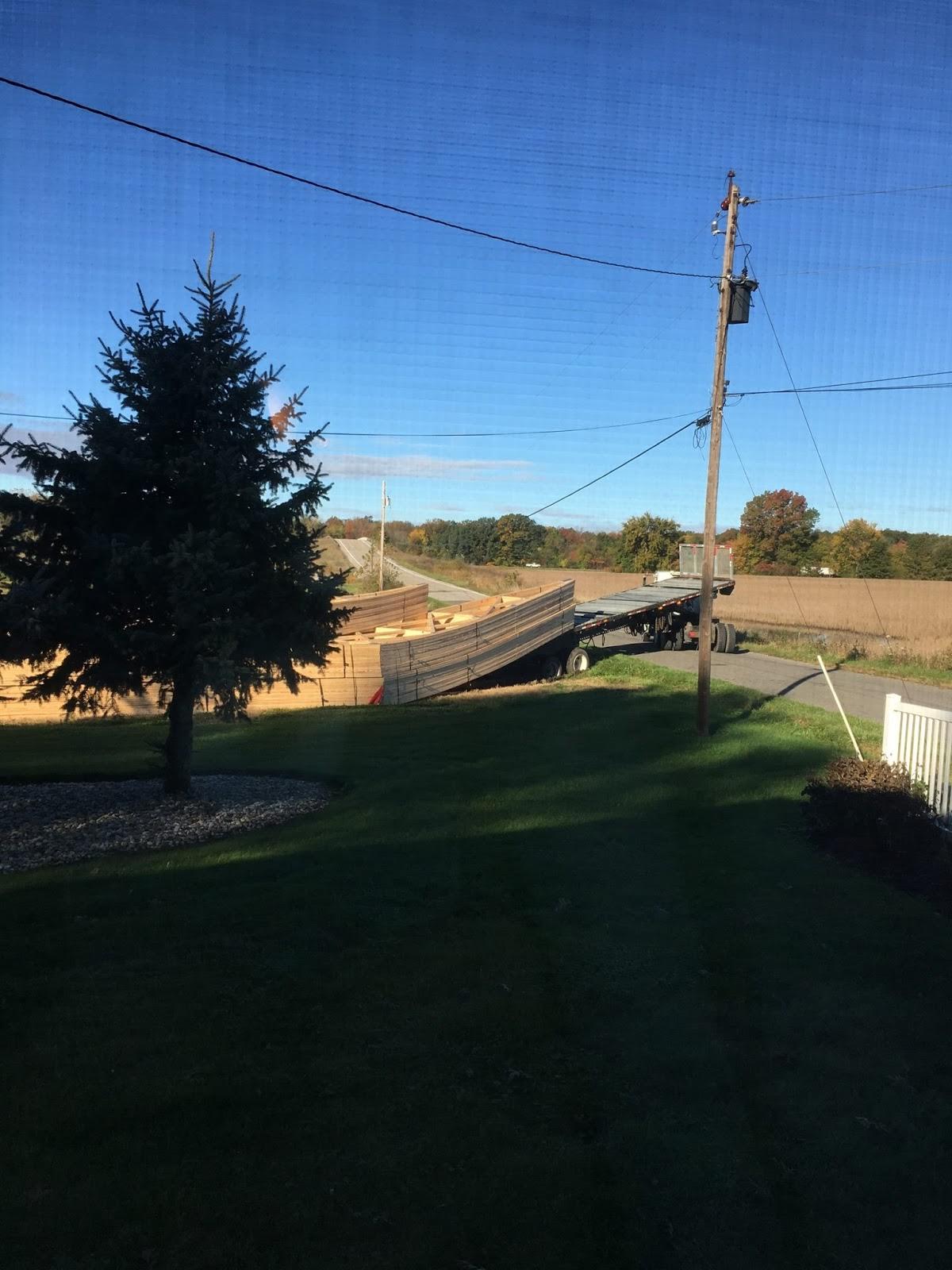

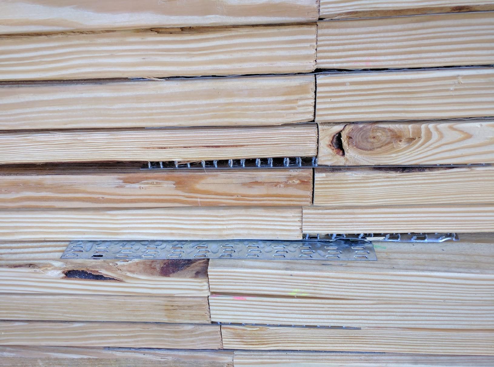

Pic 1.jpgpic 3.jpgOk so I cannot figure out how to upload pictures. (Edit I think I added them now)
Yes it would appear that I left out one minor detail of the truck pulling the trusses off.
The truck that delivered was supposed to back in to the drive and up to the construction site. Then the bed of the truck extends and tilts down. Looks like a much larger version of a flat bed they use to haul a vehicle.
When he could not get in the drive he backed into the field. It was muddy. He extended his bed like he should, but then could not pull forward to get out from under the load. He was stuck in the mud. Friendly farmer comes along and pulls the load sideways off the truck.
Pictures show, at least on the parts of the various trusses that I can see, several large gaps where the boards have pulled away from each other. Also show several of the metal plates they use to joint two boards together are pulling away from the truss.

View attachment 486075View attachment 486076Ok so I cannot figure out how to upload pictures. (Edit I think I added them now)

Yeah, pulling the trusses off the truck, and sideways, is more critical than the mud and rain. At least it looks like most of the truss load was on the ground already before he got stuck blocking the road. I have no doubt the truss company will do the right thing on this, as you described. I hope the weather cooperates for you so you get the building up as planned.
