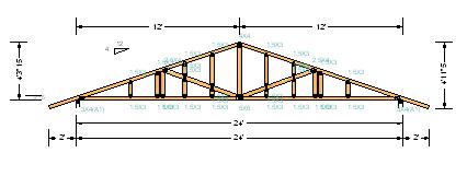

attached is the type gable I was talking about
as far as the bacing book goes they mosty covery bracing for houses not pole barns but all the Temp. barcing is the same. They truss plant "should" suppy the book but I would tell them you want one if they charge for it I would not think it is much bucause they don't want you to sue if something happens

Lazy,
Let me see if I can explain the problem with putting the bracing between the trusses. Think of all those little 2’ (4’ or whatever) braces as having a hinge point at each end and think of the trusses a dominos.
Now lets say your on top of one of these dominos and it is a little out of plumb and a hinge is holding it from going over.
Now if that board goes over a bunch of the dominos with no hinges in that board the whole stack goes done. That is the reason for the x-bracing also.
I know what you’re thinking ……But I used a hanger so I am ok……nope you were lucky….A hanger is made to take the load vertical not to keep the board in it from rotating. Nail a hanger to a beam put you a short board in it hold the other end with only your hand and pull up or down and see how easy that hinge works.
I have never seen you barn but you might think about adding a few rat runs along the bottom side of the top chord of the trusses and x-bracing the gables.
Do you guys up there (I am in Fl so now snow) seen many pole barns that fall because of snow and think well the snow brought it down? Think again most likely it was lack of bracing. A building is a system and the trusses are just one part of that system….

>or may say to wait until after the roof is installed and the truss is fully loaded before attaching it.
Up north that would mean waiting for a couple feet of snow before securing the trusses.
Also, the metal roof doesn't weigh much compared to the trusses themselves. Keep in mind that the gable end trusses are only supportting half the load of the interior trusses, so they aren't all going to be loaded evenly anyways.

As far as the trusses on the end as almost everyone has said these will need to be structural trusses since they will only be supported on the ends, which will probably end up looking like all the other trusses on the building unless they put some extra "scabs" in it for attaching you metal on 2' horizontal centers.
