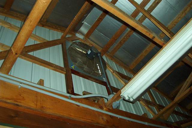

That was to be up to code far a unheated outbuilding. It was done by Paquette Electric. They do great work but aren't exactly cheap. They did a nice job though. Vaporproof flourecent lights, jar lights in the horse stalls, dust proof switches, and that monster fan on a thermostat that keeps it nice and cool in the summer.
