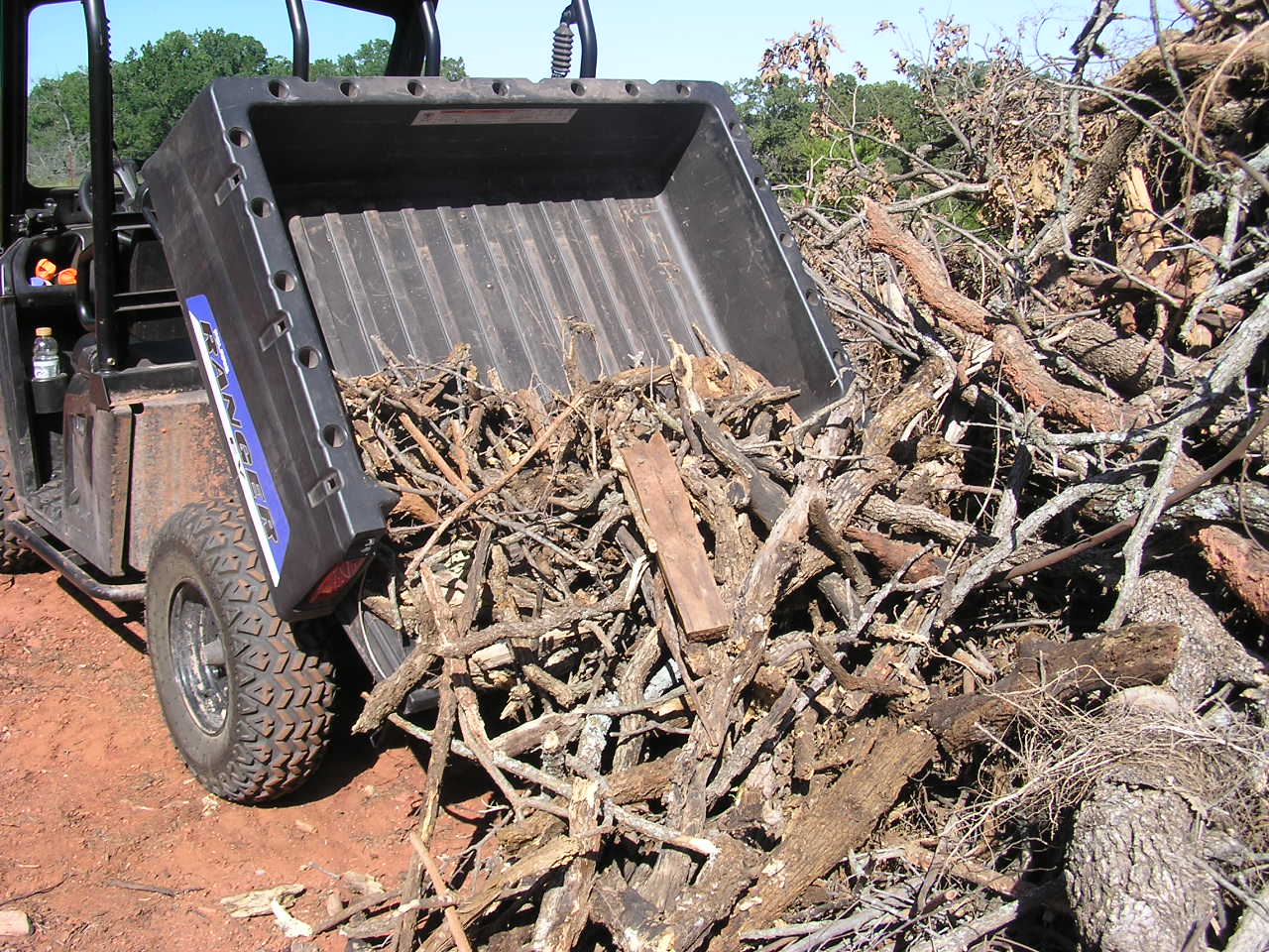

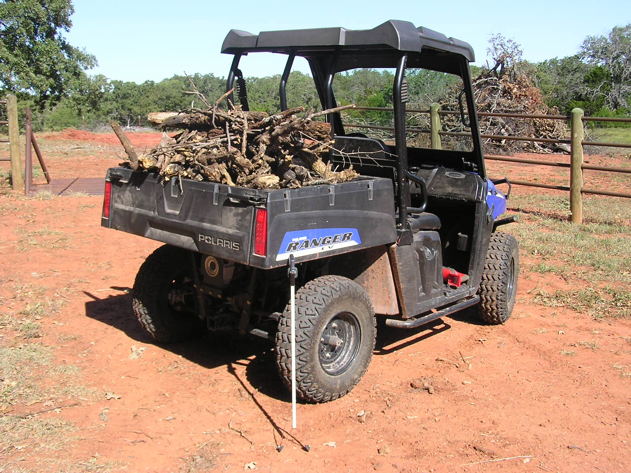

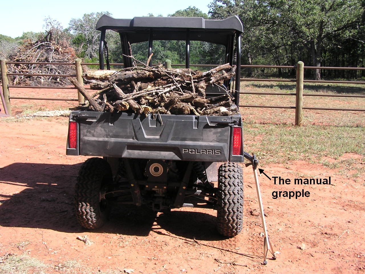

I just had to laugh, you guys are too funny. I saw that picture of that rock and thought I would just get off the seat and pick it up. But then I thought, that's no fun, so I get the skill and challenge thing going on here. I'm feeling left out of the whole grapple experience now...
I have picked up smaller rocks with the grapple than that one...:eek:
