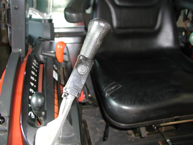

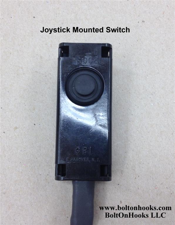

I need that switch! Where can I get one?
I guess KennyD didn't see your post, so I will answer: Ken's Bolt on Grab Hooks <<Hydraulics>>
   / True 3rd function or diverter valve for grapple? #57
I can't find the switch listed separately, only as part of the kit. Will e-mail him directly.
   / True 3rd function or diverter valve for grapple? #58
Sorry AW, Just saw this...
We do not sell the switch separately at this time.
   / True 3rd function or diverter valve for grapple? #59
Mcmaster has them. I think it is "B"?
McMaster-Carr
They are made by a company in NJ. I tracked them down a few years back. I recall that Digikey had them too, but I have not looked there for them recently. You are looking for weather proof momentary switches. It is wise to add a diode to help protect the relay from the back current surge (look it up online, I know it is a problem, but am not an electrical guru - this is a commonly know thing in the electrical world from what I hear).
   / True 3rd function or diverter valve for grapple? #60
Those prices are nuts. Tell ya...an ATV winch switch works really well....for $15.
