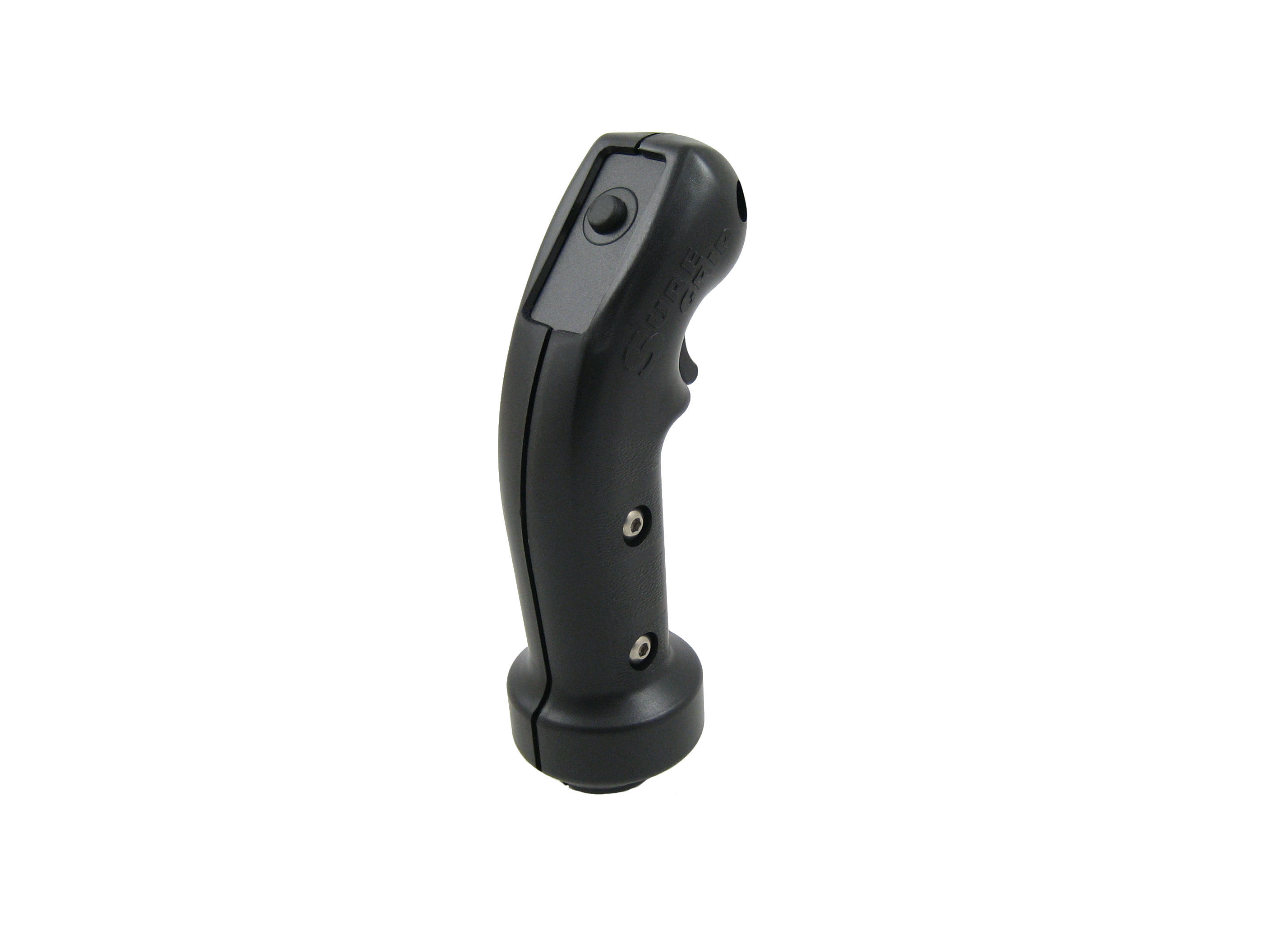

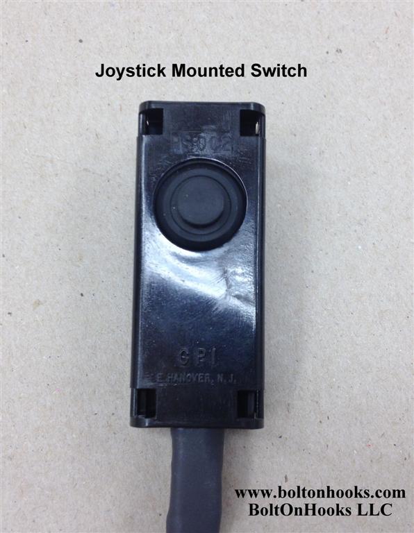

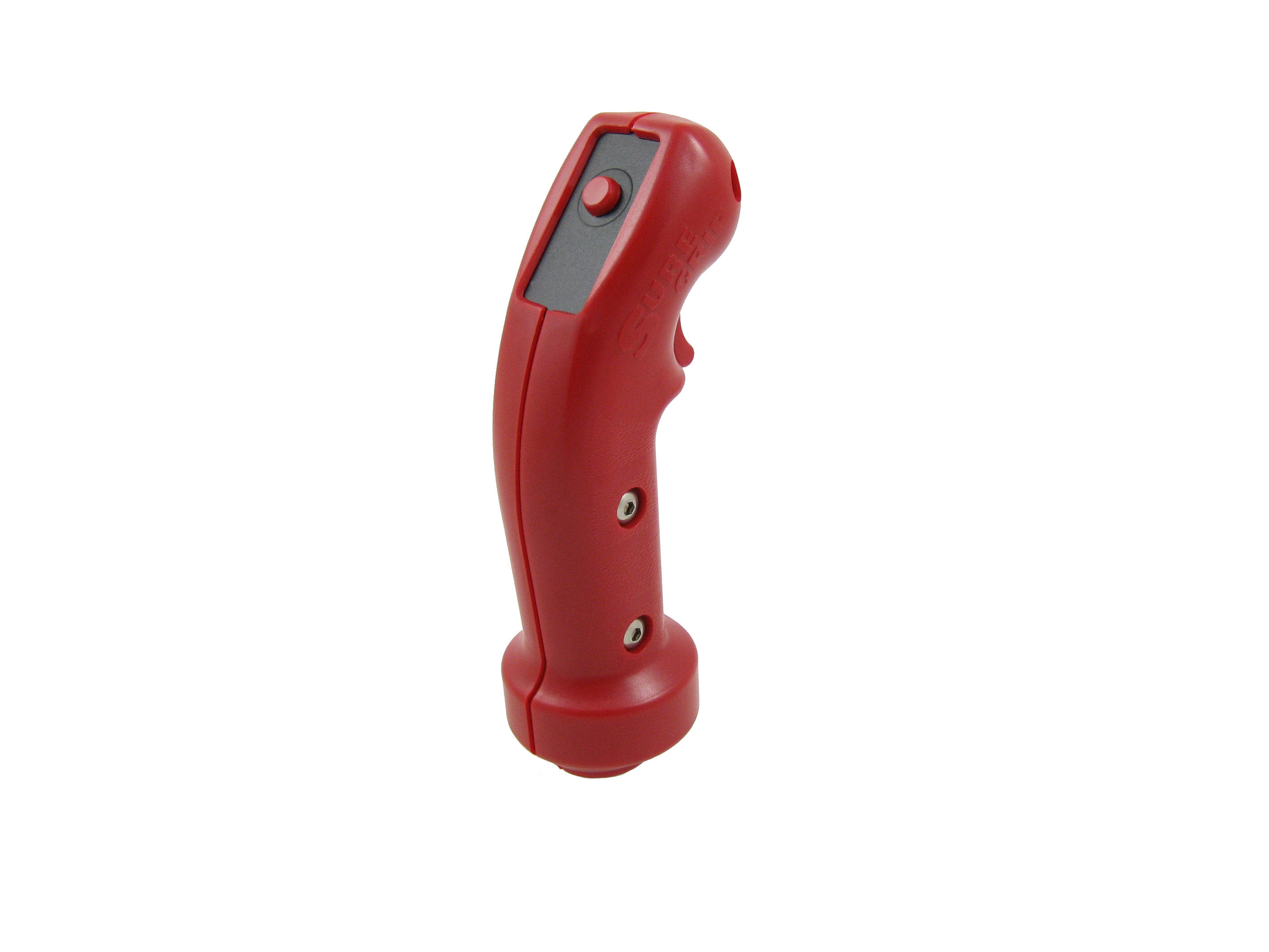

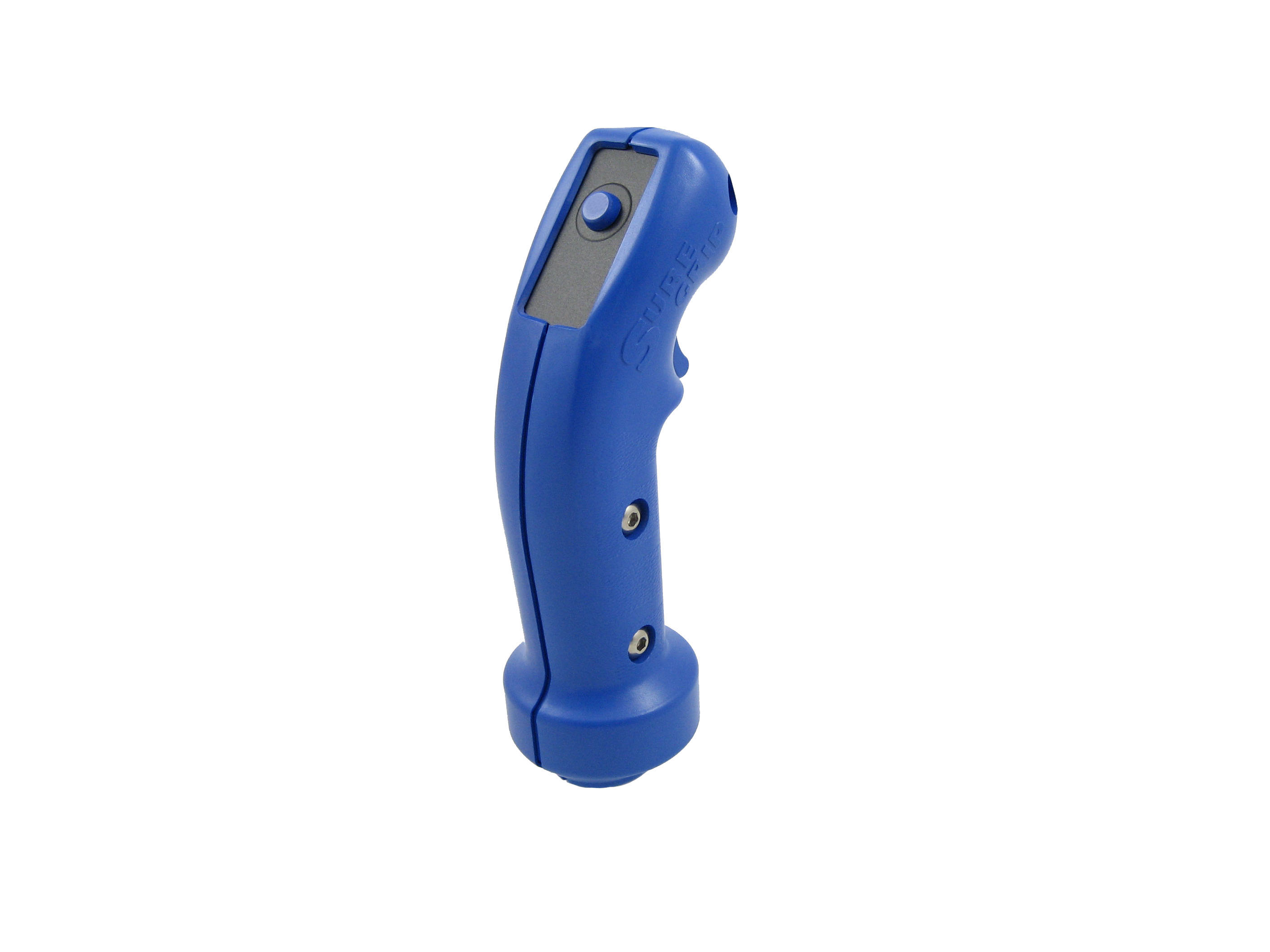

so with the diverter, I'm waiting a second for it to switch and then I use the curl on the stick. With 3rd function I have 2 buttons, open and close in real time, correct?
A diverter is going to switch circuits instantly when you press the single button on the stick, only hesitation would be the time it takes you to move the loader stick which ever way you needed for the grapple to open or close. If you were already curling or uncurling and hit the button the grapple would respond instantly.

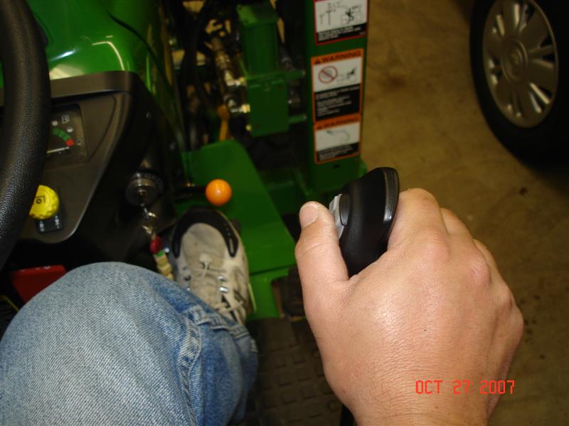

3rd function has the 2 buttons , one for open, and second for closed. With it you don't have to move the joystick at all to operate the grapple. So you can lift the loader, curl, and open or close the grapple all at the same time, basically your dividing the fluid flow between all three functions so it's going to slow down a bit the less GPM your tractor pumps. One thing with a 3rd function is , it's either on or off, no way to feather it, as with the diverter, it can be feather just like when curling or dumping the bucket.
Either set up will serve you well , just have to decide which YOU would prefer. Once you get use to using either you should be happy.
One other way and a lot cheaper, is to run hoses off a rear remote, only disadvantage is that you have two levers to operate the loader and grapple.

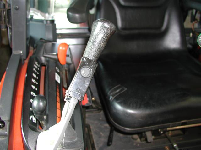

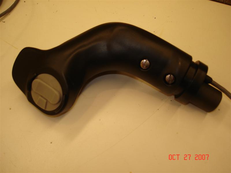

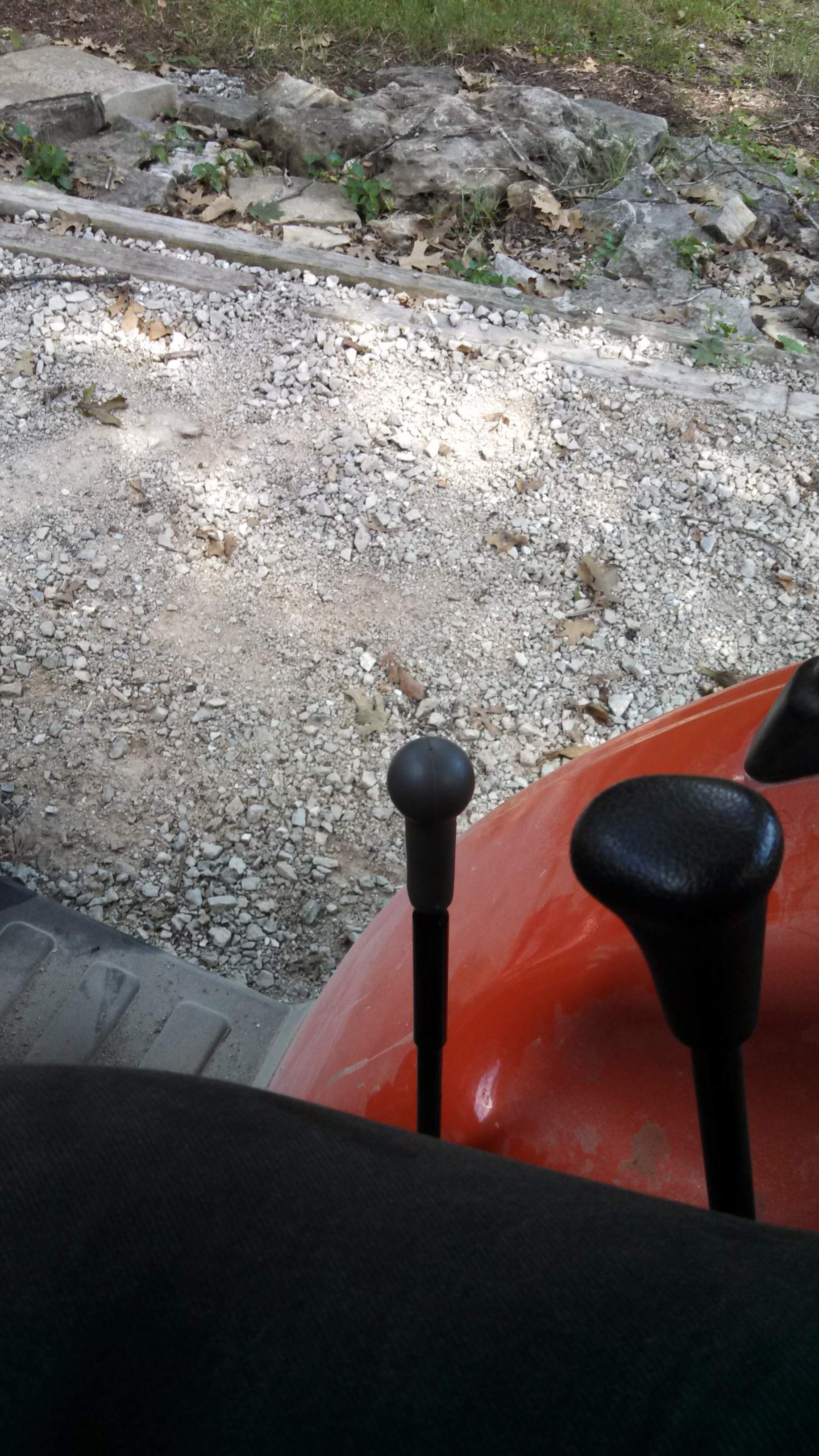

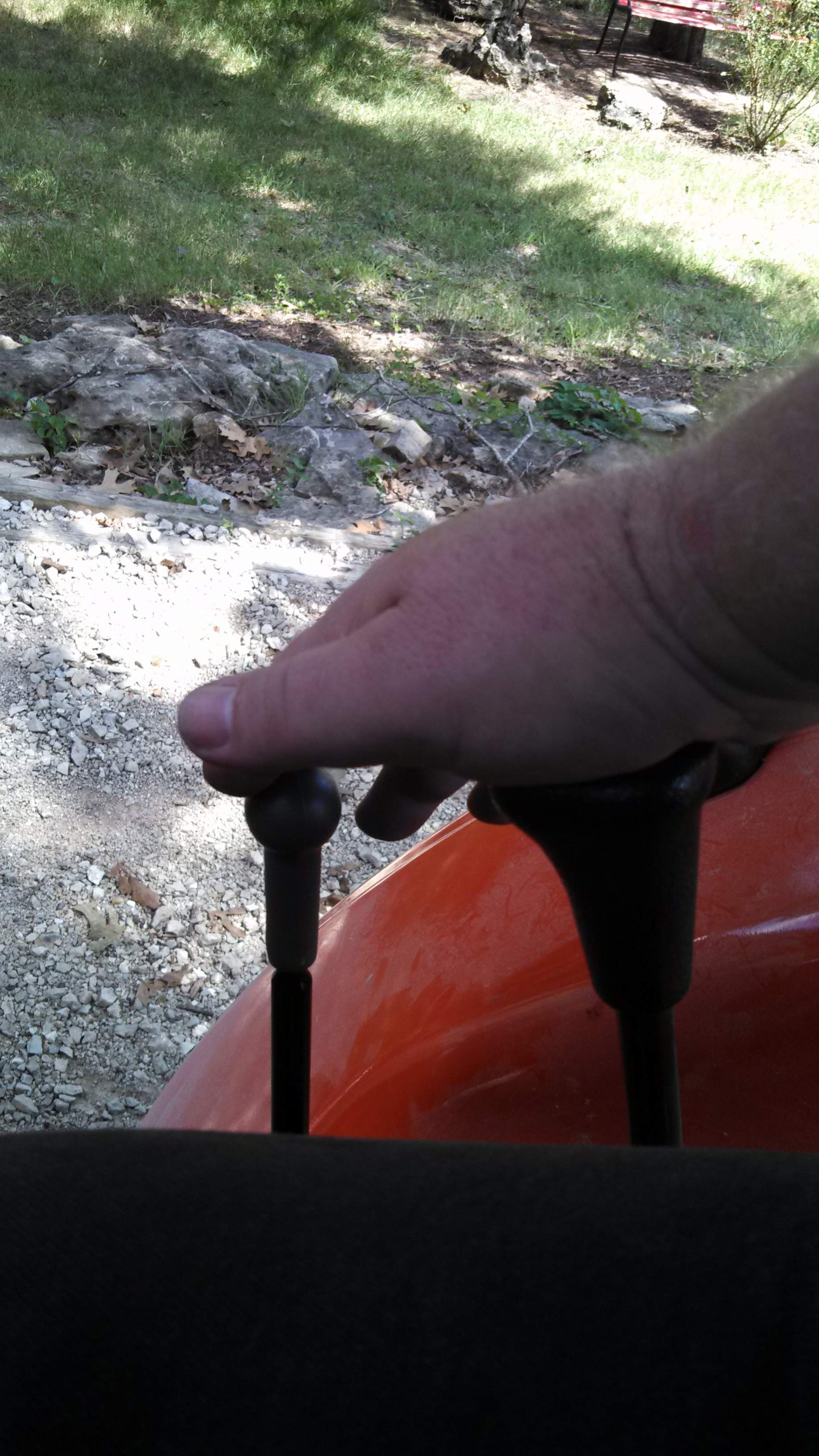

So your saying you can't have a nice switch AND use a diverter? :confused: Or am a mis-reading your comment?
No, I am suprised! Nice job. I pictured a funky switch on the dash somewhere or a manual valve up on the loader frame or something. I could see using your set up or what K0ua did or Mtn Views "new handle" set up for sure!
That is the clearest explanation yet, thanks for that! I didn't realize you only had on/off with 3rd function, I can see the ability to use "feather" an advantage. I think that is what I will do, thanks to everyone who commented! One more question: is the button a press and hold or is it press /release and it stays with the chosen circuit?
/ True 3rd function or diverter valve for grapple? #26
Diverters are generally operated with a momentary switch, so the "new" circuit is only active when the switch is held in.
Yes. Budweiser John described the hesitation of the diverter very well.
Here's his statement concerning loading the Grapple using a Diverter: What I learned very quickly is some hand coordination is required and when hitting the diverter switch it's necessary to pause a second or two for the hydraulic pressure to build in the grapple cylinder thus clamping the load securely. In the case of compressible material such as brush it's sometime necessary to depress the diverter switch more than once after the initial load is picked up to insure a tight grasp.
With true 3rd function you can lift the boom, curl the Grapple and clamp the jaws all at the same time. No confusion, hesititation or additional coordination required. I can approach a pile of brush with the Grapple open and rolled forward. Set it down on the brush pile. Push the "close" button with my thumb and hold it causing the Grapple to apply closure pressure. Then curl the Grapple back while also raising the boom. The Grapple will automatically close tighter on the brush as things move. In one swoop I can pick up that brush pile leaving only the very small stuff behind.
For users that say having all 3 functions at once isn't important I'd suspect they've never had that feature.

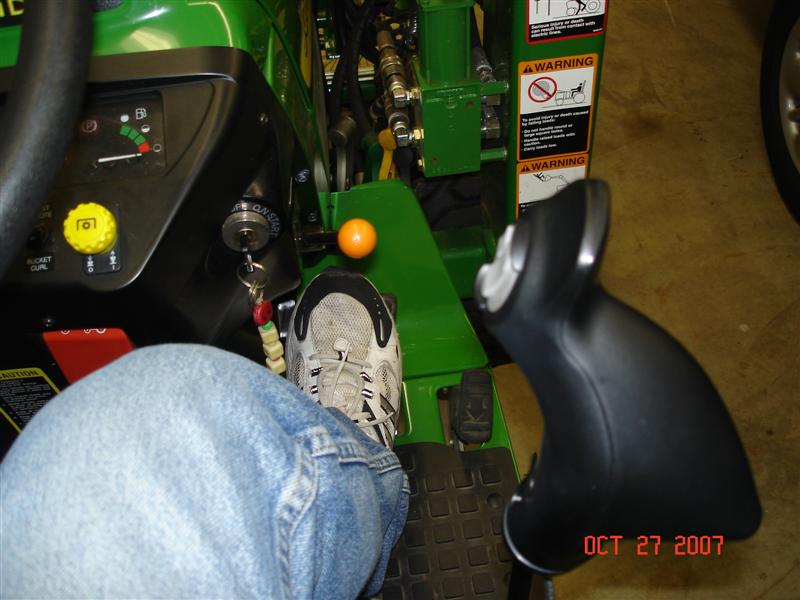

I used a ATV winch toggle switch tied to the loader handle, it actually works quite well and waterproof. Think it was $15.

Some of the above 3rd function operation comments /descriptions could lead to confusion regarding "feathering" of the grapple lid. When you press open or close you can stop the lid / lids at any point in their rotation. It isn't full open or full closed. Yeah, you cannot vary the speed of open or close but, that's not an issue.
My 3rd function controls, on both tractors, is a toggle switch and not two discreet buttons. My 3rd function hydraulic connectors, on front of FEL, are one male and one female. This assures that whichever tractor grapple, tree puller, etc. is installed on, pushing top side of toggle switch opens and bottom side closes.
