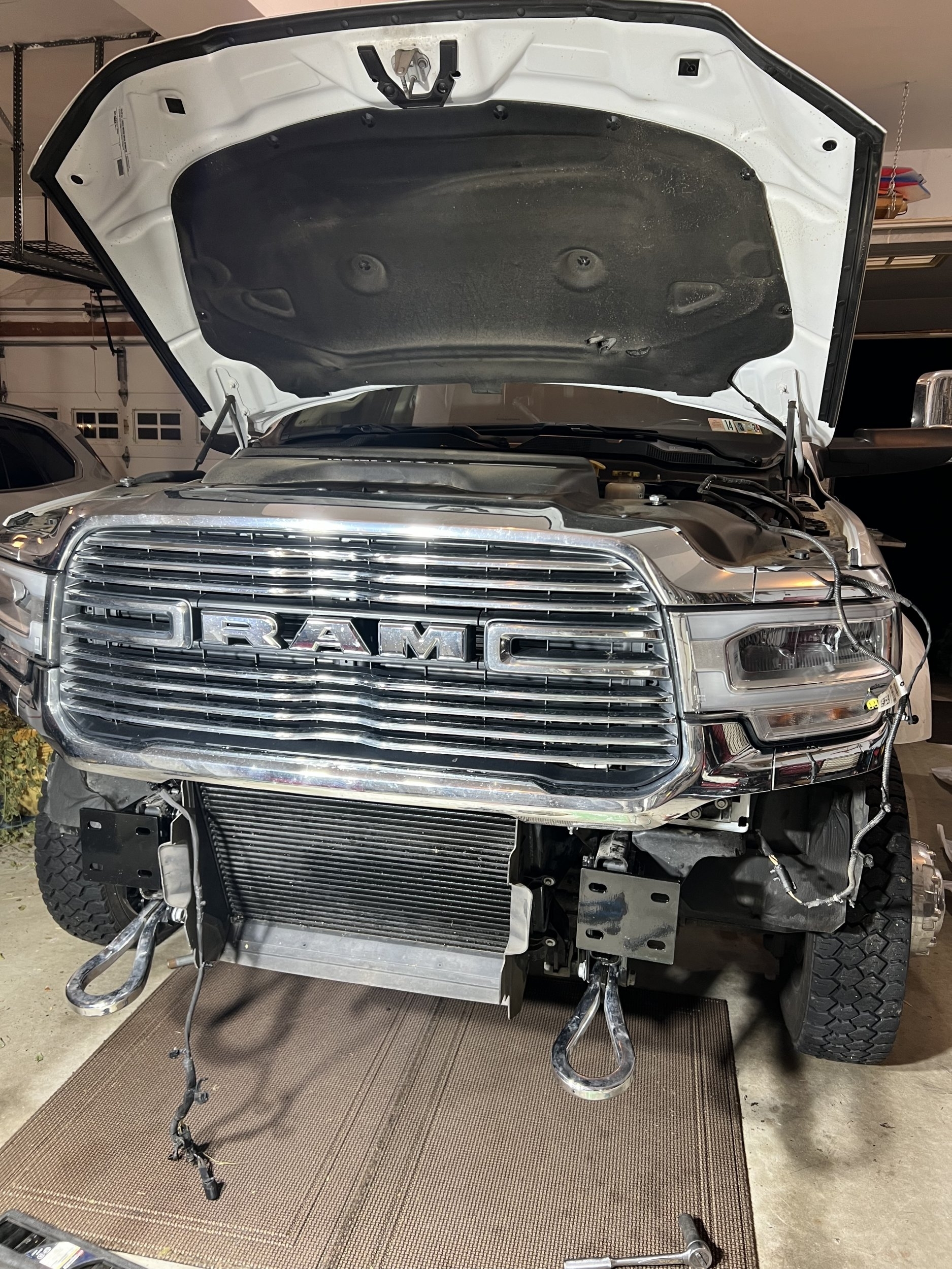

Looking to install a 20K + winch.
Had my sights on a 20-25K Sherpa. Looks like the best you can get, but they are super expensive.
Was looking at these on Amazon.
They claim the motors and larger parts are German/American made. Not a Chinese made winch
Less than half the price of Sherpa.
Here’s the company store. Looks like they have a lot of experience.

I guess I’m down to Warn, Mile Markers, Sherpa and Pro-winch.
The Mile Marker‘s only achilles heel is the engine must run.
The Sherpa looks amazing, but is psycho expensive
I haven’t looked into Warn yet, but I know they are top notch and great reputation
The Pro Winch I don’t know much about, but looks like a great value.
I think I’m down to Warn or Pro Winch, but would still consider Sherpa if I could free-up some $$
It’s noteworthy that Sherpa just put their 20K on sale for $2,000 (normally $2,500)
I welcome any additional comments or suggestions.
