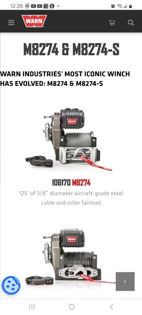

I have used my warn m8274 for endless years, yes its heavy, but fast and very powerful. It's been rebuilt a time or two but has a receiver mount and jumper cable set up I made works great. And have several doubler blocks to help on real heavy items. Will see if I can find a photo of it in use, pulled a 60' lift sunk in mud once with use of trees for anchors, no room to get anything else close to problem.View attachment 837634
It says it has "evolved", I hope so because the one I had, had only one keyway between the shaft and drum. I stripped that out two different times! I got fed up with THAT, and welded the drum to the shaft, and sold the winch!
I then bought the Warn 12,000 planetary winch (NOT china made) and all these years later it still works perfectly. I've winched out my 3/4 ton "loaded" pu, no problem at all and it was high centered crossing a swamp.

I looked at Sherpa when needing an 18,000 or so winch and ended up with a ComeUp.
Goofy name, but impressive winch, I think. Hard to go wrong with an 8274 though, and the 150 feet of cable usually allows for using a snatchblock if necessary.
