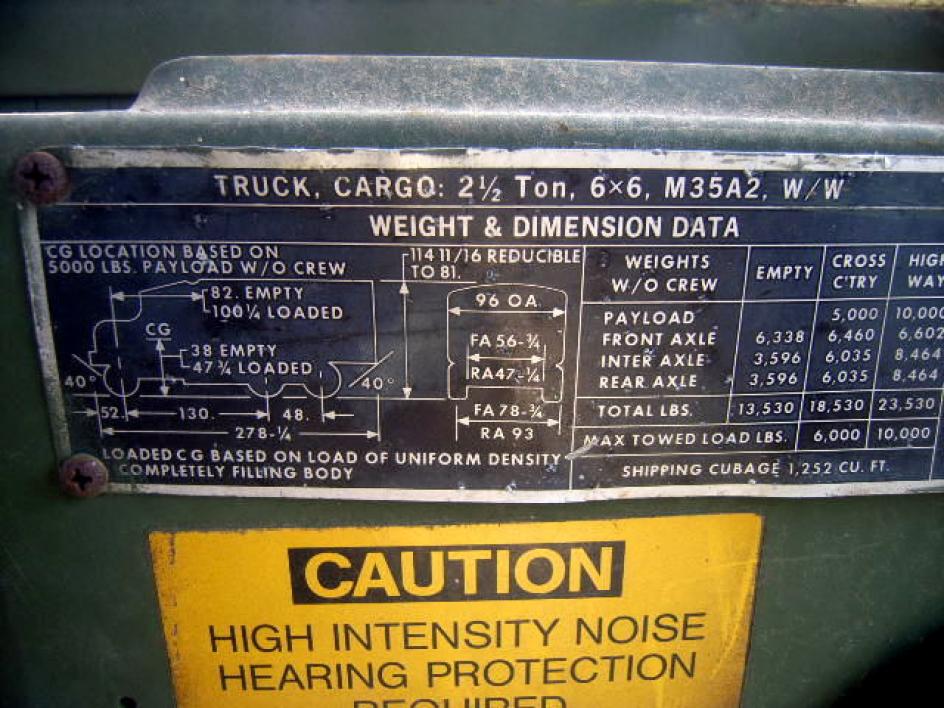

Okay , I want to hear your definitions of 1/4 , 1/2 , 3/4 , and 1 ton trucks . Explain the ratings with facts . Why the ton measure ? I know for a fact , a 1/2 ton truck is not gonna haul 1000# of rock or sand very far . Excuse my ignorance .
MY opinion,
the best I can come up with is the ton rating is a old military cross country rating, (cargo weight)
I do not know when it became popular, but my guess is ex military under stood (post ww2) what a 1/2 ton rated truck could do and what a larger ton rated truck was capable of, most likely more of a selling point,
I have a old 6X6 2 1/2 ton truck, the cross country rating is 5000 pounds but the highway rating is about 10,000.
but the best way is to go off of the GVW tag
even tho the ton rating is still used going by truck classifications probably more accurate, today
http://en.wikipedia.org/wiki/Truck_classification
http://voices.yahoo.com/guide-truck-classes-light-medium-heavy-duty-5266315.html?cat=27
http://www.wrcog.cog.ca.us/downloads/050205 Truck Type Appendix.pdf

MY opinion,
Truck classification - Wikipedia, the free encyclopedia
Guide to Truck Classes: Light, Medium and Heavy Duty - Yahoo Voices - voices.yahoo.com
Deuce and half... Nice! :thumbsup:
