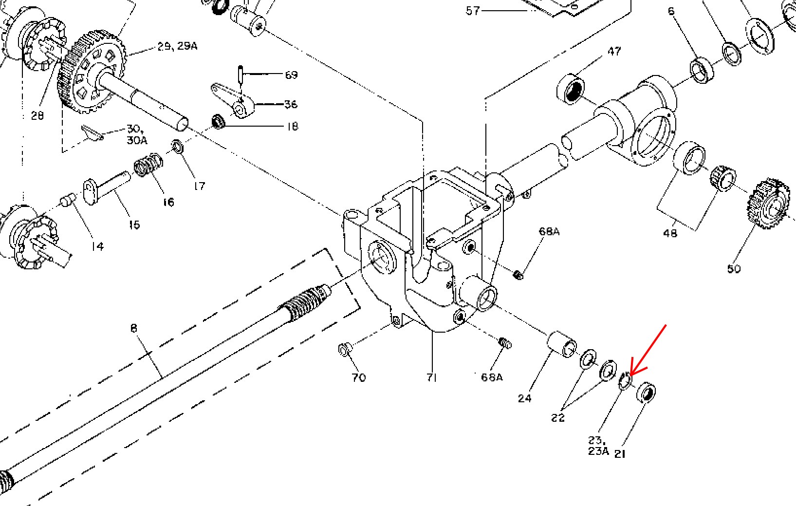

There is one belt, two pulleys. It is a two speed depending on which pair of pulleys you have the belt on.
Probably missing the c clips on the axle if the axle shaft is sliding laterally. See pic I'm sharing from the parts manual.
Sorry NH that doesn't sound right..?.
The 2 speed trans is actually gear selected
the selector slides on the pins in the diagram you posted.
the belt is basically used as a clutch/de clutch device and the pulley can drive the unit in reverse by driving the disc/pulley in a reverse direction when the belt is loose and the engagement lever raised.

Thank you, I believe my problem is the axle , gonna replace the seals, retaining clips& washers. Hopefully this fixes it . Thanks for the reply!
Thank you for replying, I took a quick look and the c-clips are not there, gonna try to replace seals , clips, washers. Hopefully this fixes the problem. Thanks again !!!
