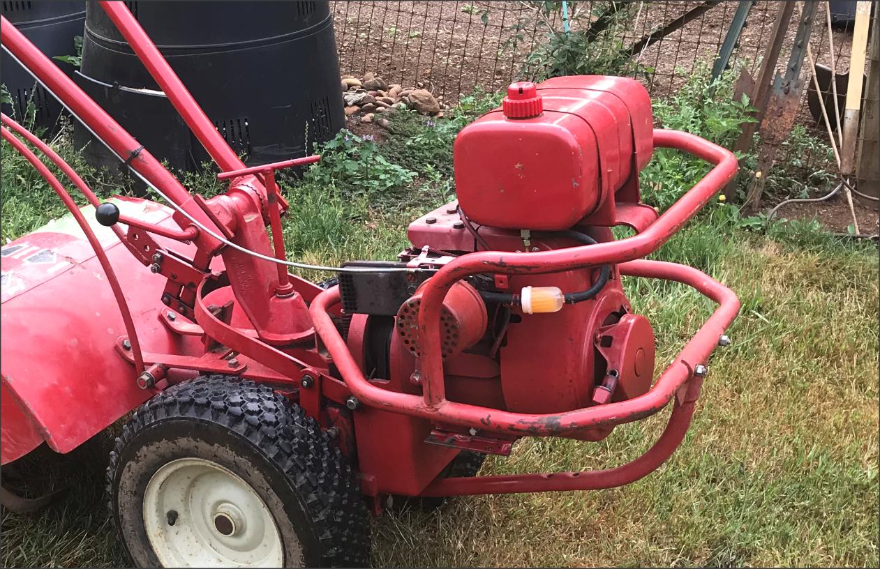

Well its over.. Big lesson learned. I removed jet as suggested, cleaned, air out and installed. Same problem EXCEPT fuel started coming out bowl vent and that indicated to me bowl full and needle stuck open.
Removed carb, looked in needle and seat....junk abounds. This kinda puzzles me cause gas clean, tank not bad and a new carb. I immediately rulled out .carb cause if was new.
When i took the bowl off the gasket kinda puffed full and could not be reused. Took gasket from old carb, installed bowl and carb. Backed off 1.5 turns, tiller fired. Fine tuned bowl jet and tiller is advancing on throttle fine. Big lesson, never trust something cause its new.
Thanks for all the replies, we are far better informed.
Respectfully, Butch

Is there a fuel filter before the carb? If not, install one. Prevents a lot of grit from getting to the carb from the tank.
I've also found that many times when I remove a carb, mess with the fuel lines, change a fuel filter, etc... it'll knock gunk loose that then gets to the needle and float.
Glad you found your problem. :thumbsup:

Appears to be oem filter in gas tank. I will recheck and put one in line if it looks shabby. Defintely running much better. thanks
   / Troy Bilt Horse.....Stumped #19

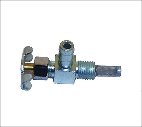

Yes it's well worth installing one of these generic fuel filters, as well as one of these fuel shutoff valves so you can run the carburetor empty before storage.
:drink:
