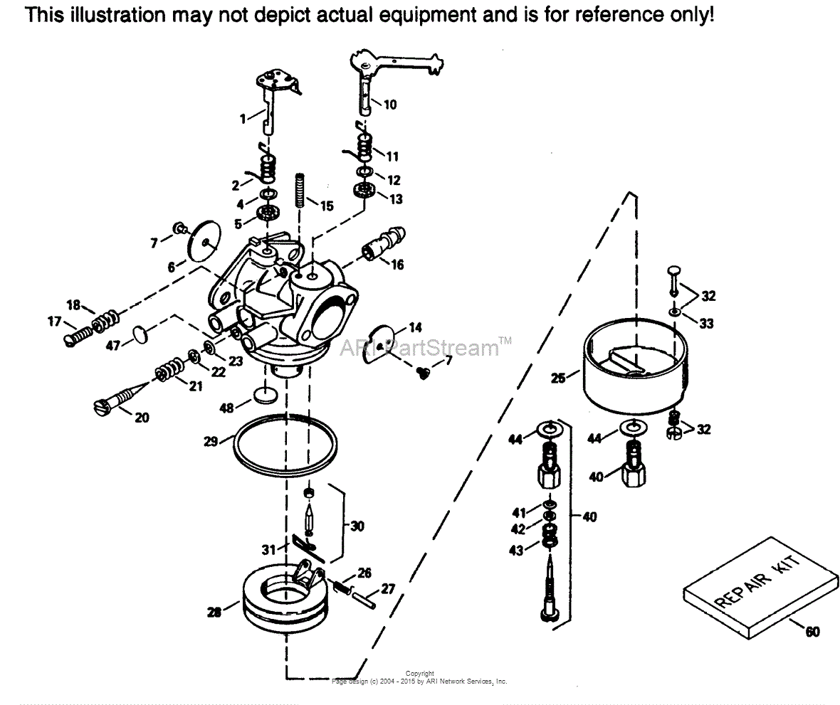

Engine has me bewildered. New points, new muffler, new oem carb. I let it warm up, runs pretty good lower rpms, but typically as soon as i give it more gas, it skips as if starving for fuel. Misses so severly i have to back of to lower throttle.
Adjusted carb and double checked. Just wondering if when it starts to skip if i shot some fuel in the breather and corrects that would answer problem as fuel issue. Any ideas would be appreciated.

Maybe a plugged hole in the side of the main jet on the bottom. Part 40.

Likely a plugged hole in the side of the main jet on the bottom. Part 40.
Bruce
Well i will check if out, thanks. Did not even give the jet a thought since brand new OEM carb.

It's a very tiny hole. A little speck can plug it.

Well its over.. Big lesson learned. I removed jet as suggested, cleaned, air out and installed. Same problem EXCEPT fuel started coming out bowl vent and that indicated to me bowl full and needle stuck open.
Removed carb, looked in needle and seat....junk abounds. This kinda puzzles me cause gas clean, tank not bad and a new carb. I immediately rulled out .carb cause if was new.
When i took the bowl off the gasket kinda puffed full and could not be reused. Took gasket from old carb, installed bowl and carb. Backed off 1.5 turns, tiller fired. Fine tuned bowl jet and tiller is advancing on throttle fine. Big lesson, never trust something cause its new.
Thanks for all the replies, we are far better informed.
