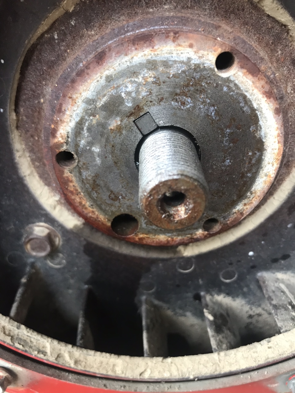

I have a 1992 Horse Troy Bilt that I purchased new. It has the 8HP M8T Kohler engine. It has recently developed an issue of kickback when starting ( recoil start). It has broken the rope and pulled the rope out of the handle. It starts ok with no issues at times and runs well, but this is an ongoing issue with the recoil. Where should I look? The ACR system, flywheel key, spark plug, coil/ignition? I'm stumped

The flywheel key is quick easy and cheap to check. The same with replacing the spark plug and freshening up the fuel. The problem with tillers is that one that is 17 years old can have 500 hours on it and the other 50. Where do you think you are at? Can you post some engine model and spec numbers. I would think that this is electronic ignition.

I am thinking it is the M8 with spec number 301608 which uses the electronic ignition module ACR parts are obsolete so could be difficult to get camshaft parts if needed. I would flywheel key and or valve clearance to start. A valve clearance out of spec could disrupt the ACR if gap is too wide.

Had an engine several years ago that was kicking back. The keyway key was twisted, not sheared and it threw the timing off just enough to act up.

Well I took the crank nut off to inspect the key and it appears ok.
What next?

How likely is the key to be the problem in a belt drive tiller? I can understand when a mower blade is on the bottom of the crank and you hit a solid object. The tiller has a belt to buffer the impact of such objects. Just asking, obviously I don’t know
