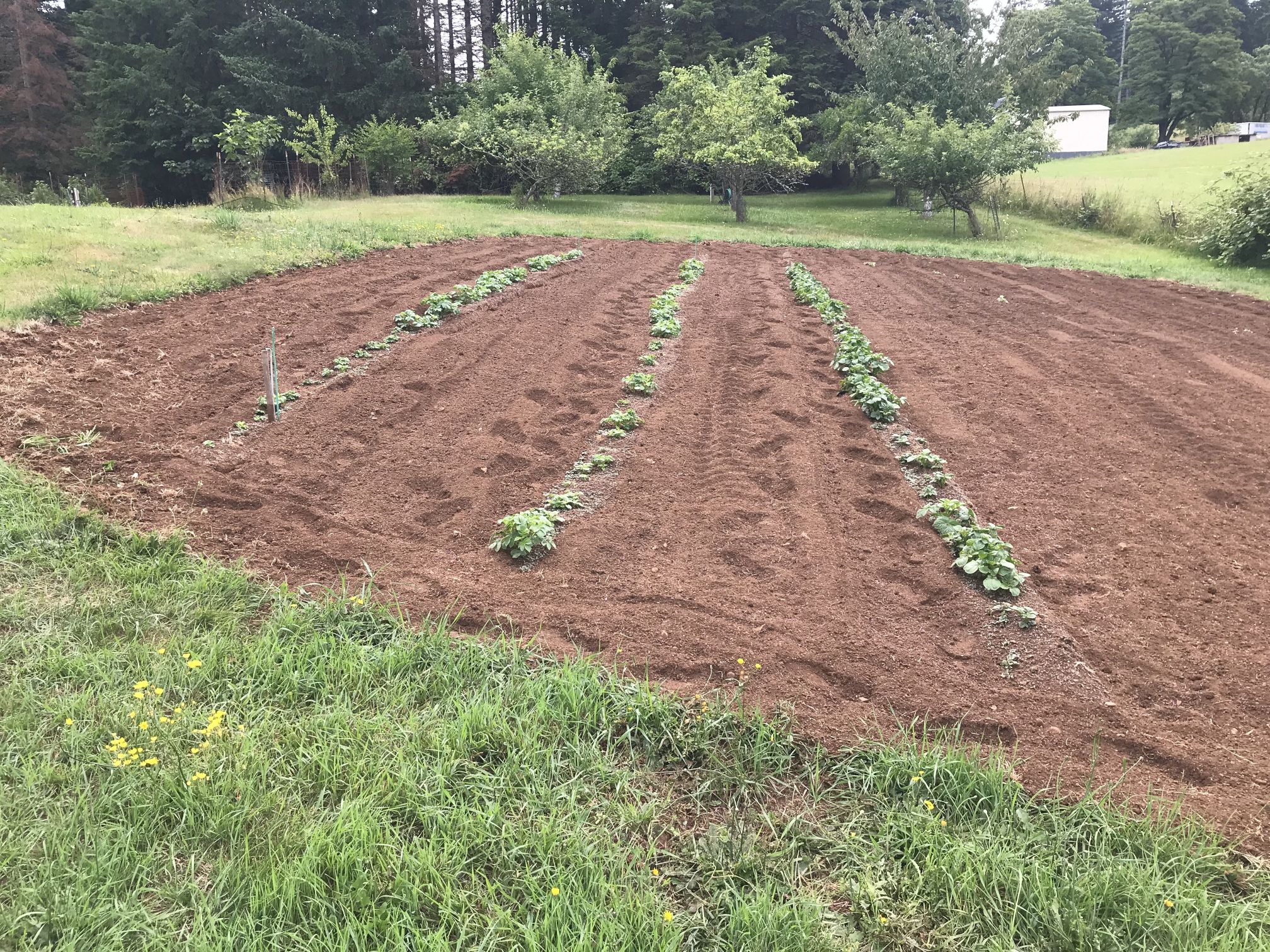

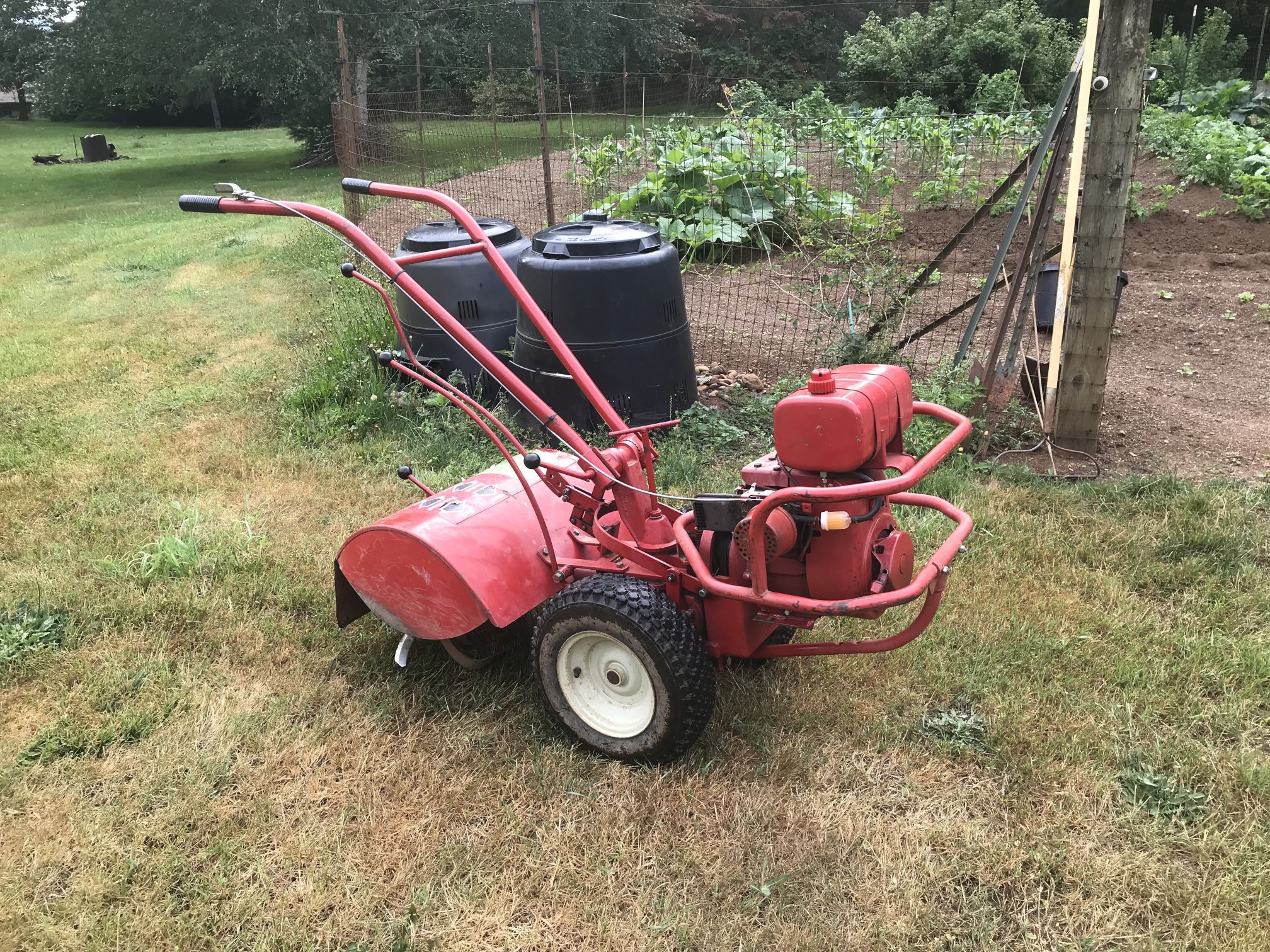

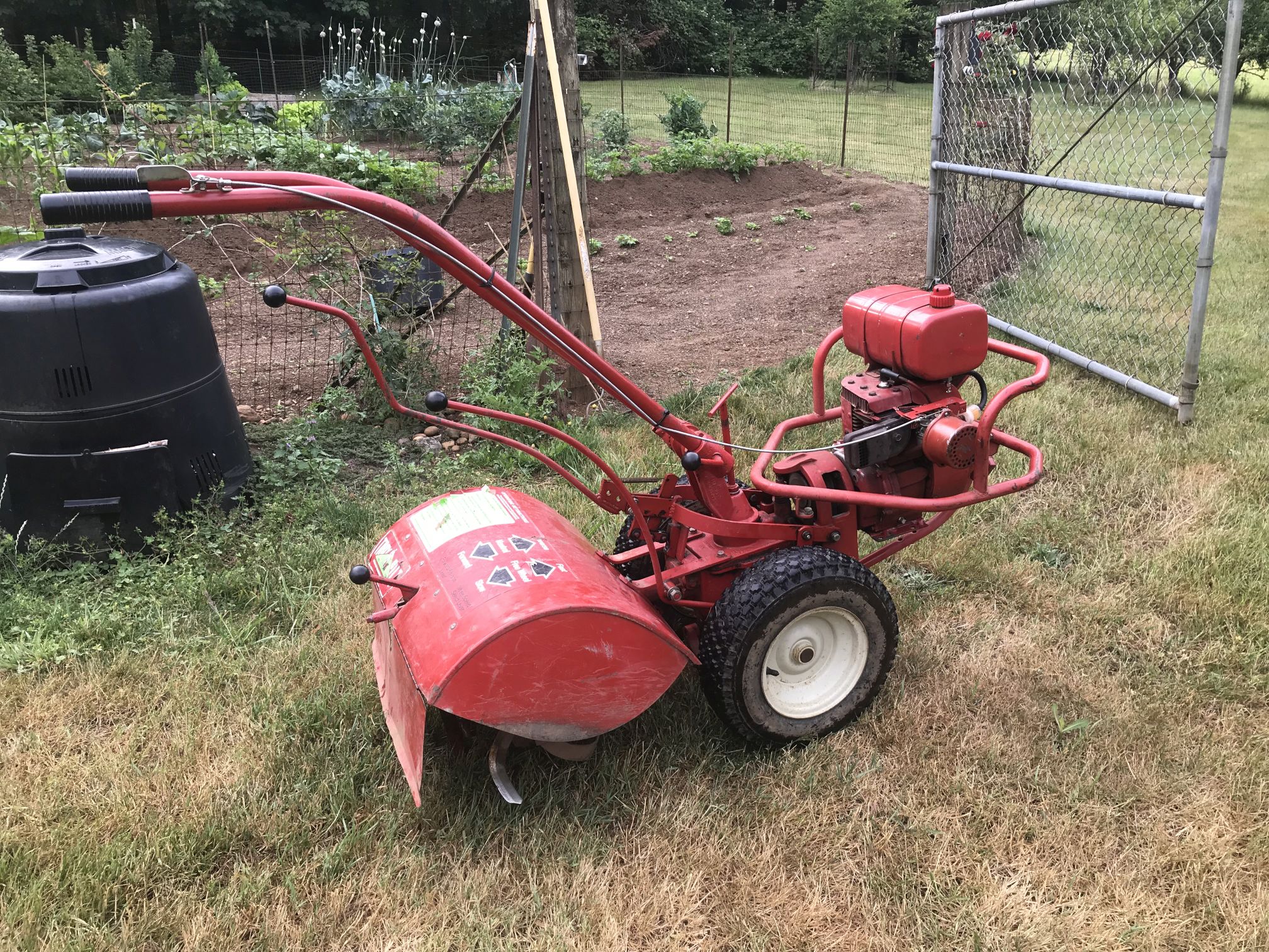

Hello everyone,
Here's couple of photos of used tiller I bought less then two weeks ago for $200 from a local fellow advertising on the Craigslist.
He was done with gardening for personal reasons and wanted to sell the tiller as is, knowing there were oil leaks in both axle seals and an issue with the engine not running under load. He figured it would not have made financial sense for him to take it to mechanic and pay for repairs!
I have done following repair / service work:
1. Replace axle oil seals on both, drive and tiller axles.
2. New 140 GL4 gear oil.
3. New 30W engine oil.
4. Open up & clean the carburetor.
5. Reinstalled the governor spring correctly. It had been installed totally wrong by someone (it would never have run properly the way it was!).
6. Install fuel shut-off valve at the tank outlet.
7. Install 40 micron in-line fuel filter.
8. High and low speed fuel jet adjustment to get the engine run properly under load & idle properly.
9. Lube linkages & replace couple of bolts.
About $55 in parts and supplies so far, but several hours of work.
I agree with the seller; In my estimate a Dealer's shop would have wanted to charge him probably 3 - 4 hours for labor!
Took the tiller for the first test drive yesterday and it ran very well.
This thing is a beast!
I will probably swap these "standard" tires to lugged, or ag tires which I have already in my barn from another project.
My new additional, or second garden has southwesterly slope which will be great for growing conditions, but it's enough of a slope that I had to slightly push the tiller forward at times when in low speed gear.
No lack of traction when in high speed which is great for just weeding in-between rows.
This will replace my 1996 Troy-Bilt Pony Proline which is a great tiller, but does not have enough traction to handle the slope in the new garden.
Cheers,
PS. I use an old 48" Maschio tiller in my tractor at the end of the season for weed control etc.
