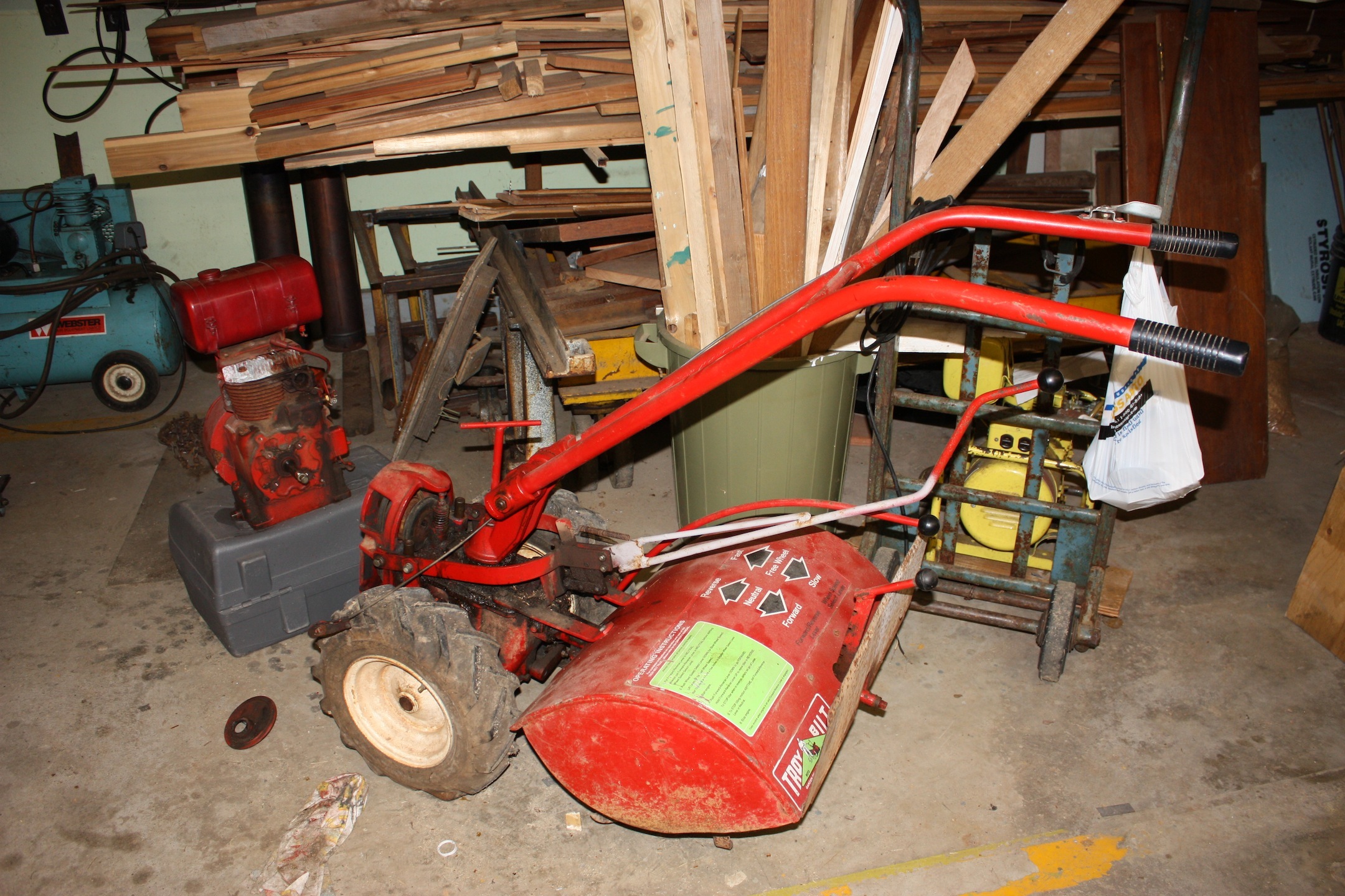

6.5 hp $207 with taxes in.
Need to adopt a new throttle cable and sharpen tines.
Tires need air plus I have an extra reversing wheel that I may install.
The old engine was a 7hp kohler.
TIA

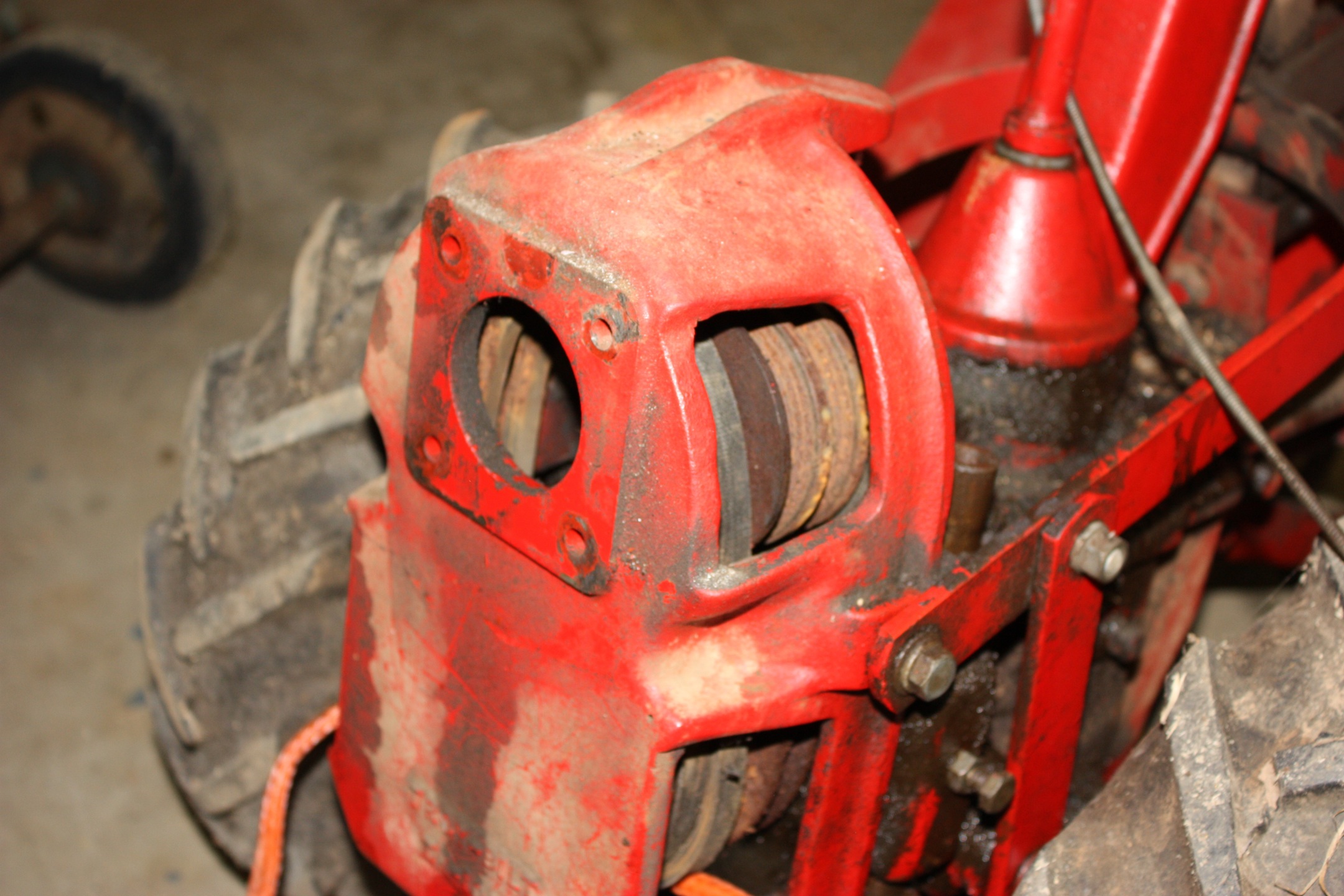

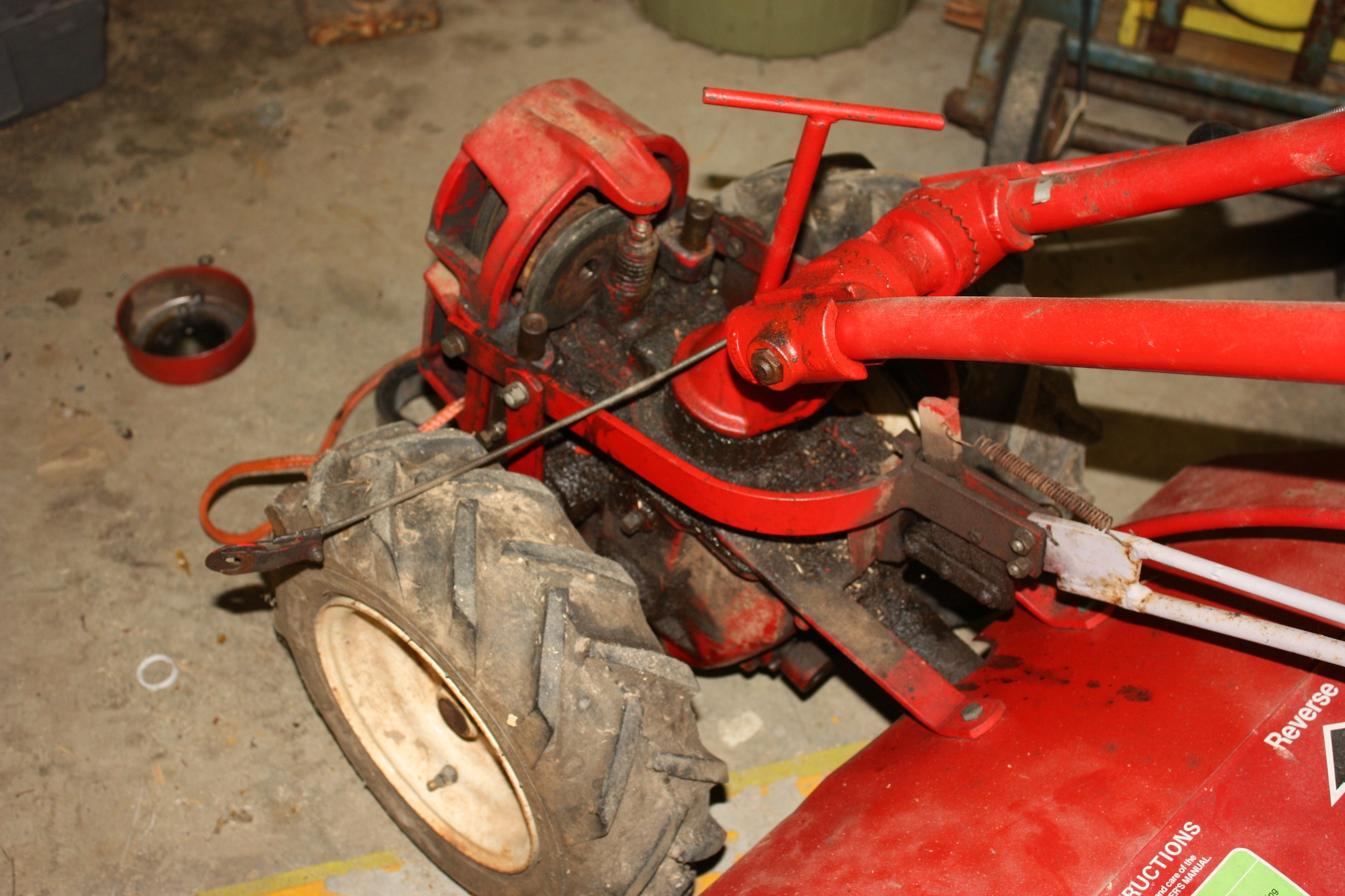

Were you able to swap the engine without taking the tiller apart? Your pics look like it, though my manual shows quite a bit of disassembly to remove the engine. You could access the engine mount bolts and remove and install the pulley? I just picked up a 6.5 Predator engine from Harbor Freight, it replaces the now discontinued Greyhound. I'm going to work on it tomorrow.
/ Troy-Bilt Horse engine swap #22

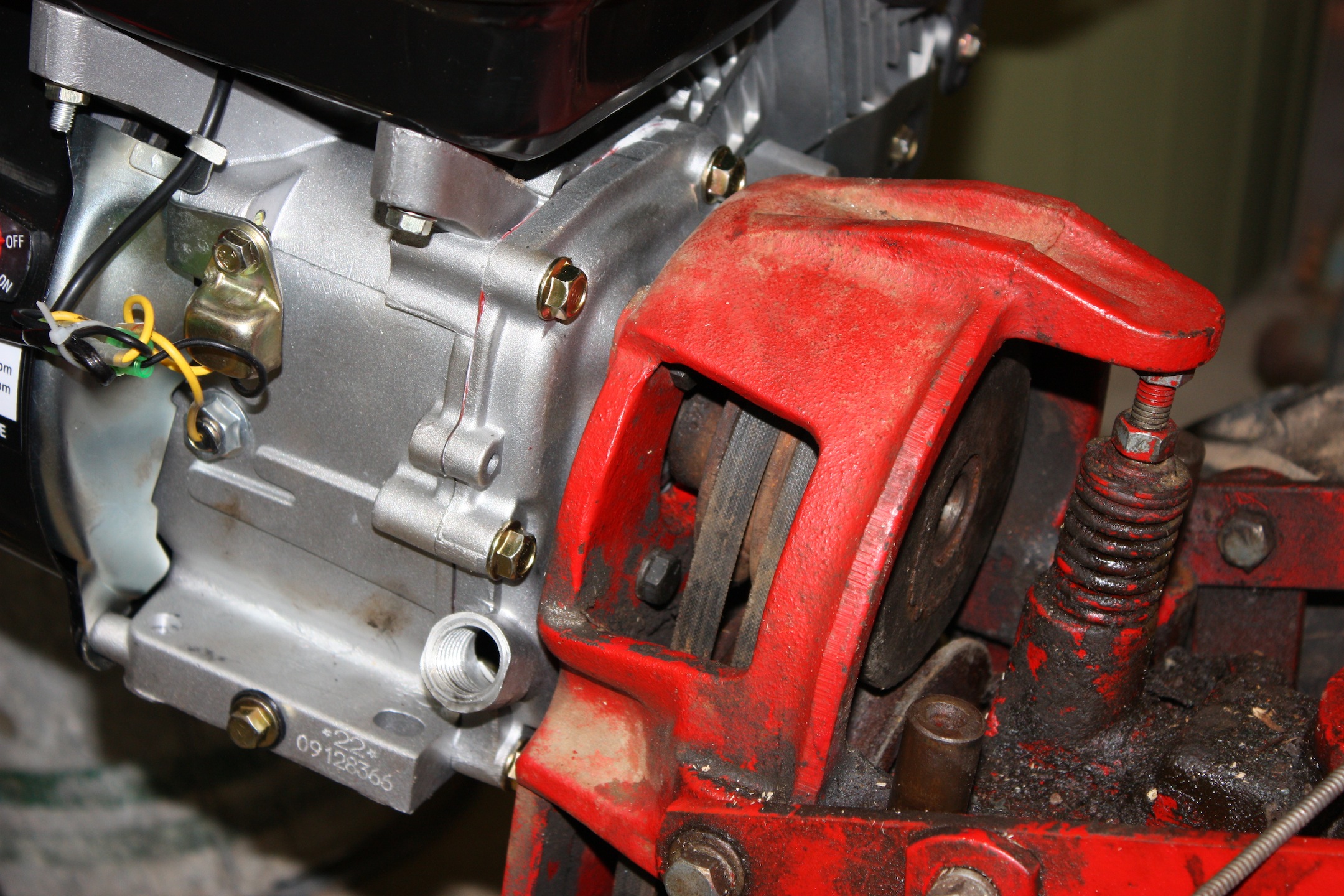

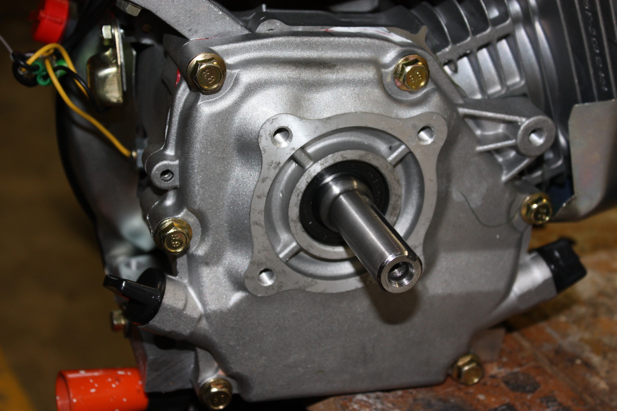

It can be be done! I swapped it out today and it went pretty well. I'm glad I has a 1/4" drive flex screwdriver to get around the pulley to finish taking out and start the mounting bolts. I broke the reverse disc taking it off and you could never access the mounting bolts with it on. New motor uses a 5/16-24 bolt instead of original 3/8" one on shaft to hold pulley. No way my engine mount pins were coming out, doing it the way the manual describes to change engine. I have to run to get bolt for pulley and then add oil and gas. I hope to be tilling in a few hours.
/ Troy-Bilt Horse engine swap #23
It works like a charm, I got the whole garden done.:thumbsup: I did make a jumper wire to disable the low engine oil switch, as it didn't like the tilt angle when deep tilling. I can't believe I was ready to spend way too much money on a new tiller and dump this 1972 one. Thanks to this site for inspiration.

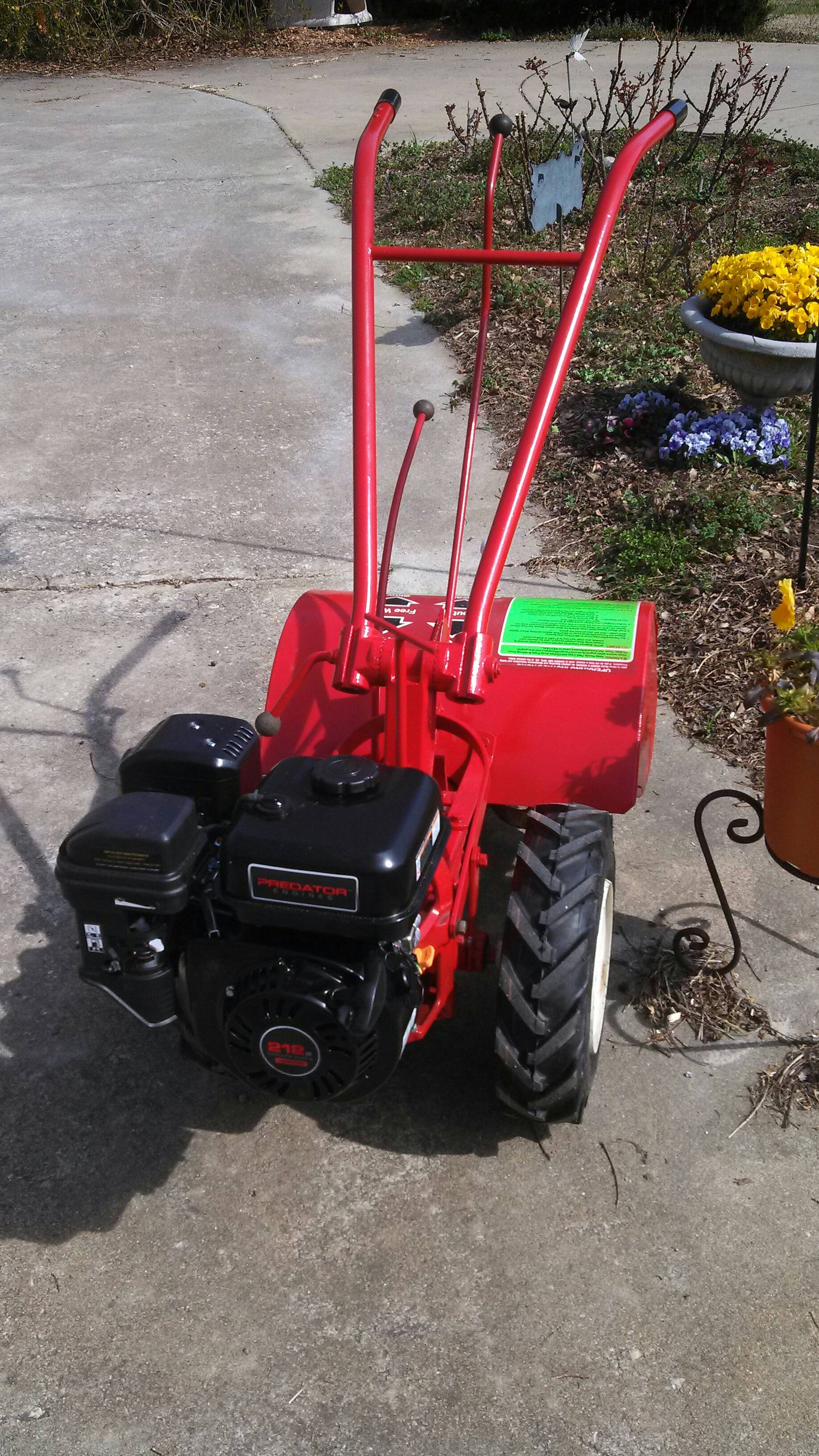

This is a photo of my re-do on an 82 6HP Horse with the Tecumseh engine. This site inspired me to renovate it after 30 years of service. The engine is the Predator 7HP from Harbor Freight. Sorry America (I'm as patriotic as anyone) but this engine was $99.00 with coupon. The holes mounted perfectly. The only difference required a few more shims behind the drive pulley and the shaft end was tapped 5/16-24 instead of 3/8-not a big deal. This is my second experience with Chinese engines. In both cases the engine out of the box required only 1 pull and fired off. My first engine (on a pump) has never failed to fire on first pull. I love Honda engines (still not American) but I can go through 4 of these for the price of a Honda. The tires are Oregon at $25. each from Mowtown, USA - Great name.

Yes, I'm the original owner. On the tap size I simply bought a grade5 5/16-24 bolt at HD and used it instead of the 3/8 on the Tecumseh.-fw

David: The tiller works fine-I hate to get it dirty-but it's there to work not for show :). On the shaft situation the drive/reverse pulley assembly fit right up on the shaft without problem and fastens to the end of the shaft. In doing so the drive pulley did not properly align with the transmission pulleys and I needed to shim the back of the pulley against the engine. The Tecumseh required only one shim. I had to use around 3 washers 1/2" size to shim the Predator and align the pulleys-a minor problem.

/ Troy-Bilt Horse engine swap #40
Thanks Frank,

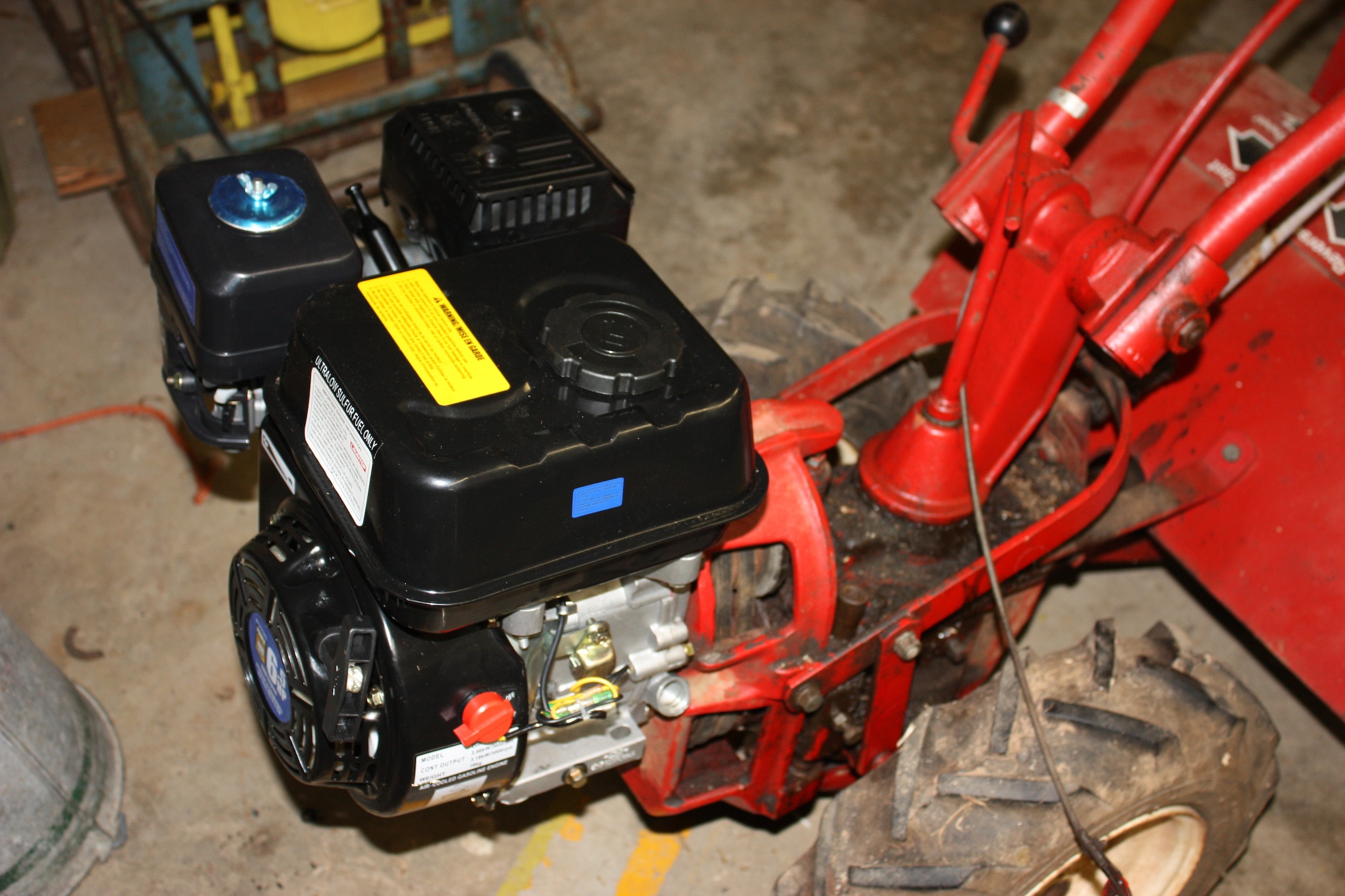

I mounted it this afternoon, went very smooth!
I had a couple of questions, there are 2 oil fill spouts, one with a checker, and one with a cover.... The manual says .5 qt capacity, I put that in, seems to be too full, flows out if I open. Maybe just added too much?
and the throttle control attachment of course is backwards. Reckon I don't really need that, how did you, or anyone else handle that?
Thanks again! David
Oh, my 92 model Horse with the ol' 78 horse in the back! a couple other pix of the new engine mounted!
