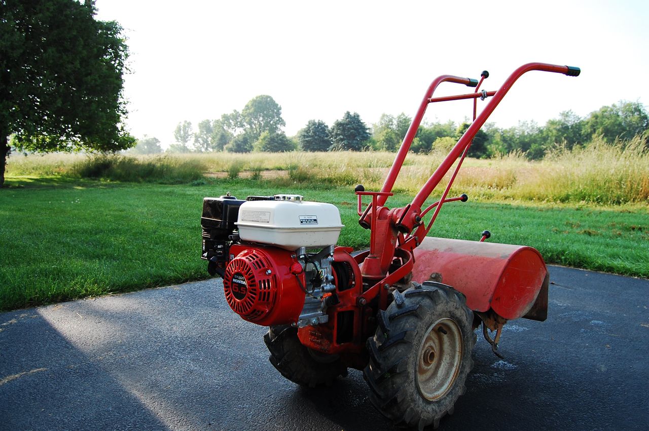

I had to disconnect the low oil switch on my honda there is a yellow wire near the on/off switch i just unplugged it and taped both ends with electric tape .
Like having a whole new tiller !:thumbsup:
I included a photo of my Honda swap you can see the orange electric tape in the photo to give you a idea where the low oil wire is . If you want I can take a close up photo tomorrow just let me know .

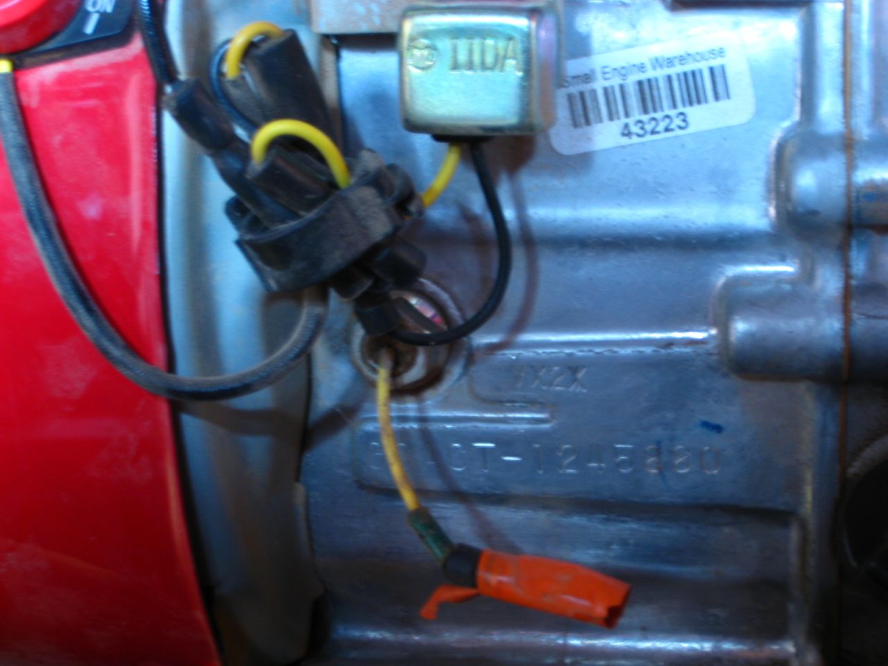

Yeah, your posts was one of the ones that inspired me. I agree the Honda red looks great and you can't beat the GX series motors, I could not receive approval from the CFO to spend that much so I went with the copy.
If you can PM a closer pic of the low oil wire that would be great, I'd appreciate it, thanks.

okay . See the plug into the block with the yellow wire coming out with the orange electric tape that is the low oil shut off sensor / switch . Just disconnect that and you will be good to go .
Just a heads up to I sold my old HH60 block on ebay to help offset the cost of the new motor . you could actually make a little more if you part it out , but i didn't want all the trouble of shipping multiply items .
hope the photo helps

Thanks for the pic, it is a big help. I tilled today and didn't have an issue. I was only tilling shallow to remove weeds so I'll see how it goes when I till deeper and the machine will be at a steeper angle.

I didn't have a problem with the switch until I did some deep tilling it cut out twice on me and I disconnected it has been fine ever since just keep a eye on the oil level and make sure the motor is close to level when you check it .
I use a 2x4 under the depth gauge to level out the tiller before I check the oil .

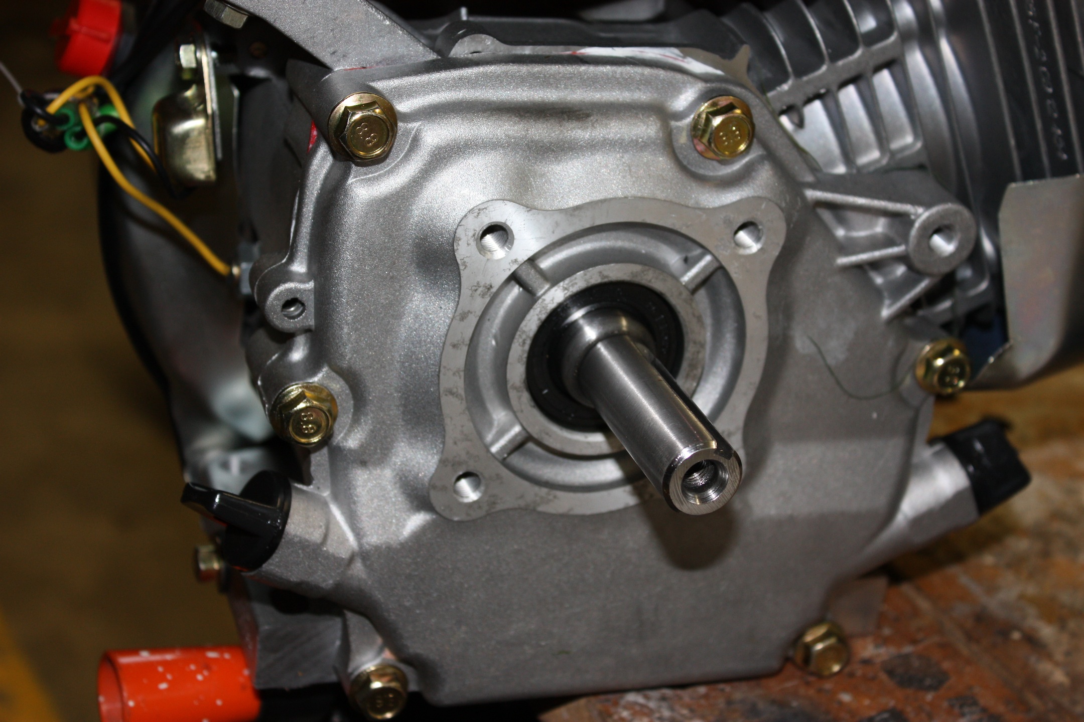

I checked out that motor at Harbor Freight and it states that the blot holes are 3-5/8 inches on center. My old Horse that has the 6HP Tecumseh HH60 has a bolt pattern 2-1/2 inches on center. Did you have to drill and tap holes on the shaft side of the engine to use it for this application?

That is a different measurement in their info. I think someone said it was a 3-5/8 circle measure they printed. The actual measure is the correct 2-9/16 square that the troybilt needs.

have 1977 horse with hh60 but harbor freight 6.5 engine mount
spacing is to wide for my horse. does hb have more than one 6.5
or is there a mod i can do. P38s engine swap looks real good.

Do you actually have the HB motor and it will not fit? The ad at their website gives the circular bolt measurement, but the square measurement is exactly right on my old Horse.
