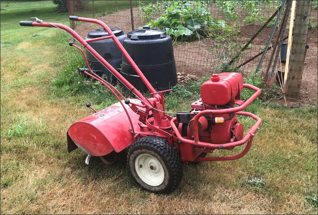

To the best of my knowledge when Garden Way started offering lightweight aluminum engines, they included a cast iron additional weight under the engine.
I understand and agree not wanting HF gas engine for a Horse tiller and I will also keep my Horse original with the HH60 Tecumseh engine, however there is abundance of all kinds spare parts for Honda clone engines on the eBay!
Here is the tiller I bought for $200 last summer:
