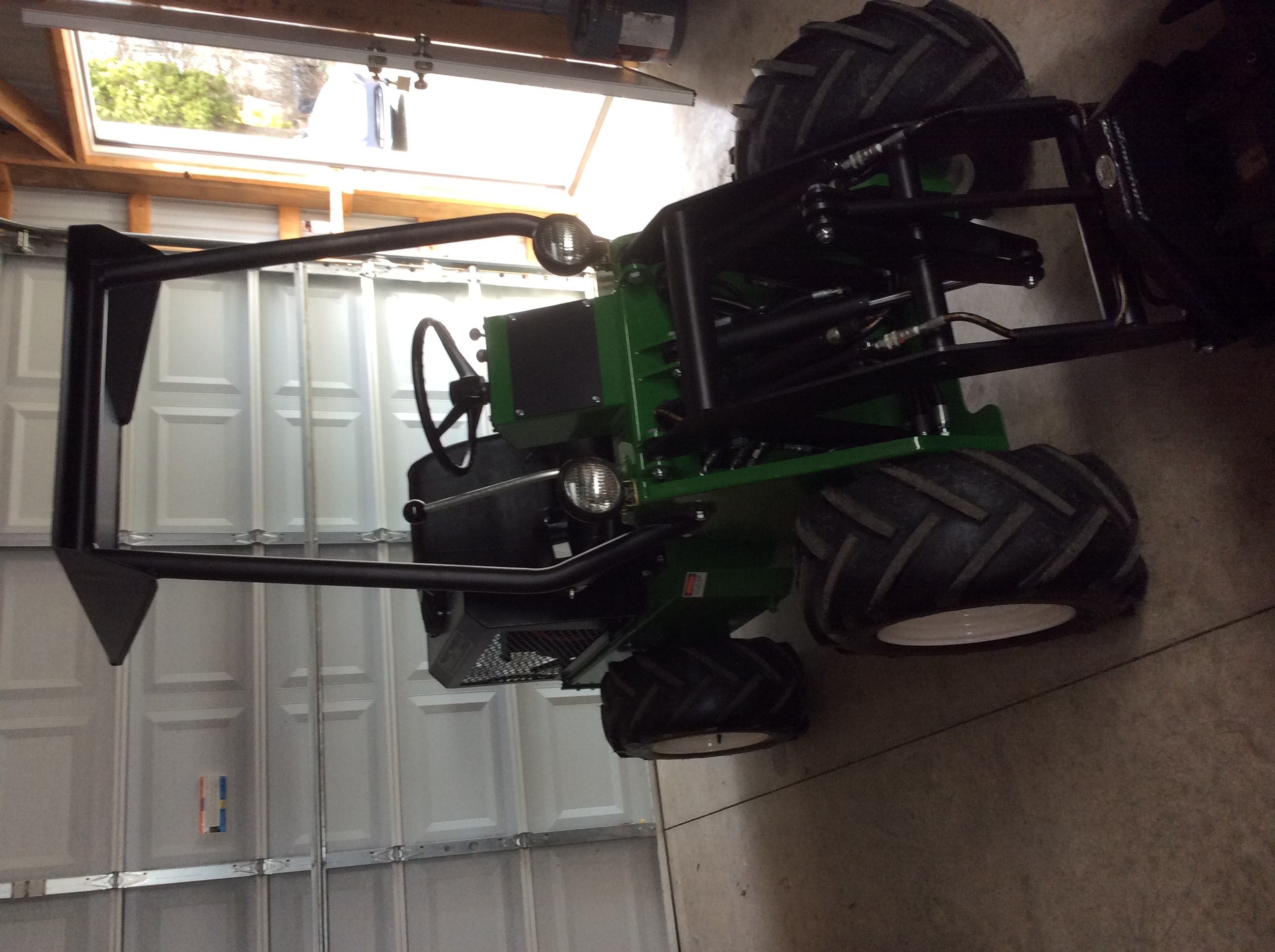

This has been a little delayed, you know life getting in the way sometimes. The 425 has been here for just about a month. I will try to post a pic or two. The process of ordering/paying and shipping was pretty much a breeze. Once we (the driver and I) realized that the reason she would not start was that the fuel tank was too low the rest was easy.
Before anyone asks: Kohler engine, 5 (w/teeth) and 10 cube buckets, blade with steel edge and wheels, pallet forks, mini hoe w/ thumb and utility grapple. Bar tires. Spare wheel/tire.
Have not had much time to use it but when I have it performed mostly as expected and sometimes better. Gradually acclimating to the steering (especially in reverse) characteristics. Really like the quick attach...does anybody not like it?
Have a possible issue but will post a separate thread.
Thanks to all TBNers who answered all my questions. Special thanks to Ernie in Bolivar for allowing me to test drive his 422 and gain from his experience.

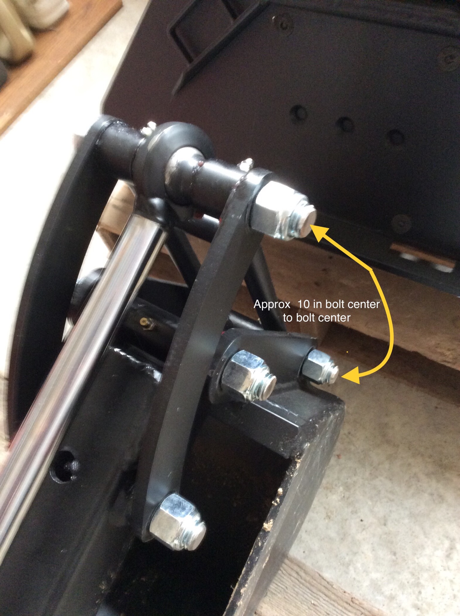

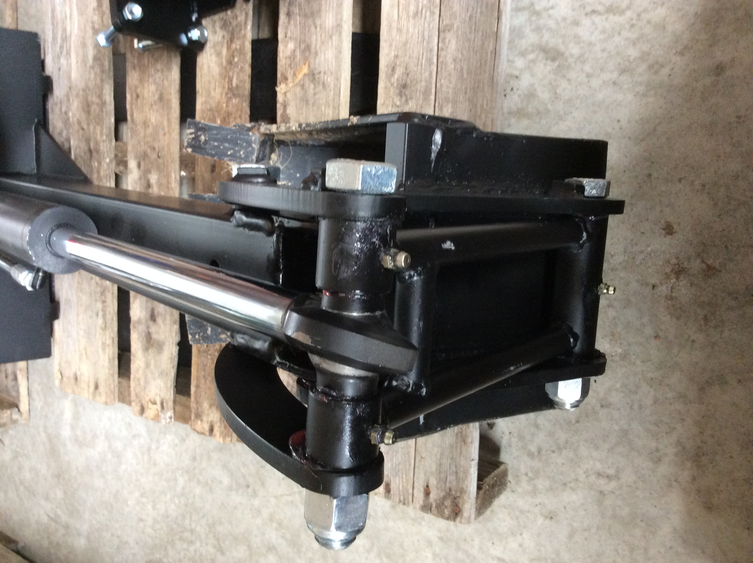

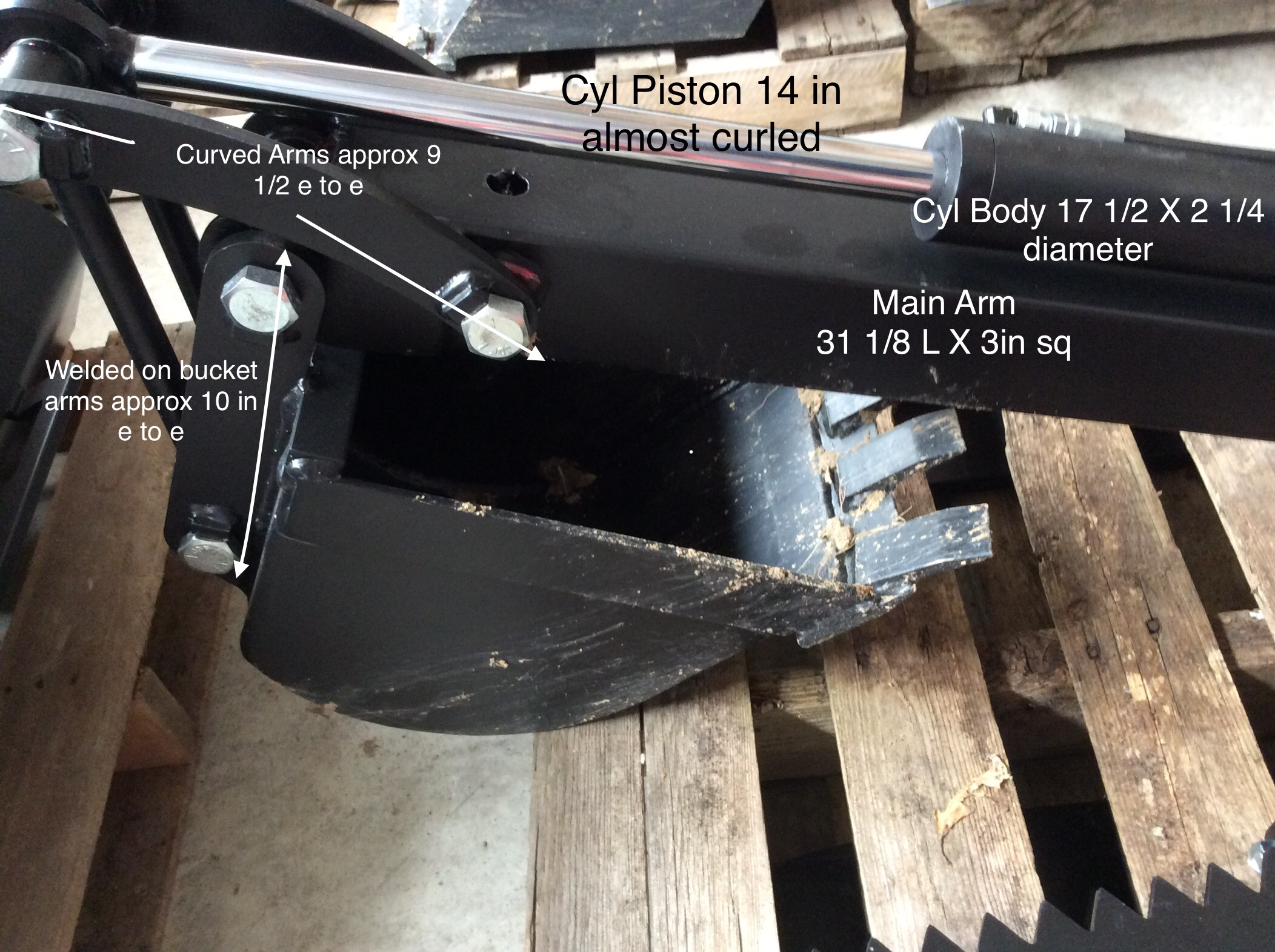

Well I have the 10 cu bucket, forks and built my own grapple and others but there are only 2 things I wish I had but too expensive. I wish I had the stump grinder and I want to fabricate and build my own mini hoe. I just need info on how they fabricate the end where the bucket attaches. How long is the square pipe and is it 4 or 5 inch sq or other size. How long is the hydraulic cylinder needed for it and so forth. I have the materials or can aquire them.

I will try and get you those measurements and a close up pic too if I can CC.

CC,
Attached are some pics with measurements on them. The thumb is 12 5/8 long with a 5x7x1/4 plate welded on and another 5x7x1/4 plate loosely bolted to the welded plate for clamping on the arm of the Hoe. The cylinder measurements do not include the bolt/pin eyes.
Did the best I could with pics and measurements. Hope it helps you

Awesome pictures. :cool2: Thanks so much but it looks bigger in the videos. These pics are great to get me started on doing some fabrication.
