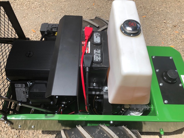

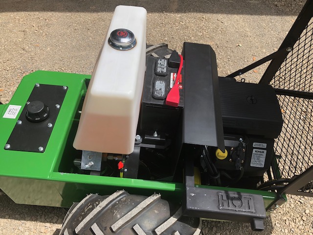

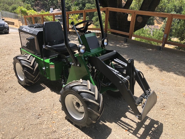

It was partially due to the collective wisdom and helpfulness of this forum that I chose to purchase a PT-425 .... and took delivery today. What a perfect fit for my needs. I have 2 1/2 acres and about 20 sq. ft of that is flat. This machine can turn around in an amazingly tight area and holds a hill well.
Seems many like to see the most recent versions coming out of PowerTrac so I'm attempting to attache some pics here (but I'm not sure I've done it correctly).
The 425 came with a Kohler Command Pro CH730-3205 - it is now rated for 23.5 HP though it was rated at 25. Same 725 cc engine so I'm not sure if they actually tuned it down or the regulators enforced some kind of "keep it honest" policy.

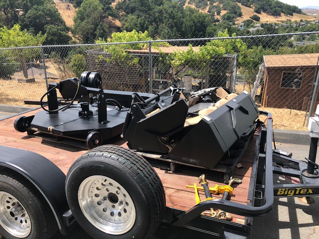

I got the LMB, 4:1, post hole auger, forks, boom, 2 plates, backhoe w/thumb. brush mower (I presume I need to flip the front wheels around?? Nothing noted about that). The only complaint I could make has been commented on by this group repeatedly - the parking brake is a pain. I'm going to have to re-review some of your posts for a corrective solution.

Nice looking package, and yes, you'll have to turn those wheel mounts around and slip the shafts up through the bottom. Mine didn't come that way 17 years ago.... and, man, you've been reading a lot! :laughing:
A note on the brush cutter.... don't flip the PTO switch with the engine running much past an idle. It'll shake and shudder a bit and smooth out nicely in a few seconds once the blades seek their natural positions. Then run up the throttle to full and off you go. But be sure and keep everyone/pets away. It can fling rocks a hundred + feet no problem. I'm sure you've read about it, but be prepared. Also, plan your paths so you aren't cutting towards houses, cars, etc... if possible. ;) It's the most dangerous tool I own, maybe just slightly more dangerous than the chainsaws.
