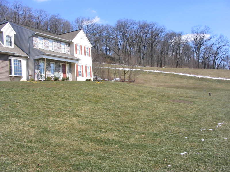

I used to have a JD 445 which is probably somewhat like the X series tractors that they make now.
I easily mowed my front slope (15-20 degrees) side to side. A couple of places were a little scary as the ground sank in a little over time to create little spots of greater slope. My 425 mows that with no problems right now.
Here's the front hill

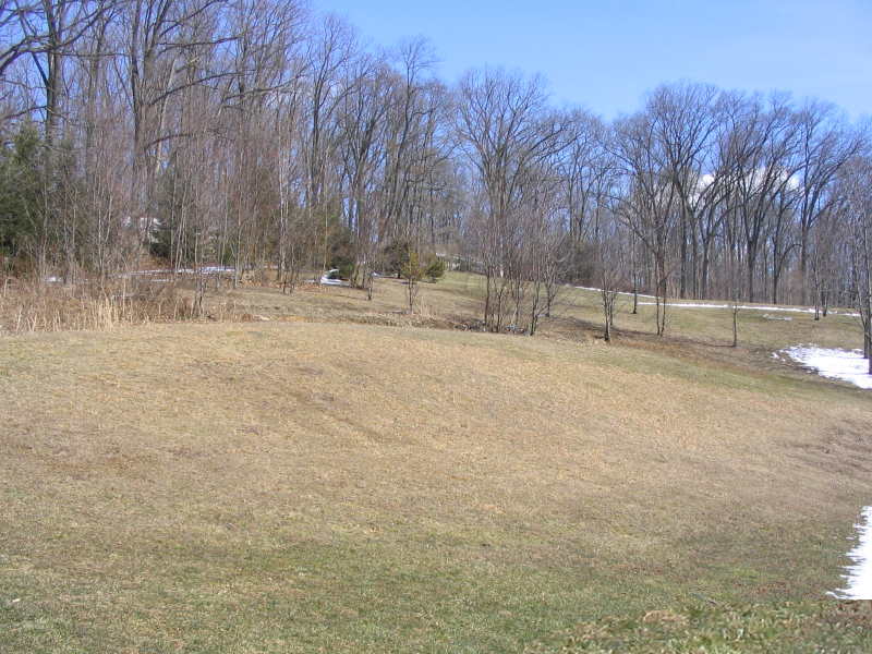

The slope behind my house is much steeper, 15-30 degrees, and I would lose traction coming down this hill with both my JD and later with my Ventrac 4200. I never even tried to go side to side on that hill with my JD, but was able to do it a couple of times with the VT. I was never worried that the VT would tip, it would just slide, forcing me to crab to keep the same line.
In the ling run, it was just safer and easier to cut going down the hill. The PT goes down the hill much like my Ventrac, but I would not try to go side to side. It WOULD tip.

And the back...
I would think that the 425 would go just about anywhere the JD would.
