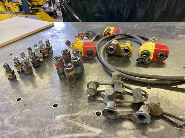

This is what we used to use on the farm.....
All OEM were discarded and replaced with Metro couplers which could be easily screwed off or on under pressure by hand.

Neat, never seen that style before. Is there any retention that prevents them from unscrewing?
When the full connection is made there is a bit of a "detent " which prevents it from unscrewing without effort.
Gotcha, I'll have to look into them. I like my flat face, but having the ability to connect under residual pressure would be nice at times.
We started using them in the 1960's. Don't even know if they're still available.
We always swapped them out when we sold or upgraded tractors and equipment.
Had a big plastic milk crate full of them in the parts room up until last year. Sold them to another farmer.
